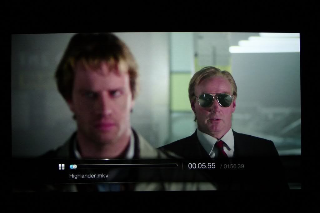

Hi Experts,
I try to calibrate my Popcorn Hour C-200 to correct some strange color decoding issues. The problem is that the C-200 use BT601 internally to decode un-flagged HD content (for example MKV's) but for flagged content it use the correct matrix of BT709.
Now I downloaded the non-flagged (1.2b) and the flagged (1.3b) version. I try to see the difference on my C-200 and also on the PS3.
Unfortunately I cant measure any difference between this two versions.
A test with this file:
http://www.cypheros.de/files/Testbil...ting_120sec.ts
It shows me that the colors a flashing if the BT709 flag is set or not but I cant see this with the AVCHD test disk.
Maybe I make some errors!? Can somebody help me?
The reason why I try to correct this are this two screenshots (form Highlander) where you can see that wrong color decoding is used:
Popcorn Hour C-200 or WDTV live
Panasonic BD35
Here are the details:
http://wdtvforum.com/main/index.php?...26980#msg26980
