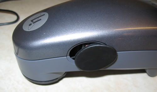

I just got an i1 Pro and noticed how flimsy the side button is. It moves/slides around very easily without much effort exposing the innards if not very careful. Is this normal?
HDholic is offline

That's pretty poor. We've sold a few i1 Professionals, and no one has reported anything like that -- especially not in so short a time. I'd call X-rite for a replacement.

That's what I'd do. For its price it should hold up together better .
