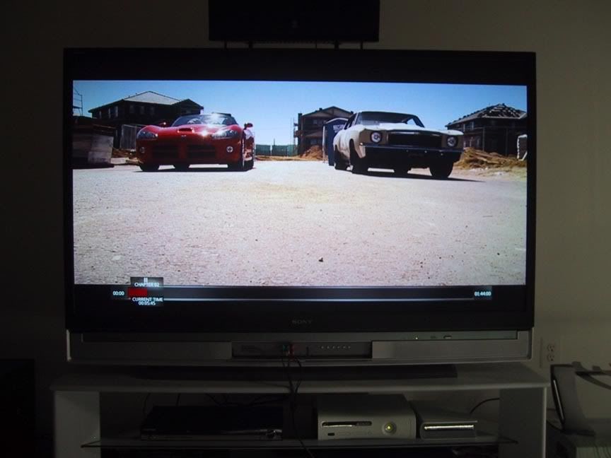

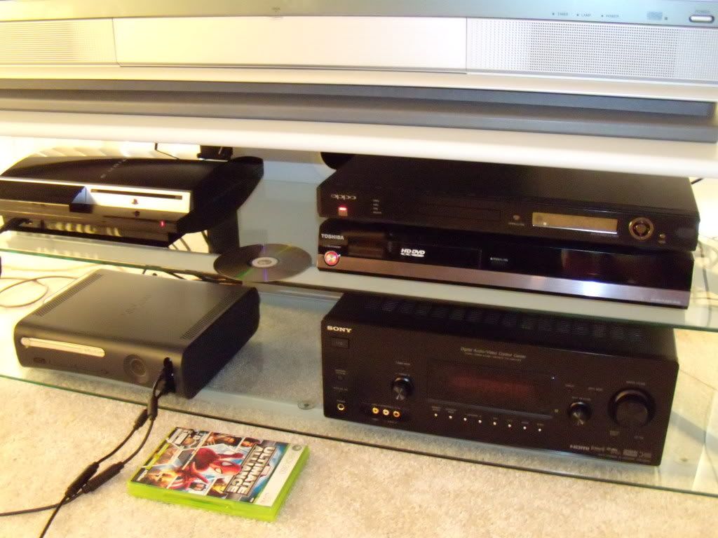

xbox #2 that broke
xbox #1 that broke
Yeh sony fanboys really like to keep giving microsoft money huh? or maybe microsoft fanboys can't handle to criticism.

that proves nothing lol... i own a blu ray pla....er I mean PS3 and I'm a huge xbox boy. I Honestly cant stand the PS3 and its LAME and BORING XMB, Its Controller and of course PSN Blows

He bought a broken xbox from ebay for that pic....lol
