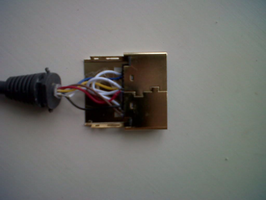

[IMG][/IMG]
so heres a pic with the audio adapter open , its not good quality but ive done my best
leroy1985 is offline

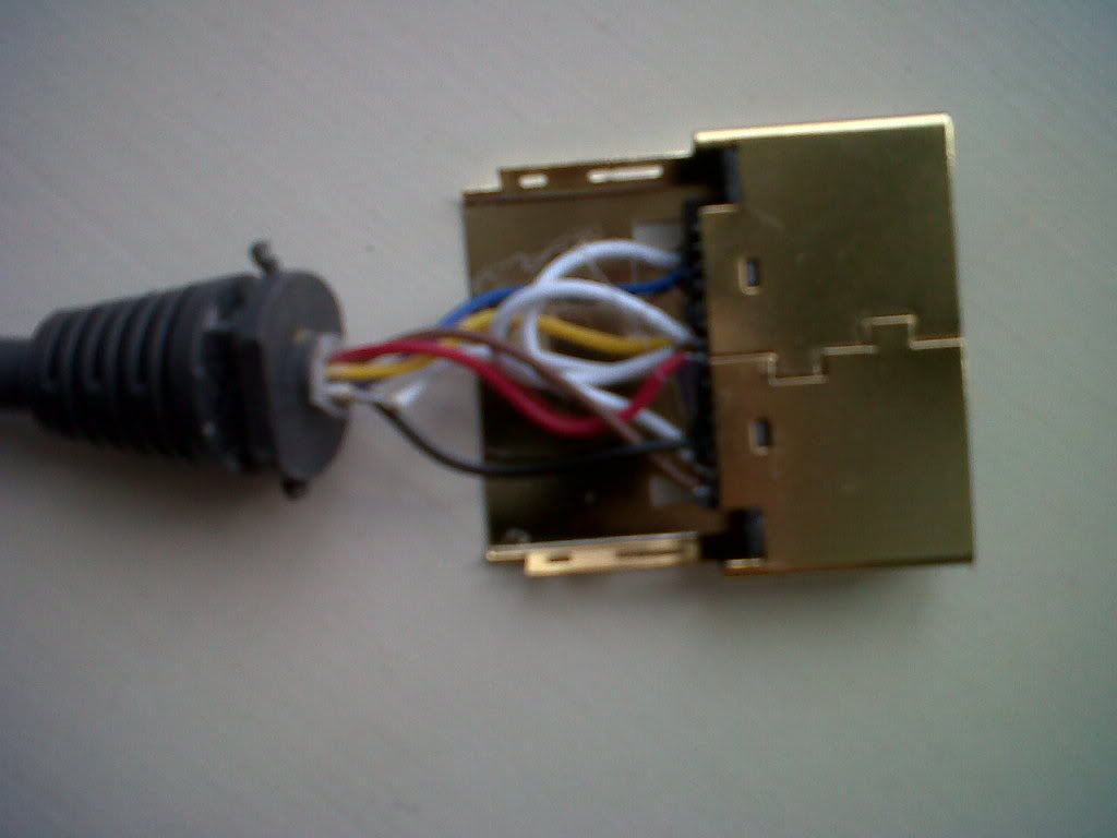

[IMG][/IMG]

i see 2 white wires looping back on themselves bt no black wire, im guessing cuz its not the composite av cable that came with some 360's, my originaly is just yellow, red ,white, and i tried opening it but it is completly glued shut
