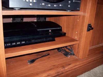

I also have a 20gig and have gotten this before; at which point I freaked and started to check my system. I play with head phones on so I can't hear much outside noise; As sson as I took my head phones off I heard my PS3 was in Super Duper 747 take-off mode; I turned the system off and Installed 2 CPU case fans in the back of my entertainment center and hooked them directly to a AC adapter from Radio Shack. Since then I have only ran into this problem one other time 'Thank God' when my AC was broke and my 1 bedroom apartment was like 97, I turned the PS3 on and played for about 45 min; then had to shut it off; So basically my question is; How is your ventilation; Mine experiance seemed to be related to HEAT; My ventilation sucked but is now way better; see link below for pics of my install.

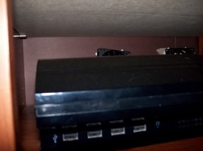

Thanks for the help, My ps3 has more open air and more ventilated. It's sitting on the top of the Entertaiment set, next to the TV.
