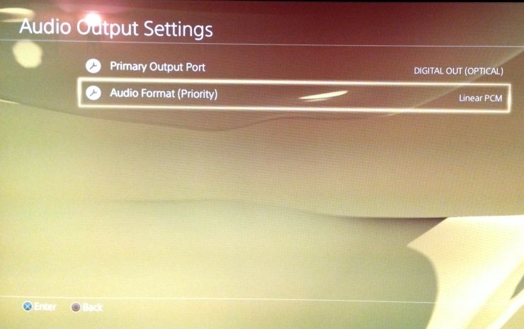

I double-checked my settings for games, here they are:
Once I do this, my AVR plays 2-channel stereo, but then I can change it to ProLogicII (and a few other fake surround modes). I still think there is something wrong with the way PS4 handles game audio on certain setups. Why would the center channel produce sound for movies, but not for games?
milehighou is online now

Originally Posted by aaronwt View Post
SOme games don't use the center channel much.
True, but this is a problem with pretty much all games I've played. Also, there is no center sound fx on the main PS4 menu. Things worked fine on PS3, but suddenly not on PS4? I blame the system.

yeah no sound for me either in the main dashboard for my center channel

Originally Posted by multicore View Post
Okay, again, new PS4, and we've tried two games so far. LBP3 has no center channel audio, but Lego Batman 3 does have it. This with no changes to anything between switching games. So is it a developer issue?
Little Big Planet 3 has no sound coming out of the center channel for me.
Shadow of Mordor is OK; Last of Us Remastered is OK; Lego Marvel is OK - that's all that I can remember for now.
My wife started playing AC Unity today, so I'll ask her if she noticed anything.
