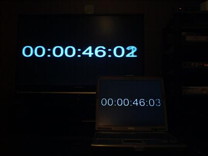

I'm a big Halo 2 and Gears of War online gamer. I noticed a big drop in my game play when I hooked up my Xbox360 to my Samsung HL-S5086W via component. My suggestion is to go with VGA to reduce the amount of lag, and turn Game Mode ON. Although, this will help in reducing lag, it's not the solution to have 0ms of lag like using a good old fashion CRT.
How did I come to this conclusion? I ran 30fps video file on my laptop to my Samsung HL-S5086W with Game Mode ON and OFF using S-Video and VGA, and took photos of my results. List of my results are show below:
S-Video, Game Mode OFF: 99-132ms (3-4 frames)
S-Video, Game Mode ON: 33-66ms (1-2 frames)
VGA, Game Mode OFF or ON: 33-50ms (1-1.5 frames)
I have pictures to prove this, but since I don't have more than 5 posts, I can't post them.

Good find, phazeshift78! How did you perform your test?

My laptop has two outputs: VGA and S-Video. My first step was to basline the output of my laptop with a CRT. So, my CRT was connected to my laptop via VGA to baseline my test. I ran both my laptop screen and my CRT simulatineously, showing my Windows desktop. I then ran a 30fps counter (a clock) which showed on both screens. An example of what the clocked showed: 00:00:12:20 , where the first and second (20) least signficant digits increased every 1/30 of a second, and the next digits (12) increased every second. So, as the clock counted up, I took pictures with my camera to capture the counts on both screens side by side. If they were in sync, then both clocks should show the same time. If they were off, you can see the time difference between the clocks between the screens. For example. If my CRT showed 00:00:12:25, and my laptop showed 00:00:12:20, then there was a 5 frame shift (or lag) between my CRT and Laptop screen.
I ran my baseline with my CRT and the photos I took showed no lag. Bot screens showed the same number every time I took a picture. But when I ran the same test on my DLP, I got signficant different numbers.
I got the idea for this test through a guy who's done this test with LCDs. I would post his website, but I can't post links yet. Just google 'HDTV Lag' and it should show up. My pictures are posted on his google site. I don't want to take credit for creating test method and want to make clear that I just copied the test from someone else who's done it.

Thanks, I've read about those techniques before. I didn't consider you were using s-video and VGA!
It's a good test - I wonder if Circuit City or Best Buy would mind if a customer brought in their laptop and a camera to test out TVs before they buy?
I wonder how different the results would be if you had a video running in the background. It would be interesting...

Well, they guy who came up with the idea went to a video store with his laptop and took pictures of different models, eventually purchasing the LCD with the leaset significant amount of lag. I would think the store would more than happy to let you run the tests, since it would make them more knowledgable about the performance of the HDTVs they sell.

post #322 of 718 Old 01-19-2007, 04:58 PM
Phazeshift78's Avatar
Location: Everett, WA
Posts: 70
Here are my photos of my tests. I've taken at least 3 or more photos of each setup, but I posted the best ones for each.
CRT and Laptop via VGA
HL-S5086W and Laptop via S-Video, Game Mode OFF
HL-S5086W and Laptop via S-Video, Game Mode ON
HL-S5086W and Laptop via VGA, Game Mode OFF or ON
Here's the guy's website who I got the idea from...
http://hdtvlag.googlepages.com/
