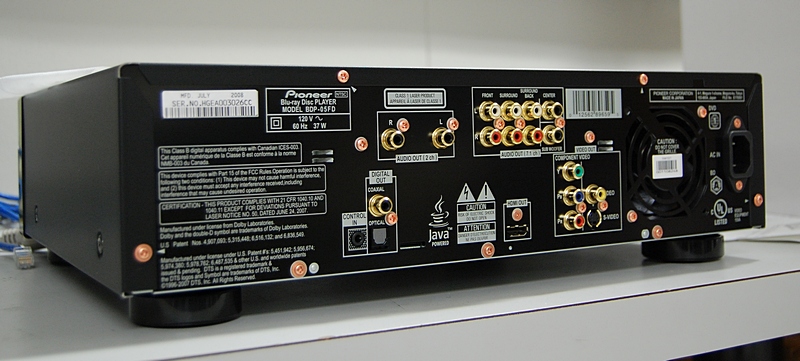

it's here! BDP-05FD -> Mitsubishi HC5500 projector. Direct Source - > Reon HQV is my main interest.
latest firmware. Can't test it until much later tonight, but thrilled it's here nonetheless.
it just doesn't have the styling of the classic elite LD players. Bring back the wood

zombie.....Congrats!
Awesome looking box....Can't wait for mine, seeing one in the field drives me nuts!
Can't wait to hear some feedback....Do you own T2 or Top Gun on BD?

I loved the rosewood sides on the old Elite equipment. Been gone for many years now!
I miss the rosewood sides on the old Pioneer Elite equipment!
