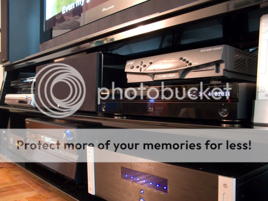

My March 2009 Malaysian built Pioneer BDP 320 arrived late tonight. Firmware Version 3.04
Initial impressions from April 2009:
Decodes DTS HD MA out of the box.
Seems about as quick in loading and power on times as 51FD.
PQ for SD DVD and BD is identical to 51FD best I can tell.
AQ is very good over analogues; generally impressed by Burr Brown DACs.
Very slick looking.
Cannot seem to connect to the internet yet for firmware/internet connections yet.
Will play BD+ (QOS) discs without issue
Here it is boxed:
Attachment 141372
Front shot
Attachment 141373
Comparison of size to 51
Attachment 141374
