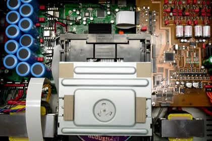

Charles, have you revealed what Dacs are being used in this player?
Also for those that interested here is an internal shot of the player found over on soundstage's website
Sorry it is not the greatest pic
"Without music life would be a mistake." -Friedrich Nietzsche
sac8d4 is offline

Originally Posted by sac8d4 View Post
Charles, have you revealed what Dacs are being used in this player?[/IMG]
It's the same DAC chip we use in the C-5xeMP -- the Burr-Brown DSD1792. This is the same exact part as the PCM1792 except that the pinout is a little more friendly for sending it "DSD" signals when playing back SACD's. A very minor difference.
As with all of our players since the MP upgrade at the first of the year, we bypass the DAC chip's internal digital filter and use our own custom asymmetric FIR filter (implemented in an FPGA) to give minimum-phase response. There is a white paper on this on our website under the "What's New" section.
Charles Hansen is offline
