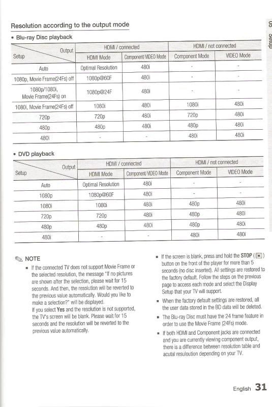

Anyone have a good link to the manual for this unit?
I've downloaded the ones at this support link but they won't open in Acrobat for me and let me read past the first several pages.
http://www.samsung.com/us/consumer/t...il&tab=support
I need to see page 30 or so, to learn whether this player allows for native pass through of video resolutions. That is, if a source is 720p, I like to see it that way, not scaled in the player, and if the source is 1080p, I like to see it that way, etc. (I have an external scaling solution.)
I know the Oppo does this but I need a player with Vudu and Netflix that can do it -- and the Oppo does neither of those services.

An
This what you want?

Awesome thanks. That is the page.
Unfortunately like most players it looks like this one doesnt have a "native" mode that just outputs via hdmi the same resolution as the source material.
Yes it does. Push "Full Screen"-button at the remote control. There is 3 options: mode1, mode2 and original. Original shows the same resolution as the source material.
