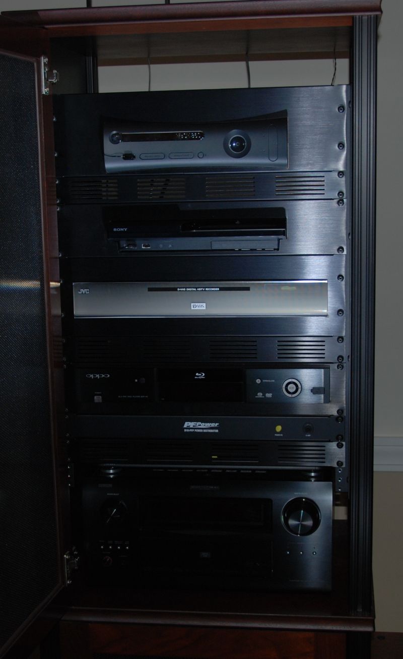

Originally Posted by petemcn View Post
My 93 should be arriving next week. How long should it take for Middle Atlantic to make up a rack shelf specific to the 93?
Please pardon me for this naive question, but is there something about the Oppo 93 that would require a special rack? I only ask the question because I am thinking seriously of upgrading to the Oppo93 and I want to be sure that it will fit in my current AV rack. The Oppo would be a non-starter in my household if my family knew that I needed to get a new rack as well! Thanks.
Cal68
Cal68
I see that Bob already made a brief reply to your question, but I thought I would expand on it. If you're using a regular rack with shelves that you sit your components on, you should be all set - there's nothing special about the BDP-93 in this regard.
The custom rack shelves are used when mounting equipment in a 19" wide rack mount enclosure that you would typically see in equipment closets and high end custom installations. What the custom shelves do is put a facade around the front panel of each piece of equipment, extend the width to the standard 19" width with holes at the correct spacing so you can bolt the shelf to the equipment rack, and lock the device in place so it won't move when you press buttons and insert / remove media. The end result, if done properly is a nice neat presentation of all the gear and no holes where you can look through and see cables or anything else in the back.
Middle Atlantic Custom Rack Shelf Overview
Here's a sample (I apologize for the quality of the photo, but it should give you the idea) of how the custom rack mount shelves look when installed in a Salamander Synergy rack with their optional rack rails. The XBOX 360, PS3, JVC DVHS player, and OPPO BDP-83 are all installed with Middle Atlantic custom rack shelves:
