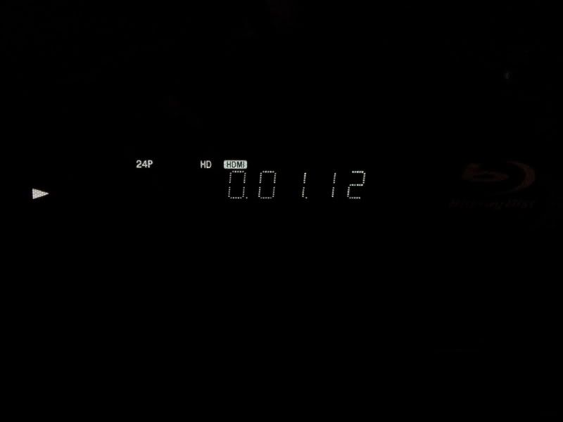

Hello everyone,
My first post here on this forum and a request for help/clarification.
I am so confused and the following is bugging me so bad, I cannot find an answer anywhere!
I will try to keep it short and clear.....
I have a Sony BDV E370 all-in-one Blu Ray system. The BD drive is knackered.
I have a PS3 slim. I had to use it as a stand-in until replacement for above is found.
I connected PS3 to BDV via optical and prepared for lossy DD5.1

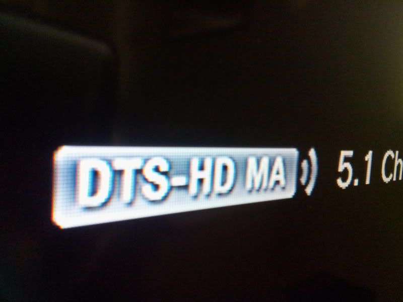

Played a Blu Ray, set PS3 to output "Bitstream (Mix)"
Bought up the PS3 on-screen display & it tells me that it is sending DTS Master Audio, 5.1 and at a rate of Mbps. When I check on the BD menu screen, it correctly shows DD 5.1 at 640kbp
All that I can find on the net is that PS3 slim cannot bitstream HD codecs over optical.
So, two big questions.
1. Why is my PS3 showing that it is sending the HD codec
2. Why does it sound so good - it definitely is not lossy DD 5.1 (there is a clear & marked difference between the DD5.1 @ 640kbps menu soundtrack and the DTS-Master Audio main feature soundtrack

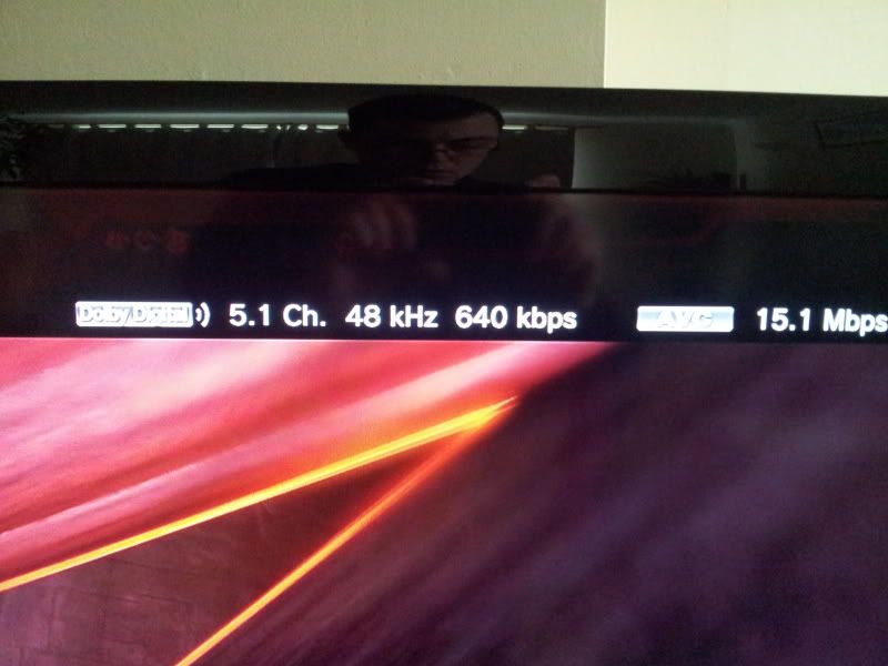

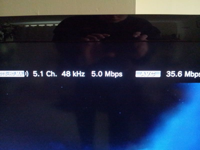

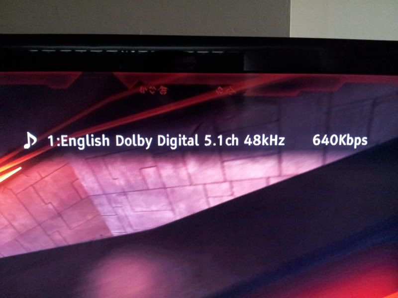

Here are some pictures that I have taken to help explain:
The disc is Transformers Revenge of the Fallen on Blu Ray.
1st.
Menu screen with OSD showing Dolby Digital 5.1 and 640kbps
2nd.
OSD during playback showing DTS MA 5.1 and 5Mbps (this goes up and down during playback)
3rd.
Amp front panel display when PS3 is set to output Bitstream (Mix).
4th.
Amp front panel display when PS3 is set to Linear PCM

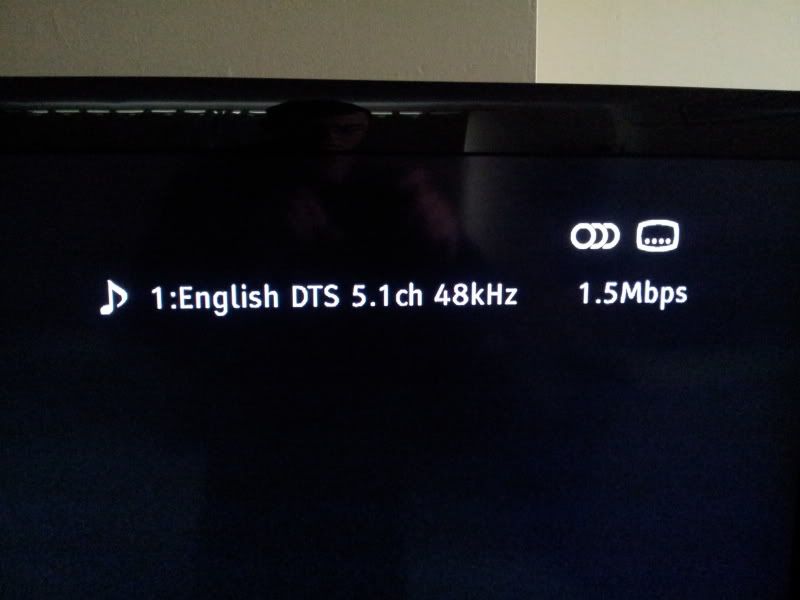

Here are some comparison pictures when using the BDV E370 as the Blu Ray player
Front panel display during BD playback
OSD during menu screen
OSD during BD playback
I bought up the OSD of the E370, I thought the audio bit-rate went up and down during playback (like the video bit-rate) as the PS3 does. It doesn't though - it is fixed at 1.5Mbps! Never moves, always 1.5Mbps.
Very odd.
Someone out there must be able to shed some light on this, I'm really hoping that it is one of you guys!
Thanks so much from a very confused person
pigSTi is offline

1.5 Mbps is the maximum over Optical (if I recall correctly), which is why you are seeing that number. The OSD is showing which audio track you have selected on the disc, which is not necessarily what is being output over optical. If you select Bitstream, both DTS and Dolby HD codecs have a lossy core (1.5 mb/sec) that can be sent over optical to a receiver. They are higher in quality that conventional DD and DTS tracks, but are still lossy.
When you select LPCM, you can send stereo lossless audio over optical and that is what is being sent. Over optical, you can get lossless stereo (I believe up to 24/96, but I can't recall 100%) or you can get a 1.5 mb/sec lossy stream that is DD+ or DTS. The OSD in the PS3 during playback will show the audio track you selected on the disc, but the OSD of the receiver will show what it is actually receiving.

Thanks for the fast reply!
The screen shot that shows 1.5Mbps was from the BDV E370, so no optical lead involved.
The PS3 OSD shows a varying bit-rate, in the case of the screen shot I provided it was then reading 5Mbps.
I understand what your saying about bitstreaming a lossy core audio, that makes sense.
However, what does that say about the E370 playing back at 1.5Mbps?! That is pretty poor. Also, there is the fact that what ever the PS3 is outputting sounds far superior from what I have ever heard from the E370.
If I change the PS3 to output LPCM, it sounds identical to the E370s efforts. The difference between those two and the bitstream (mix) from PS3 are massive.
Both the E370 & PS3 LPCM sound by comparison:
Muffled
Compressed (like the dynamic range control is set very high)
Lacking detail
Quiet
Can it be that whatever the PS3 bitstream is, that it is of higher quality than the E370? It sure sounds like it is! But how? Why? So confusing!!
pigSTi is offline
