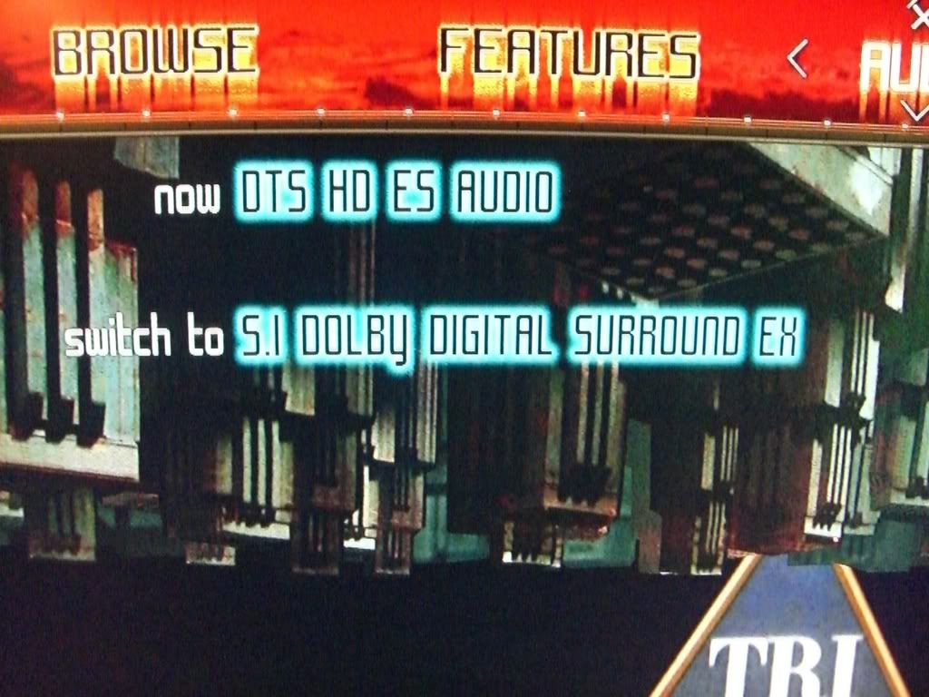

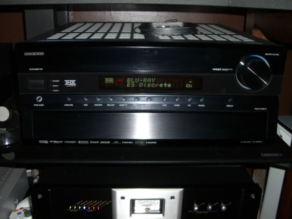

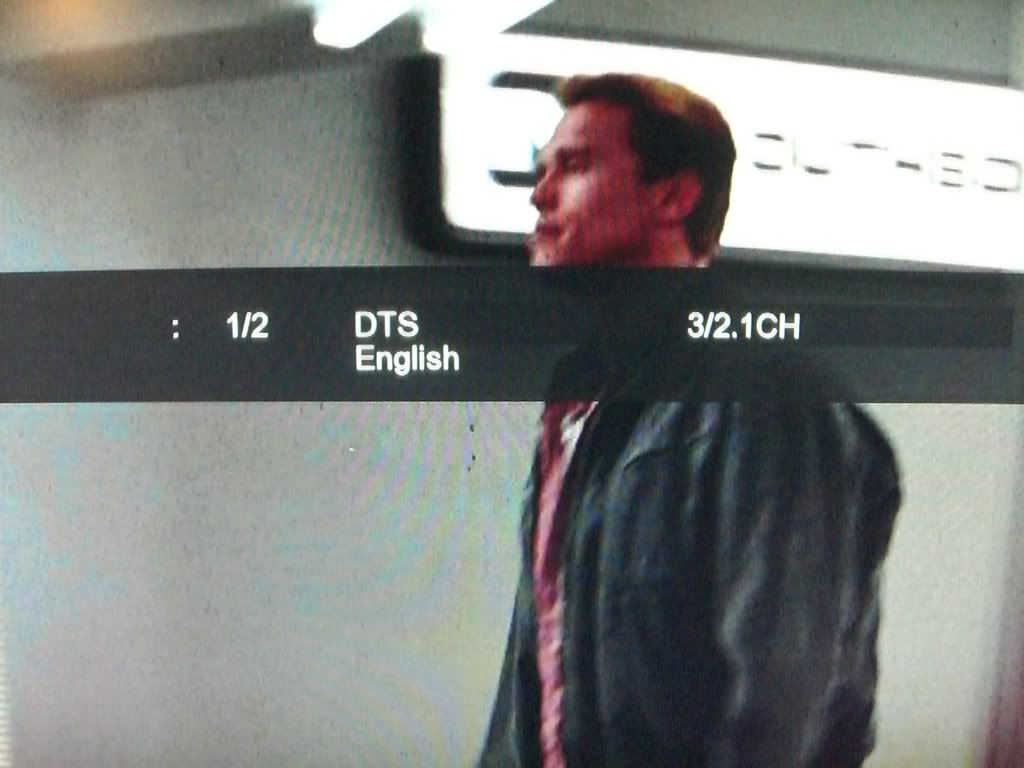

I hate to bring bad news but the Sony does not decode DTS-HD like the manual said, it sends DTS-ES instead. I thought it did as well when Totall Recall played fine but I didn't bother to check how my receiver recognized it nor how the Sony was sending it. This leads to believe it won't do TrueHD either, anyone got a TrueHD disc to tell. Sorry lparsons my original suspicsions were confirmed, check out the pics.
The disc has a DTS-HD HR option:
This is how the Sony sends it:
This is how the Onkyo TX-SR805 receives it:
I see your picture, and I would raise you one, but I'm too darn lazy.
On the disk I had with TrueHD, my receiver shows MPCM, not DTE-ES. So I know it does the TrueHD fine.
Further, I have a DVD (Snakes on a Plane) that has DTS-ES Discrete on it, and my reciever shows DTS-ES Discrete, not MPCM.
What I don't know, except with your picture, is what I would see with DTS-HD as I don't have a disk with that on it.

I hate it, but your test doesn't prove your point. It proves that the 300 doesn't pass DTS-HD, and the manual says that it doesn't. The manual does say that it decodes it, but that is a little harder to prove.

Maybe it does to trueHD as the manual says, but doesn't the manual say DTS-HD as well. DTS-ES will be passed as bitstream from Snakes on a plane that's why your receiver recognizes it as such.
Where does it say that in the manual? The infamous page that everyone keeps referring to in the manual suggests that this player does do TrueHD and DTS-HD. Someone with a trueHD soundtrack take pictures and prove me wrong.

Your 300 is acting exactly like the manual and that chart says it will. If you do what the manual says, you will get TrueHD and DTS-HD.

That'll teach me to use my failing memory. On page 48 it says that DTS-HD will be passed as LPCM 5.1 IF you select PCM and not AUTO for the HDMI out jack.
If you select AUTO, which is what I think is what happened with that photo, then it passes it out as DTS.

You need to set it up to send PCM or use the analogs.

Further reading says, change the HDMI out jack to PCM and then DTS-HD will be sent out as a 5.1 LPCM stream. In AUTO on that jack, it will output DTS, which is what you saw and I think why you saw it.
I hope that this is correct, but I can't check it myself.

Auto selects the "best" signal. Selecting PCM just forces DTS to be decoded in the receiver. Can you prove to me that the player is sending DTS-HD rather than DTS. If so, you're right.
