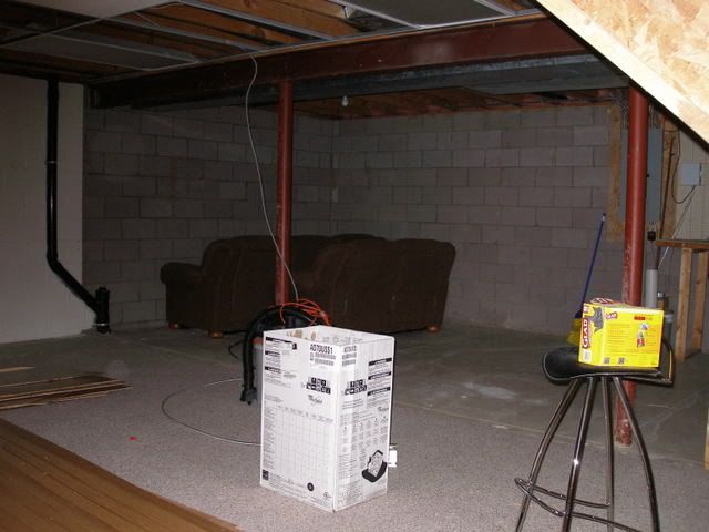

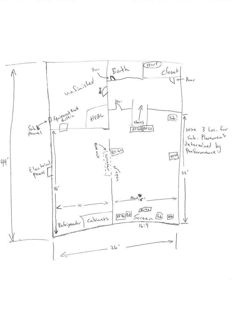

Well, after much anticipation, I finally managed to get my theater under way. While I still dont know "exactly" what I will have in the end, I at least have a good idea, and sometimes that's all that one needs.
I want a theater room in which I can enjoy my NHL Center Ice all winter long, and partially into summer, as well as movies (blu-ray now), and then another room where we can sit and play cards and what ever else.
To get things started, the lady and I just moved into a newer (16 yo.) colonial, and the biggest gripe I have is the stairs right in the middle of the basement. It limited me a bit, but in the end I will end up with 2 rooms. One 20x15 (theater) and another 11x20 (card area/fridge). the rooms are split by support beams in the middle.
My construction ability is none, so I originally thought to just contract out the framing, electrical and drywall, and do the low voltage myself. Well, after months of reading, I convinced myself that I might be able to do this myself. So the decision came, whats the easiest way for me to do this? and I ended up deciding to go with steel instead of wood.
I figure it is easier for me by myself to work with the steel and I can order it all at once, and not have to worry about anything warping if it lays around too long.
So, on good friday my shipment came, and I hauled everything down to the basement, and that was it, the rest of the weekend was shot. I had a busy week last week, so I was not able to start until this past Saturday. Both nervous and confused, I tried figuring out what I was about to do, and as soon as I hit the power hammer for the first time I was into it. --I guess I lied, I actually started Thursday night last week because I just had to try the power hammer, I nailed down 2 runners and called it quits...

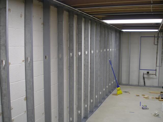

Well, after the weekend, I look back and say I managed a bit more than I would have thought, but i have something now and i will take it from there.
As I go along, I have no idea what kind of pace I will have, but from the looks and sounds of it from reading, many folks move fairly slow. It will be tough in the summer to get lots done, but I will do what I can and call it a day...

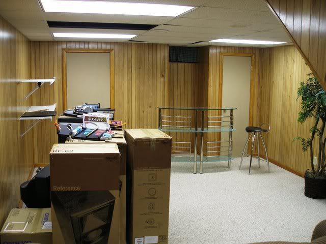

Some before shots:
The Layout...(I hate drawing)

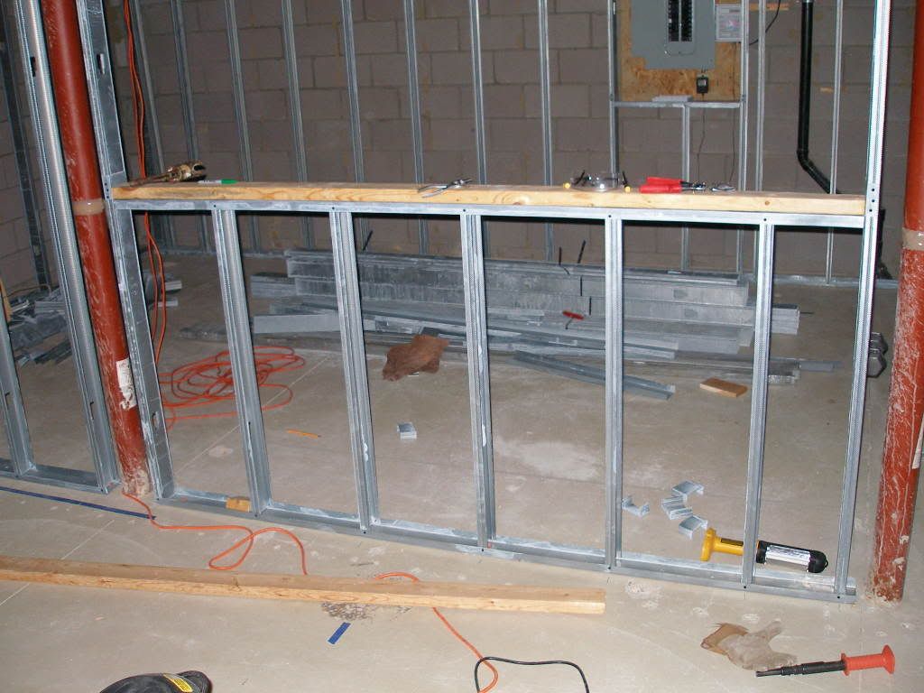

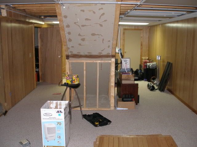

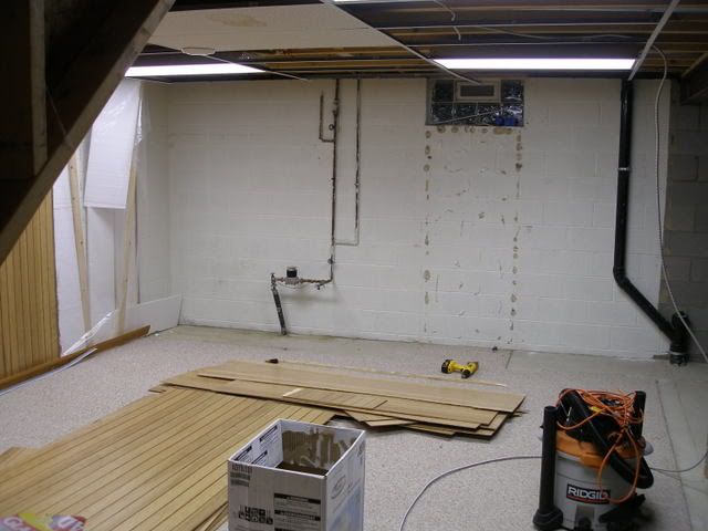

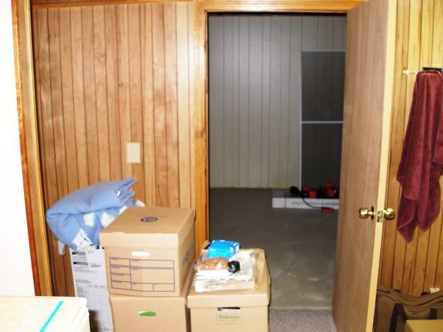

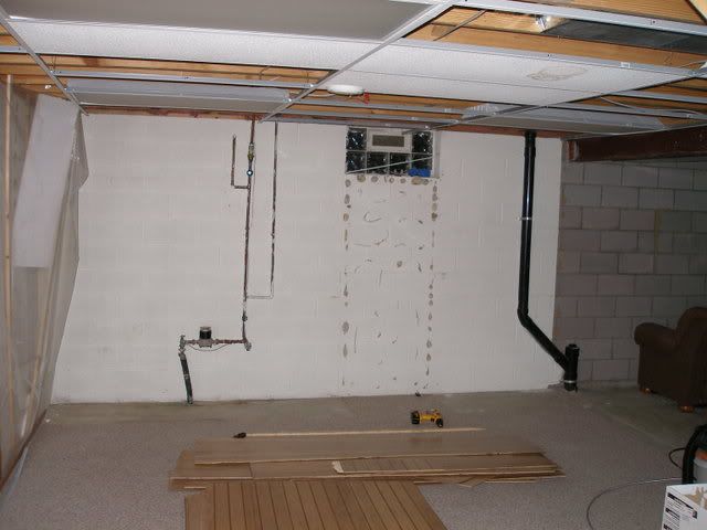

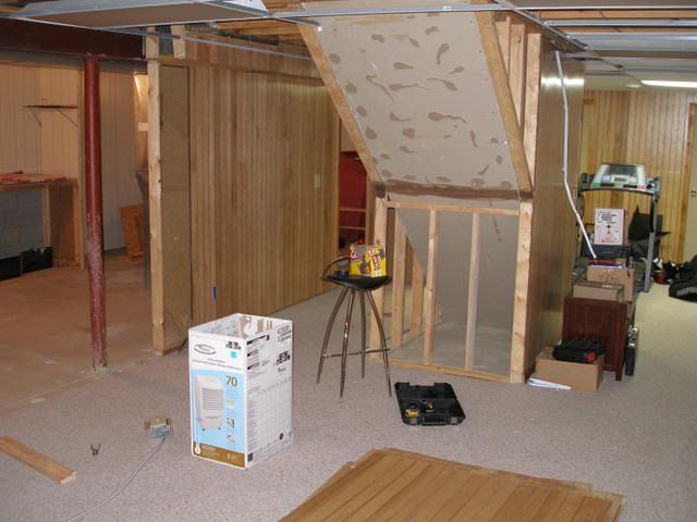

Then some demo photos:
and where I am at tonight:

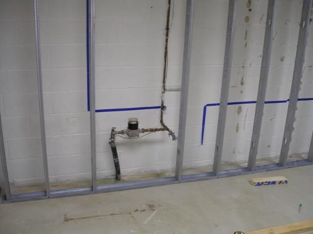

I am going to have a plumber move this water meter back a few inches to I can frame my wall...he has to replace the main shutoff anyway so he said it is no big deal

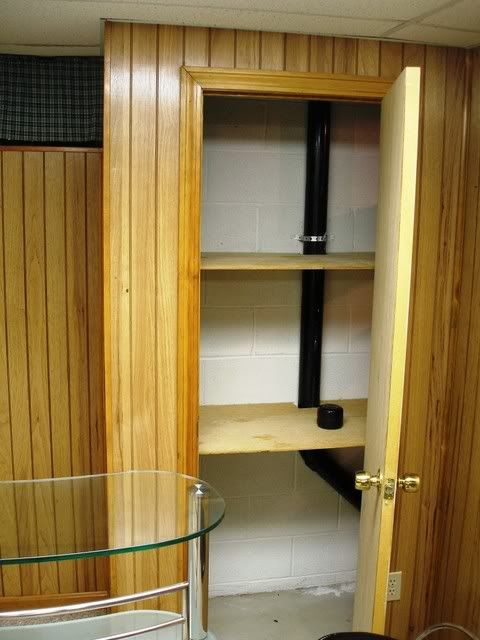

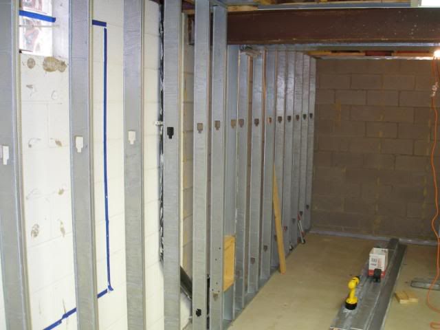

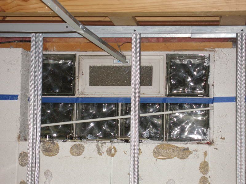

And one last photo:
-note, in my haste, I forgot about this window, and now I dont know what to do about it. Do I go back and frame around it and put in curtains, or do I bury it behind my wall forever. the wall where this is, is going to be the screen wall, so it is tough to decide what to do with it... the track in the middle intersecting the wall is from the old drop ceiling so it will go away...
In using steel I have one major concern, rattle as a result of Bass. I know very few people use steel here, so it is tough, but because I wont have drywall on the backside of some exterior walls, I dont know what to expect. I will have insulation. I thought about screwing the backs of the studs to the track as tell, but it is tough to get in there with the screw gun, so I thought tonight of the idea to get tape foam insulation stuff and put it at the backside to at least reduce any possible rattle from where the stud meets the track in the back. However, if anyone else has done steel like this and has other ideas, I am all ears. (what i really want to hear is that even if I dont screw the back side of the studs as well, I dont have to worry about rattle... )

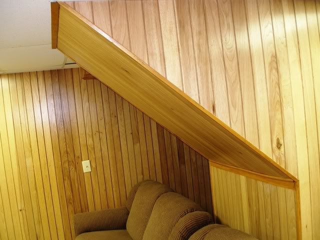

I am in the same boat. 16yr colonial with stairs smack dab in the middle of the basement. Have you drawn up any floorplans yet? I'd really like to see them as I try to figure out what I am going to do in my basement. (See link to thread down below in my signature).

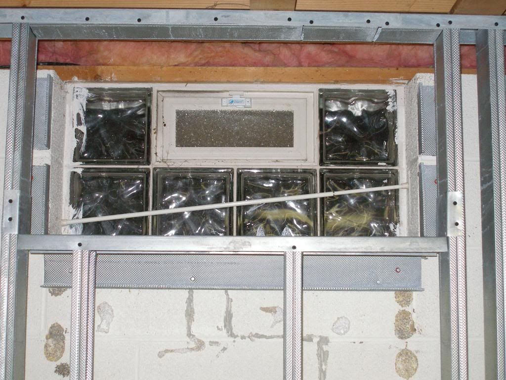

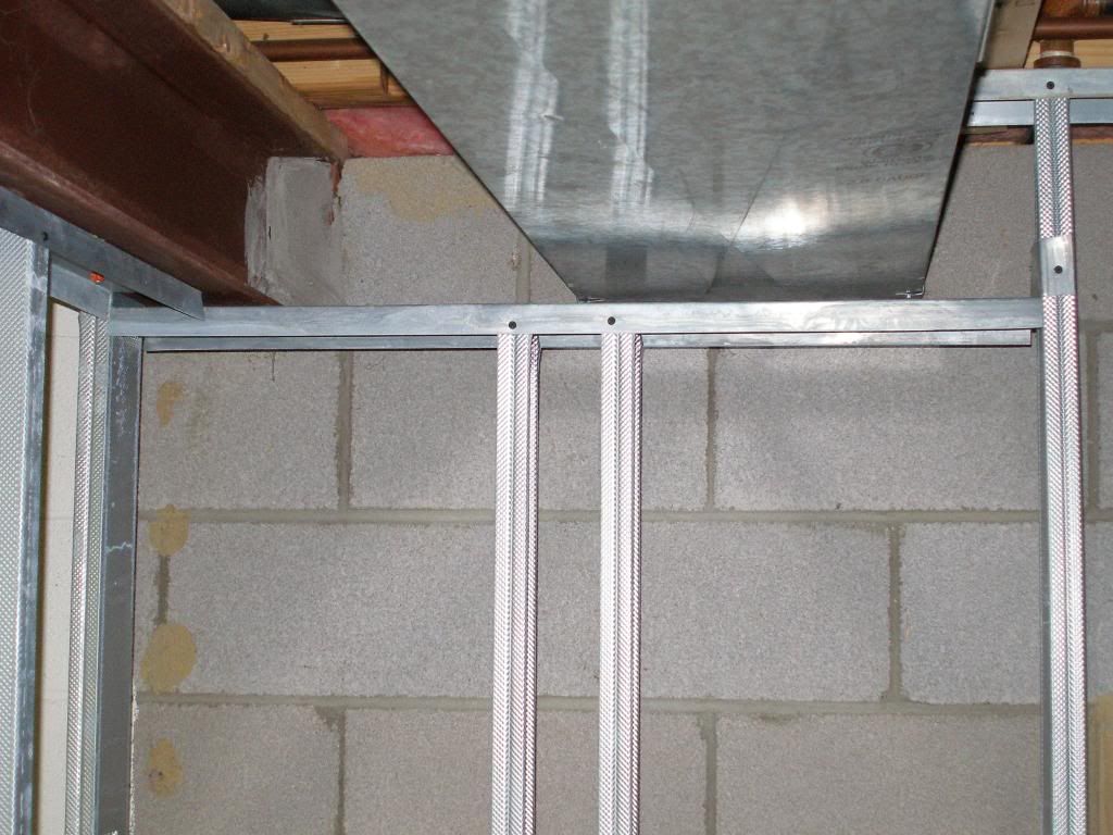

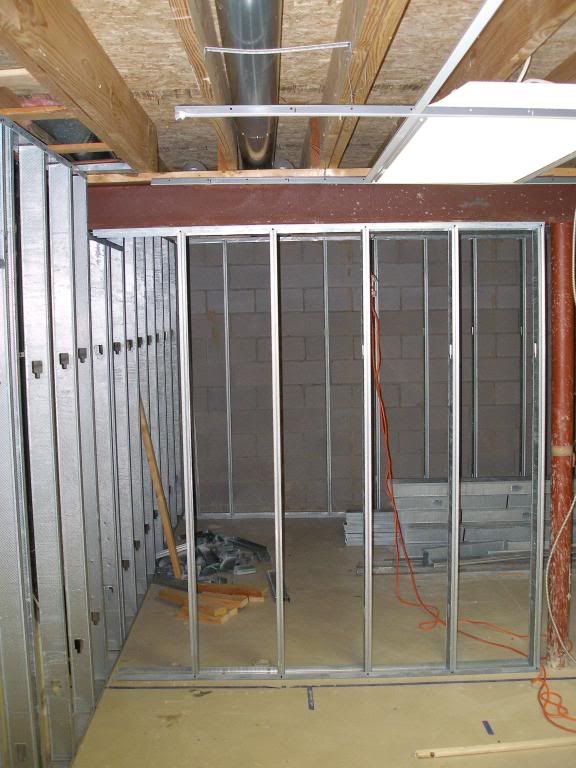

The window framed properly:

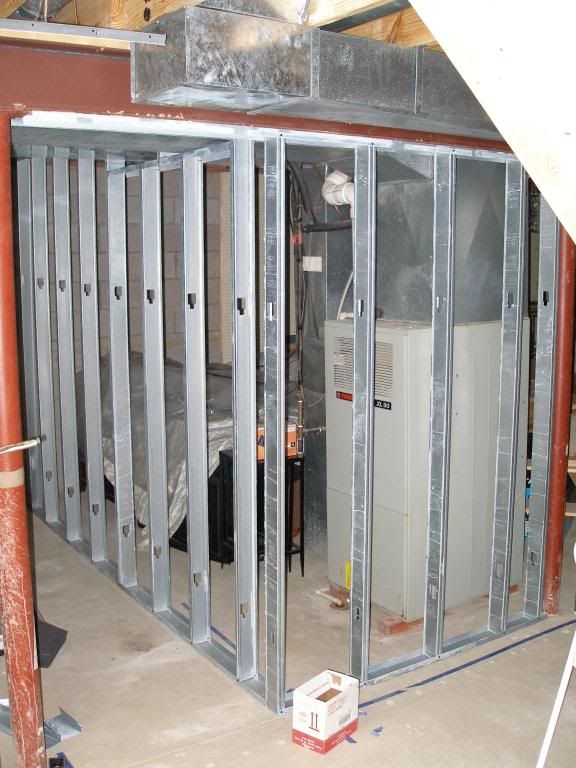

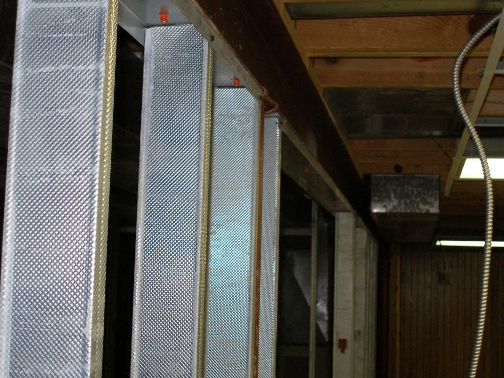

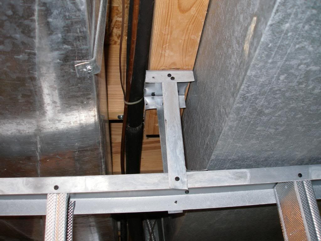

Electrical Panel:
Under Duct Framing:

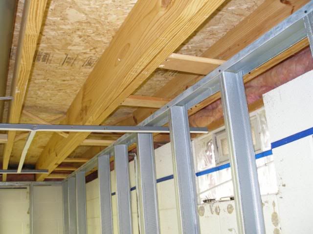

Front wall under beam (I never thought I would be firing nails into a steel beam) I used Liquid nails as adhesive as well to add a little extra...
smakovits is offline

you're braver than i was. there was noooooo way i was going to shoot nails into my i-beam. i just used the heavy duty liquid nails and it once it was all constructed it was strong as a rock.
fwiw i haven't had any problems with bass rattling any of my steel. my sconces on the other hand...

Believe me, I was afraid too, heck, I still am. Plus it is 100x harder to hit the nailer upwards than it is to hit it down on the floor.

I never thought I would say this, but I officially hate nice weather. It simply means that instead of being able to work on my theater, I have to do yard work and other such manual labor around the house. I was also out of town one weekend, so that didnt help, but this past weekend I made sure that I would get down in to the basement to get some things done. It wasnt much since Saturday was wasted doing chores (of course)...I went ahead and ripped down all of the drop ceiling supports, taking down all the fluorescent lights with it. I replaced the lights with some normal 100 watt ones about 2 less fixtures than the 4 bulb fluorescents that I took down and man can I say how different the light is. mostly there is just less light. I can still work but I think I will be forced to add at least one more at one of the ends. removing all the t bar things really opens the room up more, adding the few inches of ceiling height makes a huge difference.
I also built one of the two rear walls, 2 because there is one on each side of the staircase. The one that I built is the one which wont have a door because I havent yet decided on 30x80 or 32x80 doors. However, I am thinking 32x80 since I have the room and they are the exact same price...

Nothing is greater than watching a nail pop out through a Steel I-Beam. Until now, most of my nails only penetrated my I-Beam a little bit, but last night I wanted to finish attaching the runners for my wall...This time I was a little more confident with the hammer than the first time I was firing into the I-Beam, I wasnt as hesitant to hit the thing. So I again used some liquid nails, gripped the thing to the beam and began firing away...the first shot was lame, just like last time, barely in the steel. but then the next shot fired clear into the beam. 3/4" pins poking out the top side of the beam, it was great, it certainly put a smile on my face...
Now granted it is no jack hammer or Bobcat, but it is the most powerful "tool" that I have used in my time...
Now just a question about acoustical effect...the way the room will be configured, the stairs will make up the middle of the back wall. then on the two sides, I am recessing the wall back some 2 feet to allow me to put my speakers there and to bring the couch that much farther from the screen. My question is, will these cove like spaces cause echo or other such acoustical issues?

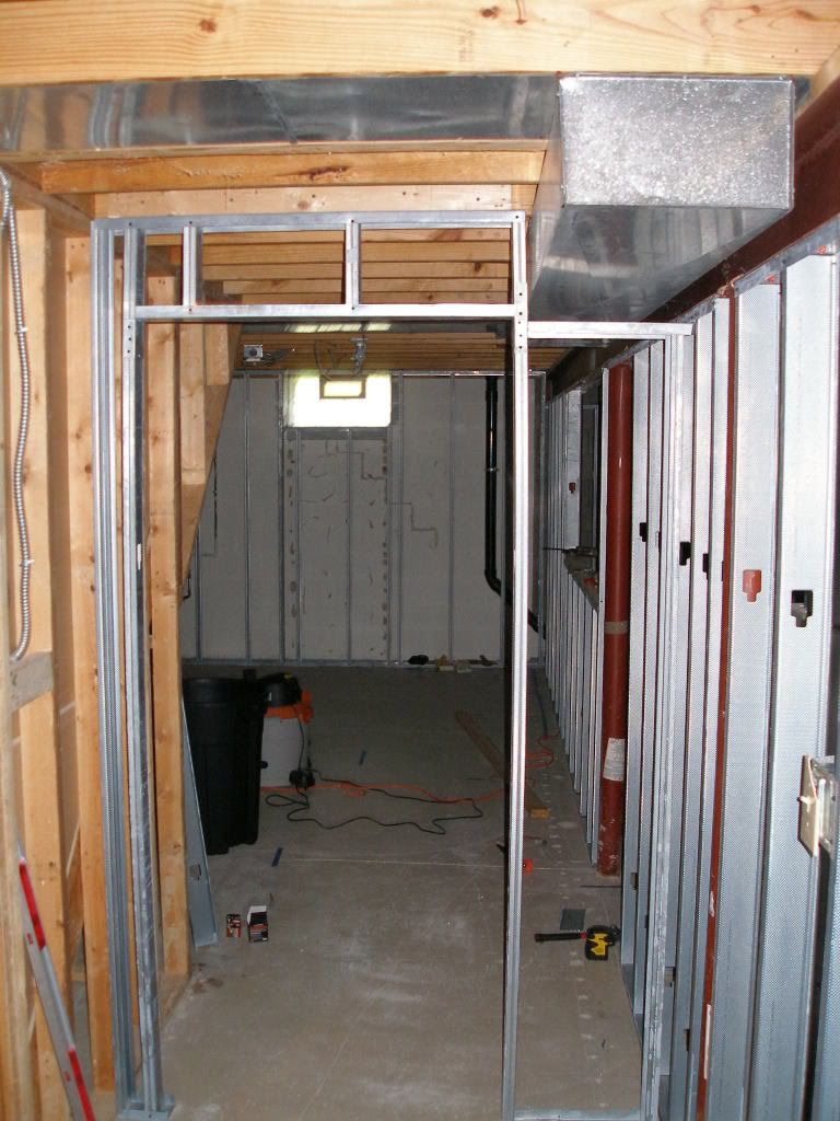

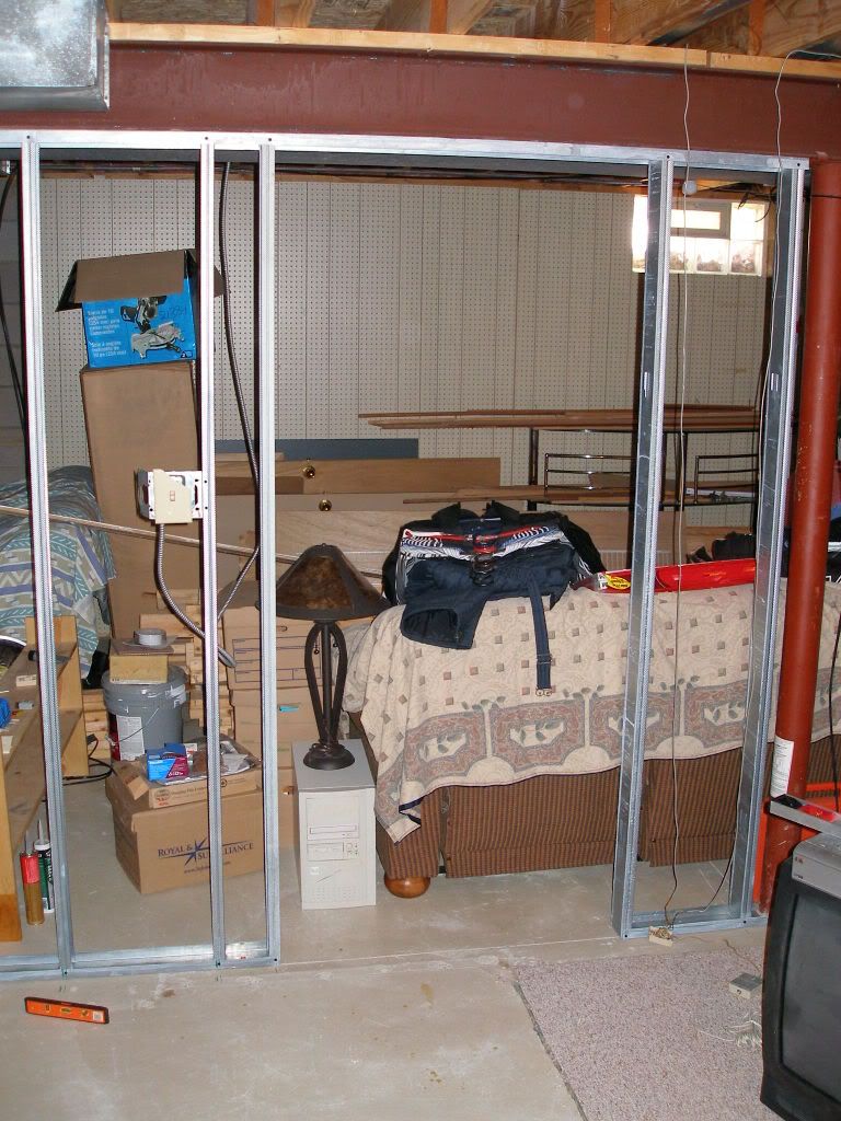

Got a few more things finished, such as 2 doorways framed minus the wood. I need my brother-in-law to return the saw so I can cut those. Otherwise, it is done. the doorway to the unfinished side is actually just high enough to get 82" under the beam. I didnt realize it was so close, but it will work and thats all I care about. The counter wall section is also finished, now I await finishing that, but I have some time. The bathroom I want to put in also needs to be designed. I am thinking 5x8 will be the finished size, but that is still in the works, it is just hard to figure out how to design it when the brain is thinking theater...

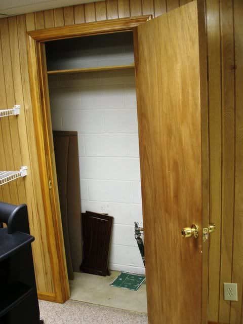

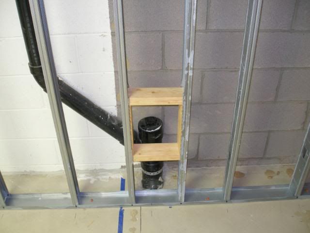

so here are a few new pics showing the newly finished items:
Until the bathroom is decided I think I am pretty much ready for electrical and wiring. I cant decide if I want 6 or 8 cans in the man theater room. also, are sconce's really necessary? are they mainly for effect? how many outlets is safe per wall, 1 or 2?
also, when it comes to electrical for the projector, do most just use a standard 3 prong computer like plug? I am curious because people talk about needing battery backup for the projector, and I dont understand how you can do that if you just wire an outlet right next to the projector. I figure you need to run a plug somewhere unless you hide the battery in the ceiling or I suppose in a hush box like enclosure.
Now the fun part. I want to finalize the projector so I can prepare accordingly. I am undecided between the Epson 1080 UB, Panny AE2000, and sony vw40.
Because I will want to watch sports which I assume will result in some light, I figure the Sony will struggle since it isnt as bright, but I could be wrong. when it comes to the Epson, i cant justify the extra 1k for the Pro so that brings me to the AE2000. For some reason this is where I keep ending up, however I cant make up my mind, therefore, I am looking for a little push. Anything that helps me make that final decision. Or due to the fact that I am a little ways off yet, do I wait and see if something new comes out in the next few months...?
