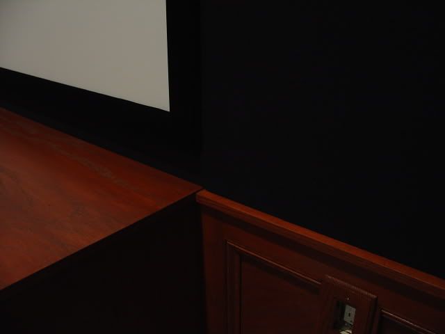

This was my favorite part...why? Well, its not every day a guy is building fabric panels for his home theater. Plus, when I completed these and put them up, snug to the wall, it completed the theater...in a way, the installation of these fabric panels made the entire room come to a full circle and it brought a delightful smile to my face.
I used some left over 3/4 inch plywood ripped to about 1inch in width.
After much search for the proper fabric I finally settled on the famous GOM FR701 408 Black. I have to say, this material is really sharp looking and nice to work with. It has just the amount of stretch property without distorting the texture.
I used this on my front wall panels to surround my screen as well as the front cabinet open panels.

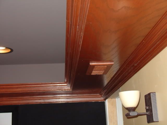

The flash sure shows my nail holes...which I still have to fill
I still need to extend this outlet 1 1/4 inches! I should have just removed this outlet, but part of me wanted the challenge of trimming around this outlet.
and a backside shot: (I still have yet to tidy up the paint lines on the ceiling)

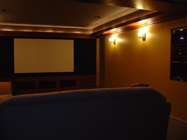

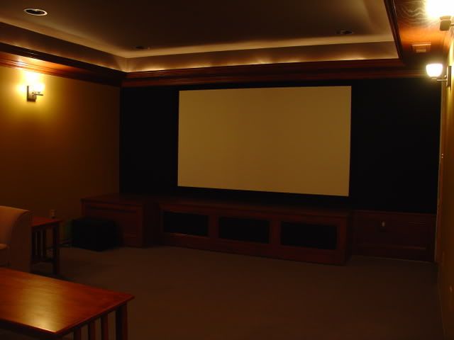

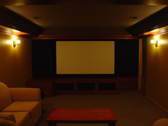

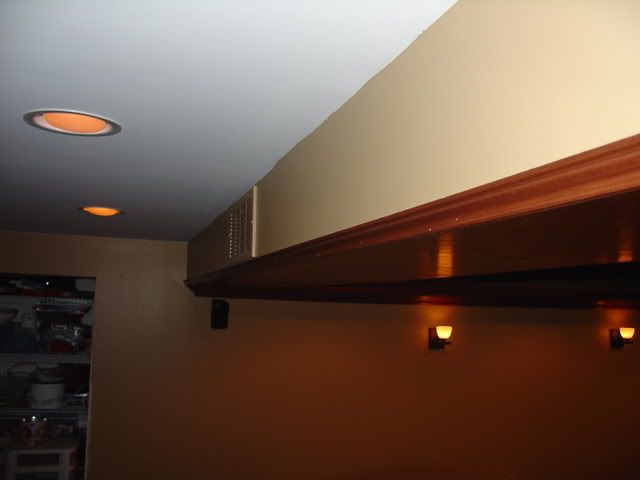

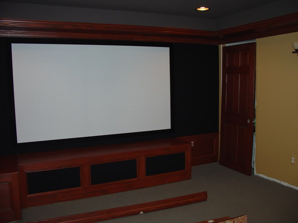

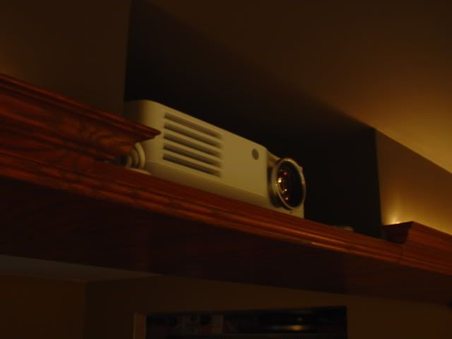

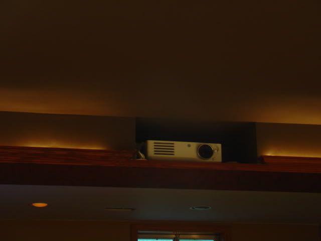

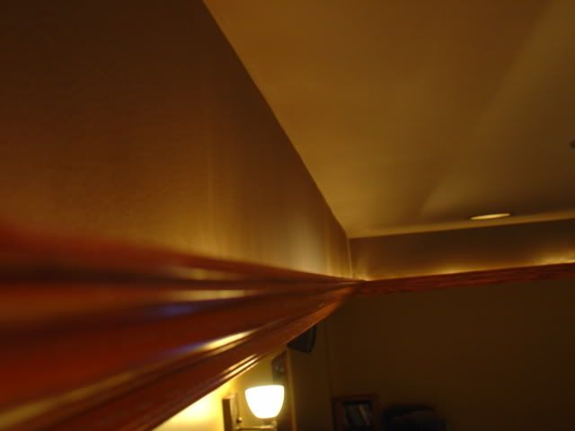

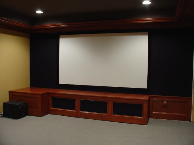

I still have some baseboards to install, a door in the front right of the screen and casing around my av rack...then its considered complete! But I am taking a break as I have been steady on this for about 3 months..

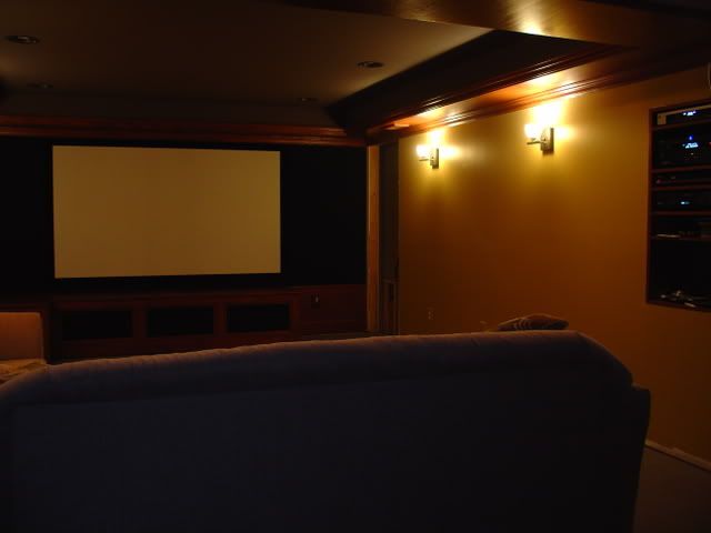

I took these in various lighting settings. The camera, does not do the actual colors justice.
and with the rope lights on
A shot from the side to show the AV Rack
and another angle

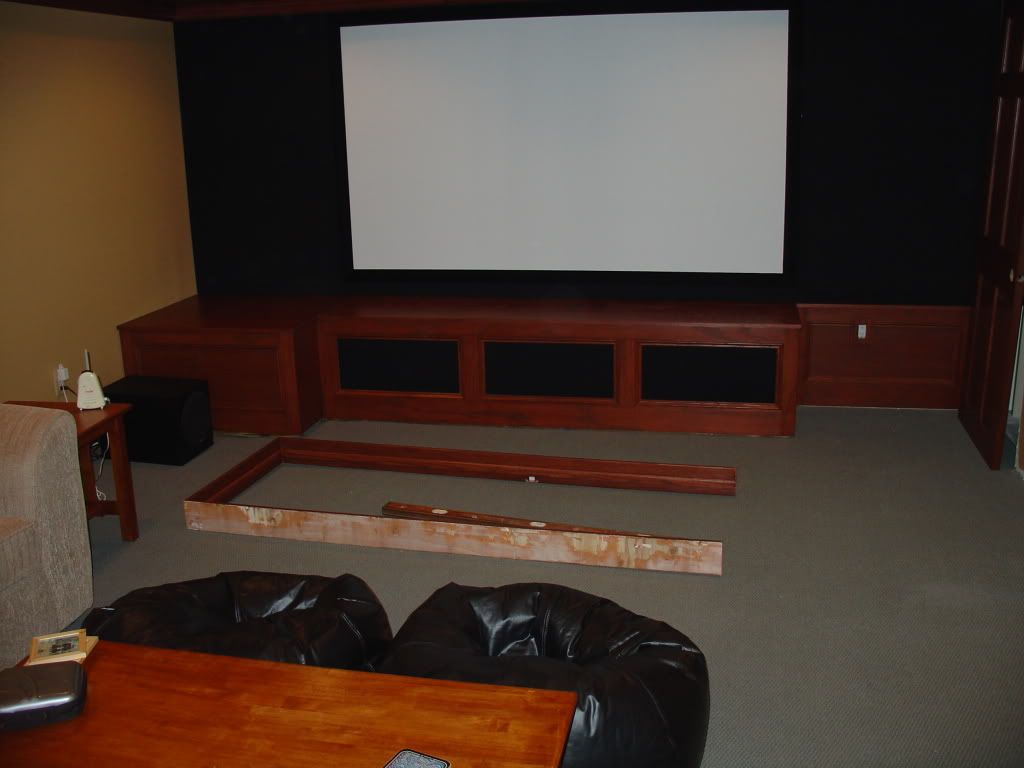

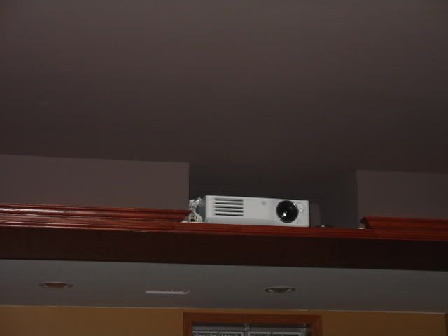

The projector box
the soffit lighting
kezug is offline

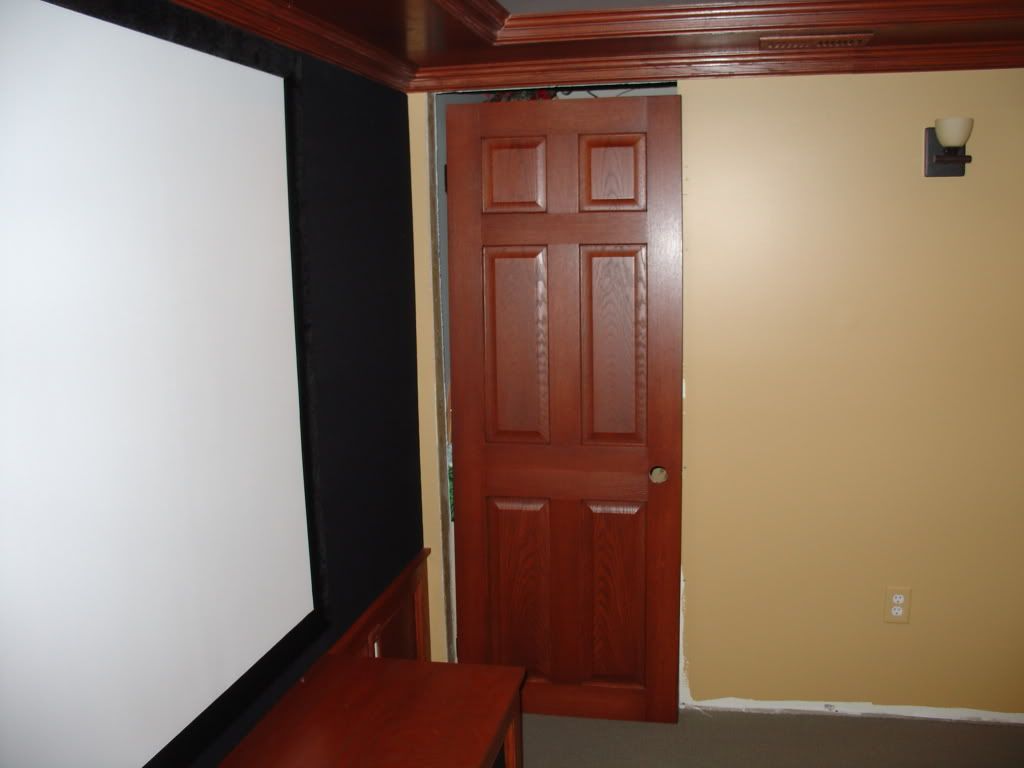

I have an update...finally, after all this time.
I finally got around to staining my door. The door turned out beautiful! I have never stained this much before, nor have I ever stained a 6 panel door either! But it turned out great.
One 2 saw horses, I worked one side at a time for stain. First, i put on my stain sealer (Minwax Stain Sealer). After about 30 minutes, I went ahead and put on my first coat. After that dried (about 4 - 6 hours) I put on another coat. However, this door was not soaking in the stain enough to make it dark and consistant with what I did for the rest of my woodwork, so I went ahead and applied (cautiously) a 3rd coat. For the first 2 coats, i had my wife helping so that I could wipe off the stain before it dried, but for the 3rd I was on my own. So I quickly applied the stain on the entire door, and carefully wiped off the stain in the same order as I applied. It ended up matching perfectly with everthing else.
Here are the results:

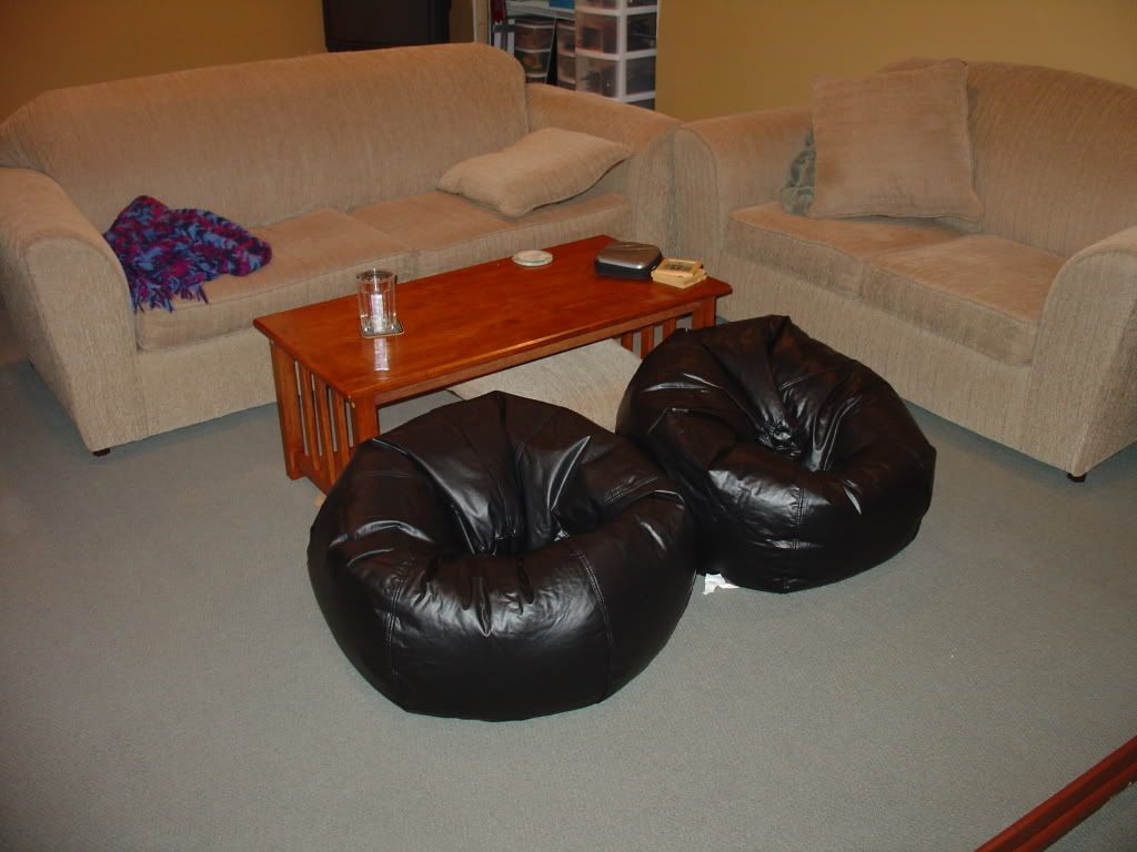

My wife also picked up some front row overflow seating...cheap, simple, and completely effective. Also, the kids love them.
