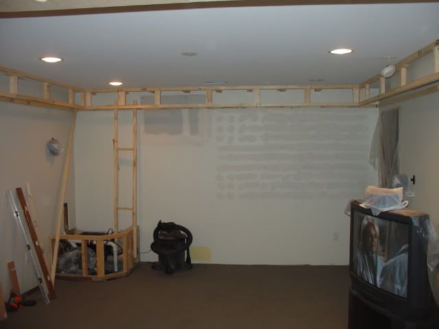

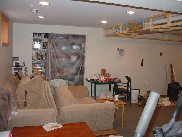

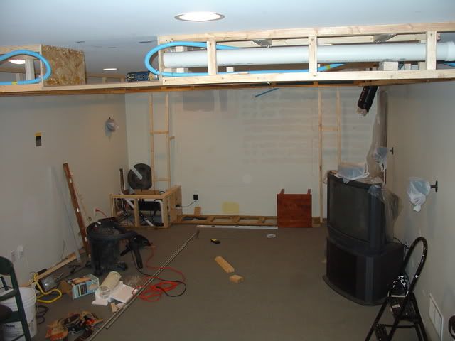

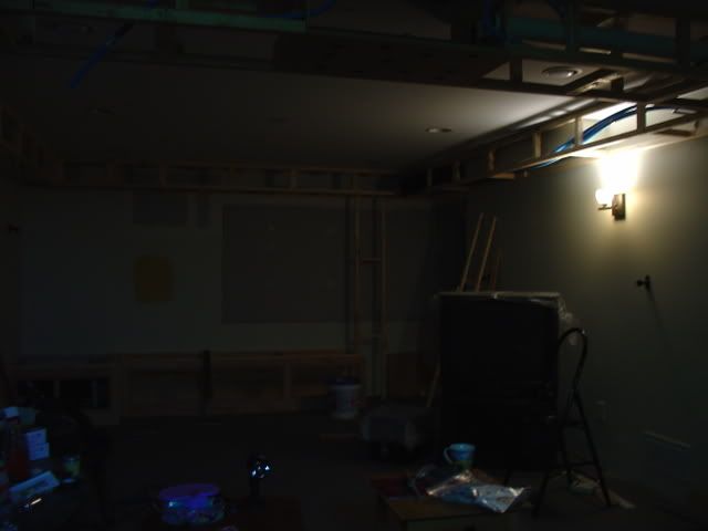

This is the room I have so far.
Here is my room. Pic is taken from about 16' back under the back Soffit.
NOTE: Those are just temporary mockups for columns to get a visual for size and placement.
Here is a pic from further back, showing my back soffit and Projector carriage. When its all said and done, I will have a Vent open in the back of the Soffit for proper air flow. I am thinking this will be plenty of air flow and no need for any additional fans to prevent heat buildup.

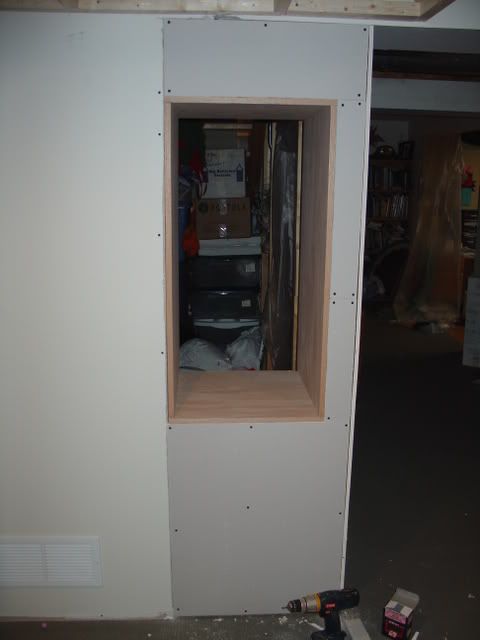

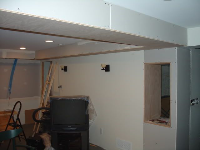

Turning to the right, you will see an opening in the corner where my AV Rack is to be installed.
The right side of the screen wall has a rough opening to a bathroom. Not the best placement, but I have to work with the room I have.
And here is my ugly fugly sump! I have no idea why the builder decided to put this here! I wish he would have put it in the utility room or in another corner but of all places, its here. I will try and work this into the design of my front wall, as you will see in the following post.
Back of the room. Which will be open for a poker table.

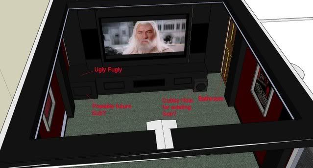

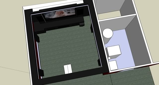

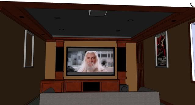

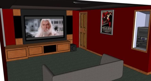

Now, of all the years lurking, I should have a design down by now, but I dont have anything concrete!
I have done some SketchUp and am shooting for something like this.
As you can see, I am going to bring out the front wall with "columns" to house my existing speakers, but with intention to allow for easy modification for some bigger speakers!
Perhaps a built in DIY Subwoofer in the "box" that hides that ugly fugly sump pit.

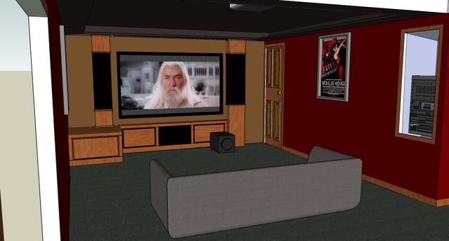

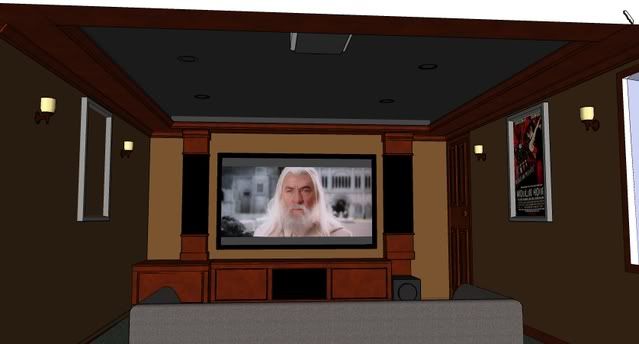

One of the big box stores has a sale on interior doors that I am going to take advantage of. I think one of the brands is Mastercraft. I have never inspected this brand and if they are decent, I will pick some up. I actually have 5 doors (1 single door and then 4 bifold doors for other parts of the basement - 2 closets, 1 utility room and 1 office)
However, I am still unsure if I should go with stain or painted or a mixture of both.
I am also looking for input on my design, layout and other questions above as well.
Here is another shot of my intended design
kezug is offline

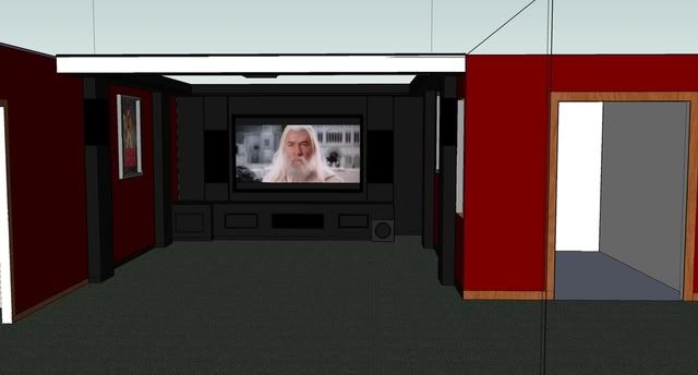

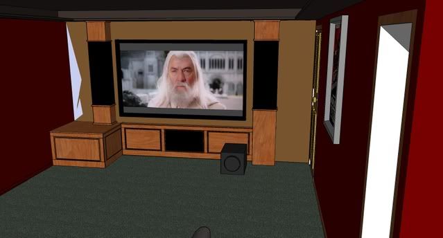

I really need some input on my front screen wall.
What is the impression this design gives off? I really need some input as I have been "stuck" in this mindset for too long and I am not sure about it and can not see past doing anything else at the moment.
Help!
NOTE: in case you didnt read above, the lower left bigger 'cabinet' is hiding the sump pump. So I thought to just incorporate it into the overall design.
Another angle

You're doing the right things. Just keep messing until you find what you want. The only person that can say which way looks best is you. If you've looked at all those peoples setups you should have seen an example of both ways. One with wood and one with nothing but black.
Buffbakers screen wall is a good example of wood up front vs all black. Even though it's not gonna be like yours it at least give you an all around feeling of wood up front. And I'm sure you can fine plenty of examples of all black front screenwall setups.
Looks good so far, look forward to following your process

If it were me, I'd lose as much of the front cabinetry as possible. The center channel most likely isn't meant to be enclosed and it severely limits sub placement.
As for the walls, if you want good performance and save some money, just paint the walls and use visible treatment panels. That will save you a considerable amount without really impacting performance.
Bryan

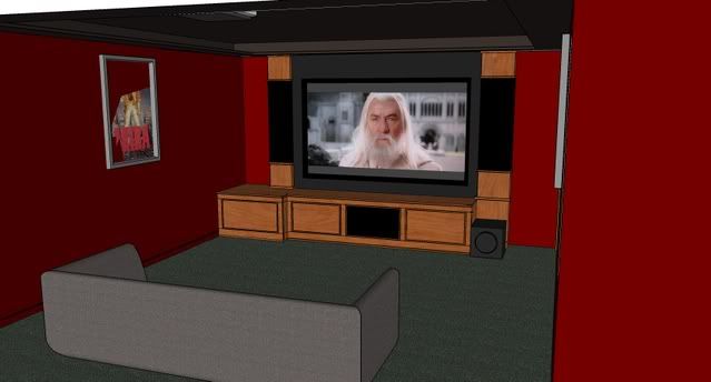

Bryan, thanks for the input. I am fully aware that I should do many things different, especially for sound treatment and I will try and incorporate some items such as treatment panels on the side walls, but to your point, yes, those cabinets are not the most ideal, just trying to make the most of my 'lemons'
So, to Bryan's point...I could go something like this...it removes the big cabinet space, and allows movement of my sub, but keeps the aesthetics I was shooting for. Althought I will have to get an inwall center channel.

You could put the center across the top and enclose the sub somewhere across the bottom leaving more room for your door. You said something about building a diy sub so you could build it into the bottom across the center trying to make it look/resemble more like what the left side housing looks like.
You could move your "center" of the screen wall left and have the left column sit up against the wall over the sump pump increasing the size of your screen a little and making it possible to make more of a duplicate box on the right, that might hold a sub, leaves room for the door opening, and looks just like your sump pump box on the left.
I've seen others that have done this but I've seen others that told them their accoustics would be messed up if it wasn't centered.

Well, I have given it some thought and the fact that my room is only 13' wide, makes for a really "up against the wall feel" if I go off center. I am set on staying on center as well as going with the cabinet build.

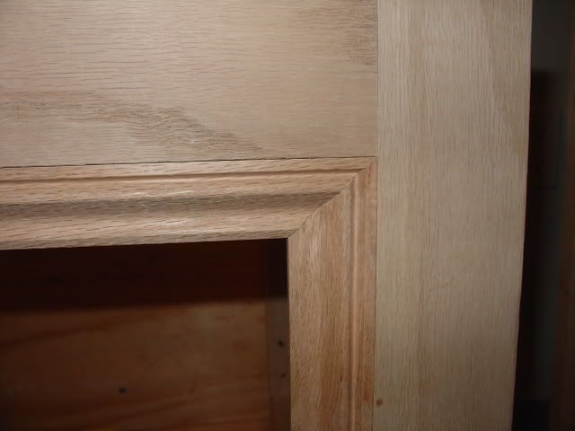

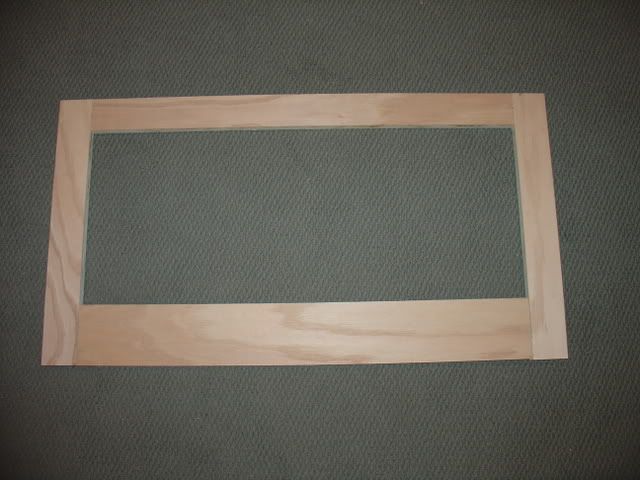

I have decided to go ahead with this design with understanding that its not the most ideal in terms of sound/speaker placement. But to hide that sump with a big ol' box to the left and nothing else just didnt quite seem to work for me, so I decided to incorporate it all.
Since I am building this cabinetry, I am open to suggestions about making it more ideal in terms of sound treatment. Immediately I will be putting my center channel in that center cubby. A sub may someday also get incorporated...
Some questions
- make a 2x4 base, on edge and fill with sand?
- leave the back of the cabinet open and put some acoustical batting?
- as for the clothe to put in front of the center speaker, can I get this at Joanns? Or should I get GOM? Anyone have some black GOM, from my design, I dont need that much for my center and fronts.
- is there anything else I should be doing with this cabinetry to provide for better sound treatment (other than getting rid of it )

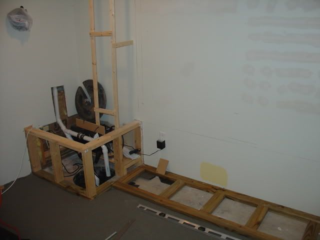

While I konw most here would not recommend what I am doing with this cabinetry for my front wall, I hope I can still get some feedback on items such as this.
Forward thinking for the future, I am going to make the left and right side of the bottom cabinetry a place for some subs (if you look at the picture above, you will see the center speaker cloth...I would put the subs to the left and right of the center (using cloth as well instead of what you see in the pic)). So, as I build this now, I am thinking of lining the bottom face frame you see below with plastic garbage bags, filling with play sand, then putting 1/2 ply+3/4" ply on top of that.
Is it worth putting this sand in such little cavity?
Should i just put in some insulation? If so, with plastic on concrete before i put in the insulation?
Or do nothing, because its just not going to benifit me in anyway?

In the meantime, I am debating adding additional lighting to my already existing 6 cans in the ceiling. I am considering adding sconces on the sides or recessed lighting under the soffits.
Which do you think looks best?
Arent these mostly off during movies anyway?
Recessed under soffits
Sconces instead

I have been busy building the panel/frames for my front cabinet. I really like how these are turning out. Plus, I found some really good moulding from a Moulding outlet store (for those in Indiana, go to www.houseoffara.com, they even have a moulding outlet/surplus store!) I couldnt find this moulding at the big box stores.
Basically, I built the frames using 3/4" oak plywood and connected using a biscuit joiner.
Here is a dry fit assembly
Trimmed out with moulding
Dry Fit for the cabinet
I also built the base frame for my AV Rack. This is about 19" wide (interior) and about 20" deep
I am now considering recessing a shelf below this rack for DVDs.

I say sconces on columns that match you front columns
Thats just the look that I went with but I've seen others that looked great with just sconces.
I like some kind of sconce look in the theater. Just think it gives it more of a theater area look.
I thought about doing that, but then, with the crown molding underneath, I will have to deal with boxing the crown around them and I wouldnt want them to be too deep anyway since my room is only 13' wide.

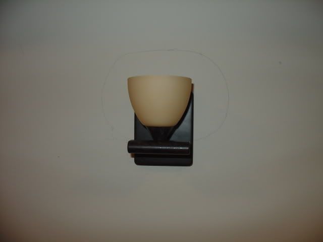

I found this sconce at Menards for around 20.00. I like the look of these and will probably use these for starters.
Here is one mounted as I wanted to get a feel for light and location. Its mounted roughly at 68" from the floor.
I will have these on a dimmer when all is said and done.
Shutter Speed adjusted for effect to show what the room would look like with the light dimmed about 1/2 way.

While it doesnt look like much, it is progress.
I have the drywall completed with a good start on mudding/taping.
I have also cut the 1/2 oak plywood panels for the undersides of the soffit. (this is just a dry fit as I will take them down to sand/stain/sand/stain/sand/poly/sand and poly)
