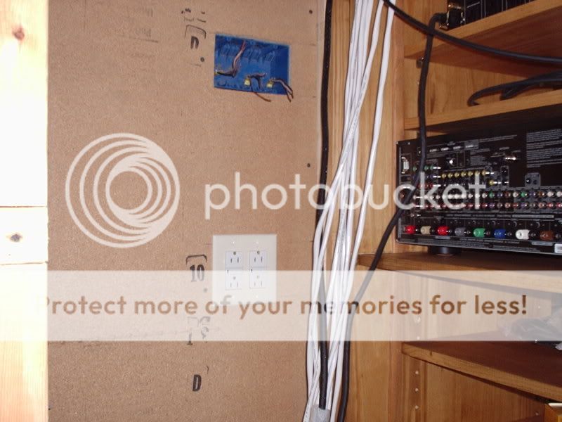

3 new 20a circuits for Equipment room, Kitchen area, HT lighting

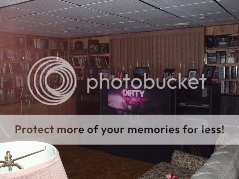

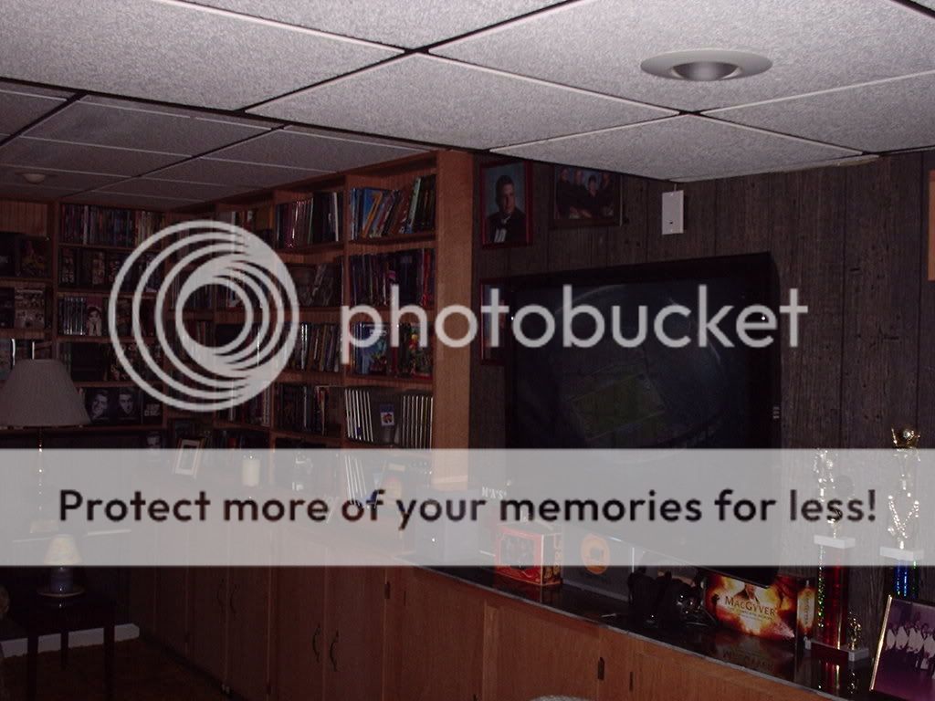

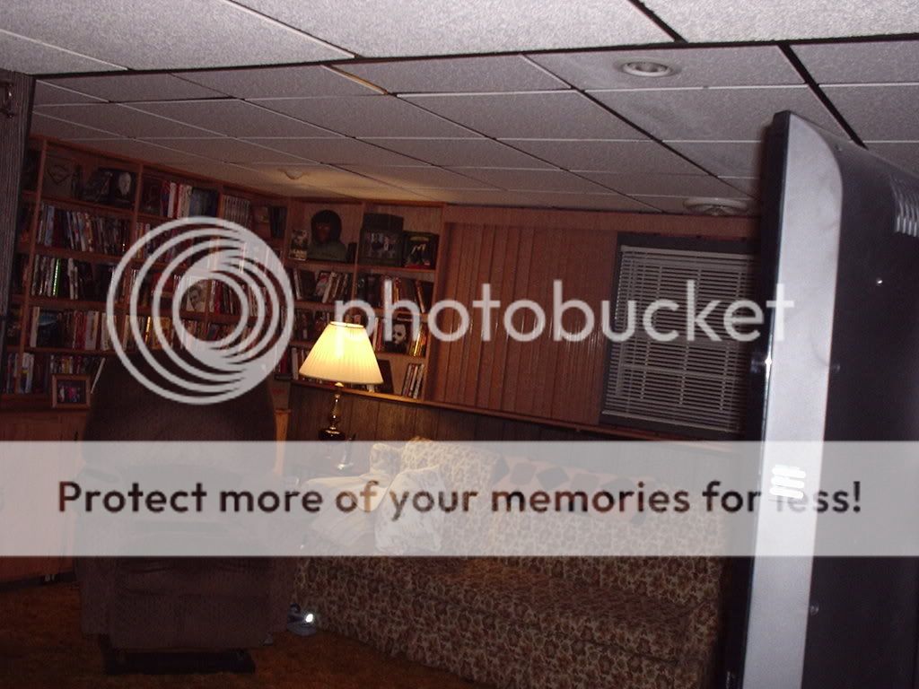

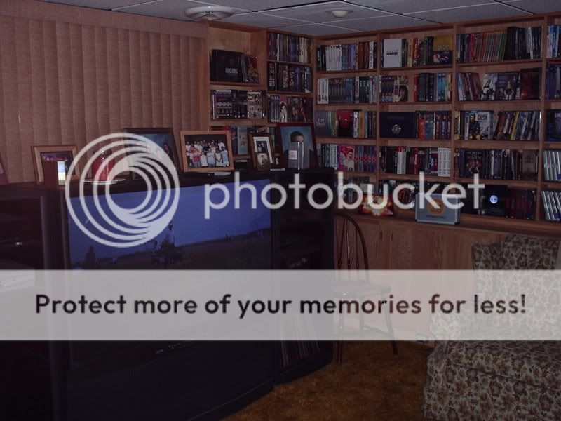

My Current Media with 2000 plus DVD collection and Mits 55 HDTV which will be replaced with a 42" Samsumg 1080p 120HZ LCD in the near future
wdaub1 is offline

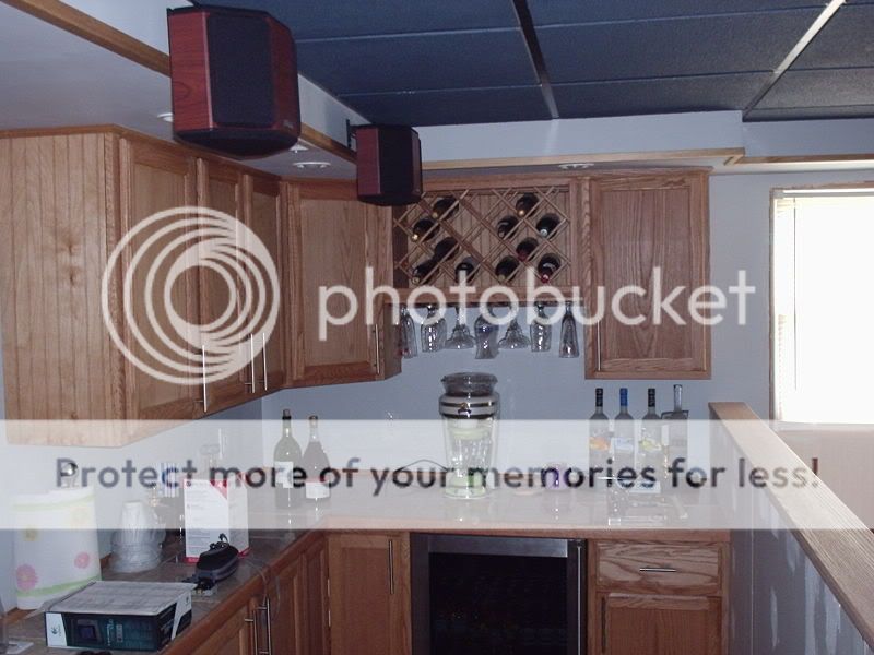

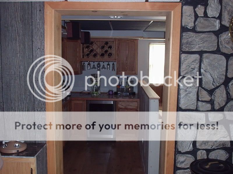

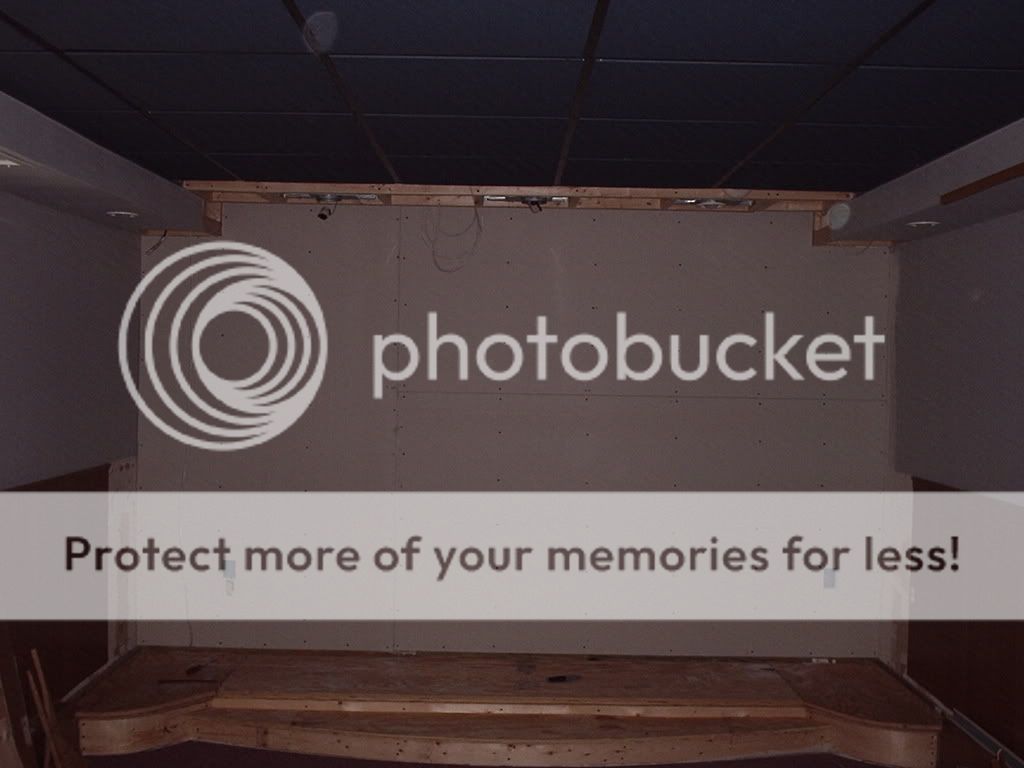

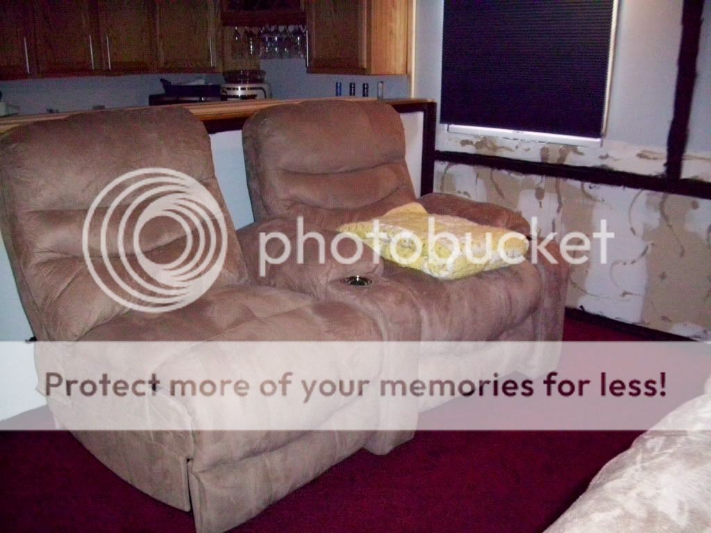

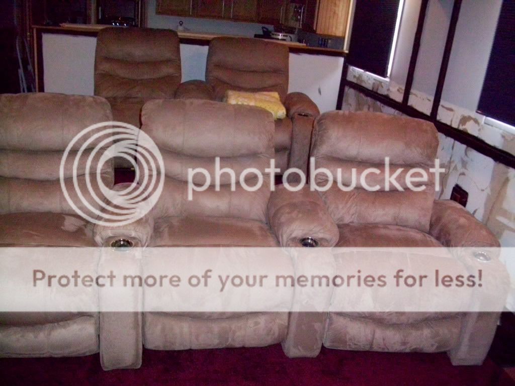

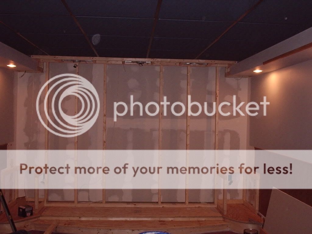

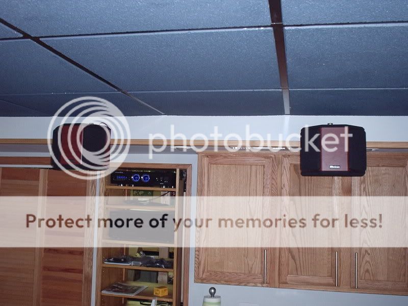

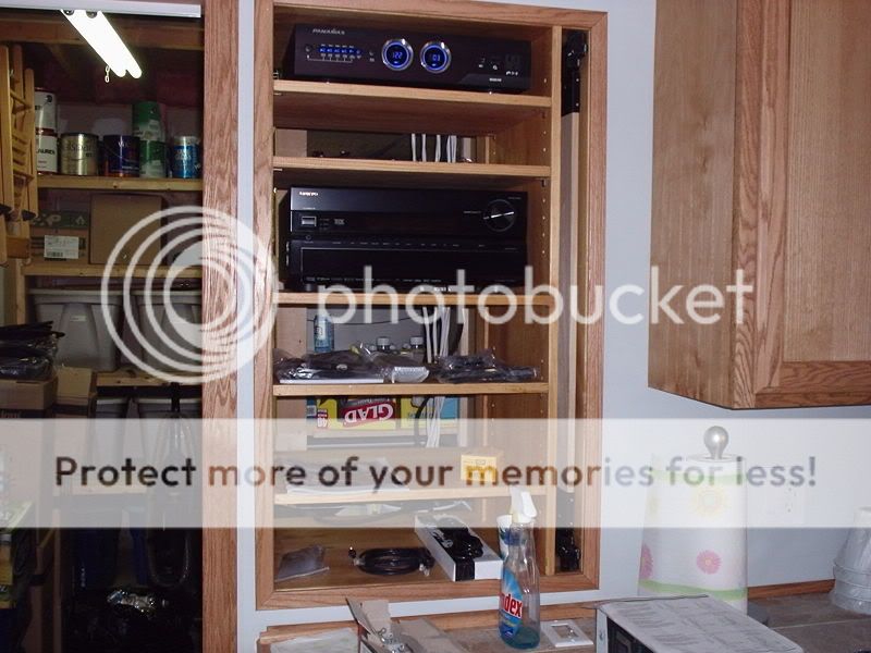

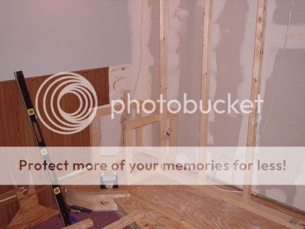

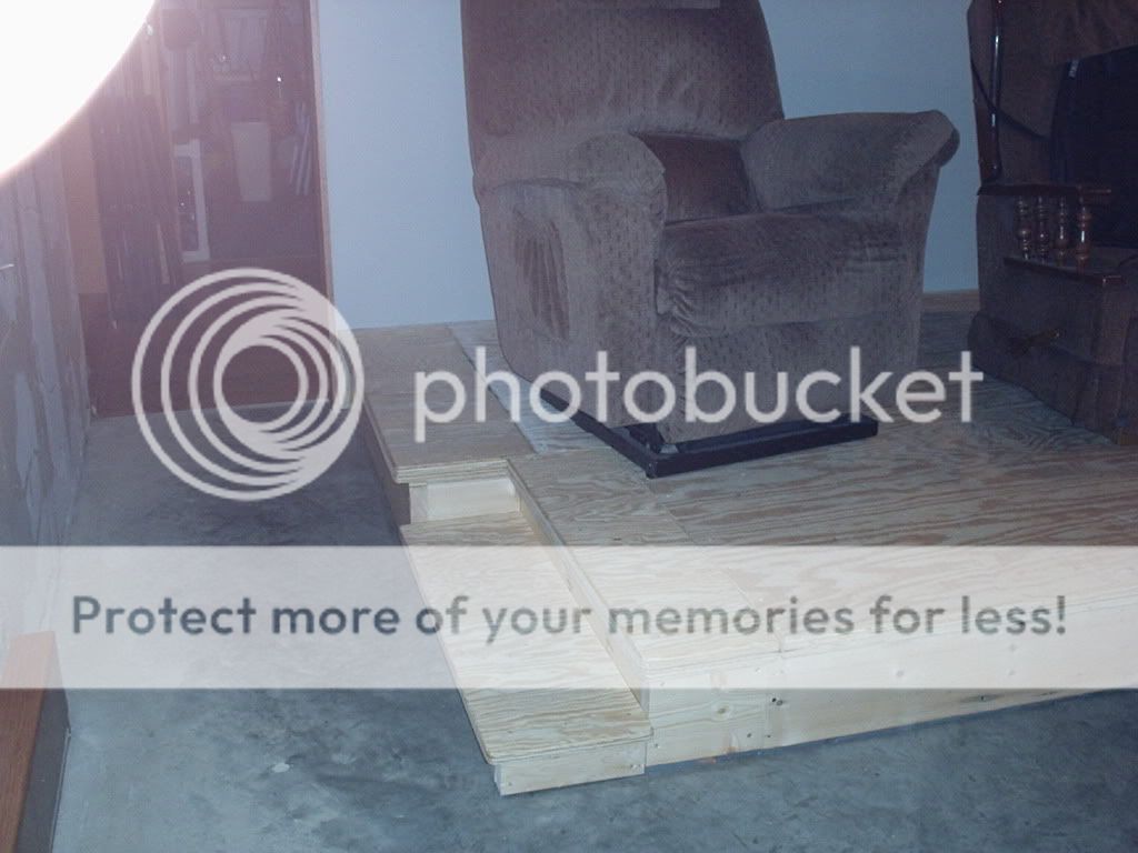

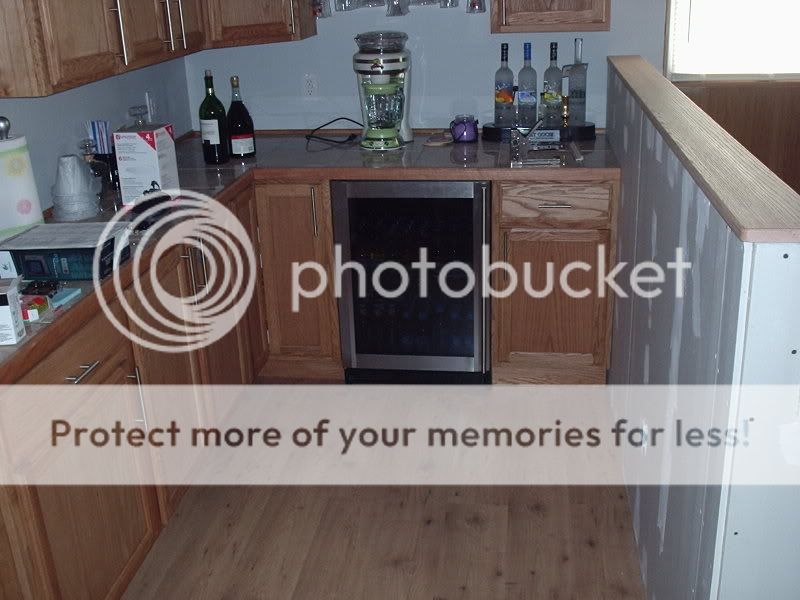

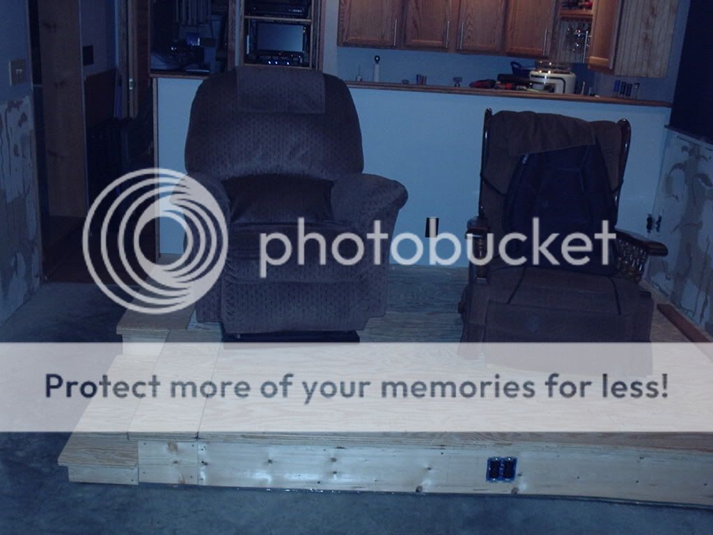

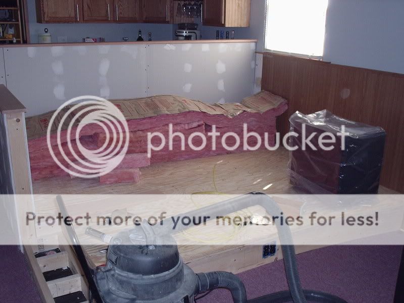

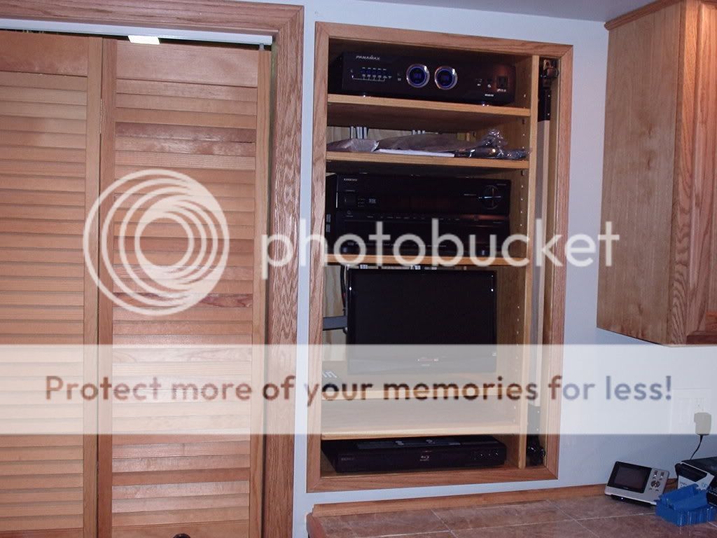

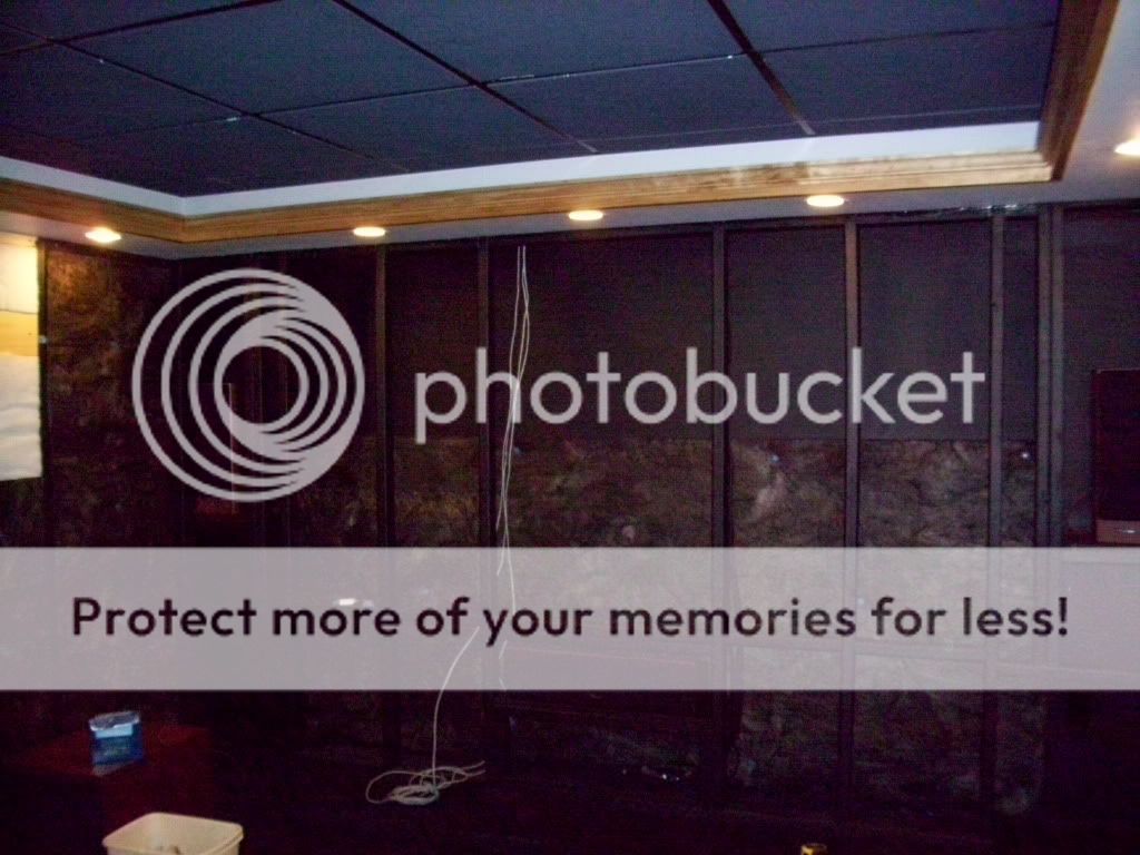

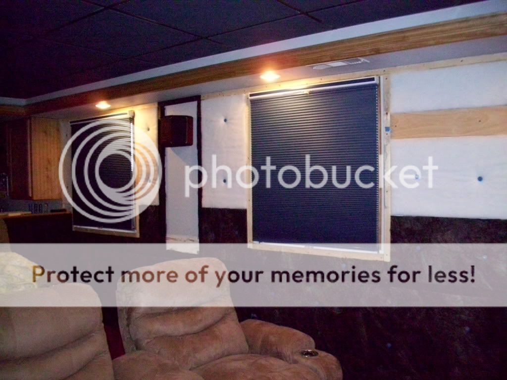

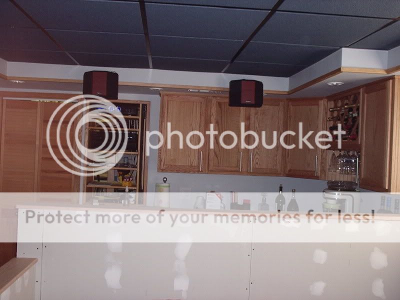

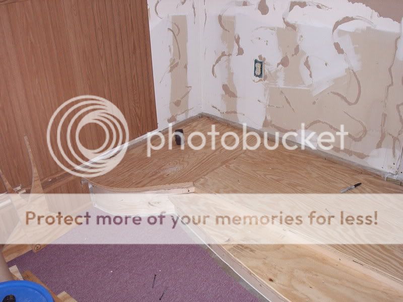

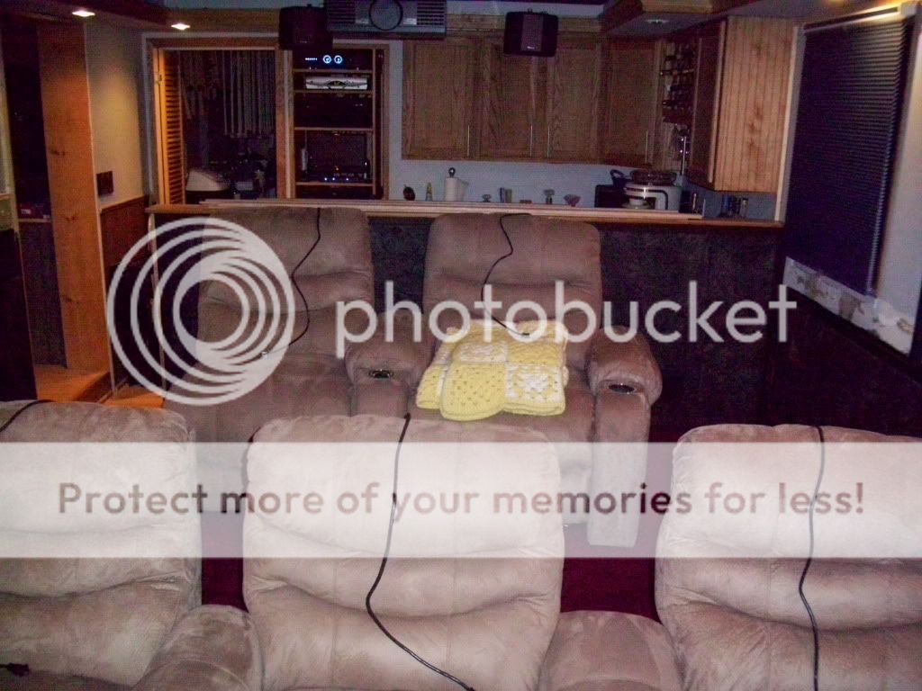

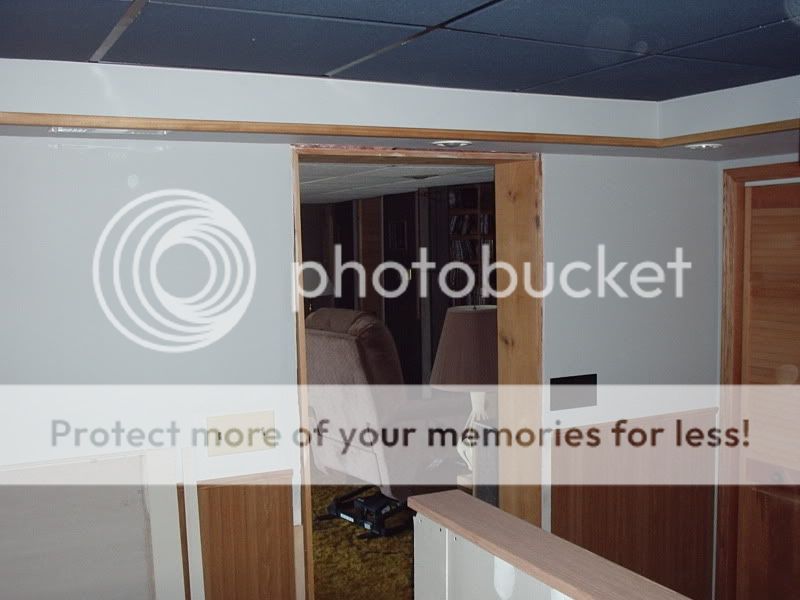

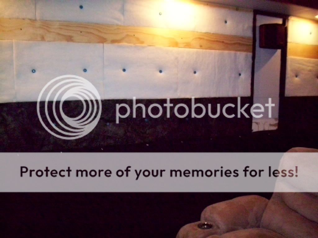

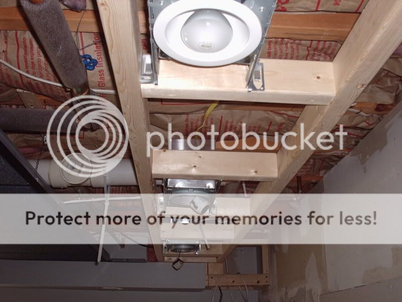

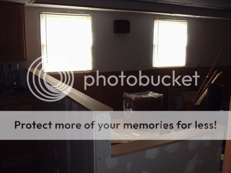

Now that I can upload pics here is some of my progress up to this point over the last 3 month I will post more on regular basis.
Next work is to finish the Screen wall with a second layer of Rock and 1" linacoustic.
Stay tuned and any Help or Suggestions is welcomed
Will Get solid wood door
Just need to grout the granite tile
A little molding and possible tile back splash to follow
Awaiting the rest of the equiptment to be installed
Cable management to follow

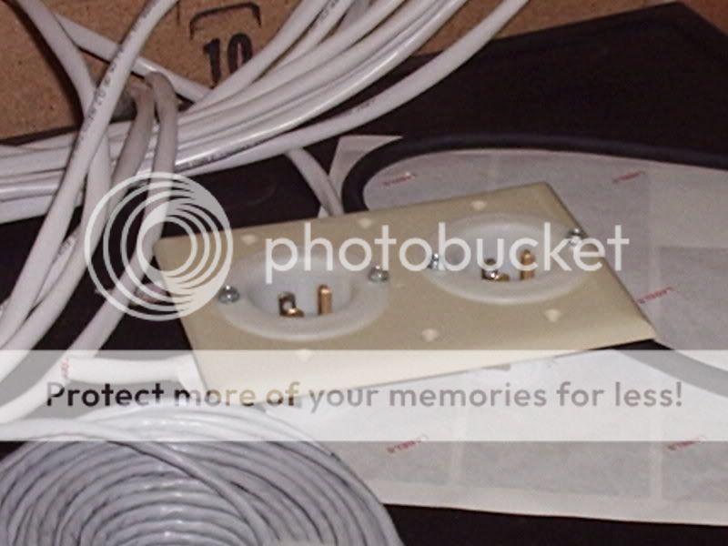

Need to install powerbridge for subs and projector Epsom 1080UB or Sanyo Z2000
Tough room for speaker placement and hoping I have them in the best areas knowing how forgiving the Axioms are
10" when carpet and pad are installed and should be plenty of room for the 3 Berkline 088's for the rear row
Still to get 1" linacoustic sound treatment if needed?
Soffit loaded with R-19 insulation
Grafix eye 3104 to replace temp dimmers on left for soffit ,Blue rope lighting,stage 4" cans and drop lights over riser wall
Windows to receive double cell blackout blinds to control light
Soffits to get crown to house the blue rope lighting
Still need to build speeker/sub enclousers to be covered with GOM
Sub to go on this right side

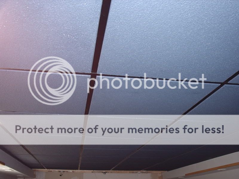

Drop ceiling painted with Valspar Night View. Could not sheet rock due to location of plumbing from 2nd floor master bath
Awaiting decision on screen wall to complete stage lighting
Now working on second layer of sheetrock for screen wall. Undecided as to whether I should put 114" Carada screen on wall and bulid a 10" box around it or just build a false screen wall 10" from back to have a flat look wall to wall
wdaub1 is offline

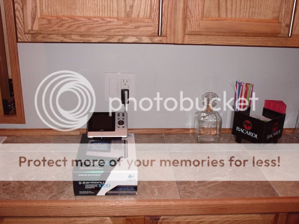

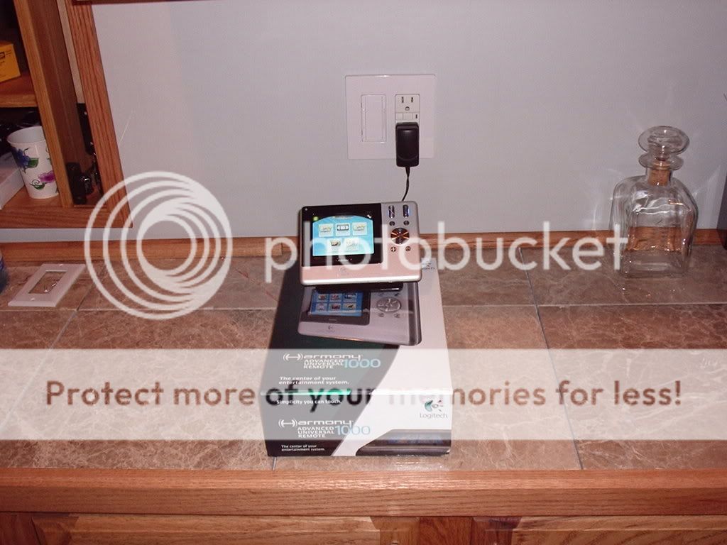

Could not resist this remote at $229. so I pulled the string. Still need to get the RF extender.
Could not resist at a bargin price even with it's weakneses
Needed something the wife could use

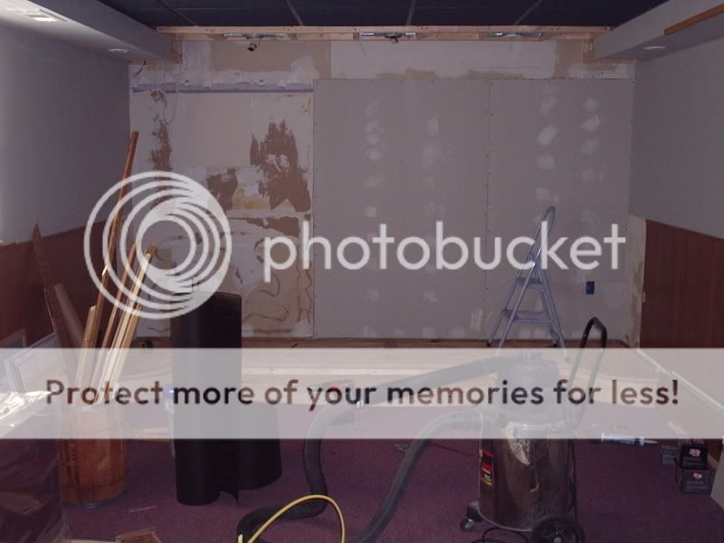

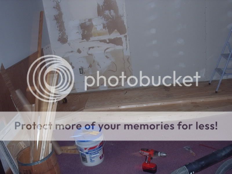

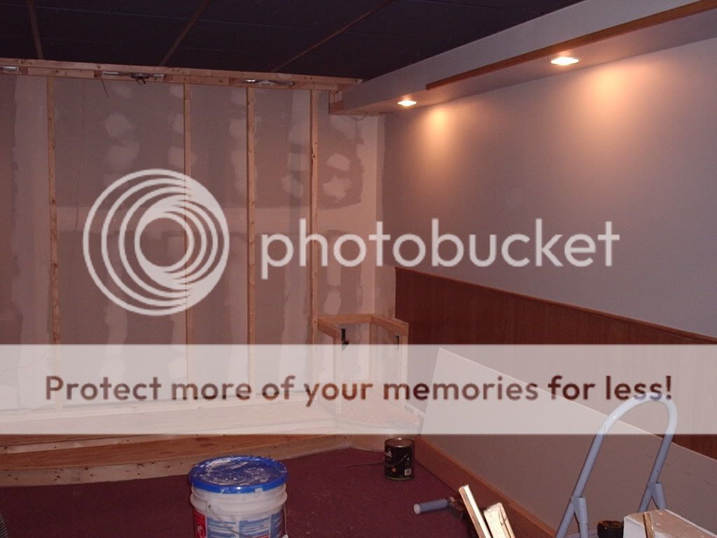

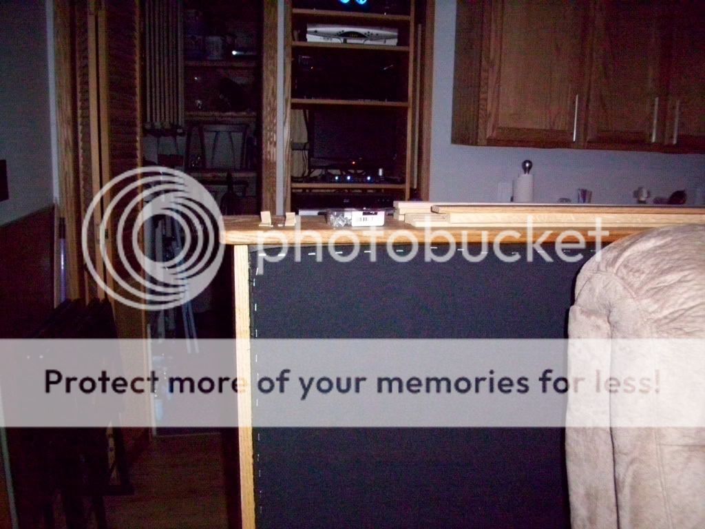

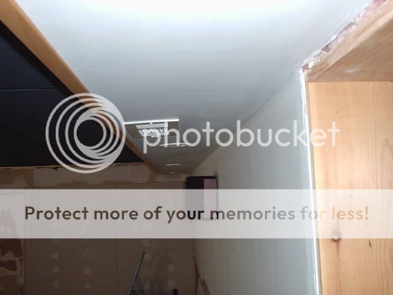

I just finished with a second layer of sheet rock on the screen wall and will be picking up a 50' roll of 1" Linacoustic on Monday.
Floor to soffit is 6'10"
Floor to ceiling is 7"5"
109" between the Soffits
138" Wall to Wall
The distance from the present Screen Wall to the back of the riser is 17'3"
I am thinking of putting a false screen wall 10" out from the present one so my speakers can be flush with the screen. Looking to use a 114" Carada BW screen but also thinking SMX but have budget concerns
Carada Frame for 114" (55.9"x99") is 60"x103.5
Looking for some ideas as I am at a stand still and can't make up my mind on what would both look and preform the best in my situation.

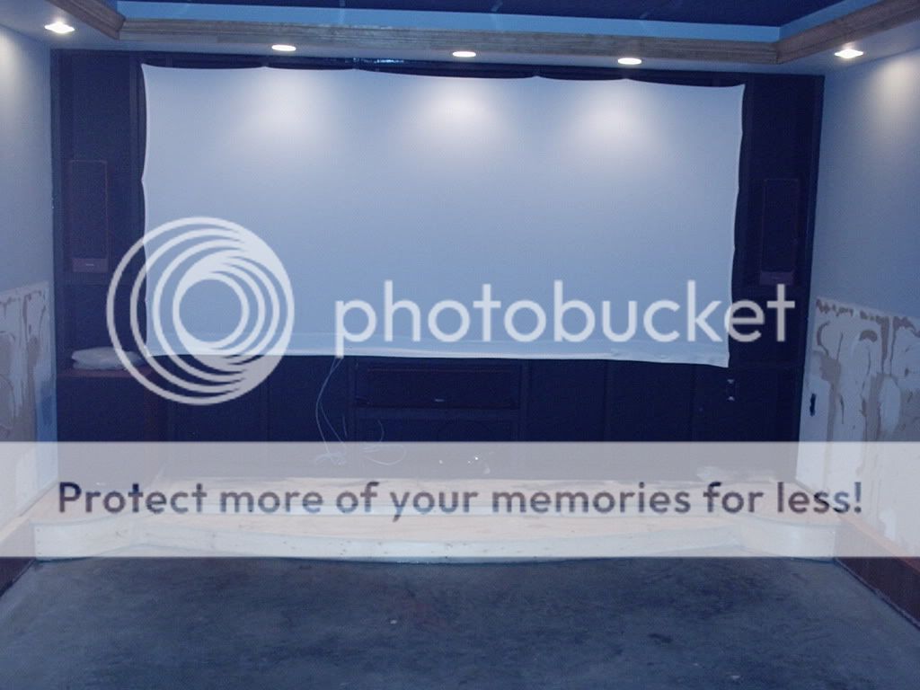

Was hoping to get some imput from the forum but I guess my build is just not that interesting as there have been no replies/suggestions since I started to post pics.

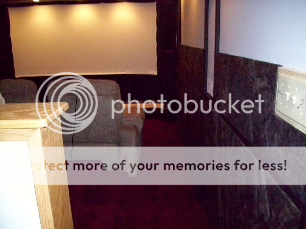

Decided to build the Wall out 10" from the existing wall for a seamless look and now need to build the speaker shelves.
Will cover with Black GOM and add 114" Carada Screen Since I have low ceilings the AxiomVP150 will go under the screen angled up
This is where my AxiomEP350 v3 sub will go
Use the alternate sub area for housing the XBox360,PS3 and Wii unless I decide to go with a second sub

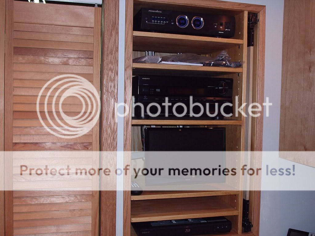

Just finished adding my new Sony S350 BluRay player and 16" ViewSonic monitor to my equiptment rack. Haven't done much work on HT as waiting for my outside work load to end with the end of Fall season. Still have not even tested my Receiver and Speakers yet.
Hope to see the prices fall on 1080P projectors now after the Cedia show is over.
New ViewSonic 16" monitor
New Sony S350 BD player
wdaub1 is offline

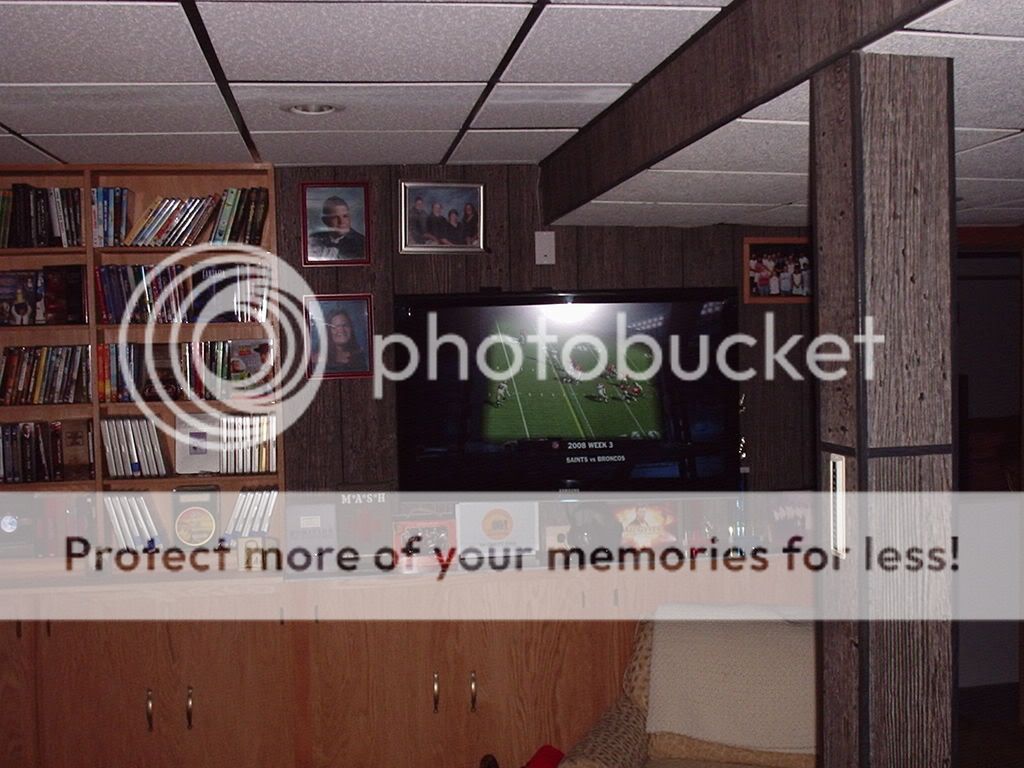

Now that the summers over I guess I can start working on the HT again
Got a New Samnsung LN46A550 to replace the big old 55" Mits which gives us a lot more room in the Family Room

Did you use a spray paint for painting the drop ceiling? Also, which style of ceiling tile did you choose?

Nothing special on the tiles just standard at HD. Just used a heavy nap roller for the painting and it worked out fine. Was going to spray them but would have needed to thin the paint.

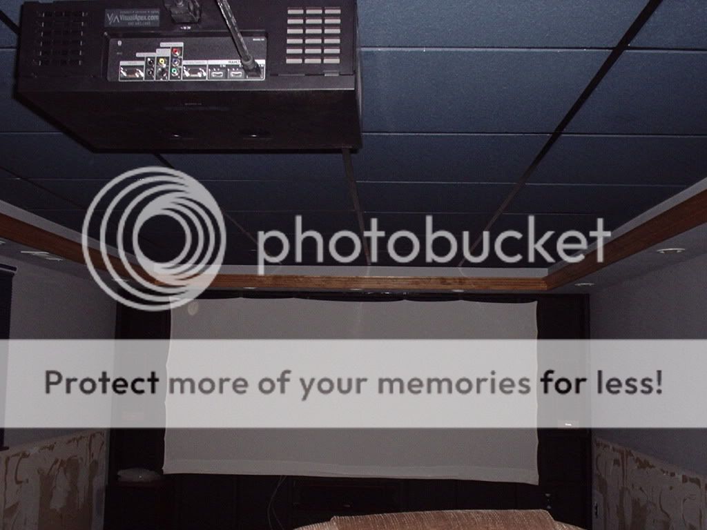

Finally have a projector on order Have pre-ordered the new Panasonic AE-4000
from Visual Apex Hope to have it early November.
Now have to decide on Screen size and scope. Thinking I will go 2.35.1 Will decide on size after I receive it and have a chance to test it out at various sizes.

How do you like the harmony remote? Is it reasonably easy to use?
Greg
I have been using it in my family room controlling a Samsung TV,Sony B-350,SA8300 and 4x2 matrix switcher with very good results after tweeking it. Can't beat if for the price.

Getting some more done on my first HT Just ordered 6 Berklines from Roman and also the carpet. Here are some updated photos
Temporary sheet used to check for screen size
Redesigned riser to allow for 2 rows of 3 Berkline 45033's
Blue rope lighting complete
Riser awaiting new carpet soon
Panasonic AE 4000 mounted for screen size and mode testing

Finally have some time to post a few updates. Carpet complete but not happy with the quality of the Black carpet on the stage. I guess that is what happens when you leave it in the hands of the carpet guy to pick out the best value and quality in his opinion.
Also finally got my six Berkline 45033 power recliners with lighted cupholder and base rails. Everythin was great untill I oppened the last chair to find the frame had been snapped in half on it and the touch portion of the cup holder did not work. Also after setting up had one chair where the transformer on the power recline did not work. After looking all the chairs over more carefully found another chair where one of the support blocks was cut about 3/4" short and was not attached in the corner. Received them on 2/29 and still working with Roman to get them fixed. First batch of parts was incorrect so getting a little upset now. They are real comfortable but having looked the over so closelly found their workmanship lacking.
Stage carpeted waiting for Sonic XP Duct Liner
Riser carpeted with first two chairs set up
Five of six chairs set up Sixth arrived damaged
Black Dazian Janus on wall behind riser
Side wall with Knauf Sonic XP and polyester batting applied
Side wall ready for Janus fabric
Screen wall getting sound treatment
Berkline 45033 from Roman
Chairs and side wall prepared for Black & Burgandy Janus
[urlIMG]http://i351.photobucket.com/albums/q470/wdaub1/Home%20Theater/100_1757.jpg[/IMG]
Entry isle with new carpet
wdaub1 is offline
