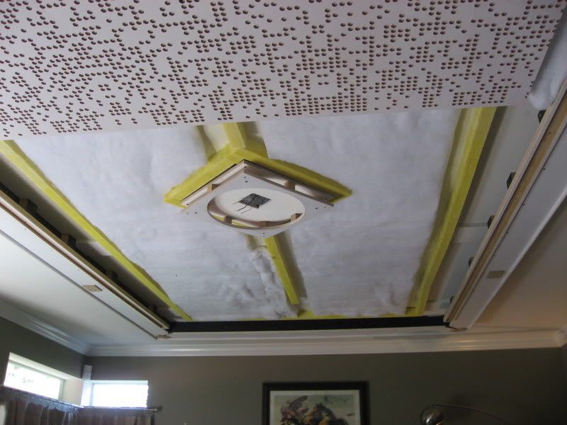

Here's the framework for the "acoustic cloud":

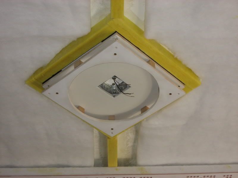

In the previous pics you'll notice that I had recessed lighting. I was going to just have the lights dropped down through the cloud, but the installer said that they had done some cool looking clouds that had a recess built in for track lighting. Thinking about it, this seemed like a good way to put some spotlighting on the art in the room. So, in place of the can lights that were in the ceiling before, there will be two recessed channels for track lighting in the acoustic cloud.
To make this happen, I did some rewiring up in the attic and covered the holes for the can lights to keep insulation from coming through.

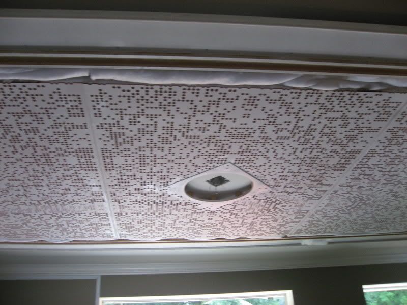

The goal of the acoustician was to make the acoustics of my room "drier" without making the room sound dead. To accomplish this, he chose RPG Acoustics "BAD Panels" to be placed in the center of the acoustic cloud.
From the RPG website: The BAD Panel, or Binary Amplitude Diffsorbor is a flat, zero depth "diffusing absorber". A BAD™ Panel simultaneously provides uniform sound diffusion at high and mid band frequencies and crosses over to pure absorption below the diffusive cutoff. The energy that is not diffused is absorbed.

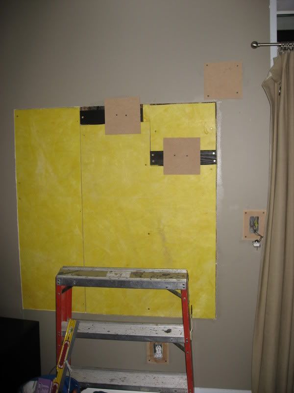

This sidewall treatment is supposed to greatly decrease the crosstalk and the destructive interference of the sound reflected off the wall and back into the right speaker.

Here's one of the BAD Panels in place and the recess for the ceiling fan. I asked them to create the recess for the fan so it wasn't lowered the full 4 inches of the depth of the cloud. It just seemed like it would be too low.
Here's a close-up of the recess for the fan.
And a couple more shots of the BAD Panels fully installed.

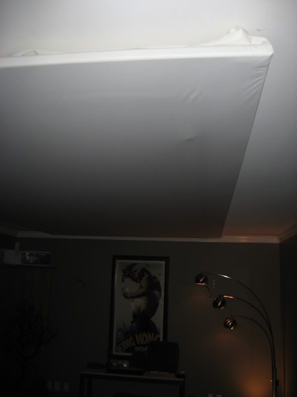

And last but not least, here is close to what the completed cloud will look like. I say close because they discovered that the fabric they chose is too sheer and you can see all of the acoustic material through it. The fabric also hasn't been stretched to perfection in this shot because they knew that they were going to have to remove it anyway.
So as you can see, the end result will probably look rather unremarkable, which is just what I wanted--something discrete.

Below are a couple of shots of the right wall treatment. The three squares of thin MDF are mounting spots for some artwork shelving that will go there. Otherwise, mounting a shelf would crush the fabric that will be stretched over this wall.

Today, things are looking much more finished, though because the acoustic cloud is so large, it's hard to get a good picture of it.
Here is my best attempt:
The installers spent most of the day re-stretching the fabric covering, going with a dark under-layer to cover the details of the acoustic paneling and the off-white over the top of that to make the cloud disappear into the ceiling.
You'll also notice that they trimmed out the recess for the ceiling fan and the two channels for the track lighting.
They had some difficulty stretching the second layer of fabric and they had to staple along the outside edge of the cloud. To cover the staples they will install molding around the outside edge. This is a bit of a strange coincidence because I was going to ask that they trim out the edge of the cloud to make it look more like an architectural detail and less like a large futon mounted to the ceiling.
Things are looking good, and sounding even better.

It looks like you enlarged the original opening in the sidewall from 32" wide to 48" wide. Was the original plan at 32"?
Did the installer remove the R13 insulation already present in the cavity or did he go over top of it with 2" OC 703?
Does your OC 703 have an odor?

Yes, that is correct. After consulting the acoustician, he thought it would be safer to increase the width of the treated area, just to make sure that no reflected sound was folding back in on the right speaker. This will also give me a bit more flexibility to position the speaker up or back to fine tune the bass response from that speaker.
The sidewall treatment is actually 1" OC with loose fiber fill behind it and then the original insulation behind that. There is no odor.

According to the acoustician, all of the choices he made were to achieve broadband absorption from 200Hz to 5KHz with some diffusion as well. He wanted to achieve a drier, more neutral sound in the room without over-deadening it. Think of the cloud as a way to improve the general sound character of the room rather that trying to address the more specific issues typically done with wall panels.
The poly fill is unusual - good eye. The original plan was to go with loose fiberglass fill behind and around the panels, but since I was going with the white fabric cover, they substituted the white poly fill so the color of the fill would not show through. I believe the reason for the loose fill behind the panels was again to offer some absorption behind the panels without overdoing it.

Did a little work myself on the cloud tonight, by installing the tracks for the track lighting and putting the fan back up.
Only 6 of the 10 light fixtures I ordered came in today, which is why all of them are at one end right now. I have to say I am already more impressed with how the cloud is integrating and even improving the look of the room. Those low voltage track lights look very slick and complement the contemporary style of the room much better than the old can lights.
There is still some work to do, as you will see below. The edge of the cloud is still unfinished.
Should have this project all wrapped up early next week. Can't wait!
