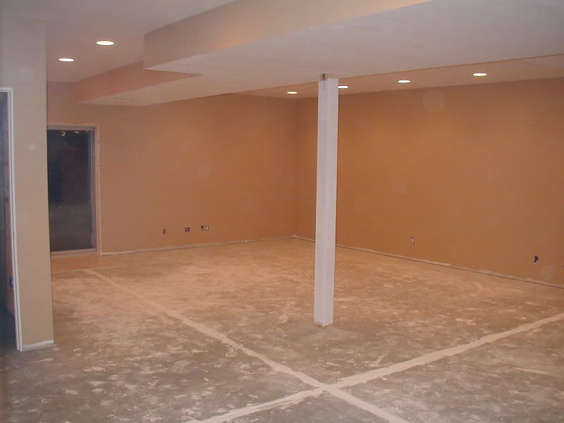

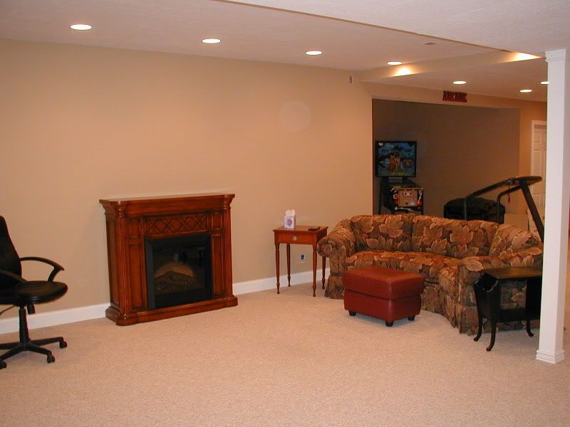

Before
After framing and electric
After drywall, and tile, ready for carpet.
Carpet in, woodwork done, fireplace installed.
I'll take pics this weekend of the finished product with the theater installed.

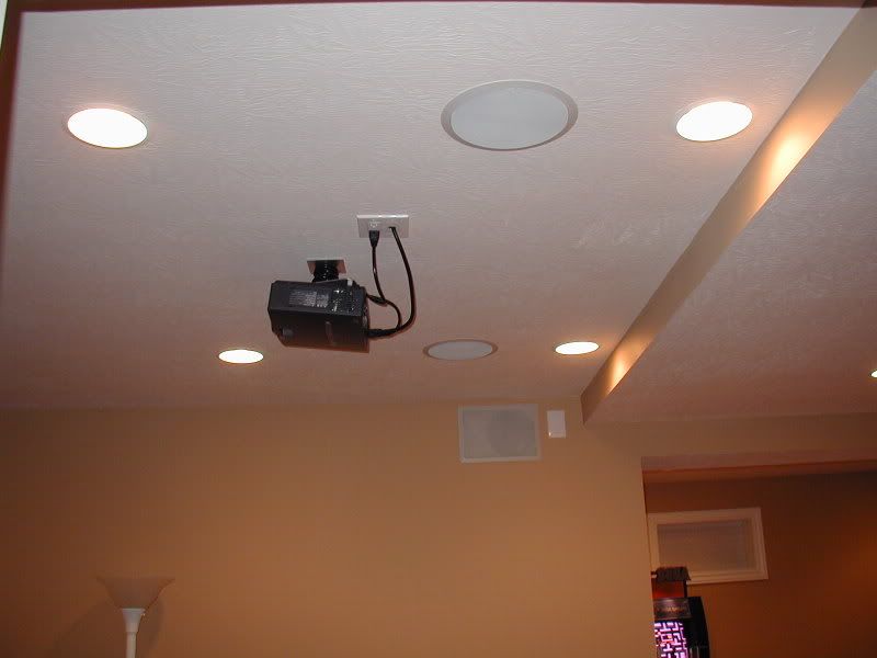

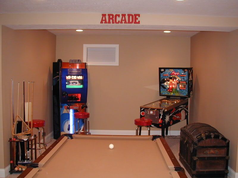

I took these last night. While I don't discount high end systems, (I used to sell barco projectors). I just was impressed that I could put in such a nice system for under $2,000. I've been grinning for weeks, I am just so amazed.
camera's don't do projectors justice.
my arcade, I have a mame computer to put in my sega stand when I get a few hours... with 4,400 video games on it.
My pinball is a 1978 williams flash, first pinball with flashing lights, and it has two sound cards, original bells, and then digital sound. I traded $50 and a table saw for it, years ago.

Any chance you could post a close-up pick of the Ikea cabinets under your screen? Do you remember the name of the cabinet?

Great basement!!! I like how you painted your in-walls black. I left mine alone (an off-white color) but I may paint them now that i've seen yours.

When I painted my speakers I used gloss black spray paint, and took out the speaker so that I didn't get paint on it. Then painted one side, waited for it to dry, and then flipped it and painted the other side, it turned out great and I didn't use the foam inserts since the speaker was black. They look like they came that way. 1 can did all three speakers. Just take your time, and make sure they are clean with no grease or marks on them, also position the tweeters before you paint, so that you don't have to move them once the paint dries.
