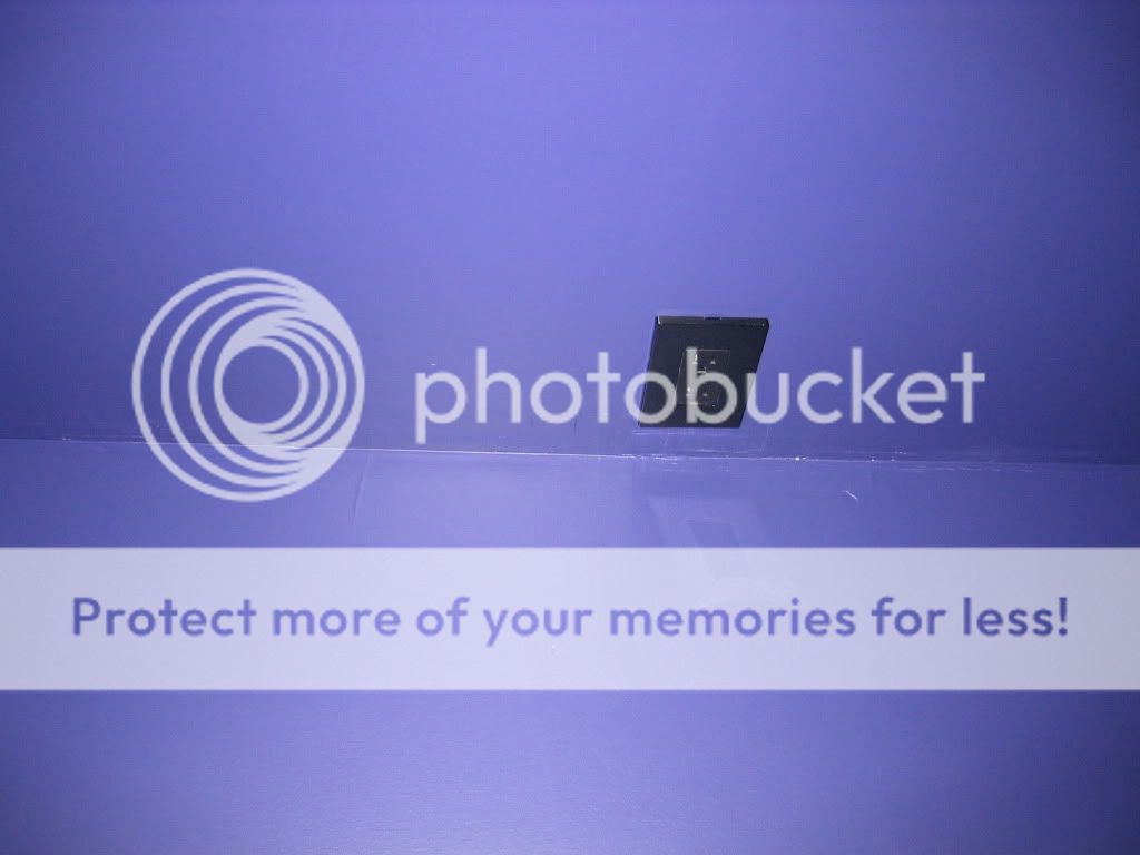

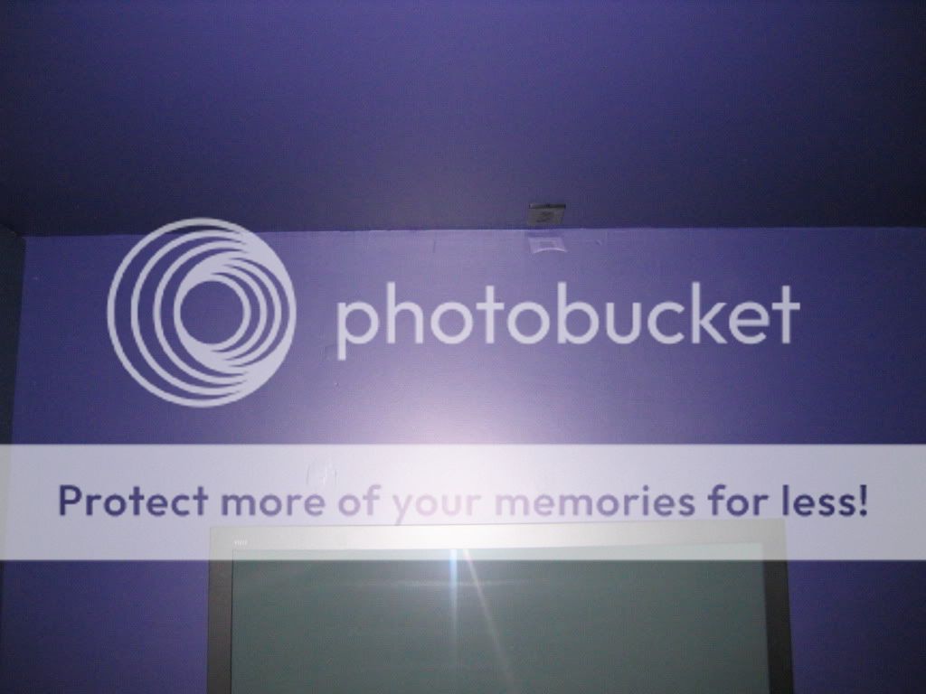

Billy search for Power Bridge.
Basically, you have an outlet in another room. The UPS plugs into it, and from the UPS, it goes to a power inlet (prongs sticking out of the wall)
that inlet goes to the outlet by your projector and the projector plugs into it.
don't worry about the prongs being exposed, there is no power in them if you can see them. You have to plug that end into the UPS to get that line powered.
This way your projector is on a UPS circuit, and the UPS device is elswhere so as not to take up room.
Michael

Thanks Chiahead. I had seen the Power Bridge metioned on AVS forum before, but I'd never really looked into it... I just ordered one! That should solve my UPS issue without needing an electirician.
I'll assume the location is OK. It seems that location of the outlet and conduit isn't a real big deal. Just lets you minimize the cabling that shows, obviously.

Location of the projector depends on your screen size, throw distance, brightness capability of the projector (lumens), ambient lighting, and your seating location. My screen will be 100", seating is at 11-12', and the projector at about 14'. Sounds like you've got it figured out, though! Good luck!

No problem Billy, and I agree with all the suggestions. I do have an outlet on the cieling behing where the screen will be. Ironic thing is I just bought a manual screen as I found a terrific deal. The other thing to consider is some framing to make mounting the screen and projector easier. Rather than hunt for studs, I chose to run some additional blocking in the areas of the ceiling mounts for the projector and screen. Finally, I chose a more local solution for surge protection, an APC wall mount power filter, check out the bargain basement price!

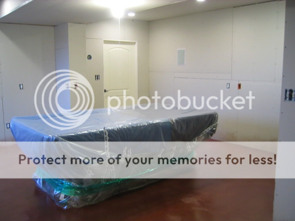

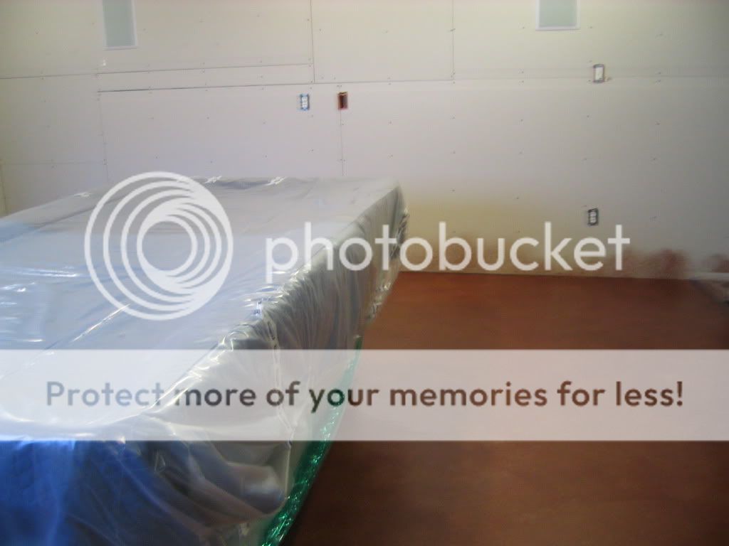

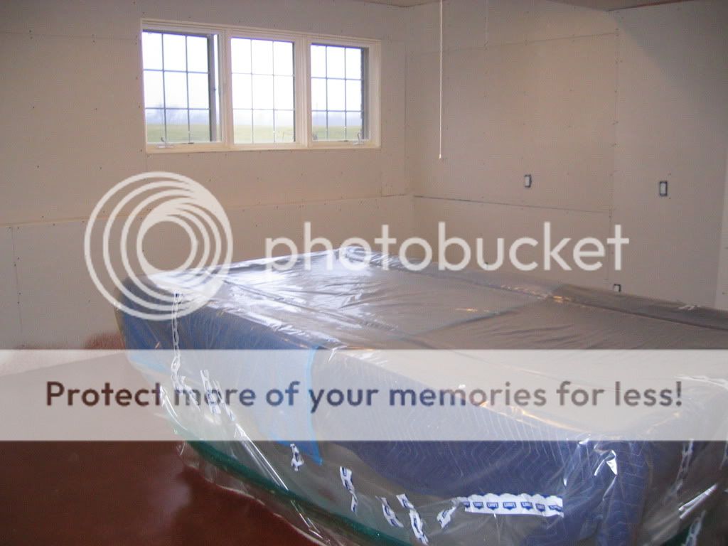

Here's some updated photos on the pool table area, just stained the floor yesterday:
More mudding and taping today, and hanging some cabinets up.

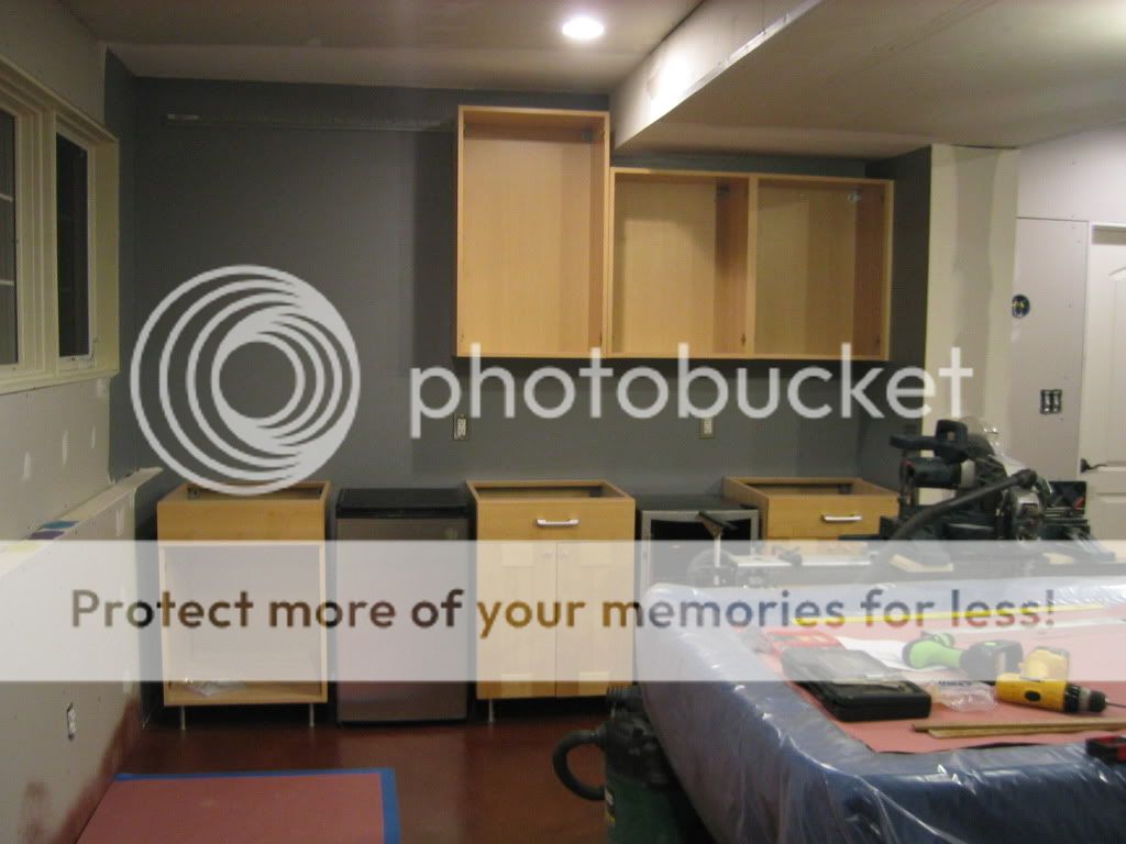

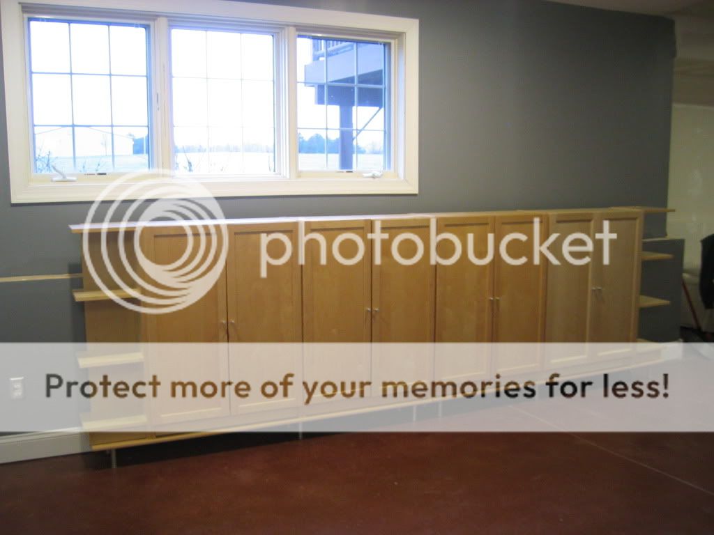

Last night's project, finishing the cabinets in the kids area for storage.
Today's project, hanging cabinets in Bar Area:
Can't wait to start putting some things where they belong, and to have the refrigerators going in the basement!

You're really cranking now. Lots of nice cabinets - where did you get them?
The stained floor looks good. Once it is stained: I assume you follow-up with a seal coat?

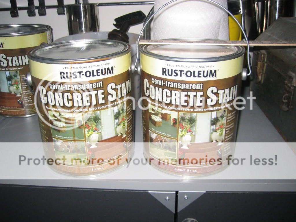

Thanks for the comments on the concrete stain. I've always wanted to have a basement floor acid stained. That is, until I heard a couple horror stories on them turning out radically different than planned, etc. My wife and I had been going back and forth on the floor covering, from wood (scared me to death in the basement) to carpet, to vinyl plank wood look, etc, to ceramic tile, etc. I was in Menards for about the 100th time a couple months ago and noticed Rustoleum had a concrete stain product, and it was on sale. I went home and did some quick research, finding generally positive reviews. I figured for a couple hundred bucks, no harm no foul if I screwed it up, so decided to give it a try.
It turns out it is a really nice product. I went with a two stage application, putting down a layer a Burnt Brick, then a layer of Sienna at about 50% the amount of the burnt brick. I then applied two coats of clear gloss sealer.
The product is applied with a sprayer, making it incredibly easy. It's semi-transparent so it doesn't look like paint at all, which I like, and it is a penetrating stain.
The final clear gloss coat doesn't make it quite as glossy as I would like, but after more research I found that it can be polished to a ultra high gloss, which I'll do once everything is done. So far I am extremely happy with how it has turned out! We do plan on getting a couple big area rugs to break it up. The nice thing is down the road we can always cover it with carpet or something else if we want a change.
Here's the sequence I used. it may vary slightly from the instructed method, but I'm very happy with it:
1. Completely clean, clear, sweep and wet mop the area (wet mopped several times)
2. Apply etching solution (Rustoleum brand) and scrub with a hard bristle broom
3. Wet mop two more times to rinse
4. Let dry completely
5. Apply base color stain (burnt brick) with sprayer, keeping nozzle on a fairly fine mist. Apply in circular motion at about 70-80% coverage
6. Let dry.
7. Apply a second light coat of base color to increase depth.
8. Let dry.
9. Apply accent color (Sienna) at about 50% coverage.
10. Let dry.
11. Apply Clear Gloss Sealer (Rustoleum).
12. Let dry
13. Apply second coat of Clear Gloss Sealer
davboy is offline

Here is a photo of the concrete stain product if anyone is interested:

All the cabinets are from Ikea. We've actually moved some of them around from House to house and have repurposed them. They've held up well. There is some color variation when you have to buy some new ones to supplement, but after a couple months they all seem to even out.

Some photos of screen and projector, as well as wider shots. Forgot to pop flash off so no good screenshots!
Projector:
Screen:
Makeshift Equipment Rack:
Entry:
From Screen:
Kid's Area:
davboy is offline
