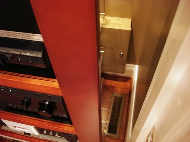

I gutted a closet to use as my new AV closet. I used a QTXEN110 Nutone Ultra Quiet Exhaust Fan/ Silent Fan (~$100) in the ceiling and I have a floor vent to draw cold air from under my crawlspace if needed. Not sure what your setup is but mine works great and is VERY quiet.
Ceiling:
Floor vent:
DoingOK is offline
