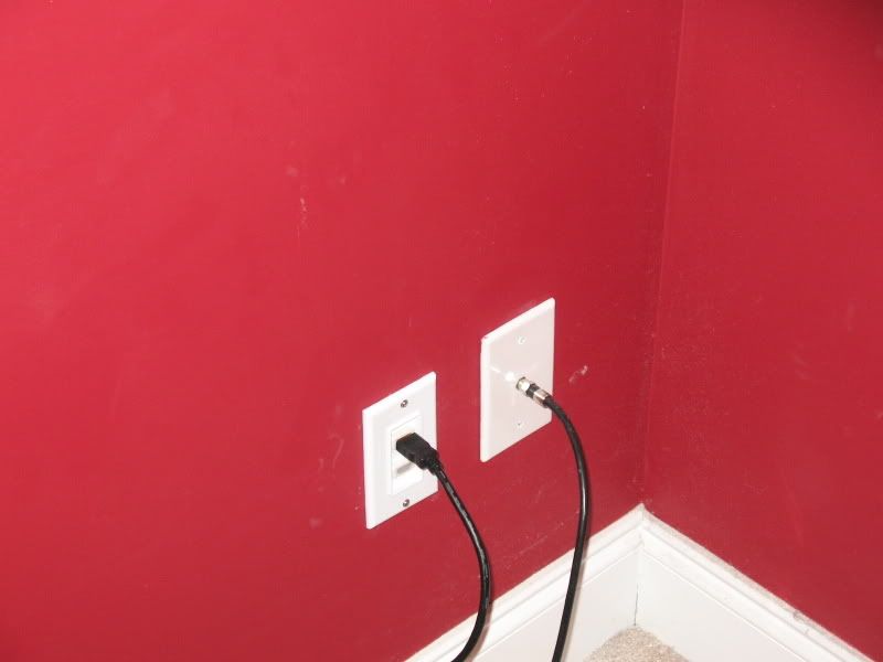

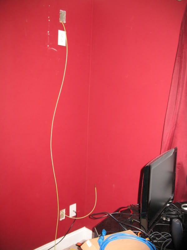

I had a high mounted coaxial wall plate mounted when we built the house (had a 13" tube mounted on the wall), now I need to replace that box with a HDMI cable and wall plate.
So far I have removed the old tv.
Cut 2 new holes at bottom of drywall for the coaxial and HDMI plates.
I found the coaxial cable(coming up from the basement) in newly cut hole and pulled it to make sure it was the same one running up the wall.
Tied a string to the coaxial cable and pulled it down to lower wall. In doing this I noticed it got hung about halfway down the wall like it was trying to get through a cross stud/support stud.
Now my Question is how do I get a HDMI cable up to the top wall plate when I'm sure the hole is only big enough for a coaxial cable to get through?

You need to drill a bigger hole in the cross support. So you cut an access hole in the drywall put your drill in through the hole. Then patch and paint.
OR, You invest in a long flexible shaft drill bit set up that you can fit in from the HDMI plate hole. It will also require a special drill bit like this one that holds it's self in position.

I have fish tape through it right now, just waiting on my HDMI cable form monoprice to come in. I have one but it had that little cylinder thing on the end of it and I ordered some flat in wall HDMI cable

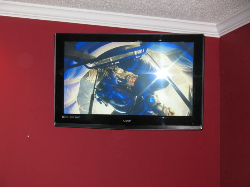

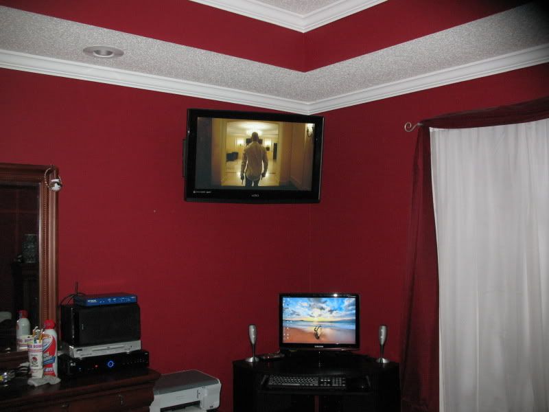

finished!!!
I finally got the HDMI through the wall, I like the way it turned out.
Huge improvement over the 13" tube tv we had mounted up there.
