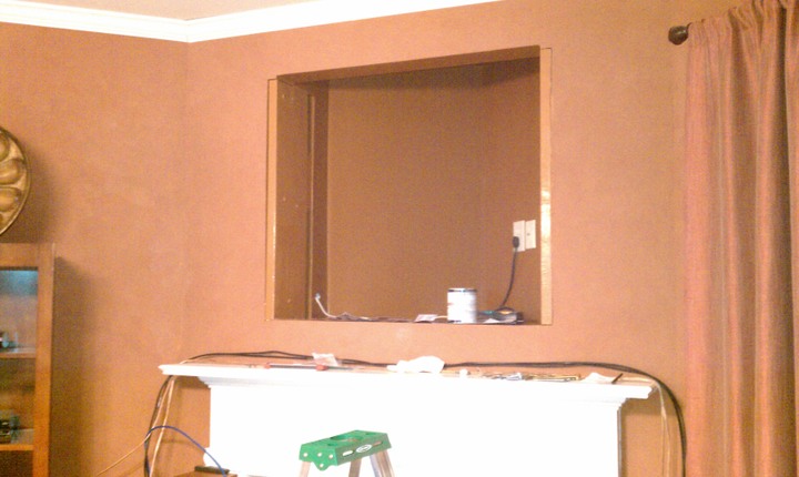

I want to thank Skidpad and the other contributors to this thread, and add my similar experience.
We had a 32" Samsung in a niche created by a prior owner. The niche had been wired with coax, L/R RCA for audio, and RCA composit component wiring, all wired to the right corner of the room where a media center was located.
Attachment 154329
Attachment 154330
I went to Magnolia AV (Bellevue, WA), and they helped me realize first (before I found this thread) that I could cover the niche with a 54" Panasonic plasma (TC-P54G10). Like a prior thread here, it was first suggested that I use a mount to the back of the niche as was suggested to an earlier poster. But then I saw Skidpad's post and suggested we do something similar.
We needed to account for the fact that the studs were at the front and back corners of the niche, so the sides of the "H" strut covered the sides of the niche.
I wanted to be able to tilt the screen L-R and up-down, so I sprang for the Sanus VisionMount VMDD26, $600.
Attachment 154331
Attachment 154332
Magnolia charged me $750 for delivery, buildout and setup, and they were very professional.
The only thing I would make sure you consider if you want to cover the whole niche and you are cutting it close is that the niche may be visible from other perspectives of the room, and depending on how it is tilted.
I would do Magnolia again--they did a good install, and the prices were the same as BestBuy or better: $600 for the bracket, $750 for the install & delivery, $1700 for the TV, plus $200 off a $250 Panasonic Bluray player (DMP-BD60K) and $300 off a $650 Martin Logan Dynamo subwoofer.

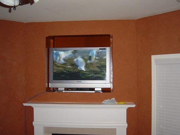

Thank you SO MUCH for all of the helpful info you posted! My old 46" DLP finally kicked the bucket so I went out and bought a 55" flat screen LG TV.
Unfortunately my niche is only 40.5" wide and won't fit anything larger than a 42" TV. After reading this thread, I finally realized how I could solve my problem!
So I picked up a 2" x 10" and cut it into three pieces, one for each side and one down the middle, then mounted the side pieces to the walls using 3/8" quality lag bolts. Then I installed two "strong tie" brackets on both sides at a slight angle using 1/4" lag bolts. I then installed the middle piece to the strong tie brackets, then installed a second set of brackets on the other side. As suggested, I installed the brackets at a slight backwards angle.
The TV mount is a "VideoSecu MW380b" you can get from Amazon for under $70. It's extremely sturdy and has gotten great reviews and I had zero problems installing it.
Now my TV is practically flush with the walls around the niche and appears to be professionally installed and it only cost me about $8 for the wood, $20 for the brackets, and about $15 for all of the lag bolts and washers!
I also have a Vizio speaker bar installed just beneath the TV via an HDMI ARC cable so I have great sound from the TV when I don't want to use my 5.1 surround sound system.
As you can see, I didn't bother painting the wood because you can't see it at all unless I pull the TV out to get to the cables and whatnot.
Just wanted to say "thank you" again for the great idea and post my own results. I am by no means a "handy man" but was able to complete this job in about 5 hours, most of which was me just taking my time measuring and re-measuring things and making sure I got the side pieces installed correctly in the studs before I started the rest of the project.
Please see pics below...
