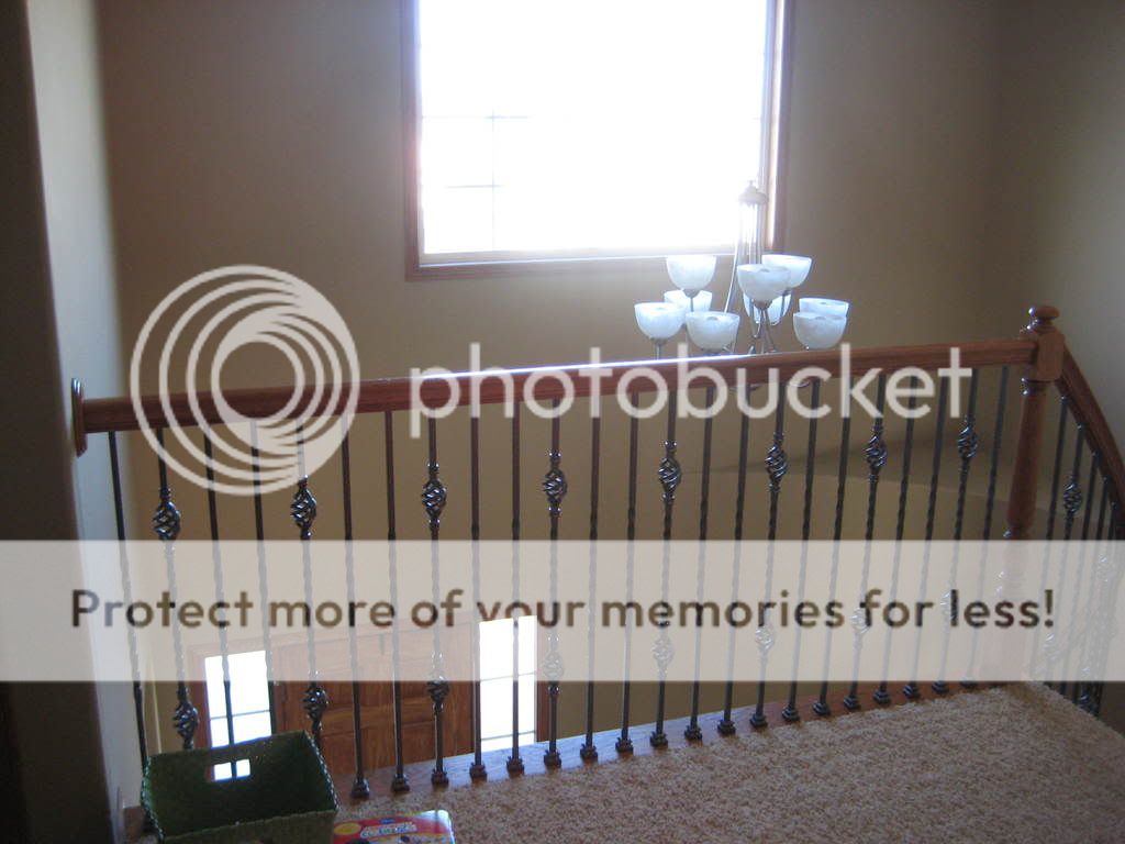

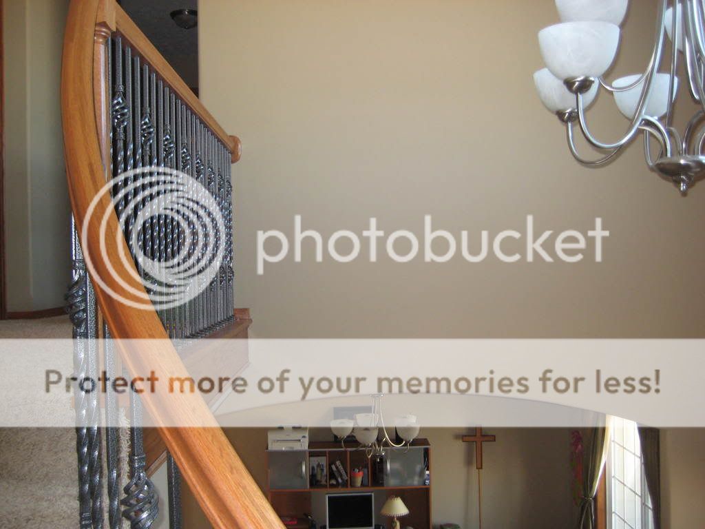

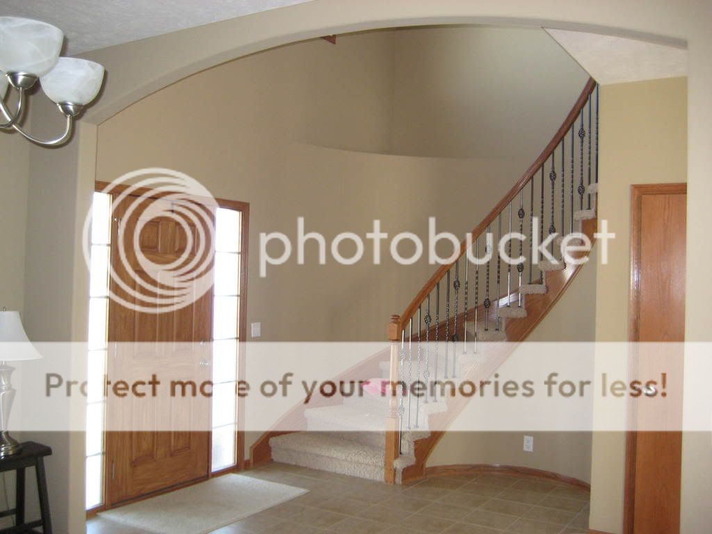

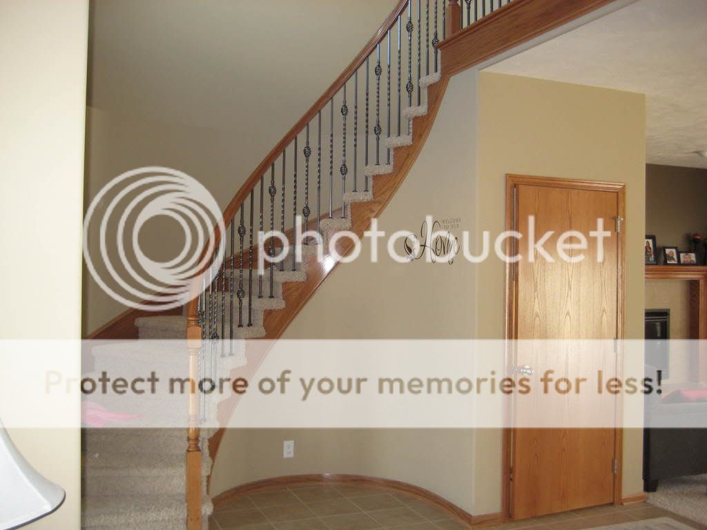

Here is the context. Purchased this house about 9 months ago and love it. The only thing I don't like is how sound travels from the first floor (open floor plan) to the second floor (kids bedrooms).
The first floor houses the family room, kitchen and formal dining room (coverted to office). The entryway has 18 ft ceilings and a spiral staircase.
My question for you is how can I reduce or attenuate the amount of sound traveling upstairs? It tends to travel both ways and can make for some cranky kids at night (and parents...). Any help is appreciated.
