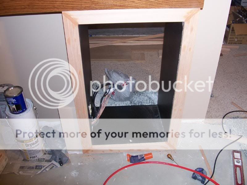

post #276 of 1362 Old 03-13-2009, 04:28 PM - Thread Starter
Iusteve's Avatar
Location: Northern Indiana
Posts: 3,376
No pics ...problem doesn't exist....
Ask and you shall receive....this is the only picture I have and its the rack from the back the oak frame I need to sand and build a door for.The opposite side will be open to the theater....sorry its the best pic I have , hope it helps

post #278 of 1362 Old 03-13-2009, 05:22 PM - Thread Starter
Iusteve's Avatar
Posts: 3,376
Stop apologizing for your lousy photography. We are either used to it now or it's getting better.. What do you want to accomplish? Why is the back towards the theater? Wouldn't you want the pretty lights from your equipment flashing and impressing your guests?
No the back (which is what you see in the pic) is facing the bar the front (which u dont see) is facing the theater...I want to accomplish a decent looking shelving setup for my components....the easiest and most cost efficient way

post #279 of 1362 Old 03-13-2009, 05:42 PM
HeyNow^'s Avatar
Join Date: Jul 2001
Location: Martinsburg, Wv USA
Posts: 2,755
What are your thoughts on the wires hanging out the back on the bar side?
HeyNow^ is offline
post #280 of 1362 Old 03-13-2009, 08:30 PM - Thread Starter
Iusteve's Avatar
Posts: 3,376
Well I plan on some sort of wire management but that is also the reason that side (the side in the pic) is going to have a door on it....to access the back of the components but to also conceal wires etc.

post #289 of 1362 Old 03-13-2009, 10:00 PM
RTROSE's Avatar
Posts: 6,732
Quoted: 192 Post(s)
Liked: 167
Ok,
Here is an idea FWIW.
Obviously space is always at a premium so how about if you would say flush mount one of these (from the Lowes site) in each inside corner.
You then could have neat easily adjustable shelves and with the clips you typically would use be plenty sturdy for you av equipment. If your worried about weight you could always double up and use eight strips.
Or you could modify something like this to fit (also from the Lowes site) to fit your needs. Sort of a rack in a rack type of deal.
RTROSE
Hey you asked for ideas. You did not specify GOOD ideas. Of course as the hour gets later the ideas worsen. Sorry
RTROSE is offline

post #295 of 1362 Old 03-14-2009, 09:34 AM
LSWHO's Avatar
Location: Clarkston, Michigan
Posts: 457
Another idea would be to just drill pilot holes for the (for the lack of a better word) "pins" and the shelf sits on the pins. I did this for my cabinet behind the bar. I just made a jig out of wood for the pattern and then drilled them on all 4 sides and the shelves sit on them. I know, I know this is the "El Cheapo" route. but you wanted ideas.... and yes this will hold as long as it is in wood and not in drywall, i know because I have this set up for my AV rack.
Here are pictures to help explain what I am talking about.
This is from the cabinet behind the bar.
The shelf just sits on the pins
The Copper Pub /Corey Lane Cinema
"Sir, I'm going to have to ask you to exit the donut." IRONMAN 2
LSWHO is offline

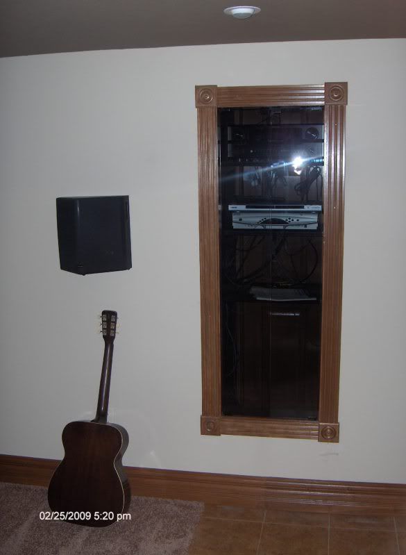

post #296 of 1362 Old 03-14-2009, 09:38 AM - Thread Starter
Iusteve's Avatar
Posts: 3,376
Not a bad idea. I would have to line the inside with wood to do this because basically my cabinet is framed 2x4's then drywalled. I am leaning toward cutting strips of mdf for shelf supports and using the mdf as shelves as well then just trimming the front with some sort of trim peices....but I am have to ponder this one for a bit.
XBOX Live: Zz NiNj4 D4D zZ

post #297 of 1362 Old 03-14-2009, 09:54 AM
LSWHO's Avatar
Posts: 457
I would not use MDF for the supports just use some pine or extra oak if you have it. Sometimes the MDF tends to fall apart at the nail or screw holes. MDF for the shelves is fine.
Are you thinking of doing something like this? this is the shelf above the T.V. in my office (please excuse the mess)

post #298 of 1362 Old 03-14-2009, 10:07 AM
malbols's Avatar
Location: Southern Ontario , Canada
Posts: 84
When i did some shelving ( although it is all oak) , i simply bought some "L" shaped oak trim (i think about 1/2" wide - although you certainly could go bigger depending on the span & weight factor), glued and nailed into side of cabinets and sat shelves on top . In my case i had 1/4" glass cut for shelving . So not only do you get a nice shelf support but it looks good too .
malbols is offline
