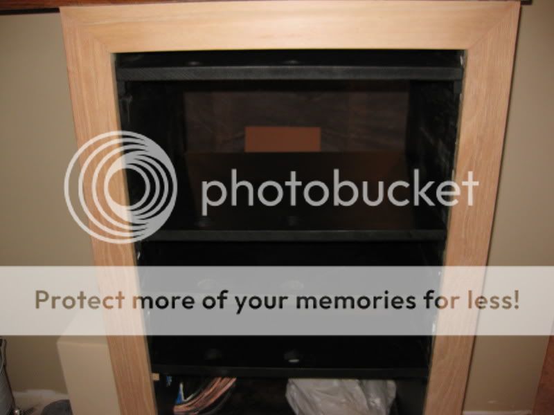

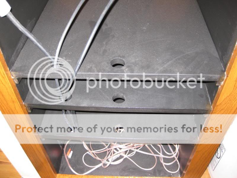

Nice looking sink, I only wish I had made my bar a "wet" bar but I didnt want to mess with running water and drain lines. Anyway not alot going on here as I have been tinkering with the rack and some other small things like poly on some trim peices etc. I also have taken all the old baseboard trim to the garage and sanded it down and stained it the same colora s the bar to match the rest of the room and let me tell you this sucked.
The rack shelving was a peice of cake once I figured out the way i wanted to do it.
I just used 1/2"x3/4" pine and cut to size sanded and painted. I used 3/4" mdf for the shelves and although it doesnt look as nice as most of what I have seen on here it is truly functional and fits my needs very well. I have yet to trim out the front (theater side) as I am waiting on the carpet to get put back in place and thats why no pics from the front.
Heres the shelves installed. Notice the mucked up paint. Yea I painted the inside prior to shelves because I thought painting around all those shelves would be a pain. Well guess what ......I had to paint it all again as the shelves were cut "snug" to fit.
Now the trim has been stained and polyed. This is where the cabinet door that I need to find will go

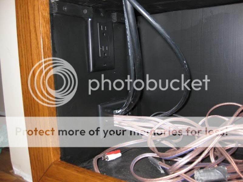

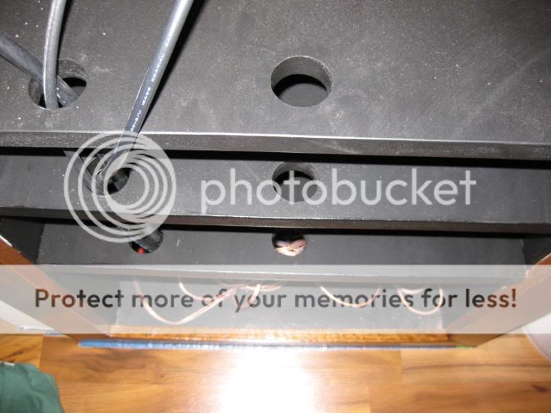

Looking down into the rack I cut 2 seperate holes for wire management
Its funny how the flash makes the black paint look dirty or dusty but trust me its "BLACK"
Here is a shot below the last shelf and on the left you can see where all my cables come into the rack from the wall. On top is the dedicated 20A electric and below is a simple cable pull through faceplate. In front of that I cut another peice of mdf and installed it as a shield if you will to prevent seeing wires and the surge protector from the front. I mounted it about half way in the middle so that in the front I have a small storage cubby for xbox games and controllers. The rear side (which you see here) gives me a great place help hide all those damn cables

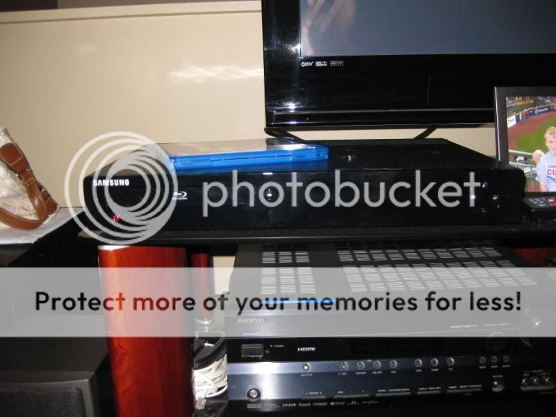

Our first BD player.....yeeeaaahhh I got this unit (Samsung BDP-1500) for literally half of what BB is selling it for and I am quite pleased. I have it setup in the living room and hooked to our plasma and I am blown away so I can only imagine what I will see in the theater when that time comes. Hopefully I will get back to work soon as I have run out of new Blu ray discs to watch....however I have another toy set to arrive in the next few days.......THE SUB!!!!!

Steve,
Your cabinet is going to work out just fine. Looking forward to seeing it from the front, and populated with gear!
I think you will enjoy the Blu-Ray player. I bought a used Samsung 1400 last fall (from Ralph Potts - he is the one doing the reviews in these forums). Aside from lengthy load times it is serving me well. I suspect your 1500 is better in this regard. I have been taking mine back and forth between Family room and the HT room and need to buy a 2nd unit. Can't decide if i will buy one of the newer Samsungs that will stream Netflix, or go with a PS3 (I like the idea of having some media storage capabilities..)?

Thanks for the input, I am so far pleased with this unit. I didnt really have any interest in the Netflix options as I dont do alot of movie watching so this was perfect for me. Load time so far is fairly quick and for the price I paid I couldnt complain anyway. As for the rack....I wont bring the gear down until its time otherwise NOTHING would get done and also that would make me want to purcahse the PJ and I have faught off that tempatation so far. I am though getting closer to that point......so stay tuned

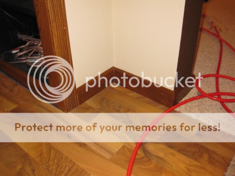

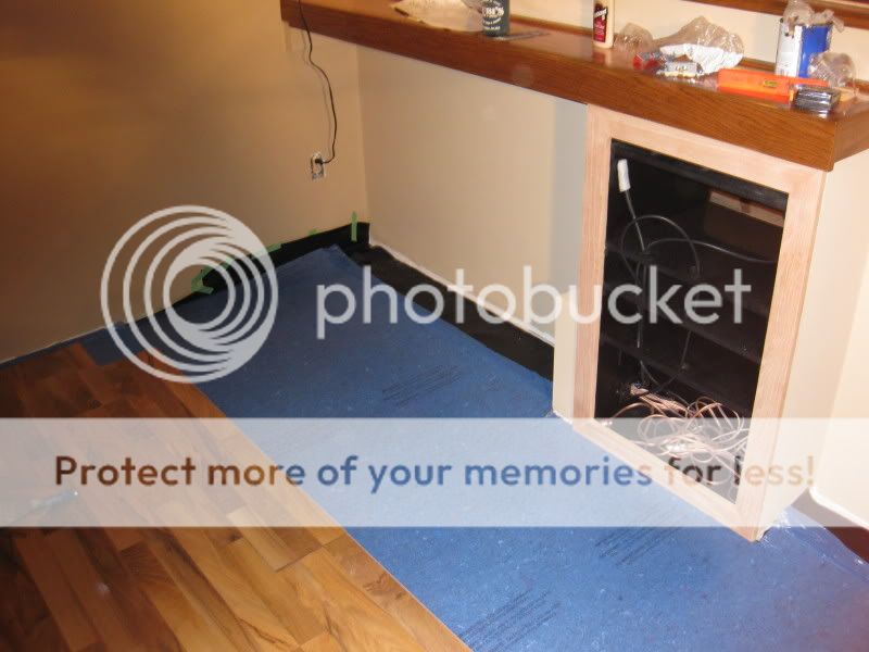

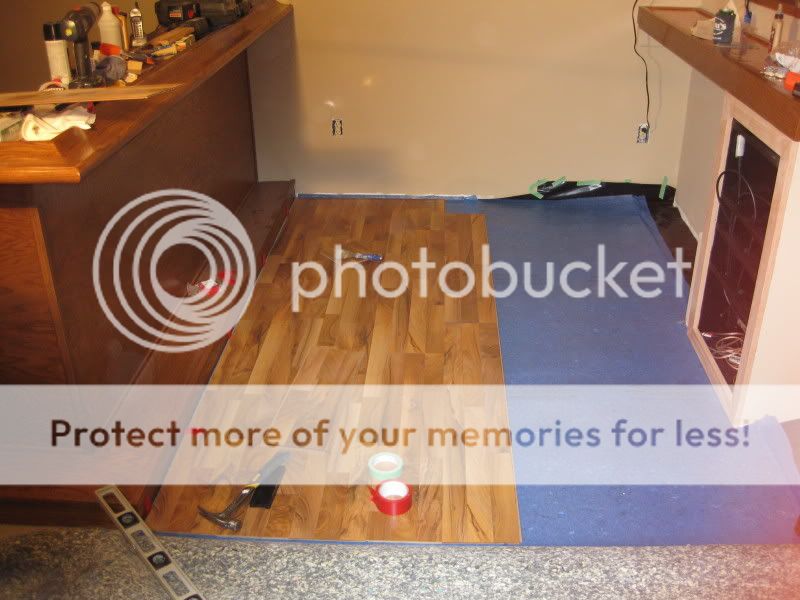

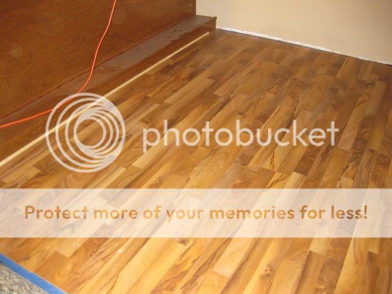

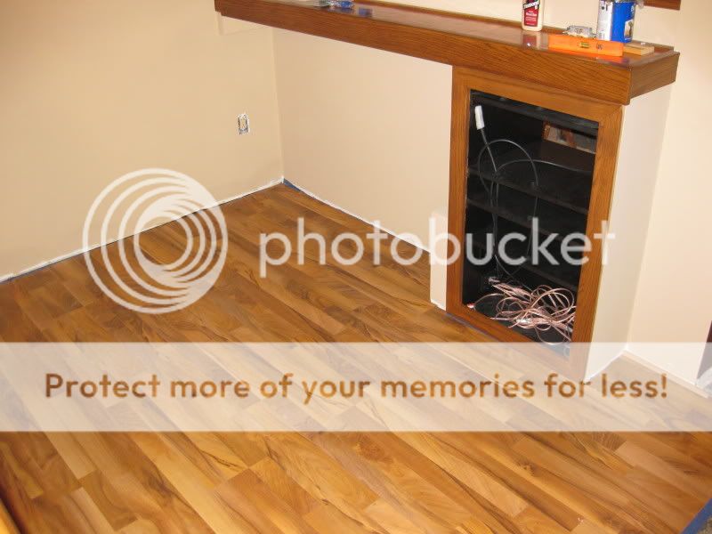

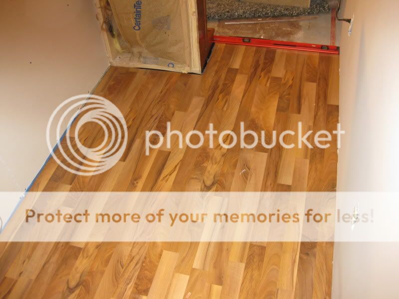

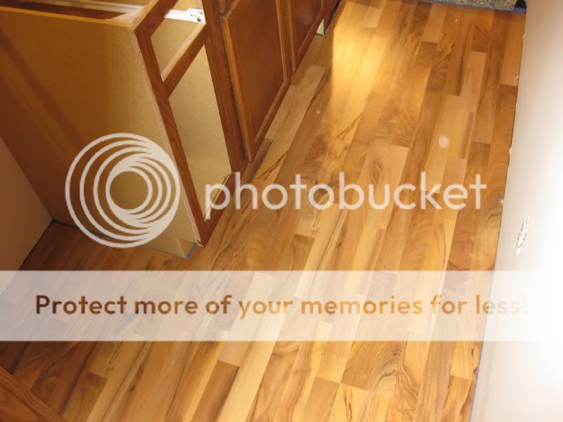

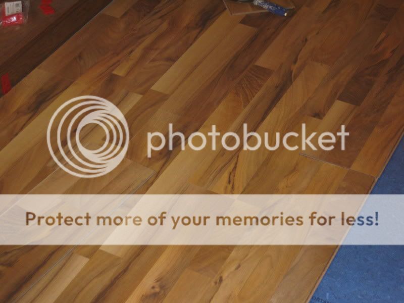

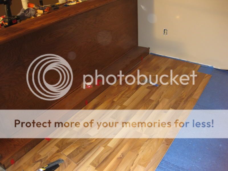

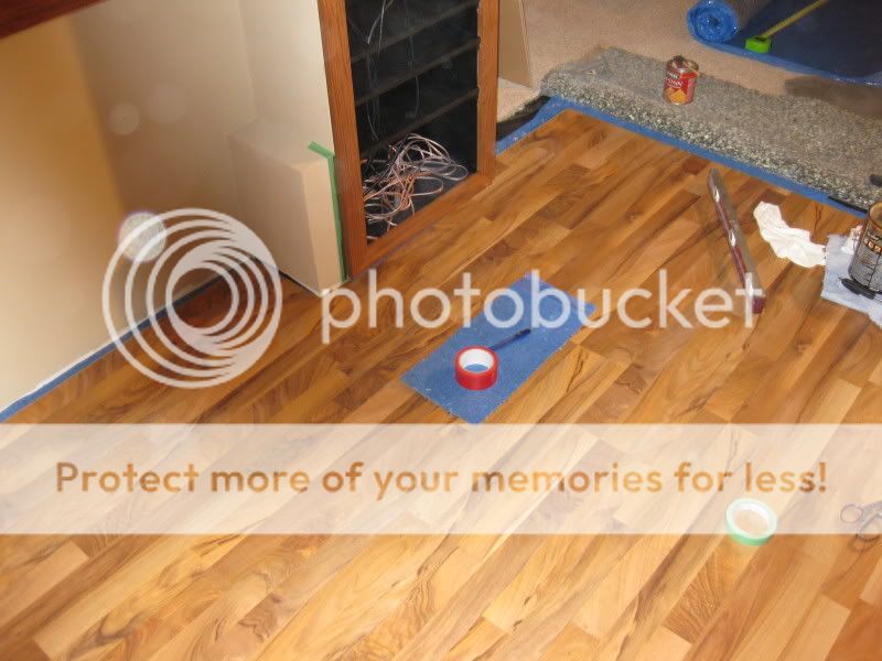

Time for some long awaited updates to the space. I have been working on a few things (slowly I know) such as the laminate I put between the bar and half wall bar as well as behind the bar. I have also been working on the front face trim for the av rack. Things have been moving slowly as I was hit with a small plumbing issue/leak that I had to hault things in order to fix. Here are some updates.....installing the laminate I apologize as I took a million pics and why not share them right? lol
The peice of quarter round you see against the foot rail of the bar is unstained and just to see if I liked it

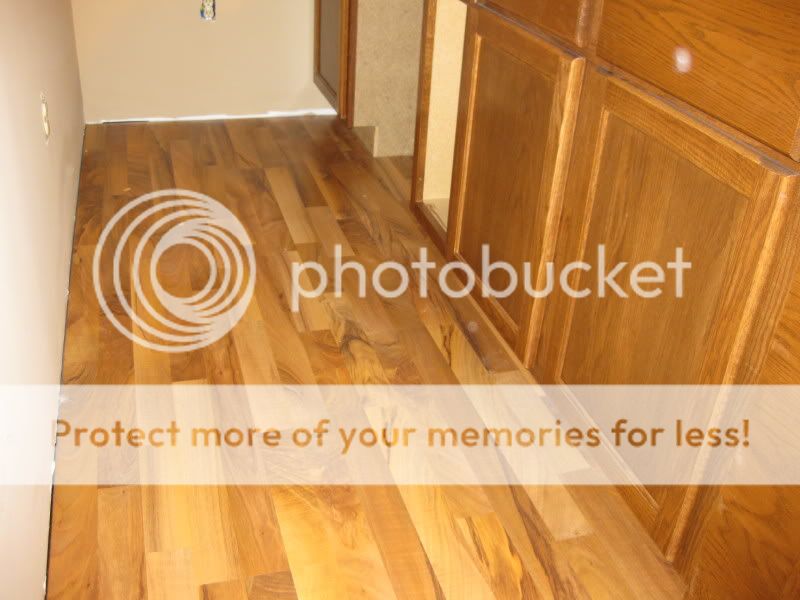

Now behind the bar....here i originally installed the entire area and was going to install my cabinets on top of it but I later changed my mind and pulled up about 4 rows and cut it around the cabinets instead
BEFORE:
AFTER:

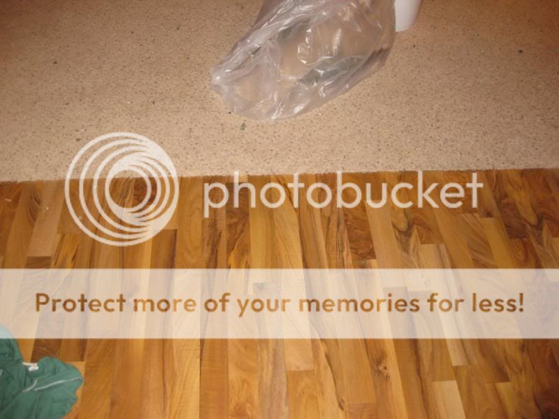

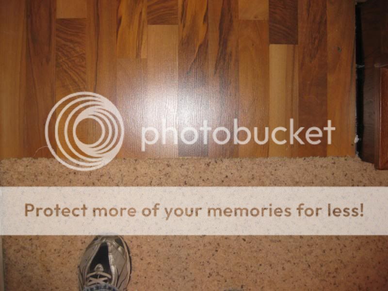

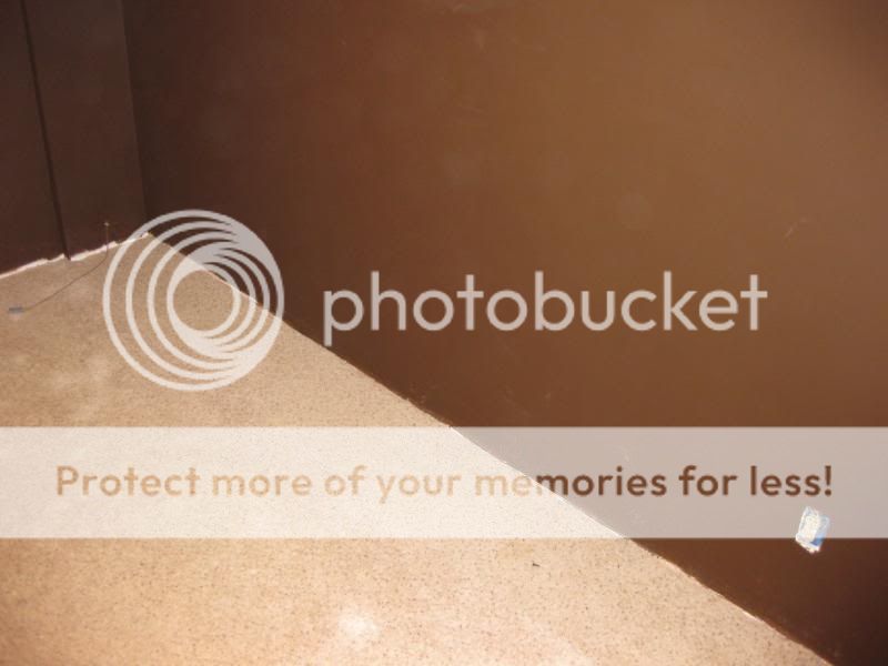

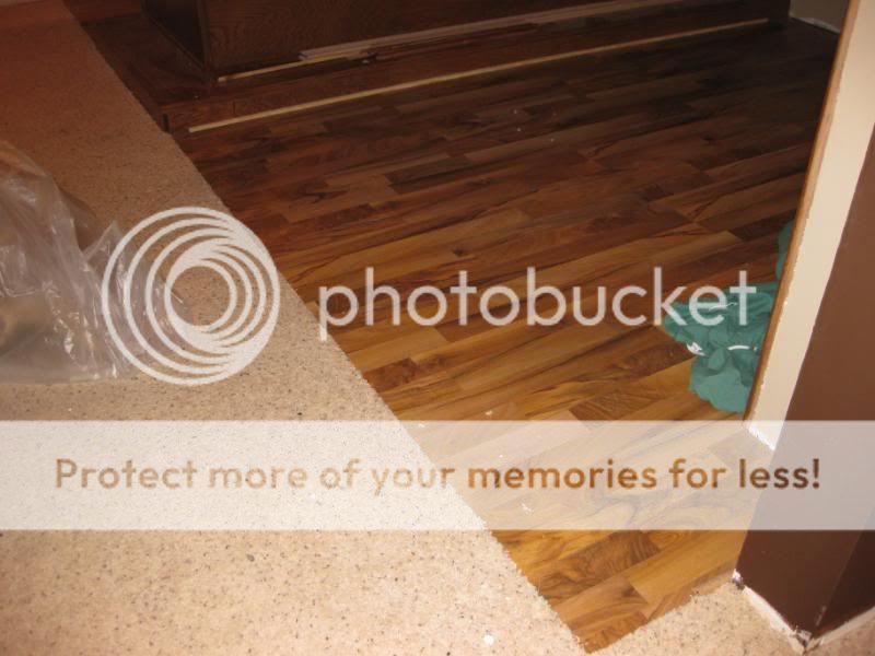

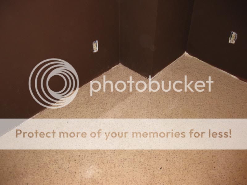

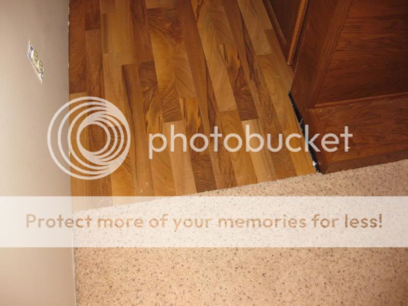

Then I had a small delay in finding someone that would finish the carpet transition up to the laminate as well as peice in the area where I bumped the wall back 18"....the problem was my job is too small although I never was actually told that I know better. But I luckily stumbled upon a great guy that is semi-retired and been doing carpet for 41 years.....and he did a great job and it was cheap as well.....$75!! I originally purchased the T moulding and some reducers that were the same color as the flooring but he decided to just use aluminum z-bar and I have to say at first I was a little skeptical but now I would never do it differently. The z-bar actually is nailed along with the tack strip and the carpet then rolled over and hammered down AND the best part is I got to return the T mould as well as the reducers for a total of $93.....BONUS CASH!!!!!!
Area in theater where I bumped the wall back

post #379 of 1362 Old 04-13-2009, 06:01 PM
hanesian's Avatar
Posts: 2,880
Quoted: 25 Post(s)
Liked: 71
Hey Iusteve - do you think you might be able to post a few photos of what your new laminate floor looks like?
J/K buddy - great job!

That floor looks S W E E T ! ! ! D U D E ! ! ! Very nice. What I'm missing though is more pictures of the bar. HA! Sorry couldn't resist. Looking good. I too have had issues with some of the jobs I want done being too small for someone to come and do for me. I really hate that but I guess it is the nature of the beast. I had a HVAC contractor basically tell me that my job was too small for him to come out and give a "free estimate". That's OK I'll just spend my money with someone else.
Keep up the good work.

You two are absolutely hilarious arent you I posted a "few" pics of the flooring because everyone usually enjoys pictures, next time you will get one picture from 40 feet away I will get some more pics of the bar as soon as there are updates to it. I havent actually done much to the bar in a few weeks. Sometime soon I plan to do the envirotex pour on the top as well as installing a countertop so there is more to come soon so stay tuned if your bored......

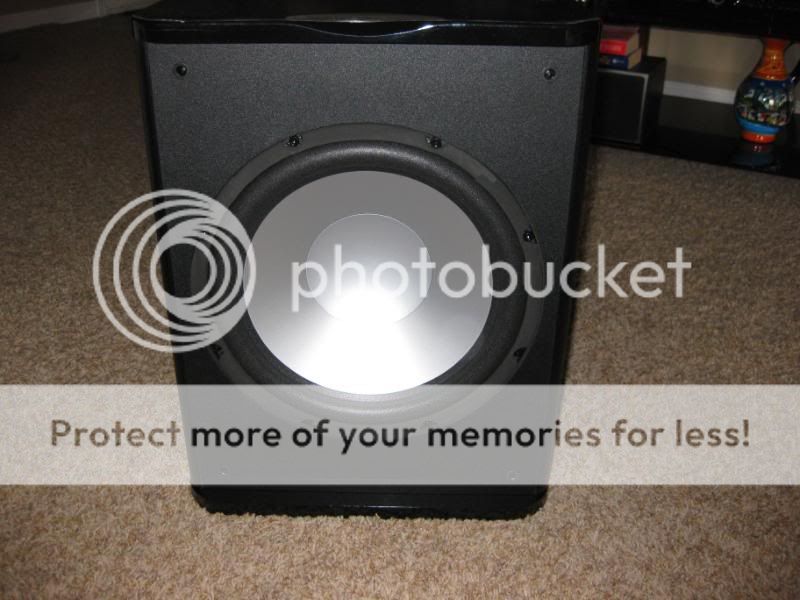

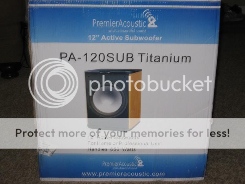

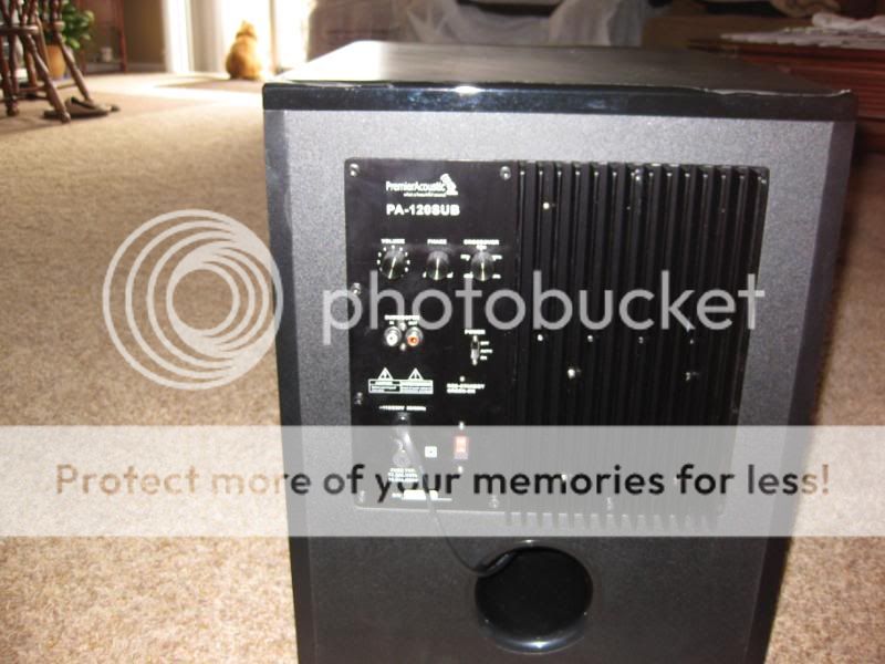

Well its been a few days since any updates have been made. Progress has slowed a little as I have been busy as basball season has started for my 12 year old and well lifes hectic as the coach. We have practive 3 days a week and we are at full speed now so I have been busy. I did however get this baby, I know its not "build" related however it is theatre related.....Premier Acoustic pa-120.....and let me tell you I have been delighted since its arrival
I also got an Auralex subdude for underneath it to help with sound but I dont have any pics of that yet but is has made alot of difference with the subs performance. I will have some other updates (photos) soon as I have been tinkering with an led solution for inside my av rack. I have also been doing alot of the little things like running speaker wire down the wall cavities and installing wall plates for the banana plugs to attatch too as well as wiring banana plugs on all my speaker wires etc. All the little time consuming things that really can eat away a day

Everything is looking really nice! It's great to hear that you are enjoying the sub! I'm not familiar with the Auralex subdude?? What is it? what does it do?
Thanks for humoring me in my attempt to learn all this fun stuff!
Keep up the good work!
Ryan
ripcord87 is offline
post #385 of 1362 Old 04-20-2009, 08:41 AM - Thread Starter
Iusteve's Avatar
Location: Northern Indiana
Posts: 3,368
Thanks for looking. The subdude basically is a carpeted platform that is raised by some high density foam to help cut down on bass traveling into your walls and other unwanted areas. It will help "you" feel the bass rather than pictures on the wall rattling etc. Here is a thread that talks all about it.
http://www.avsforum.com/avs-vb/showthread.php?t=644330

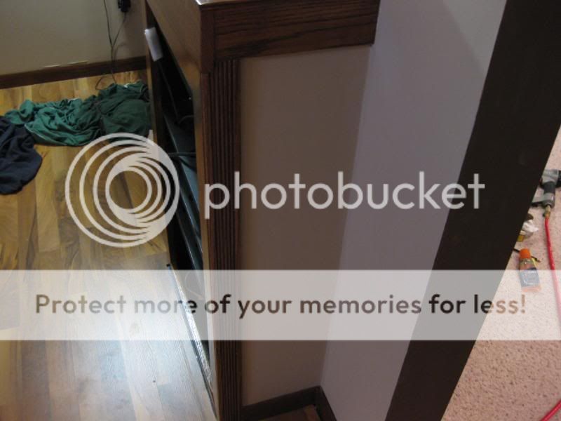

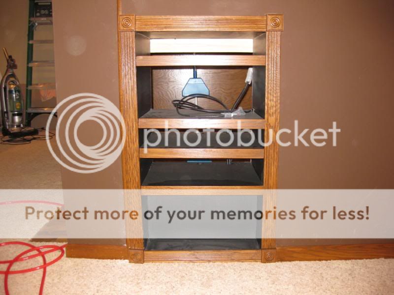

Well progress has slowed here tremendously with the arrival of nice weather and now baseball season. I have been "roped" into coaching my sons 11/12 year old team and that has taken up quite a bit of time as you can imagine. I have been messing with some sort of led lighting idea for the media rack. I have been playing around with these and sice they are in Cali I have to wait forever to receive my order as I have ordered a second order of goodies from them. I got these http://www.oznium.com/led-flex-strips and also got a remote control module so that I can operate them from anywhere. I may (depending on how carried away I want to get) add some of these in my speaker stands, behind my seating or in the bar area...the possibilities are endless and installation is a sinch. And they you almost no electricity so why not, they are a definate cool factor. I also just received my stands for my surround speakers. I didnt go with any in wall speakers so I needed stands for my 4 surrounds as my fronts are free standing. So with all that I have been putting them together, wiring speakers with banana plugs etc. I am waiting on yet another delivery from my good friends at monoprice any day now. Other than all this I have been installing basboards......and let me tell you this is my first attempt at them and so far I think I have done pretty damn good. Here are a few pics of the theater side and I will get some more of the bar side and some closeups of the corners to brag about my work soon

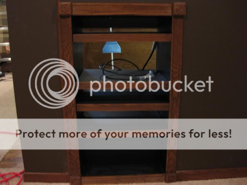

New corner in rear of theater where I moved the wall back...
Other corner
Other side of wall wall bar (random shot)
Side of av rack (rear)
rack front..
The rack will have a door on the rear to block out any light getting through to the theater side. It is on order (didnt want to attempt this myself) I also need to fill all nail holes,and touch up corners (with stain) on all the trim. I will get some shots of the bar side trim and doors I "re-stained" maybe tomorrow.

how do you like that floor being floated? the guy that installed my engineered floor said it can be floated too, but that floating it makes it have a hollow sound when you walk on it. Now that I went glued I like it, right on the concrete floor it is just solid.
It has a bit of a hollow sound but only in a few places is it bad. All in all I can live with it since its only down behind the bar and between the bar front and the half wall bar...for the money I cant complain. I paid $.99/foot for the stuff on sale and installed it myself so it was definately cost friendly

Iusteve,
Looking Good !!

you are the man....nice job.
