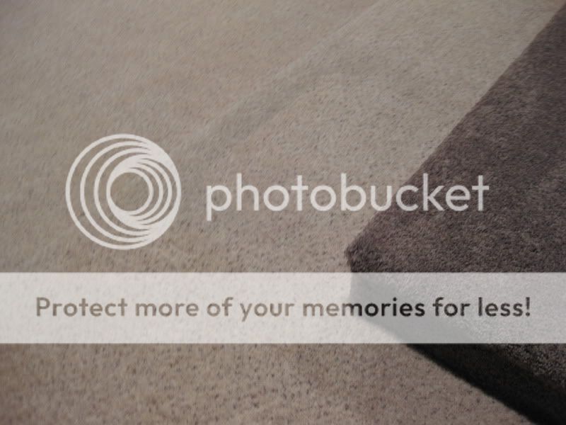

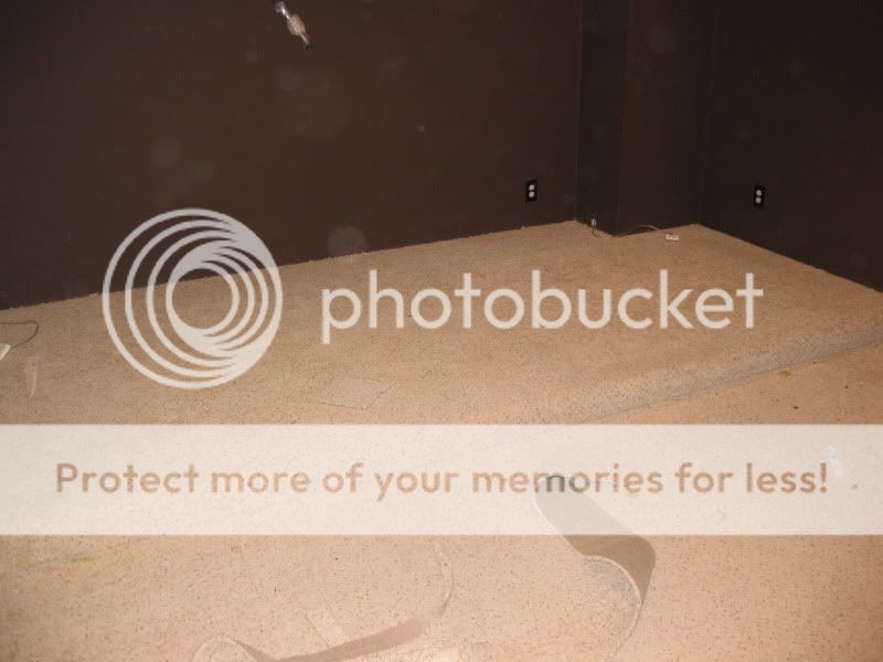

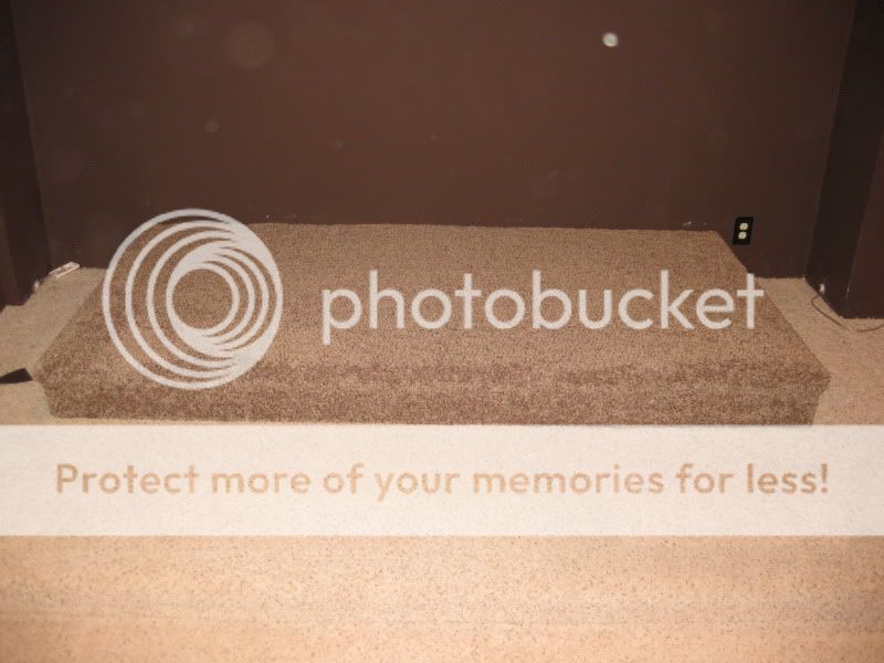

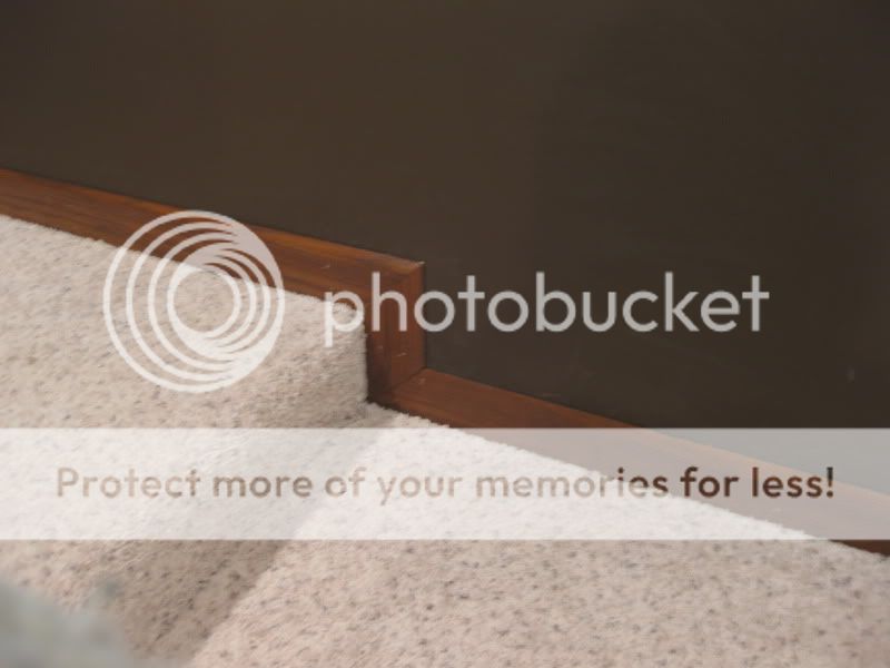

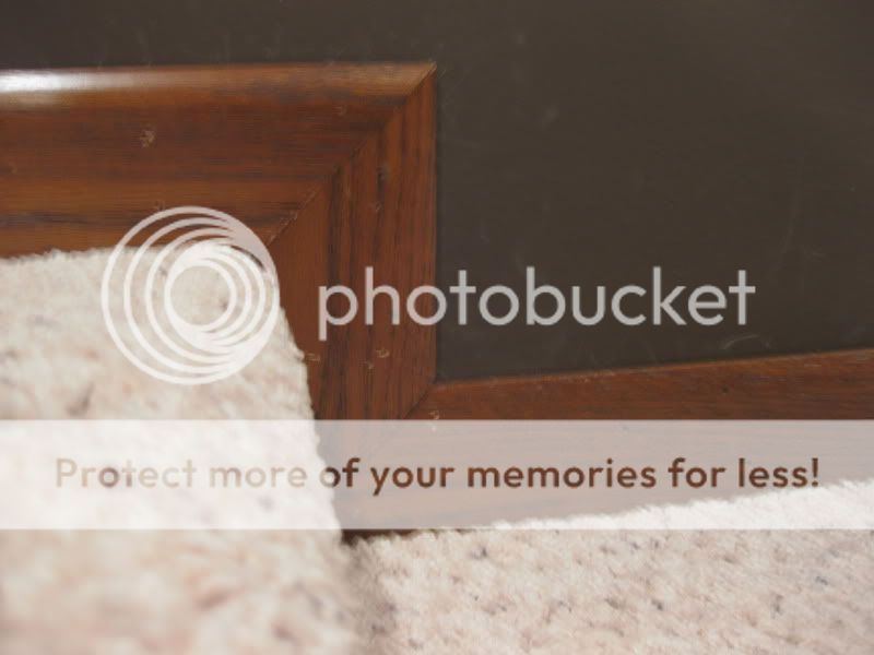

Ok enough about tile (for now) and on to something that may be compared to progress. I now have an "Official" second row of seating. By this I mean I had my carpet guy out to carpet both tiers. Since the basement was already carpeted he just took the extra piece I had cut out to install the laminate flooring in the bar area and used it for the bottom riser.
Here is the bottom carpeted.......
He suggested that I just carpet the bottom riser completely and then install the top riser and carpet it.....probably easier for him and didnt really matter to me either way. So here is the top riser with 3/4" ply base, 2x6 framing with 2x4 cross supports.
Another angle.....

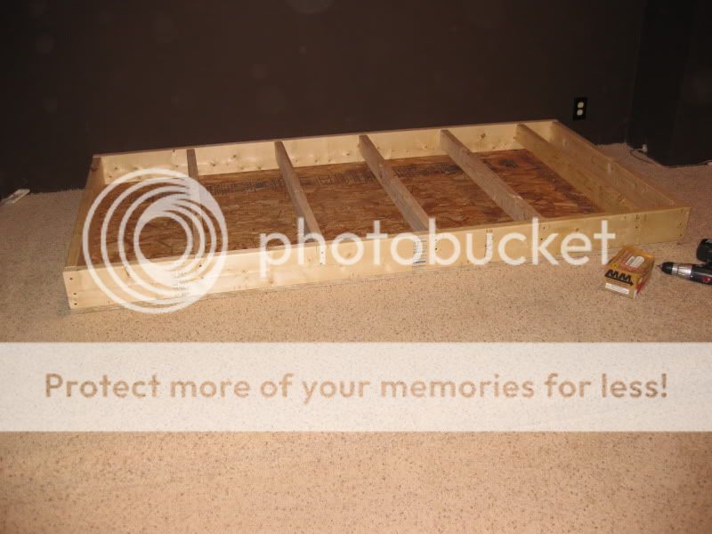

I packed both FULL of insulation but didnt get any pics. Next up I had him carpet the top riser. I didnt have any carpet left from the basement and since it was carpeted when we bought the house I couldnt find an exact match. So instead of getting something close and have it look bad because they were off by just a shade I decided to just go with a bit darker carpet. I got this darker brown that matches the cocoa brown walls and my berklines very well. Almost a complimentary tie in for the space.

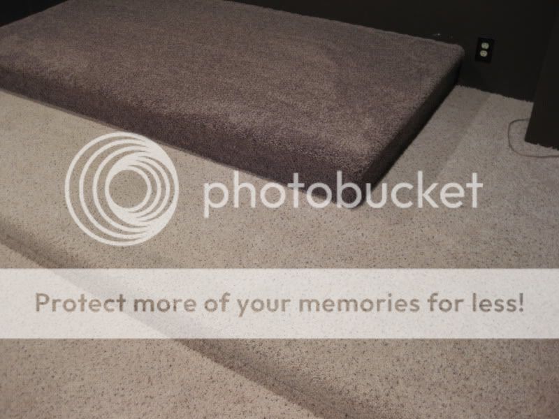

Here is the top carpeted........
Top view....
Corner of the seating riser......
Now I know these arent screenshots and I have yet to really get any "good" ones since I am only using a bed sheet currently BUT for those that are demanding them they are coming I promise......

Also managed to re-install the baseboards in the theater side. Here is what I thought to be a tricky series of cuts for me since i have never done baseboard trim before but turned out to be relatively easy.
Still need to fill nail holes etc. Sorry these are blurry, I think my camera battery was getting low

Looking good man! I think you did the right thing regarding the color choice. I am however upset that you did not use me as your carpet consultant especially since it is in my signature. Good job anyway! We want screen shots anyway!

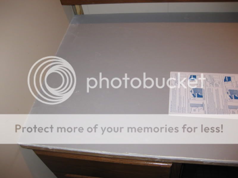

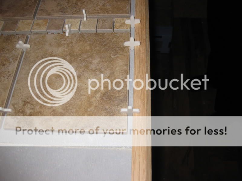

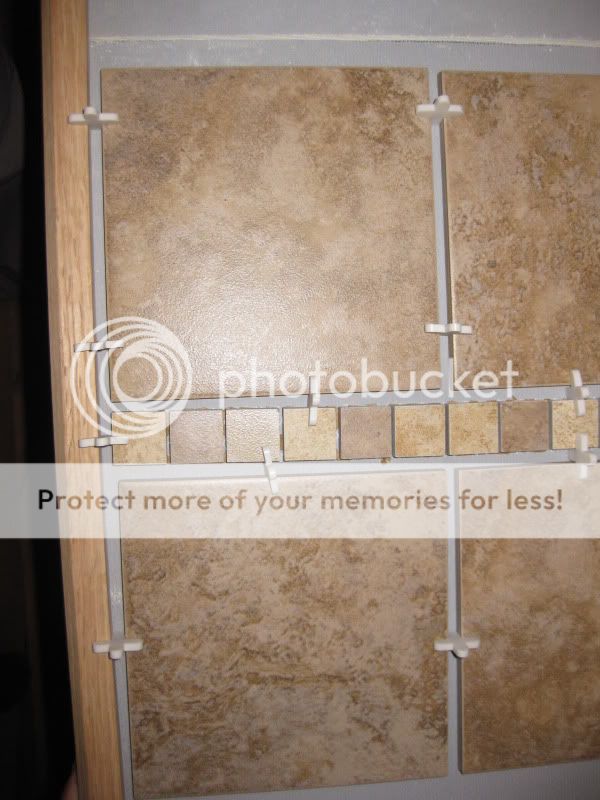

Ok back to my tile planning. I have never attempted to tile before so i have a few newbie questions. I am using a piece of oak trim in front of the tiles and am not sure on how to finish the tile up next to that. I have a few pics here of my situation
Now I wanted to tile first then install the oak trim so I can stain it and not get grout all over it but is that the way to do it or is there another/better way? I am not sure on where to start the tiles in reference to the oak trim? Against or 1/4" spaced (same as my tile spacing)? And what do I fill the gap with? Caulk/grout? I am lost here. ANyone????

THey say, whenever changing planes or material, to not grout. You can find some products that are very much like caulk, can match very close to your grout, to use instead. I forget what it is called but its like caulk mixed with sand. I used it when I tiled my floor and instead of putting in t-molding to transition to my hard wood floor, I used this special caulk so that I had 1/4" gap and it looks like grout, but its not.
The purpose is so that there is some flex. Wood tends to expand and contract (and in my cased with 800+ sq ft of flooring, I couldnt risk the flooring expanding and busting up the grout.
However, you dont have much wood, so you should be ok to just go with grout, but you may see some separation but it will be minimal.

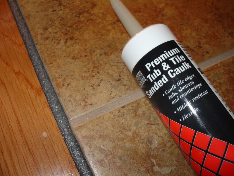

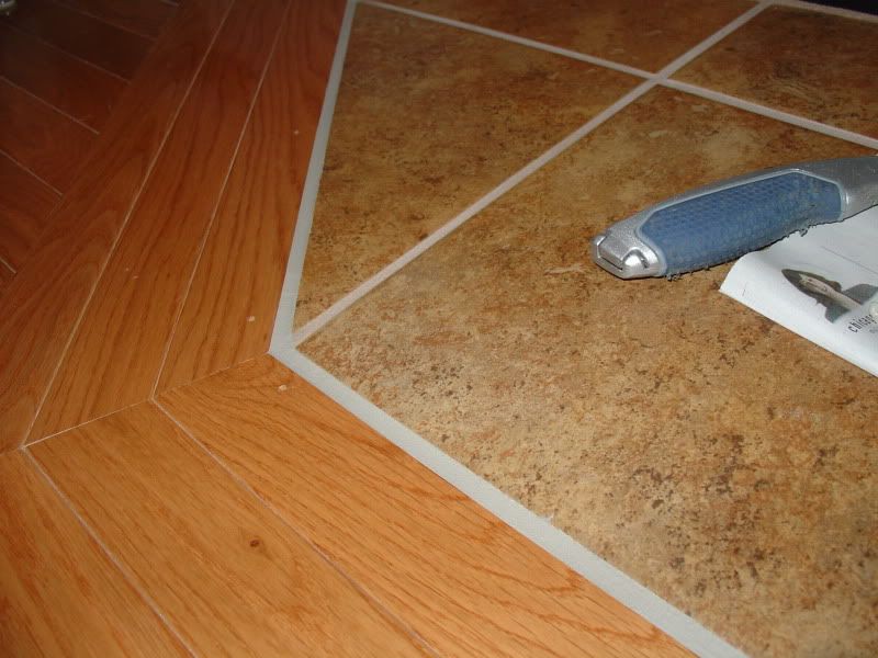

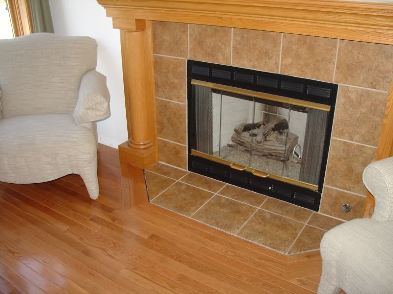

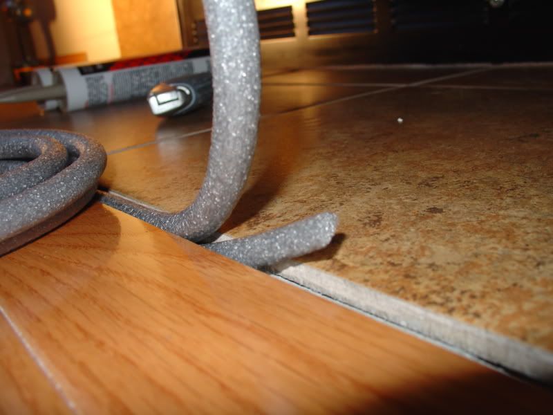

The grout I was talking about (again only for transition of material and I am not sure it would be required with your tile and wood trim, but this is what I did) is called Sanded Grout.. You can find it anywhere. The trick is to find the one to match your grout color so that it all looks like grout and only you know the difference.
Here is from my tiling and hardwood project (this brings back some memories for me)
Notice the intended 1/4" gap between hardwood and tile...
Because I had some depth to deal with since I put down backerboard first, I filled in some space with Caulk Backer Rod (you can get this almost any big box store or tile store)
Only with a flash do the colors of grout and caulk show slightly different shades.
Make sure you tape off the tile and hardwood when you apply and smooth the caulk. Let it setup a little before peeling the tape, carefully.

Yes, you should be able to get it at those stores listed. I would try and do the tiling first...like you said, to avoid getting mastic/grout on the trim.
As for you last question, are you refering to an inside corner? Its hard to say, can you take a picture of where all this is going so I can see. From a guess, I would think you would just butt right up to that corner, no trim needed. But lets see a pic first before I go further.

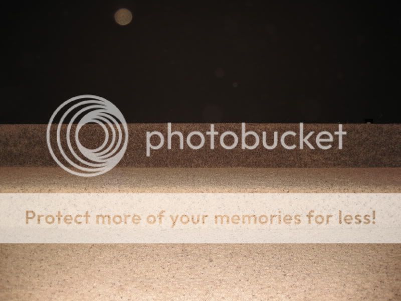

I will get a picture here in a second. But what I am referring to is actually a corner but also the one whole side of the back bar is against a finished wall so I am unsure if I should space (1/4") away from the wall or butt up against the wall and what to fill with? I will go snap a pic
XBOX Live: Zz NiNj4 D4D zZ

The upper left I still need to put a peice of backer board/drywall in that hole but this wall is where I am in question
Hmmm, the other pics with the tile, I thought was the backsplash, but now I am thinking that is the counter top? Perhaps a pic further back to see it all would help.
As for the corner, if not continuing to tile on the turn wall, then here is where you will want to use caulk (again, as its due to changing planes whether wall to wall or wall to floor/ceiling)

The first two pics are the countertop looking straight down. The wood trim piece you see is the edge of the counter and where the tile meets up with the trim piece. The last picture i posted was also the same countertop where (on the left side) it will butt up against a wall. If you look (at the last pic) you can see the cabinet/drawer below the backer board. Does my description help?
That makes sense to me...but what about the backsplash?

I am using 1"x1"x12" ceramic sheest for the backsplash. Its what you see in the first two pics between the 6"x6" tiles. Now on to my questions/issues. What should I do next to that wall in regards to the tiles? Up against or 1/4" gap? Sanded grout, grout or caulk? Also since you mentioned it where my 6x6 tiles meet the bottom of the backsplash tiles should I grout or sanded grout or caulk there? Answers my friend answers I need them

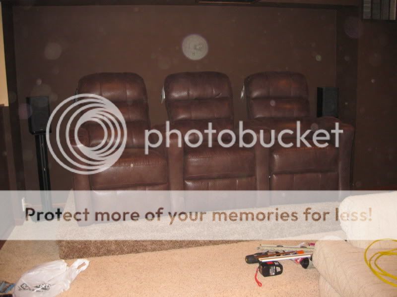

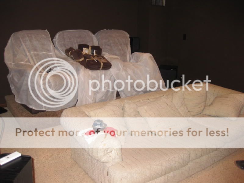

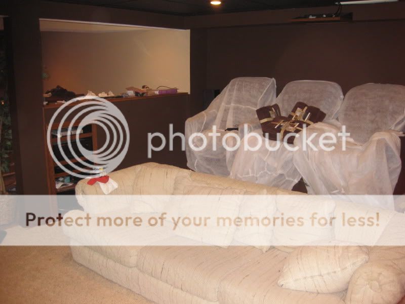

So things have been a bit hit and miss around here as far as work/progress since the arrival of the projector (I know I was repeatedly warned) but it is all for the good? Right?! We have enjoyed alot of xbox time (my son and I) and several good blu-rays in the theater since we got the pj including this past weekend.....Transformers 2 and Paranormal Activity. Now Transformers was simply SPECTACULAR with all the special effects and such, I along with the family was absolutely blown away!!! Th Panny puts out an AMAZING picture even on a bedsheet And while Paranormal Activity IMO was a terribly slow movie that was silly to say the least it had some great bass moments and the sudden "scary" parts (you know the ones that make you suddenly leap out of your seat, pee your pants or better yet both) really got us good. So I have been doing a few small things here and there as well as this little tile project for the counter and back splash on the bar and the back splash for the half wall bar and all in all it went fairly well for my first time. So like many of you I will be scrambling to get the basement superbowl ready to watch my Colts do their thang in 2 weeks!! Maybe I will even have a screen up by then but that may be pushing it a little since I have yet to decide on a screen size or order it yet.
I do have a few pics of seating in place after I got the risers built and carpeted. I had been waiting a LONG time to get these babies out of their packaging since my spur of the moment run to Costco way back when
And here are a few with our front row in place. This is the old couch we have used down there for sometime and absolutely love. It is super long, sits very low to ground making viewing over (from the back row) and breeze and is extremely comfortable. We are contemplating getting it reupholstered in a similar color to the theater seats down the road but for now it is what it is.

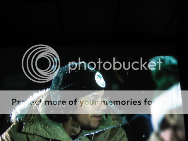

For those waiting for screenshots.....I forgot to take some when we watched Transformers 2 and we returned it last night. I also have been holding out since all I am projecting on is a bedsheet so the quality is a bit poor but I will give you a few. Keep in mind the sheet as well as they are a little blurry but hey they are screenshots.....right?!
The first movie we watched, The Invincibles.....
These I hope will hold some of you over until I get a screen and get some "good" shots. I also will get some tile pics up as soon as I get them downloaded.
