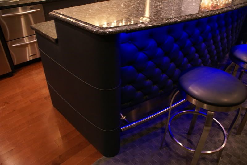

I'm at the same stage as you. I want my bartop to be a little higher because I'm using the taller stools with arm rests. I have a 2 x 6 knee wall at 42" that my bartop will set on. This way the arms of the barstools will fit under the bartop when swiveled. As for the overhang, I want 3" on the bartender side and at least 10" on the barstool side. So I'm planning on a bartop that is 18" to 20" deep. I don't think there is a standard as far as the over hang is concerned. I believe it's more personal preference and what is comfortable for your situation.

Wow. That looks very similar to my build so far.
I also have cabinets around the front of the bar with a granite countertop. The cabinets are the standard 36" height. In front of the cabinets is a 42" half wall. I've gone to a few bars and the most common measurement for the top width is bar rail plus 15". I'd like to have a front overhang of 10", but then I have an awkward situation where the back of the top hangs over the countertop something like 5" and the countertop space under the top isn't that useful. The solution is to either push the top farther towards the front of the bar or reduce the width of the top.
