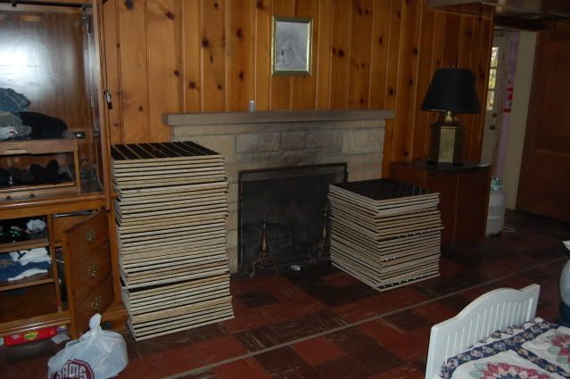

I had hoped to avoid the subfloor route but may throw in the towel and just do it. I know the platon route is cheaper than dricore, but judging from other's threads it also involves a lot of effort/hassle in securing it to the floor. Given my (non-existent) handy man skills and tools, I would probably opt for easier route (dricore) even at the expense of ... well, the added expense.
It just never ends, does it?

I know the thought of additional time and expense of doing a subfloor is making you queasy and weak in the knees, however I know from experience you won't regret putting it in. You will be very happy you did it. PLUS it does cut down on the potential of that MOLD thing!

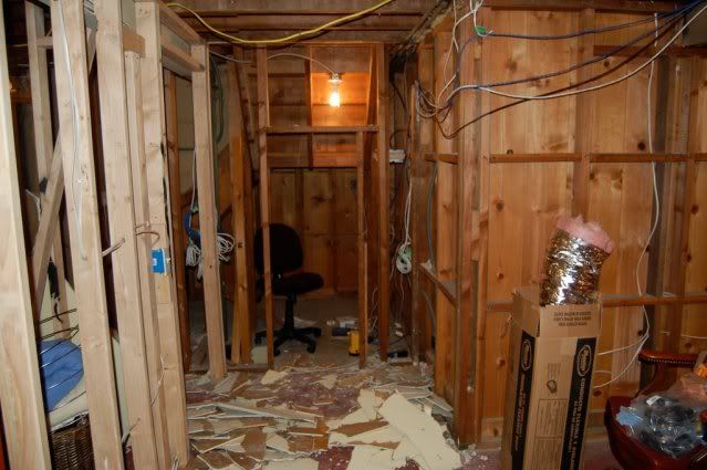

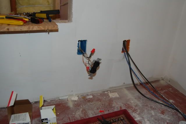

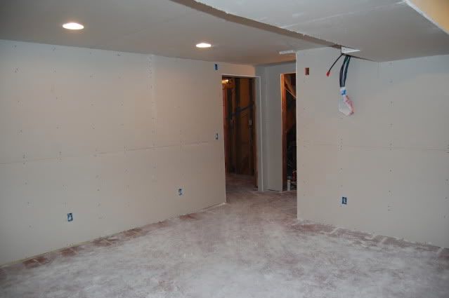

OK, it's been a while since I shared one of my many screw ups ...
As I was in my recent mad dash to finish the HT & laundry room before the drywall guys arrived, I suddenly realized that I almost forgot to pull romex for the planned low voltage trey lights. So, being a veritable electrician by this point, I pull some romex up off of the nearby floor outlet boxes to the logical spot near the ceiling to plug in the low voltage lights, while simultaneously patting myself on the back for thinking of this before the drywall went in the next morning.
You can kind of see one of the two outlets I'm talking about here, in this photo, almost above the entry door.
Fast forward a few days, when I get my electrician to swing by to connect the new circuits to the power panel and do some other odds and ends. He looks over the work I've done - all of which except the trey light outlets were done after reviewing plans with him - and he nods approvingly until he notices the new outlets near the ceiling and asks, "And what are those for?"
I proudly tell him about remembering at the last minute wanting to do the trey lights, and figuring out all by myself at midnight how to just pull power off the floor outlets, waiting for more electriciany praise.
"Ah huh," says he in his best nonchalant, Minnesotan way, as I start primping my tail feathers for my anticipated strut down the electricians' hall of fame runway.
"And where is the switch for it?"
"Switch?!", says I in my best 'you can't fool me, pretending I have a clue' voice, "why in the world would I need a switch for an outlet?!"
"Well, no reason really ... as long as you want them to always be on. Is that what you had in mind for these fancy lights?"
Fortunately, I still have access to the electrical behind the drywall from the laundry room to fix one outlet, but the other outlet will test my nascent wire fishing skills (and I use that term 'skills' very loosely). I figure that will only set me back about a week or so, until I give up and pay my electrician to just come in and do it right.
I can't wait to discover my next screw up!

No switch... Been there done that. You could always say you were planning on using a wireless switch so you could control it with your remote control from anywhere in the room...
How did I know I was going to do that?
Phase one dricore materials purchased, hauled down to the guest "bedroom", and ready to go down on the floor. Just need to borrow a saw and find the time ... Here's a shot with about two thirds of the dricore hauled down.
Well, that and buying a new gallon jar of Motrin, as an old hockey injury to my left knee makes doing any flooring a special form of torture.
Thanks guys for talking me into doing a subfloor. I got your numbers now, and I never forget ...

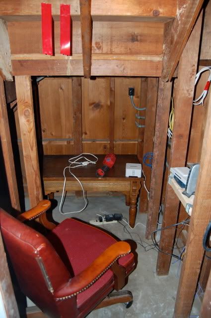

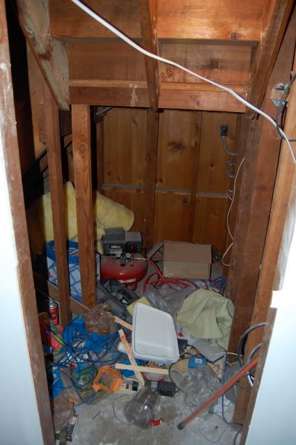

Now for some transformation of the former under-the-stairs storage area into something that begins to be recognizable as a future equipment closet.
To recap a bit: in recent weeks the closet has gone from this
to this
to this. Here's the shot showing closet with all the tools and crap thrown helter-skelter to quickly get them out of the way of the drywall crew. The cables were originally nicely coiled and organized, but while we were away sampling wines in California my dear neices and nephews found their way into there and reorganized things for Uncle Hanes.
Bless their little hearts!
I've since found that an effective way to prevent this happening again, while entertaining the little dibbins at the same time!
OK, where was I before I got distracted with babysitting duties? Ah yes, cleaning up the closet ...

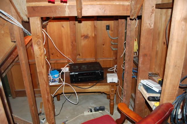

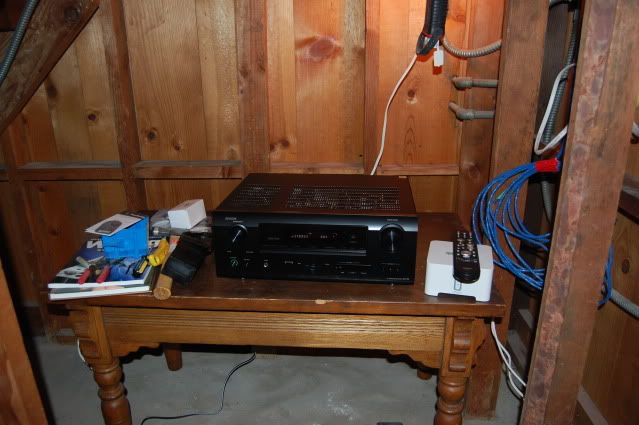

Presto! By the magic of time lapse photography, the equipment closet is clean and in the process of assuming it's initial state simply using spare tables and such. Fancier equipment racking and such, if any, is reserved for further down the road. Stay tuned ...
The new receiver assumes the position atop the high tech rack coffee table.
And is eventually connected to the front L/R speakers, just so I can test it out and get some music to work by.
And here's the "after" shot, once I finished connecting a few more cables and wires and such.
