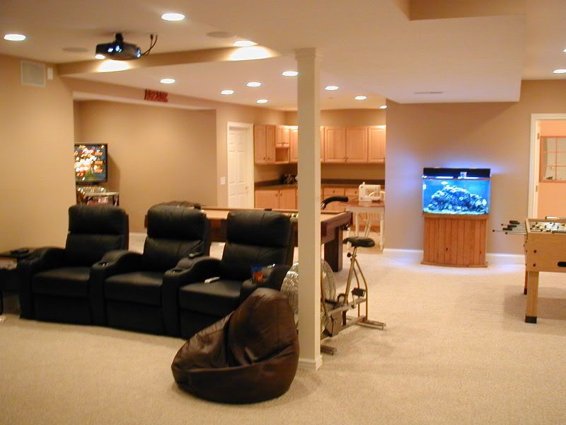

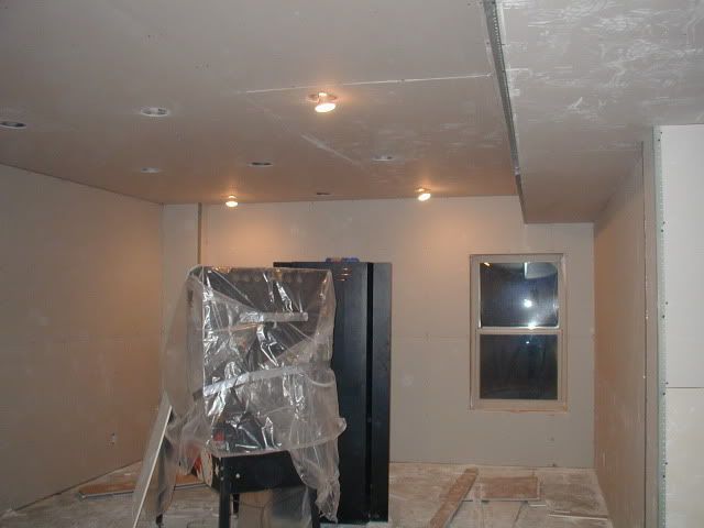

My soffts around the perimiter of my room (18" wide at the sides; 30" in front and back, and ~42" wide in center) are right at about 7' high, and these don't feel too low.
However, my PJ is mounted on the center soffit, and the clearance under it is about 6'5 or so... and while I can walk under it, it feels pretty close. I think much of it will depend on the flow of foot traffic in your room. If it's just around the perimiter, or over seating, I think it would be OK.
Oh, and I agree about matching them up throughout the room... the symmetry makes it feel like a design feature, rather than screaming "Ducts and pipes I couldn't move HERE.". My side soffits are for aesthetics (and to house can lights), and my center soffit is larger then necessry to cover my off-center I-beam, yet have the soffit centered in the room:

post #242 of 1799 Old 05-14-2009, 04:06 PM - Thread Starter
hanesian's Avatar
Posts: 2,861
Quoted: 36 Post(s)
Liked: 84
Originally Posted by pennektj View Post
The other thing I was thinking about is start frmaing out the soffit where you KNOW you will have to have it... and then from there you can get an idea of the type of space it will take up and determing if you want to match it, or just do it where you need it.
If you take a look at my build thread, you can see an example of both. In the theater I did a matching trey all the way around. In the poker room, I did a standard box soffit all the way around and in my "office" I just built the soffit where it was needed. It might give you some more ideas.
Good luck and can't wait to see how you "solve" it!
Holy carp, Tim - that double trey/soffit you did looks amazing! I see how that step helps avoid one big, thick soffit. Very nice. But making all those soffit pieces like you did must have taken forever! And, most importantly, required skill! That skill part may well be above my pay grade!
Amazing work Steve, and what a result you got! Of course, I'm going to say you cheated - anyone whose wife can - and does - help out by operating power tools ... well, it's just not fair!

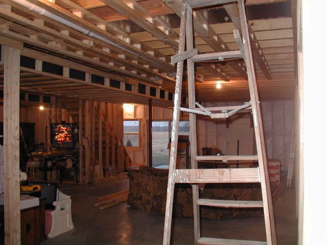

First off, I have really enjoyed reading your wit, I mean thread...
Very entertaining!

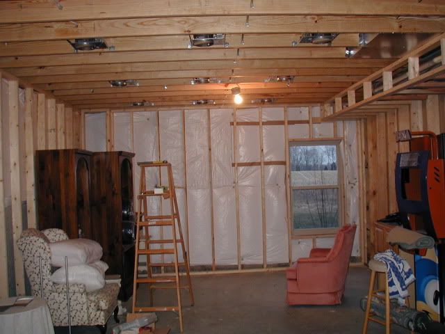

It looks like your main furnace lines running over the windows are running with the floor joists... Couldn't you push them up into the space between the rafters? Then back down on the wall where the door is... It might restrict the flow a tiny bit, but then you could go full height over to the windows which would look great, and only have the drop down by the wall... Or maybe... Whats behind the wall? Could you put them on the other side? Or is it just a regular wall and not load bearing? (most basement walls are not load bearing) you could put the duct work "inside" the wall...
If you are limited to leaving them where they are. (remember they make aluminum foil coated cardboard that is very easy to work with and is used to make your floor joists become the supply lines for hvac).
Put your studs sideways so that you lose the least amount of space.
and dynamat your metal ductwork and eliminate that annoying boom when it kicks on, or when someone walks over it.
Ceilings are a pain... I had tons of support beams, ductwork, plumbing drain lines from the kitchen upstairs. But, I did the best I could and framed around everything focusing on making the ceiling as high as I could. It ended up being 8'10" at the highest, and 7'7 at the lowest. But, those extra few inches really make a difference in feel.
more framing pics.
more framing pics... See how you can run water lines through this 32 frame... Oh, whoops, wrong kind of frame...
I used that foil coated board to rebuild the ductwork so that it didn't stick out so far into the room, and I ran the pipe inside the floor studs so that I could get away from having to run over my window for the line.
Its not balanced, but... now that it is done, I never even notice it.

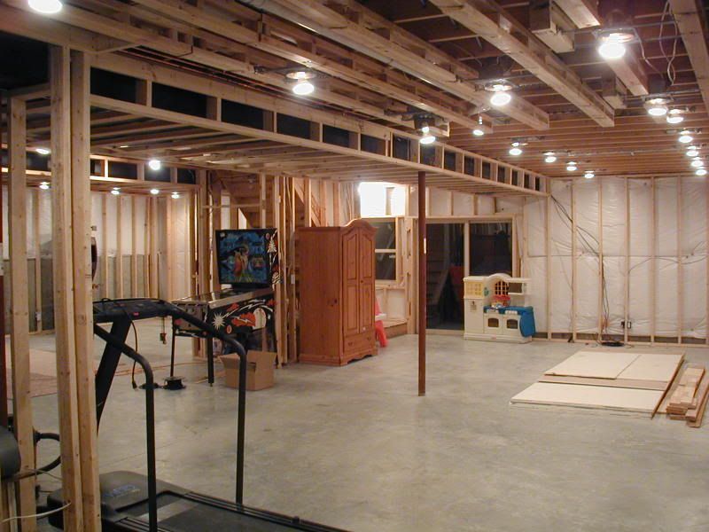

OK, actual progress to report!
No, wise guys, you did not accidentally open the wrong build thread, although you might want to make a note of this on the calendar because it will be a looooong time before you are likely to read the word "progress" here again.
Realizing that I was going nowhere fast using my curent tactics (i.e. staring at the walls and wishing forlornly), I resolved to take action, because I read something somewhere that said nothing happens without action.
Of course, I was also taught not to believe everything I read, which kind of had me confused, but after trying the whole not-believing-everything-I-read bit and getting nowhere, I decided I might as well just give the believe anything bit a try. Worst case scenario I can always sue someone for misleading me.
First order of business was to get the crap out of the way so we could finally see exactly what we were dealing with! We had too much crap in the basement when we started this project back in the early seventeenth century, and that expanded exponentially when the kid I used to have came home from the service and took up residence in the construction zone, which he once knew as his bedroom. For perspective, here's a pre-weekend view of the once and future construction zone, which had started to regress back to it's original state of a bedroom. (Decoration by Peppie Le Pew!)
So I rented a storage pod thing for the driveway to absorb said crap and sundry related stuff so we could get jiggy with it. That thing is bigger than it looks - 8' x 8' x 16'.
Here's a view of the pod from inside the garage.

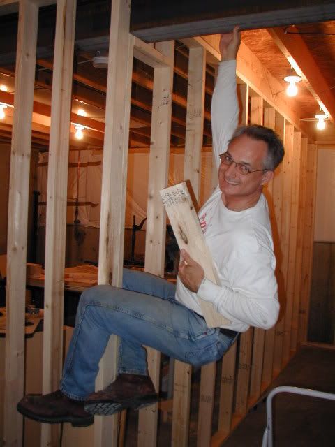

Second order of business was to recruit both skilled and unskilled labor. My builder buddy Chris came through for me again (I think his wife needed a break) in the starring role as the skilled labor and only one in the general vacinity with half a clue, while joining me in the supporting unskilled role was my son and a couple of his young friends, who did a marvelous job of coming through in the clutch, just before Chris arrived, and moved all the stuff from one half of the basement up and into the storage pod.
(This is where a lesser man would shaelessly and publicly give his son well deserved grief about being too hung over to do this moving work a day earlier as he had promised his old man, but I'm far too big for that sort of thing.)
The Three Amigos trying to get a round peg into a square hole.
And - shockingly!! - succeeding!
Obligatory young buck victory dances:
The one with his best, um ... face forward is, I am obliged to admit, my son. I think he must get his warped sense of humor from his mother.
I will just point out that the hideous couch is my son's, not ours, and despite it's state of disrepair he fights my constant suggestions to chop it up and feed it to the termites.
OK, back to some actual building!
Next order of business was for my buddy Chris to "help" me (cough cough, do everything, cough!!) finish the framing that had now langushed for the past couple of months. Those with great memories (and pathetically boring lives) will recall that a few weeks back I had managed to focus all my "talents" over the course of a weekend to frame an 8 foot section of wall, but other than that the framing had come to a standstill.
I was like a proud father showing off my handiwork to Chris. So you can imagine my pride when Chris took one look at what I had done and announced: "dude, the first thing we gotta do is fix this wall here." Here he is with his Sawzall fixing my masterpiece wall.
With that bit of humiliation out of the way, we kicked into high gear and, even with my frequent cutting mistakes (Dude, 23" is not quite the same as 33", but nice try!) by the end of the day, had finished almost all the framing, including the walls between the laundry room and the bedroom.
Here is a view of the area near the start of the day.
Making progress ...
Cans going in. Another advantage of being 6' 5", like Big Foot, is who needs stuff to stand on?
In the home stretch. View from the bedroom looking towards the laundry room.
And reversing orientation, from the laundry room looking back towards the bedroom.
And finally from the laundry room looking out through the door towards the stairway and the future HT room.

Thanks. We're here every Thursday and Friday night. Can you tell me more about this aluminum foil coated product? I've never heard of it and a quick google search didn't turn up much that I could decipher. I'm not sure how much time/money/effort I want (or can) spend on fiddling with those main ducts, partly because they are located in a spot that doesn't present that big an issue for the way the room is used. Still, if it wasn't a huge project cost or time wise, maybe ...
Oh, whoops, I just found this...
Well, I have a box of it next to my furnace, so I'll check on the name of it and let you know.
Here are some tips for your cutting project. My father in law owns a large printing company where I work. So we have tons of paper... But, when working on a project, where you are doing muliple cuts, it would make sense to use paper to write down the dimensions... If your like us, you just don't have any, so write it on a piece of scrap lumber, then when you are "hanging around" waiting for the saw, you won't forget.
Here you can see a single duct using that product.
And a double duct...
I will check on the name of it, tonight when I get home as I have about 3/4 of a box left. My HVAC contractor got it for me.
00
Making progress ...
But other than that, it was a pretty quiet weekend ...

post #267 of 1799 Old 05-23-2009, 08:39 AM - Thread Starter
hanesian's Avatar
Posts: 2,861
Quoted: 36 Post(s)
Liked: 84
Originally Posted by bwcafishing View Post
Hanes,
Great progress thanks to your non-virtual bigfoot Chris. Still can't wait
to see a pic of you putting something up.....
Your wish is my command. Here's a shot of me putting something up.
Hey, while you're up, you mind grabbing me another gin and tonic?
The Un-Theater Un-Build
hanesian is offline
