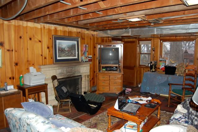

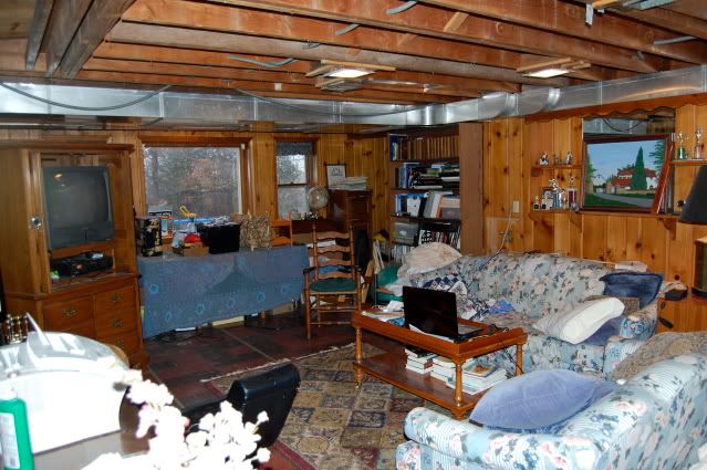

First, some before photos of the basement pre-project, to give you some perspective (and laughs). If you are actually here looking for the promised explanation, you're proof positive that you can fool some of the people some of the time!
Actually, I figured that unless I humor the mindless hoards with an immediate fix of floorplan & photos no one will stick around long enough to sample the real meal that awaits right around the corner for those intrepid souls persistent enough to persevere through my BS. So, without further ado, here are some before photos.

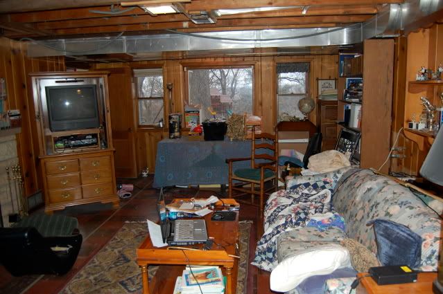

Old rec room. These weren't entirely pre-project, as the old acoustic tile ceiling has already been demo'ed. That was very satisfying. For me. For the wife, it was shocking, as I gave her my typical advance notice of attack ... none. What can I say - it was calling out to me to destroy it without delay!
Old rec room, featuring our totally awesome, state-of-the-art 24" TV & VCR (note the complete absence of any DVD player, which is rumored to be just a fad. And don't even get me started on the BluRay thing!).
Also, please don't ask where our 8 track tape player is, or I may have to get rough with you.
I choose to focus on the positive in this set up: the bar is very low moving forward in order to achieve the "wow" factor with just about any improvement we make (including taking a baseball bat to the entire setup).

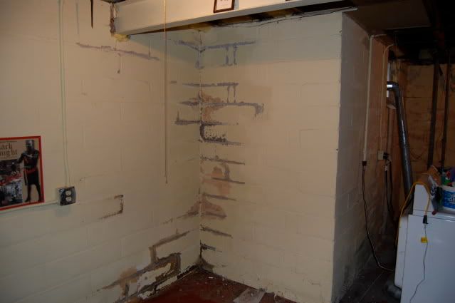

Rec room, looking towards my office in corner (behind the bookshelf).
Old Rec Room, looking past my always-computer-playing daughter towards stairs and laundry room beyond.

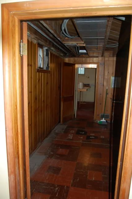

Entering the old rec room / future HT room (dig that happenin' shuffle board tile floor!!) Note the obvious signs of water damage on the floor near the wall also, and be thankful for what you've got.
The Western (or Wailing) Wall (future screen wall)

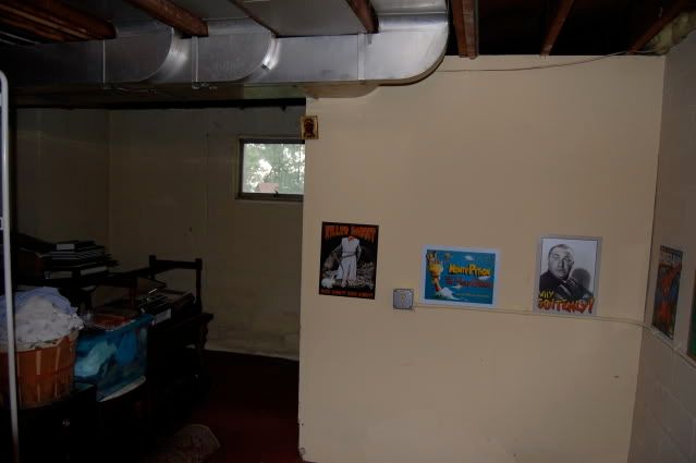

Old Teen Bedroom / Future Teen Hang Out Room complete with obligatory rad wall posters

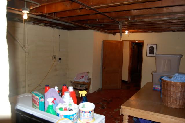

Corner of same room, with a view of some of our lovely moisture problems
Once and future laundry room
And a different view of the laundry room, showing yet more evidence of the mold and moisture seepage

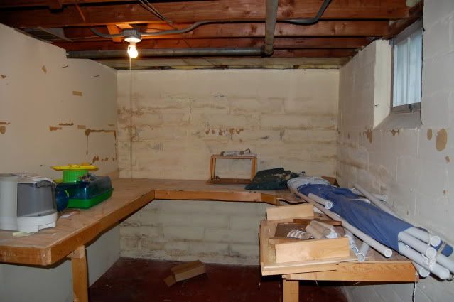

Former storage area, future site of the best little sauna this side of Helsinki. This will be Sauna 2.0 for me, although 1.0 was in a different house, long ago and far away.
Now, at last, time for some 'splainin'!!

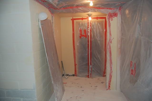

June 2008

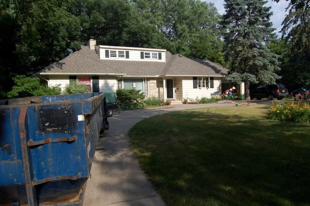

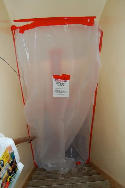

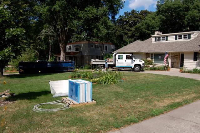

Once we realized we had to deal with really getting rid of some serious mold in this old house we bought a few years earlier, we brought in the pros, and they went to work over the course of about a month.
The dumpster arrives, heralding the start of something big.
Next came the people who took big gobs of our money, but did a good job.

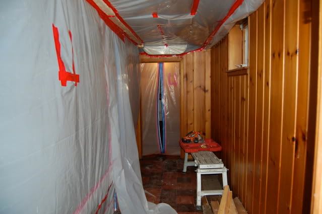

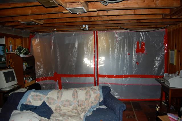

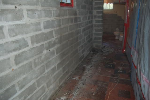

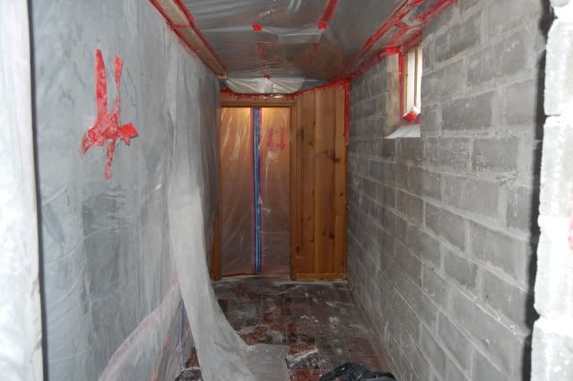

And the long process of preparing and containing the work area began
The mold guys make a huge mess, but they really take their time to set up the containment barriers and fans and such to contain and properly exhaust the air so the displaced mold spores don't simply find another spot in the house to land and become active again. Those mold spores have a lot in common with teenagers, only smaller and quieter.

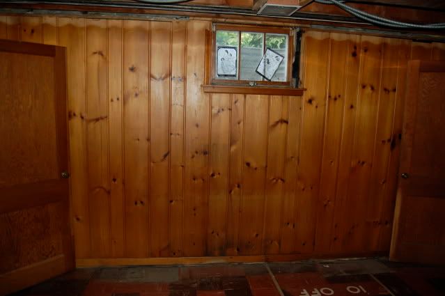

Take a last look at the paneling on the Wailing Wall, which will have to go in order to get access to the moldy cinder block behind it. That window - actually the window well - was also a factor in this, as it was clearly the source for water occasionally getting into the basement during big rain storms. Going to need to correct the source there too.

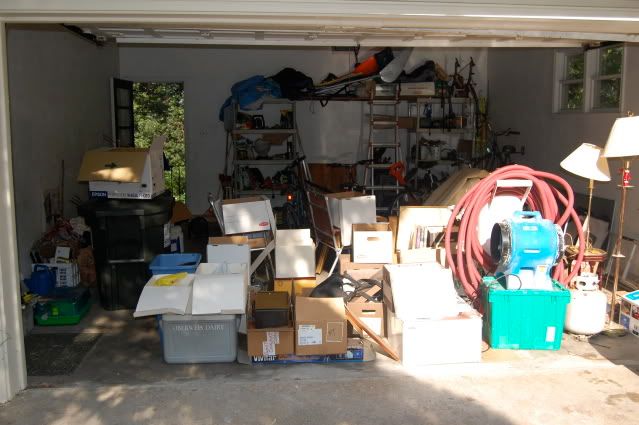

Of course, before we could actually begin this project we had to deal with the inevitable domino effects of temporarily converting space used everyday by a family to an unusable construction zone.
First we had to relocate as much of the crap, er I mean treasures, that accumulate over the course of some years, especially in unfinished basements and storage areas. Most of it found it's way to the garage, which seems like a lot of prime space to waste on mere automobiles.
If we were only dealing with the basement that would have been the end of it, but of course that would be too easy. Because we also had to simultaneously demo the bathroom on the first floor - otherwise known as our primary family bathroom - in order to open up the walls to get at the mold that formed behind the shower walls because of old plumbing.

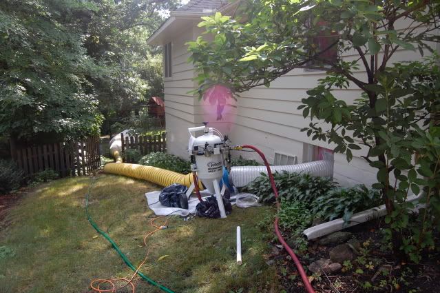

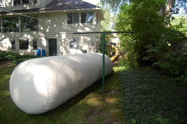

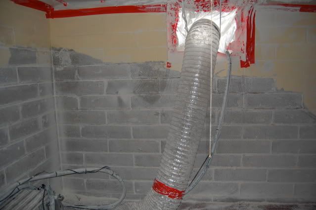

OK, so once mold dudes had removed the various superfluous parts (like walls and showers and infested framing) they transformed into astro-mold-nauts and began getting rid of the mold in earnest. They wore get-ups pretty much like real astronauts, but since I couldn't get into the quarantine area to take any pictures of them in uniform, this will have to suffice for giving you an idea of what they looked like:

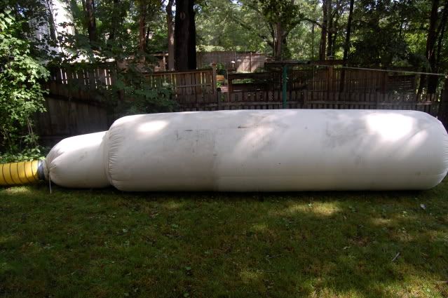

A key part of the process is making sure the disturbed mold spores do not become airborne and migrate to other spots in the house, where they can lie dormant for years until the right conditions reappear (perhaps some really hot female mold spores in mini-skirts suddenly appear to entice them from their couches?) and then once again they step out and strut their stuff.
So in addition to the containment barriers pictured earlier they also had an elaborate exhaust/ventilation system exiting the house and going to our back yard, precariously close to our kids' playset. Somehow they seem to have survived that, so I guess we still can't retire just yet.
I think that pink haze in the first photo must be one of the mold monsters being caught on film while trying to escape the mold-busters protoplasm storage containment device!

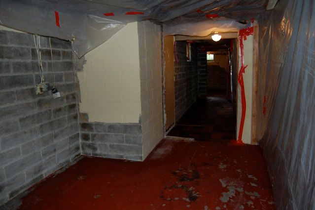

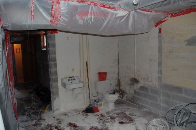

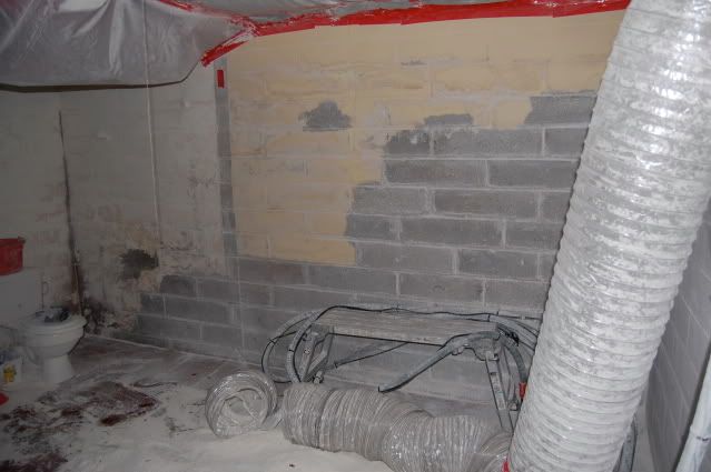

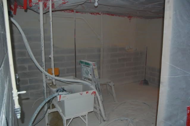

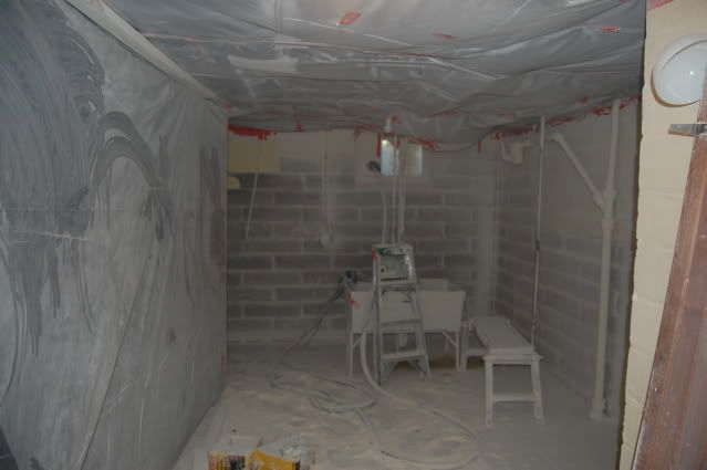

The process involved essentially sandblasting the infected walls, but instead of sand they used baking powder of some sort. Don't ask me to explain the science behind it. I just pay for it, while harboring suspicions that those guys turn on their loud blasting machines and exhaust fans while they sit behind their quarantine barriers laughing and drinking beer while watching a football game on a portable TV they snuck onto the job site.
Whatever. All I know is this is what it looked like inside, at the end of (I believe) the third or so day of attacking the mold.
First the Wailing Wall in the old rec room.
The bathroom area, with the door at left leading back into the rec room.

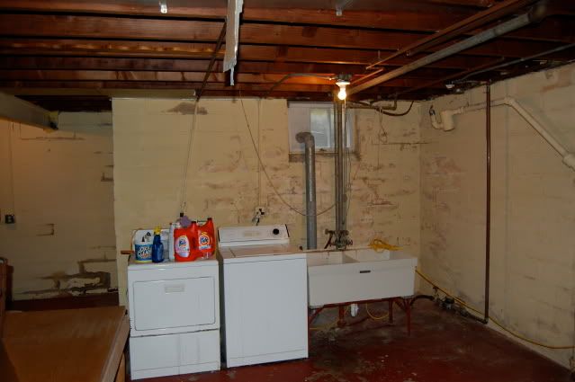

The laundry room area, looking towards the door to the rec room.
Looking into the laundry room from the door to the rec room.
More of the laundry room. This photo shows the baking soda residue on the floor and the walls showing where they blasted bare as opposed to the original painted portion of the wall higher up.
And a shot of the exhaust hose vented to the outside.
Here's the bathroom & (future) sauna area. You can also see the exhaust hose on the right leading to the window outside.
The Un-Theater Un-Build

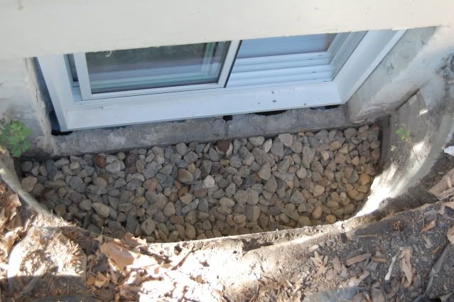

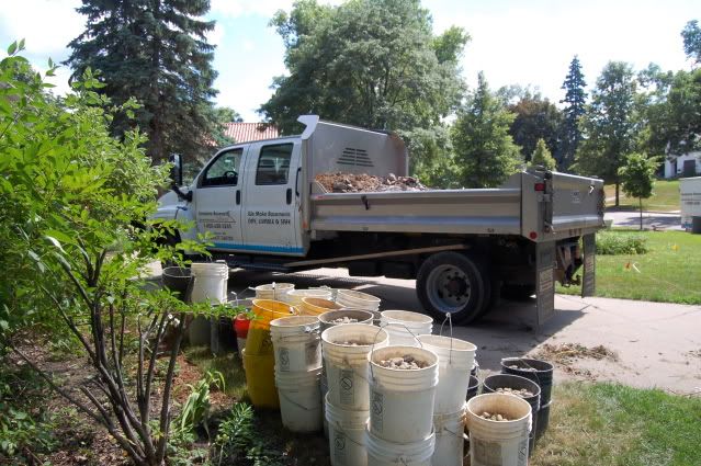

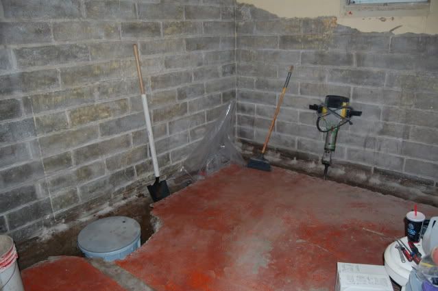

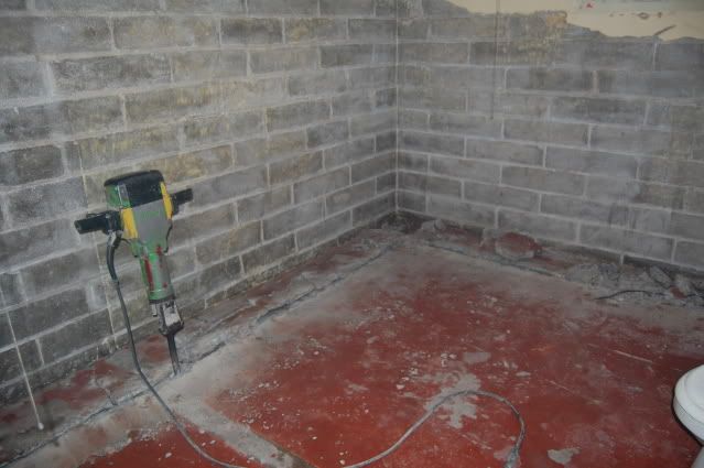

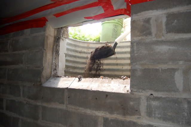

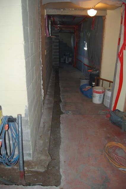

Now that we had finally gotten rid of the mold and the astronaut suits, the next phase was to attack the original causes of the mold to make sure we could better manage that moisture in the future.

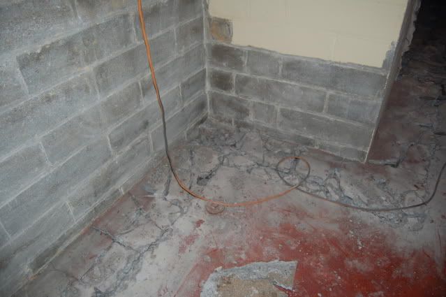

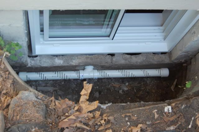

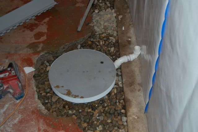

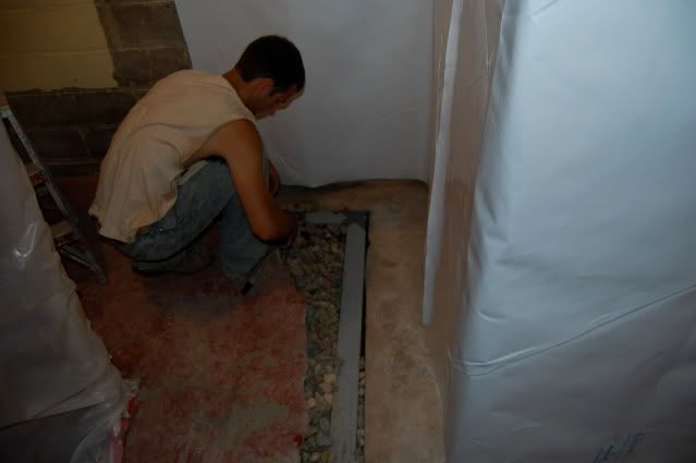

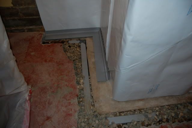

So we had drain tile and a sump pump installed along the perimeter of the below grade walls.
Here's a shot of the front facing wall after the soda blasting was cleaned up but before they started excavating the trench for the drain tile.

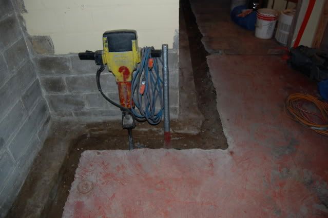

Here you can see the portion of the floor that has been jack-hammered apart, but with the concrete still in place.
I can say from experience that it is much easier to be the one watching that process than the one doing it!

While all this blasting was going on, things were a bit loud around the old homestead, or so I was told by my wife and daughters. I was seldom there for quite a while as right around this exact time - when things were so slow at home - I changed firms. That move, at least, had been in the planning stages for quite some time, unlike this entire project, so it was on with the show!
Good thing sleep is overrated!
Plus, I figured if the new gig didn't work out as anticipated we could always escape the project all together and downsize to one of these nice condos I saw advertised recently:

As the month drew to an end so did the last stages of the mold remediation part of the project. The next step in the process was digging out the trench where the drain tile was going to be installed.
Here's a view looking down the length of the west (below grade) wall, from the laundry room looking through the rec room to the bathroom area beyond.
Here's the sump pump pit going in in the bathroom / sauna area.

Next up in this saga we have the installation of the drain tile. Observant readers (which would exclude YOU - yeah, I'm talkin' to YOU!) will also notice the special vapor barrier than tucks right into the drain tile system. The rest of you un-astute readers will be totally oblivious, as always.
And the sump pit area as well.
Here's a shot showing just some of the pails of rocks that were used to fill the drain tile pit. All of this had to be hauled back around the house and into the basement. It really broke me up watching those strapping young lads busting their, um, backs hauling those suckers while I sliced up some of those lemons I had been dealt and made myself another gin & tonic.

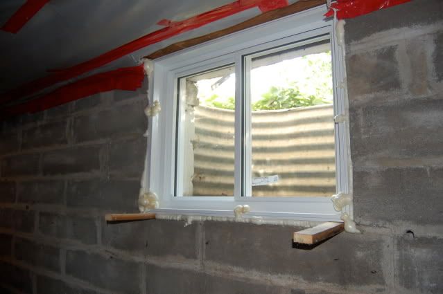

First it's out with the old window, and digging the window well lower so that we could install the drain system.
The windows sitting on the front lawn.
In with the new window ..

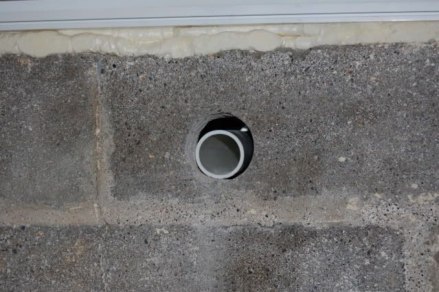

Looking down into the window well at the pvc drainage system, which as you can see empties through a connector piece through the wall ...
... and into the inside, where the system is carefully designed so that I then scream like a banshee and then find and kill the people who installed the system!
Either that, or it is designed so that the water will flow into the pvc, and through the wall in the pvc connector pipe shown below from the inside ...
... and is then routed into a channel which runs straight down to the drain tile in the floor (somehow missed getting a photo of that so you voyeurs are S.O.L.), and then onwards to the sump pump and out of the blasted house, back into nature as God intended it!!
We did this on both the windows with window wells. That oughta show those slimey windows who's boss around here!!

Finally, here's a view of the window well with the rocks in, and only the caulking and finishing work to be done.

OK, I feel like I durn well better pause from all the mold remediation stuff to introduce a smidgen of talk about ... <<gasp!>> HT stuff!
Because of the way this project started - bass ackwards with no warning - I was caught completely unprepared for this public exposure and yet managed to start with the following totally awesome HT set up:
  • 24" SD TV, 14 years old (Panasonic if that matters a whit)
  • Almost new (10 year old) VCR of some brand, don't know or care which (does it matter??)
  • Period. That's it.
  • There is no more - why are you looking here.
  • I'm serious. Just an old TV and VCR.
  • Nope. Not even a flippin' DVD player. Had a $20 one that - incredibly - broke.
  • And don't make me laugh by asking about any sort of video system. WTH would I do with a video system?!
I can almost hear the collective sighs of deep rooted envy emanating from across the interweb, or "information superhighway" as we tech heads like to say. Your equipment envy is completely understandable. Who could blame you?
Still, incredibly!, despite this state-of-the-art HT set up, I am not satisfied. Being the early adopter, cutting-edge techno-geek that I am, I crave the latest and the greatest, just like everyone.
In particular, I was thinking how cool it would be to be the first one of my friends to get a DVD player, and maybe even a remote control!!
Eat your hearts out, riff-raff! Mwuha-ha-ha-hahahahahaaaaa!!!
