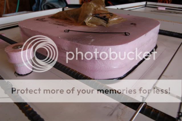

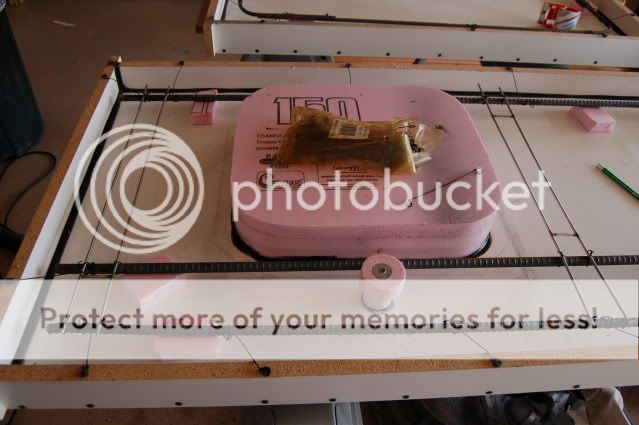

OK so it's time to make the molds. The method I choose to use was to pour the concrete in a mold which will mean that it's upside down and backwards. I'm using 3/4" melamine cut down to the sizes that I needed ( I had the big box store do this to save time and hassle). I then screwed the 3" wide strips to what will be the top of the counter using 1 1/4" drywall screw, predrilling first to avoid stripping out the holes. This will give me a finished overall thickness of 2 1/4".
The next step was to caulk all seams with black silicone to make a waterproof area inside the mold. Using black simply makes it easy to see where you put the silicone and as your smoothing the seams you can easily see if you left any behind. Anything and I do mean anything left on the melamine surface will show up on the finished surface. You may want some things to show up on purpose that you added (fossils, coins, etc.) so just keep that in mind before you pour.

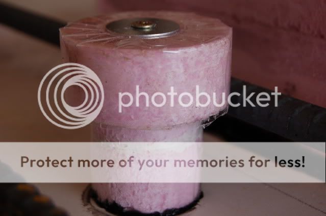

For the sink and faucet I used 1" rigid foam. For the sink opening I took my bar sink and put it upside down on the foam, reached inside the drain opening and traced the shape. Then it was a simple matter of cutting this out and repeating two more times to give me an overall thickness of 3". The faucet was made using a hole saw. Both were then wrapped with clear packing tape to make them easier to come out later.
More to come

This is really cool... I am trying to figure out how the foam blocks supporting the rebar don't affect the top of the counter... I can't stand it

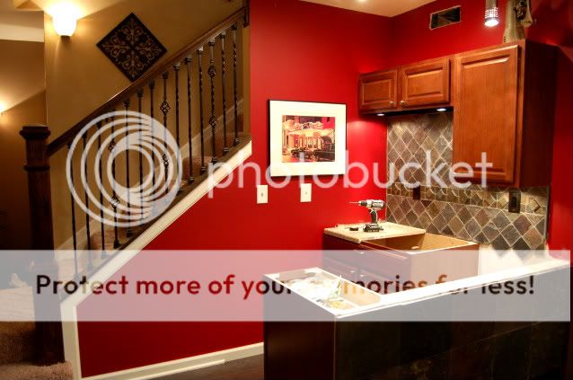

This is a work in progress Home Theater. I wish I would have found this great forum before I started, it would have saved me sooo many headaches!!
This is the bar area where the concrete is going. I still have some finish work to do, but you get the general idea of the layout.
Looking toward the stairs going up.
Standing on the stairs.
Looking into the Home Theater.
Finally, one shot of the theater itself with the temporary couch and table until I can find a close match to the theater chairs in a sectional.
Thanks for looking!

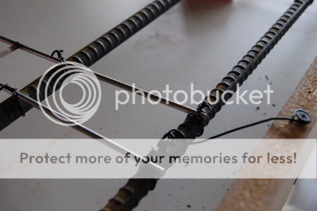

Can you provide a few more details on the steel rebar and wiring that you showed in your pictures.
post #10 of 192 Old 06-01-2009, 08:54 PM - Thread Starter
mmeister's Avatar
Join Date: Oct 2008
Location: Columbus, Ohio
Posts: 182
The re-bar that I used is 1/2" thick around the sink area and 3/8" everywhere else. If I did it all again I'd use 3/8" only because it's thin enough to be able to bend it using black iron pipe as a sleeve and then bending the 90's. Around here Home Depot only sells 1/2" where Lowe's sells both sizes.
In the pictures you can see cross pieces which are stainless steel. They are really used for support in glass block windows but work very well here. They sell wire ties in bulk bags of maybe 100. These are used to secure the the different metals together as well as secure the re-bar to the mold (drywall screws on top). I used small pieces of rigid foam to hold the re-bar up off the melamine temporarily until the wire is in place, then the foam can be removed and the re-bar will "float" above the melamine.
After the cement is poured and sets up for a few I'll cut those wires to the top of the mold as close to the cement as I can and tuck them in the still wet cement if needed. Keep the questions about the bar or theater coming!(I'll talk about cement mix/ratio/additives next)

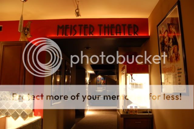

Someone asked about the letters for the theater.
http://www.craftcuts.com/wooden-letters.asp
I primed and painted them. Glued 1/2" wood plugs to the back so they stand out from the wall(cant see that in the pic). Then using my brad nailer I secured them in place after measuring and drawing out the spacing. Hope that helps

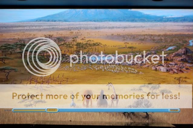

How about shot of your screen wall? everything looks great.
post #12 of 192 Old 06-03-2009, 08:34 AM - Thread Starter
mmeister's Avatar
Join Date: Oct 2008
Posts: 182

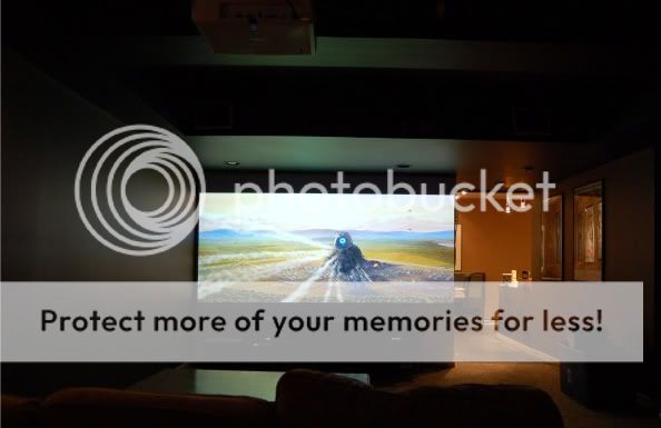

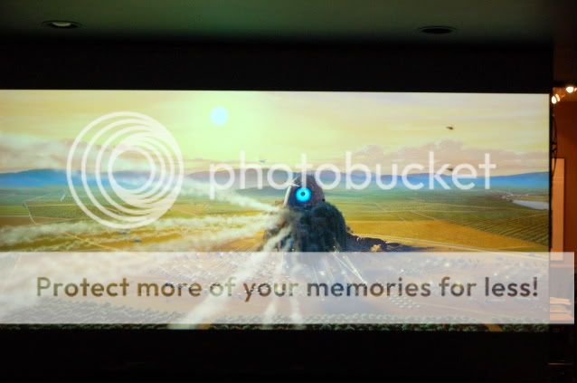

Some screenshots I took real quick. Pics are slightly blurred because I just hand held the camera. The screen wall measures 120" and was done with four coats of Behr Silverscreen sanded to achieve a smooth surface. If your on a budget I think this is a great first screen but I'll end up getting some sample screen swatches and trying out others in the future. Projector is an Epson 6100.
I left the main lights in the bar on for the pictures, but they are normally off or low for movies.

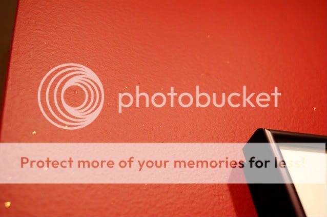

Side note-I added granite dust to the paint in the bar. It's very subtle and you may not pick it up at first but it adds a little spark to the area.

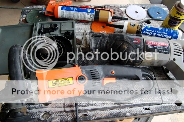

Lee,
To get the look that I have you need diamond grinding pads and a polisher. An angle grinder will not work because of it's high rpm's. Harbor Freight is your friend for this tool as well as the hole saw if needed.
http://www.harborfreight.com/cpi/cta...105&pricetype=
This is the one I used. It's nice because it has a dial for speed control and it maxes out at 3000rpm's and you don't want to go over 4k when polishing concrete. The pads can be found on ebay at a good price also.
The more you grind with say your 50 grit pad the more stuff will show. This is optional and some people may just want a nice rock free look. I went for a happy medium on my first one. It's like a box of chocolate, you never know what your going to get
I'll take lots of pics during these steps. I plan on pouring the beginning of the week when I can get my buddies over to help- it's at least a two man job, three is better!

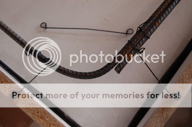

Detail of the re-bar in case there was any confusion. If anyone needs anything explained further at this stage of the game please ask!!
The fun is about to begin.....

You should put curtains along the wall left of the screen. The glare off the screen reflecting off the wall is pretty strong. Awesome looking basement though!
TommyHolly is offline
post #21 of 192 Old 06-04-2009, 01:30 PM - Thread Starter
mmeister's Avatar
Join Date: Oct 2008
Posts: 182
I see what you mean, The camera over exposed the shot a little so it's not as bad as the photo shows. The walls are flat paint. Originally my plan was to have a small curtain along the top, say 4-6" and small sized curtains along the side but after seeing it maxed out in size it's hard to go smaller. This stuff was all done before I found this great forum so I didn't have anyone to bounce ideas off of. Now after finding this place I'm already thinking about HT 2.0!

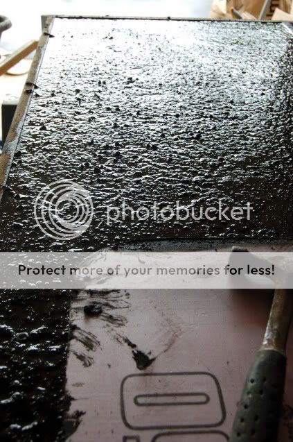

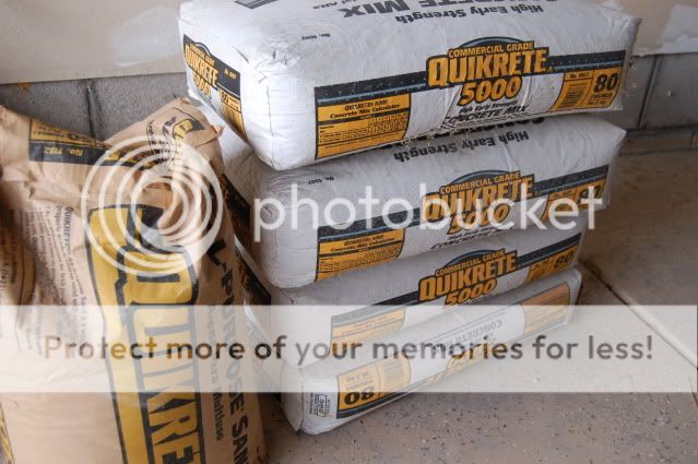

Before I pour, a quick overview as to whats needed to make things run as smooth as possible.
Quikrete 5000- this is the only cement you will want to use. Do not use the 5000 that has air entrapped in it, you do NOT want any more air bubbles in that you will have to remove. The only other mix I wound advice is this for ease of use- a good choice for first timers. I believe you can special order for HD or Lowe's but don't quote me on that!
http://www.quikrete.com/ProductLines/CountertopMix.asp
Sand- I use this to help the mix "flow" a little easier without hurting the psi of the cement. There are chemical products out there you can buy to do this also, but I like to keep it simple. I add about 10% to the cement mix.
Re-bar- I went over this some. Not needed if you are just making a small top or say a top with no holes or little to no overhang. Use it around sinks and overhangs for say a bar top where stools will be tucked under.
Colorant- I use QUIKRETE Liquid Cement Color. The sky is the limit with color. Search the web for cement colorant and you will find a rainbow of colors. I'm using charcoal for mine with several ounces of brown added to push it to the warm grey side.
Anything you want to show on the cement top needed to be added before pour! Broken glass, coins, fossils, old car transmission parts...you get the idea. Use your imagination here. DO NOT use aluminum- this will react badly with the cement and corrode fast. Put a small amount of the silicone on this stuff and "glue" it to the melamine.
Sawzall- This will be used with the blade off. Immediately after pouring take the saw and place the guard against the outside edge of the melamine and pull the trigger. The natural vibration from the saw will move the bubbles to the surface and remove trapped air. Run around the outside and under if you can. A rubber mallet works too, just not as fast. I heard of jigsaws being used or palm sanders also...whatever you got, just beat the snot out of it to get those bubbles out!
More to come!

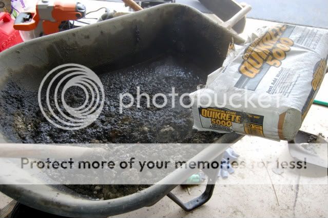

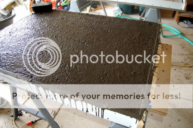

Or how to make a mess and break you back in three easy steps...
Mixing the cement by hand. You could also rent a mixer if you want to make things easy, but come on man up!
I added the color to a five gallon bucket of water and added it to the cement. Mixed it till I had the cement the way I wanted it then shoveled it into the molds paying close attention to the corners and what will be the top edges, pushing and feeling with gloved hands. Fill the mold half way, then using a rubber mallet knock the molds on the bottom to release the trapped bubbles for a minute. Once I had the molds filled up I took the sawzaw to it and vibrated out as many bubbles as possible. This was followed up with sharp blows with a hammer on the bottom.
It's not pretty right now and you will get messy but the end results are worth it.
After the cement has had a chance to set up for a few, the wires are cut freeing the re-bar from the mold. Now the re-bar is floating in the middle. After 24 hours the cement will be at about 1000psi and at day 6 I'll flip the mold over and free it from the mold. Cement will be at about 3000psi and ready for grinding and polishing....and more mess.

Location: Martinsburg, Wv USA
Posts: 2,755
did you use a vibrator on the form to get them bubbles out?
HeyNow^ is offline
post #27 of 192 Old 06-09-2009, 04:59 PM
hanesian's Avatar
Posts: 2,891
Quoted: 30 Post(s)
Liked: 78

I beleive the Sawzall vibrated the mold to release air bubbles. Very novel use of a Sawzall.
I had several beers in me to loosen up the sore muscles and was half taking a drink when I read that.....beer on a laptop from your nose is never a good thing
HEYNOW- I use a sawzall aka reciprocating saw with the blade off. Place the guard against the form and pull the trigger. The vibration that is natural to the saw does a good job of releasing the bubbles from the side and bottom...then I take a hammer( or mallet) and give it some hard thumps on the bottom of the form just to make sure any stubborn bubbles released.
