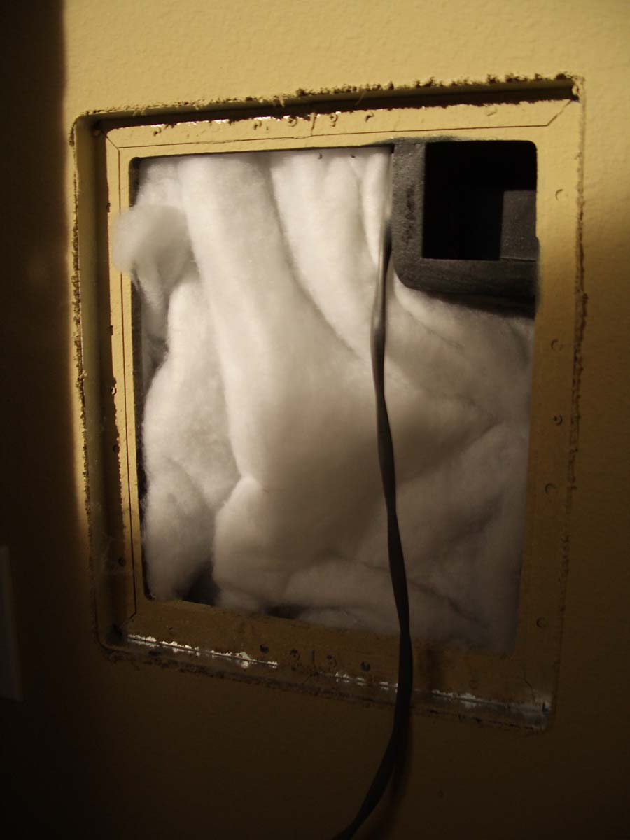

From the article it looks like polyester fill used in pillows and comforters and can be found at any fabric store or you can order from PartsExpress.
Alright cool. Well then I can use that approach in the article and just put a top and bottom on the space behind the speakers and then fill it with that stuff to make it sound better.

Making some real progress now. I've been completely focused on getting the projector hung, because that determines and kicks off the rest of this. I won't know where the columns need to go without having the screen up and can't put the screen up till the projector is hung. Can't finish wires, can't do anything.
So, been focused on my mysterious box. I got it done finally. Took a while because it needed a few coats of mud, then texture, and I had to wait for it to dry. I think it came out pretty good though:
Here's a pic of the box and the cutout for the power inlet:
Here we are with the projector finally hung. I tried to cut it REALLY close on the measurements, which ended up biting me a little bit. But, my dad is here and helped me figure out a solution. I need to drop it down another 1/4 inch. I am VERY happy with how the vision turned out in reality though.
First screenshot. This is plug and play, no settings messed with, no screen, just put up the projector and put a picture on the wall. The is a standard definition DVD being upconverted through a Samsung bluray player. I am ecstatic right now.
