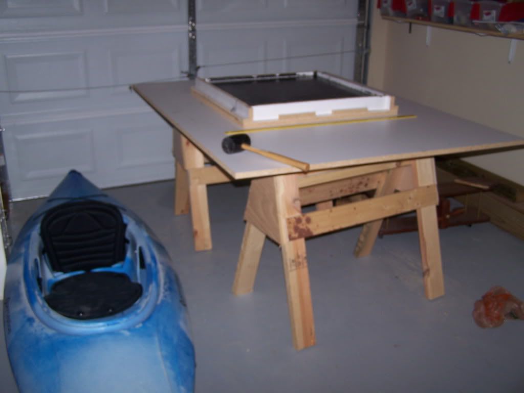

Small progress over the weekend.
Ordered the concrete polisher and pads.
Ordered the Bar Sink.
Bought the dishwasher for the bar (should be delivered today)
Built 4 sawhorses to support the concrete molds.
Gratuitous Wood pile picture (so I started small, I'll work my way up to larger piles)
Completed sawhorses pictures

post #11 of 281 Old 07-06-2009, 09:23 AM
cuzed2's Avatar
Location: Chicago Area
Posts: 4,940
Mentioned: 19 Post(s)
Quoted: 187 Post(s)
Liked: 237
Wood Pile $20.00
Dewalt Circular Saw $100.00
a Dodge mobile tailgate sawhorse combo - PRICELESS !!!
Nice Sawhorses - these should be more than strong enough!

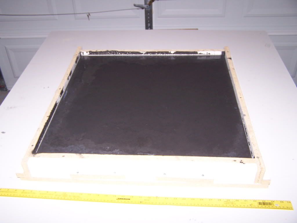

Ok so no concrete yet, I have all the supplies except time. This past weekend was spent reassembling the office. I'm still waiting for the doors to the built-ins, they were outsourced. I can't tell you how awesome it is to be organized again. Here's a few quick BB shots..
(EDIT) I'm really going to have to replace these with better shots... (EDIT)

Ok so GWAPT certification test is out of the way. Yipee I'm a Certified Web Application Pentetration Tester now (whopee). That's a fancy term for employed hacker.
I actually made some progress this weekend and got my garage cleaned out and organized. Which then allowed me to create my first mold for a test "concrete counter". I'll spare you all the details of the step-by-step since MMEISTER provided most excellent documentation in his thread. (http://www.avsforum.com/avs-vb/showthread.php?t=1151574).
So here's my first pour. Roughly 26" x 26" and 2.5" deep. I didn't think it would hold an entire 80 pound bag, but it did. So this is 1 x 80 pound bag of Quickrete 5000 and two bottles of black concrete colorant. One bottle still left it looking a dark gray, and I wanted a deep black. Two bottles per 1 bag looks like it'll do the trick. So in three day's I'll tear off the mold and see how well I did... here's hoping!

Is this just a 2x4 frame? Things are looking good. Been a while since I looked in on you and I am very impressed. I read the concrete counter thread and it was quite intriguing to me. I am curious how you framed this out and if you used rebar etc? I may do this with my back bar area
The frame is melamine covered mdf. Apparently you have to use that to prevent the moisture from the concrete causing the wood to swell and change the shape of your form. I did not use rebar in this slab, it's really just a test slab to check color, consistency, and practice the grinding/polishing process.
I plan on doing a couple of these "Stepping stones or end tables" until I'm comfortable with the entire process. The next test will have rebar embedded so I can see how that's done. My bar area will have two tops around 91" (one with a sink) and one more that will be around 72" so I defiantly need to figure out the rebar piece.

Test top looks great. Did you get a lot of bubbles to come to the top with the mallet, or did you use the ol' sawzall? The 91" top will be two pieces or are you building two 91" tops? If so you may want to break it down to two pieces because a 91" top will be in the 350lbs range. I calculate four 80lbs concrete and one bag of sand for a 91" top. Doable but hard to move and may crack.
