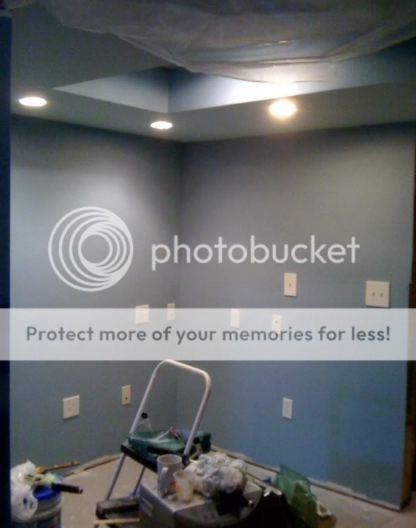

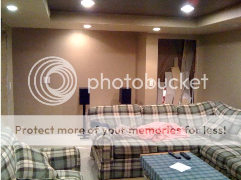

I noticed my recent trend has been to post without adding any images. So, I grabbed some photos I had taken with my phone. They are not great and a little old but, something is better than nothing. I've already rearranged the front wall a bit, finished the wiring to the low voltage trim rings and numerous other, small items.
Here are a couple pictures of the room front and back with the general layout we will be using. We've been using the room and working out what we like and don't like about the set up. One thing we will do is raise the TV about 3-4 inches. The plywood over the subwoofer was there for a test fit.
The second subwoofer is between the back surrounds hidden by the sectional.

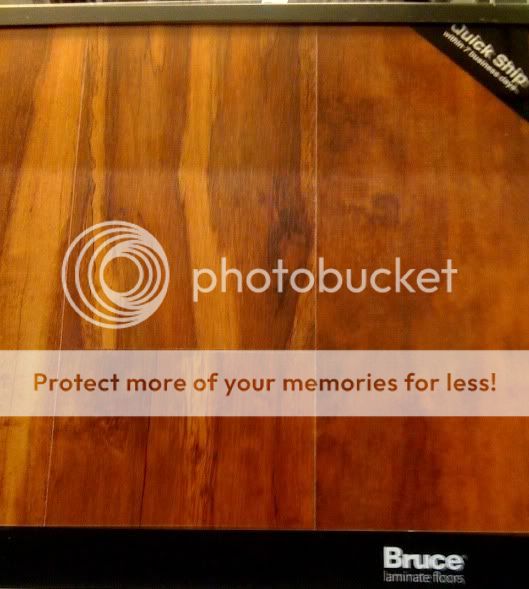

Here is the floor we selected, a floating floor from Bruce Flooring. The materials are due this Friday (11/12) so, with a little luck the floor will be competed by Sunday evening. This past weekend I filled in an unused sump pump hole that would accumulate 1-2 inches of ground water. I filled it with sand and capped it with 2" thick concrete.
Here are the doors we picked to match the ones through out the house. They are solid MDF, six panel colonial doors.
It looks like we have settled on cabinetry for the HT components. The room will have white trim and crown molding, so this should tie in nicely
The subwoofer speaker cover design has been evolving and is in progress. It will be covered in a chocolate brown colored speaker cloth that matches the wall pretty well.

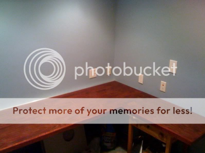

The attached office is progressing too.
Here it is with a built in "L" shaped desk. I will be adding shelving that comes up the left side and across the top. This will have the same floor as the family Room/HT.
I should have some much improved images the middle of next week showing a finished floor. The following week should see the doors installed. Then it is just baseboard trim, the crown molding/rope light and trim out the column in the office and add the shelving.
...Oh, and finish the two closets.
Having to empty the room including the speakers and new receiver are going to be dissapointing only because we have been enjoying it so much. But, I can't wait for these next steps to be competed.

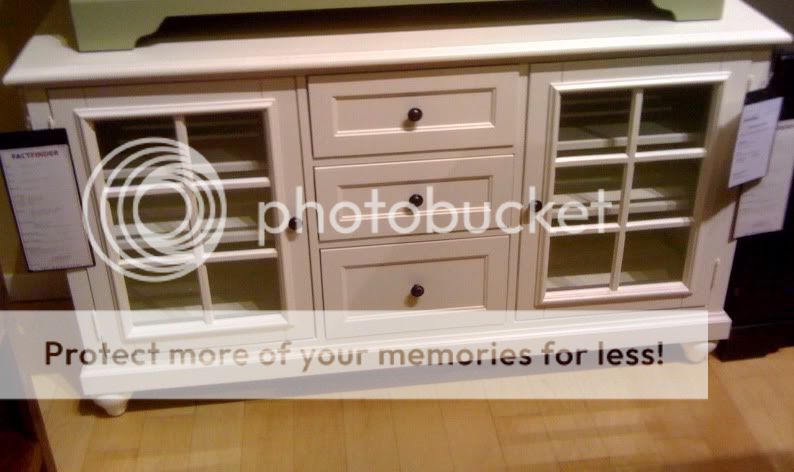

Thanks for the comments. It has been a long, slow process as most of you know. It is nice to be so close to the end.
Console problem solved. We found this one at Jordan's Furniture and it works great with none of the height concern of our previous choice (pay no attention to the pile of cables in the closet).
and a cocktail table to match

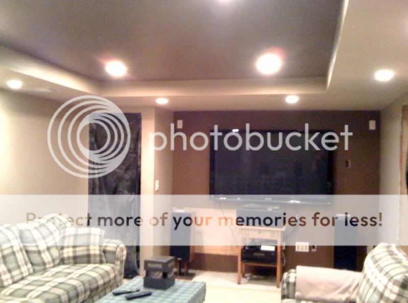

EDIT: I was looking at some older photos of the room and thought I would share one. This photo is a little bit into the framing phase. The basement was a catch all from when we moved and I was simply shifting everything one way or another a few feet in whatever direction I needed to put some framing up.
This is a picture of the same spot as of a few days ago.
There are many things I would do differently but, I'll always be glad I did it.

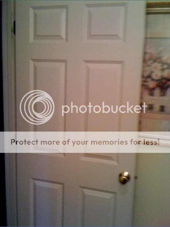

Now for the update:
So, the doors came in and went up. They are not perfect but, I think I am being too critical. The fourth door is the best, it is perfect. The other three doors having learning mistakes that kind of irritate me because they were easily avoidable if I had only known what to do. In the whole scope of the project, the issues with the doors are minor and a year down the road probably wont bother me.
I custom ordered the doors from homedepot and have a few complaints. One door is bowed so that the top corner sticks out almost 1/4". One door I had the trim deleted from the inside and the outside trim was provided uncut and not attached - not a big deal but they all had splits running along the length. I ended up having to purchase new trim. None of the recess areas for the door knob hardware were deep enough or large enough. Almost all of the trim on the doors that had it was pulled away from the door and the mitered corners pulled apart. These are probably not a big deal for experienced installers but, not being experienced, they were enough to slow me down and complicate installation.
Here are a few pictures showing the front and back of the room.
We picked up some basedboard molding and I thought most of it would be installed yesterday but I quickly found out my miter saw only cuts 5" wide boards and the baseboard is closer to 6" wide.
Now its time to find a saw that I can use for the molding...
...Looks like using a little extra force on the miter saw I can just about cut through all but about 1/16-1/8" of the modling. I'll be working on that this week and filling in over the finish nails on the door frames.
If anyone is starting their finish woodwork, Homedepot has a great deal on a Porter Cable Pancake compressor that comes with a 16 gauge finish nailer, 18 gauge finish nailer and an 18 gauge crown stapler. I needed all three and picked up the package deal for $259. It also comes with an air house and fasteners for each gun. Works great. I highly recomend it.

What did you make that desk out of? Solid Doors?

I used a piece of cabinet grade oak plywood, faced the edges with solid oak trim and bought arched, metal reinforced wood supports for a closet shelving system at lowes that matched the desktop stain. I used aluminum "angle iron" along the walls and about six inches back from the front edge for support and screwed into the top through that from the bottom side. Then I added three plastic cable grommets that have rotating slots to adjust the size of the opening for the cables. With the gluing, staining and trim, the whole thing only took three days.

We used Martha Stewart paint: The medium color on the walls is called twine, light color on the soffit ceiling is called cappacino and the dark on the tray and front wall is called Nutmeg.
Updates:
The front subwoofer speaker cover is in process, about halfway done.
2/3 of the baseboard is installed and the rest is waiting to be cut and installed.
We matched the crown molding in the rest of the house for the tray and it is waiting to be installed. I have an idea on how to put it up and allow for rope light but, I may look around the forums for others solutions. My plan is to rip 2 x 4's with a 45° face, attach them to the tray and then nail the crown molding to them.
Some minor Cat5 wiring completed and now the DirecTV DVR, Toshiba HD-DVD and Onkyo Rx are all connected and receiving various updates.
We slightly adjusted the placement of the sectional, chair and speakers and I redid the Onkyo's auto calibration using the six main seating locations. An intersteing find was that on the previous auto calibration, before the floor and doors, the subwoofer was calibrated at 75db. When I went to redo it after the floor and doors were done, it measured 88db.
Basement HT/Family Room | Status: 11.24.2010: 95% Complete, Working on trim and details

Looks great. Curious how that front sub sounds behind the cabinet and front speakers. (Still cracking up about all of the drywall screws!) Nice job.
davekeith is offline
post #59 of 64 Old 01-16-2011, 08:46 AM - Thread Starter
moneypit's Avatar
Join Date: Jan 2002
Posts: 121
The console sits about a foot out in front of it and overlaps it by about 6" so it doesn't really block anything. The front left speaker is about 32" out in front.
There is also a subwoofer on the opposite wall. With the two of them, it sounds better than in my previous room and fills the space with plenty of bass. I haven't noticed any peaks or boominess.
