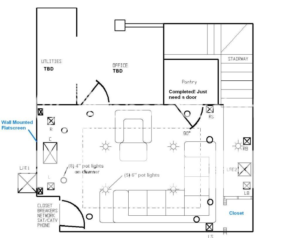

The space will be used as a family room and an HT area for movies and video games. We wanted a room that was focused for HT but, would blend with the rest of the house and be easily used for many purposes. Our current family needs made a more dedicated HT impractical.
Here is a quick, rough floor plan of what is being done with approximate speaker locations for wiring purposes.
We already have most of the furniture and all of the HT gear from a previous set up in another house. So this room has been somewhat planned around this with an eye towards being able to upgrade.
This past week I've spent a lot of hours running electric, A/V, Network and Telephone wiring, insulating and putting up sheetrock. Updated pictures to come.

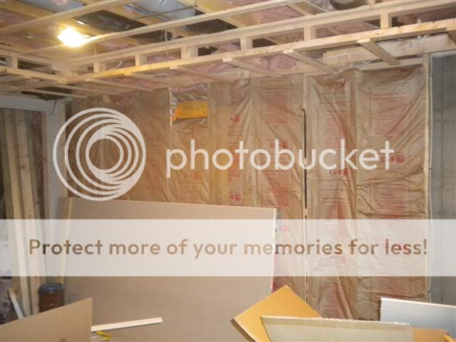

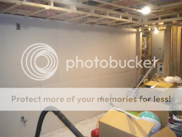

Here are some pictures of the progress.
Side wall going up

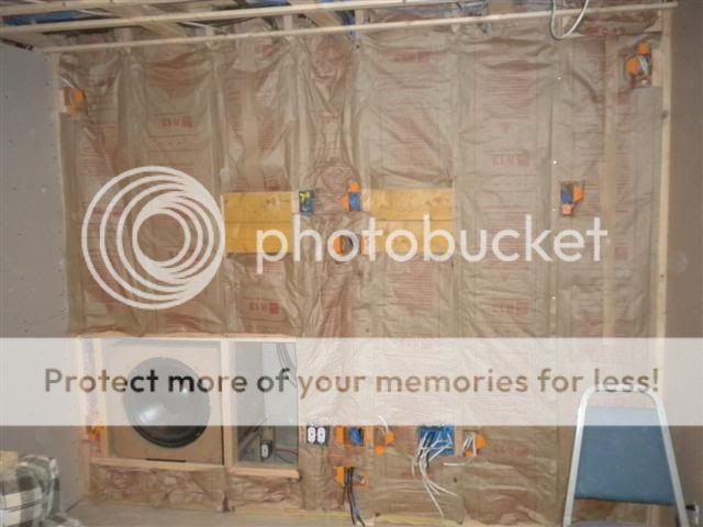

Insulation

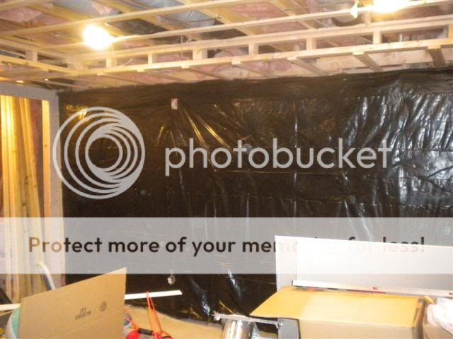

Vapor barrier
Sheetrock

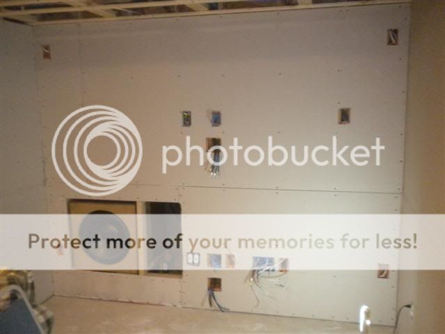

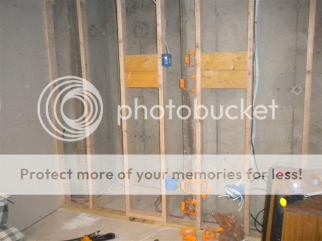

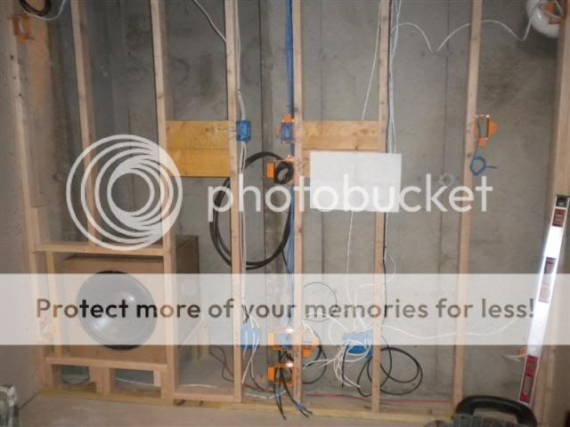

The front wall going through the same process with all the necessary wiring. I reframed the wall to accept the flush subwoofer. The subwoofer is sitting on pressure treated lumber feet and 2 x 4 frame. I'm using a anti-vibration matt under it and beside it that is typically used with industrial equipment. Im hoping this will keep the wall shaking to a minimum. I'm also placing 150 lbs of pool sand on top of the subwoofer to keep it from moving. For those interested, it is an 8 cu. ft. sealed box with a Maelstrom driver from Adire and Parts Express 250 watt amp.

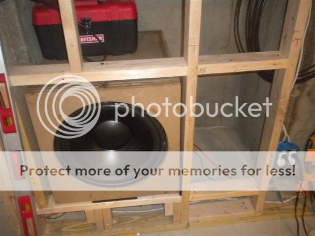

Front wall before subwoofer pocket
With the subwoofer pocket framed and wires run You can see the extra 2x 8's I nailed in place for a plasma mount
The opening to the right of the subwoofer will be covered with the speaker grill and used for access to the sub and in-wall/thru-wall wiring. It also keeps me to code with the subwoofer power. The speaker grill will have a piece of foam insulation sized for the door.

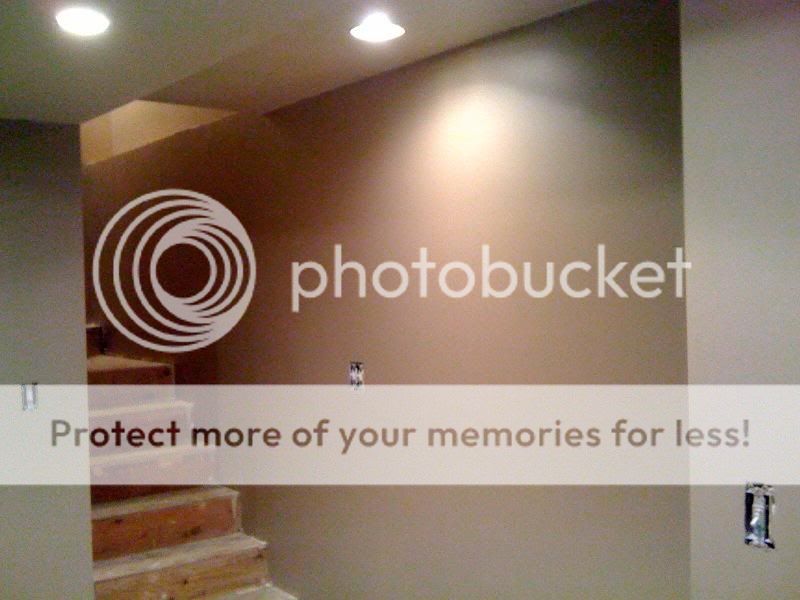

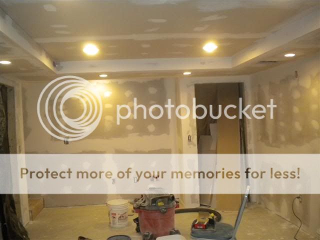

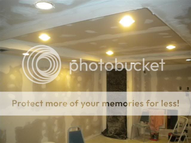

Here is a picture before the soffit lighting
and with eight 4" diam recessed lights to be on a dimmer.

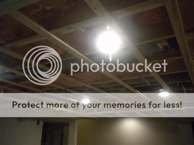

While I wait for the HVAC, I've pretty much finished the electrical for the office, rewired the entire basement lighting and pulled Cat5 to six locations in the office for network/phone/ir. There is another five network/phone and one IR pulled in the Family/HT room. I've decided to place a DVD changer (400 disc) and DirecTV DVR in an adjacent closet and have pulled Audio/Video/IR into there.
The basment originally was six lights controlled by two three way switches. Its now on five zones and each closet (four) has its own switched light. I still have two 4" cans to install as task lighting for the office once the soffits are framed (after HVAC is completed).
The office will be three walls and a column on the open side. Everything is framed but the column. I started insulating the walls between the office and Family/HT (F/HT?) room. The remaining basement will be unfinished for a year and I wanted to be able to control the room temp of the F/HT room better.

HVAC is finally done in this room. It didn't work out quite as well as I hoped but its not all bad.
There are two six inch supplies coming from the supply trunk, one at each end of the room using 12 x 6 vents. I was fearful that all my heat would dump into the basement but what I've found is that with the heat in the rest of the house at 72°, the basement is 60/61° with an outside overnight temp in the high teens to high twenties with a daily high in the thirties. The main difference is now the basement is a consistent tempurature. Before, there would be significant swings with some of the basement at 53° on cold nights. I did notice that during the few hours working in the basement with all the lights on, the temp would rise 4 to 5 °.
Next step is to sheetrock the ceiling. Updated pictures to come, including the office area.

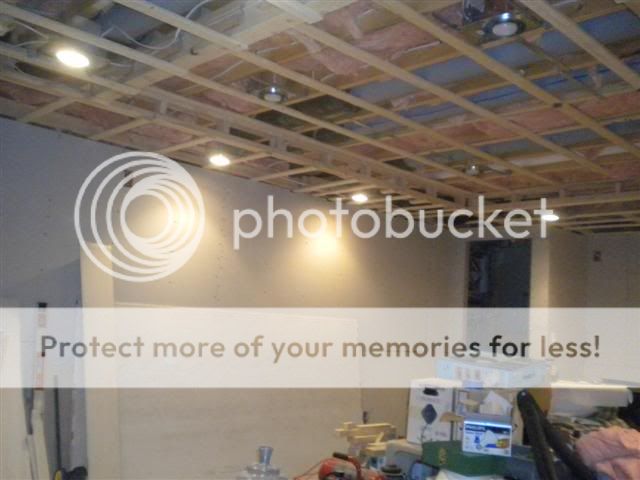

Like most projects, the progress hasn't continued as expected. I've had little time for any real progress. Here's whats been done since my last post:
1. Had another look at the HVAC, basement still not warming as much as I want. Found out I only had one return in the whole house and had to add another. Fan was also hard wired to run low/med speed and that was changed to run med/high speed.
2. Ceiling is up.

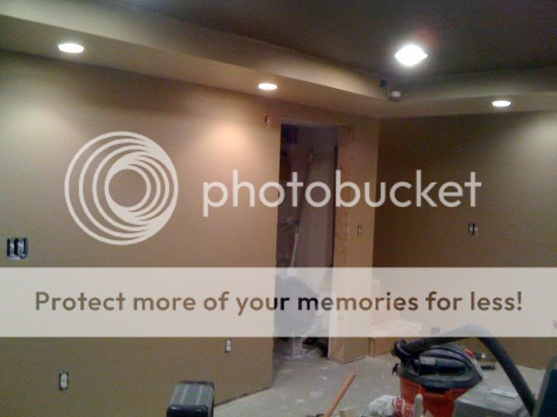

seven hours of sanding today. sand/clean, sand clean, sand/clean

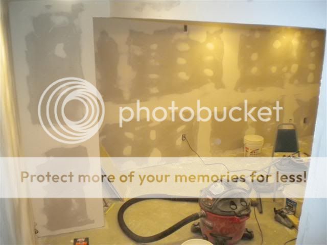

Before I started, I had to fill in a 3' x 4' part of the soffit and another 12' x 6" section I had left open during the HVAC work/rework. All of the walls are now sanded and I need to tape and mud the new section and second coat the rest of the ceiling. Then more sanding. What a messy job.
With so much done today, I can actually envision mud/tape being done in a couple weeks and ready for primer.

post #24 of 64 Old 03-30-2010, 07:24 AM - Thread Starter
moneypit's Avatar
Join Date: Jan 2002
Posts: 121
Finally, some updated pictures.
This is the view coming down the stairs entering from the back of the room. The jog in the corner is a closet that has a sump pump location, sewer clean out and outside water shut off.
Here is the left side wall. You can see the two HVAC supplies in the soffit.
Here is the front of the room that will have a wall mounted plasma, components on a low table/shelving. The closet to the left is were all the DirecTV/Comcast/Phone/network/IR runs go to. I'll also place a 400 disc DVD changer and DirecTV DVR in there. You can get a good sense of the tray ceiling in this picture.
This view is looking at the rear of the room. You can probably just make out the receptacle wired to a dimmer for future rope lighting behind a crown molding.
That's it for now. Hopefully the next update will be of primed and/or painted walls.

Posts: 121
Taping, mud and sanding is finally done. I learned I am not anywhere close to good when it comes to mudding but I sure can sand. Three coats of mud and a total of 17 hours of sanding. I swept up a buckets worth of dust and cleaned my shop vac filter four times. The end result looks pretty good with most of it looking excellent as close as few inches away.
We settled on a three color scheme: Medium color on the walls called twine, light on the soffit ceiling called cappacino and dark on the tray and front wall called nutmeg. I took a few cellphone pics for a quick post. The pictures don't reflect the actual colors that well but think of the medium color being Coffee (with milk)and the dark color being milk chocolate. We used an eggshell finish as a good compromise between gloss and flat to match the rest of the house.
Here is the view looking up the stairs
A view of the side wall
and one of the front wall
These pics are of first coats and before creating sharp, crisp lines at corners.
This is a big step for us. This weekend I plan on hanging the TV and buttoning up all the speaker wall plates, network, phone and electrical. I'm not sure when it will be functional, theres still so much to do to finish up A/V wiring in the closet, then doors, trim and carpet. Then, I'll put a crown molding around the tray and rope lighting.

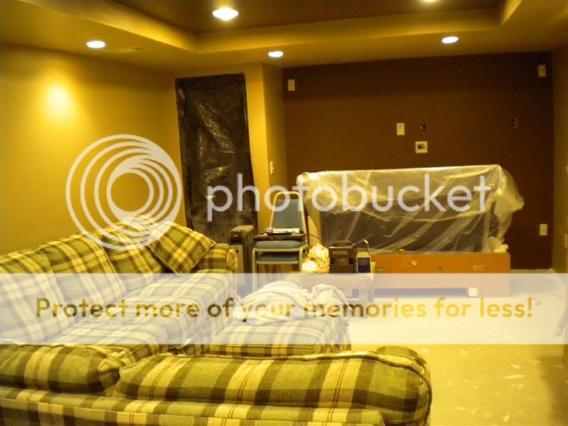

post #27 of 64 Old 04-18-2010, 02:00 PM - Thread Starter
moneypit's Avatar
Join Date: Jan 2002
Posts: 121
We finished the second coat of paint for all three colors. I think I can officially say it is now a room after 19 months of working in my spare time and on a limited budget. Here what is left to do:
1.) Finish trimming out electrical, audio and video plates. I have a bunch of keystone inserts on order.
2.) Mount TV on wall
3.) Purchase and install light trim kits
4.) Sheetrock the inside of the last closet
5.) Install speakers and electronics. Build a speaker cover for the hidden subwoofer.
6.) Purchase and Install the four doors required and then finsish the wood trim
7.) Select carpeting and have it installed.
8.) Enjoy the room!
9.) Finish the adjacent office (Sheetrock, paint)
I couldn't wait to drag in the sectional to see how it actually fits in the space. We also took the opportunity to partially unbox the TV and hookup the new blu-ray player up to make sure they both worked.
Looks like the hardest part is over.
