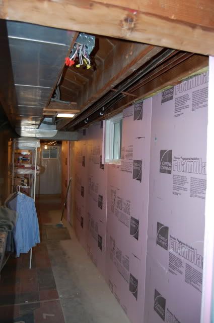

Spent a couple of hours cleaning up the basement and hanging temporary poly construction walls. 2" XPS and framing lumber will be delivered today. Hammer drill and Tapcons are ready as soon framing layout is complete and insulation is hung.
Speaking of which, can anyone offer some tips for hanging the 2" rigid insulation? Mechanical fasteners (2-3/4" tapcons with 1" washers) vs. adhesive (PL300 for Foamboard)? Maybe I'll need a couple of fasteners to hold the board while the adhesive cures anyway?
Steelkilt is offline

I just used the adhesive and had no problems. As you go you'll get the hang of how much you need and how long it takes before it bonds reasonably well with the wall. And remember, once the framing is in that will serve to hold things in really snug as well. Those boards won't be going anywhere.
I've never heard of anyone using tapcons for this purpose.

Is it seconds or minutes for the adhesive to setup? Reading the label on the adhesive it mentions to provide bracing, so I just assumed a couple mechanical fasteners would do the trick.
The other concern I had was the adhesive being able to bridge around the concrete 'snot' that is there from the concrete forms. You know, the excess that was squeezed out at joints, or the small relief at panel joints. If the adhesive is fine by itself that is good, I just didn't want to be there stuck holding each board against the wall for 15 mins a pop.
The 2x4 wall framing will be held 1/2" from the foam board, so I can't rely on that to hold the insulation boards in place.

Not sure about the concrete "snot" you mention - maybe you could include a couple photos of your walls? My experience was as long as the walls were fairly clean (I have 60-ish year old cinder block walls and just swept them down good) you should be fine. I believe I let the adhesive sit on the boards for a minute or so, then held it up against the wall and within a minute or so it was sufficiently bonded to at least hold its own weight in place. Remember that if you cut them down some to fit the height of your ceiling that also adds another method of tension to hold them in, as it was generally a snug fit between the floor and the joists.
Also, that red tape for taping the seams came in handy for holding the occasional board in place in more awkward spots, like over the tops of windows, etc. I just put the adhesive on, then temporarily taped the board in place (by taping to the surrounding joist/ceiling/whatever) until the adhesive dried. Don't mess with duct tape - it does not adhere well long term to the boards, whereas the red tape made for that application stays well. I had to re-do some seams because of that.
Finally, having a small gap between the insulation boards and the framing is no problem. My buddy showed me a great cheap trick where we got one 1/2" board which we just broke up into smaller pieces, and then simply inserted those pieces like shims between the framing and the insulation as and where needed. The result was a nice, snug pressure from the framing to the boards.
Hope that helps. I'll see if I can find any photos that might show this better and add them if I do. Good luck.
EDIT: Not great photos, but here's one showing the boards held snugly between the joists and the floor, before adhesive, tape or framing.
I couldn't find one showing a good shot of the poly board shims, but this shot below kinda shows a bit the small gap between the framing and the boards where I simply placed them as needed. Plus as a bonus you can see my daughter's attempt at Christmas decorating in the job site.

Hanesian, thanks for taking the time to explain your install and including some images. Hearing that the set-up time of the adhesive seems manageable, I can now go into my project with confidence that using only the adhesive will be necessary. We'll see how it goes when I encounter the aforementioned concrete 'snot.'
Here's what I mean:

First delivery of the build did in fact come yesterday, and I spent a good 45 mins hoofing it around the side and throwing it through the basement window. Need to get it organized, and start the wall layout on the floor.
Horrible picture I know...left the camera in the trunk over night and got some lens fog, oh well.

Personally I wouldn't worry much about that "snot." It's not like the insulation is ineffective if it's not adhered to every single inch. Plus, I also then added some unfaced fiberglass bats between the framing just for a bit more thermal insulation, so small imperfections with the poly board won't matter so much.
If you just experiment with a small area I think you'll see it's easier than you fear.

Good to know, I tend to over think things at times. I will let you know how it goes.
I won't be going with the batts between the studs, as we already have 2 1/2" of XPS on the outside of the foundation wall giving us a total of R22.5.
FYI - we also have 2 1/2" of XPS below the floor slab, so we won't be floating our floor on any insulation to save headroom.

Well Hanesian, you were right on target with regards to squashing my concerns over the concrete 'snot'. It was a total non-issue when it came to adhering the insulation to the wall. Apply generous amounts of adhesive, slap it against the wall, hold for 30 seconds, then move on to the next piece. Simple as that.
Here's a couple of boring progression photos from the first real day of work:
Rear wall insulation progress:
Spray foam sealing sill plate gaps:
Shot looking toward future display wall:

Framing is now complete, with the exception of the soffits. I've been procrastinating, as I'm not 100% certain on how to approach them. I'm going back and forth between building a 2x ladder on the floor and raising/nailing it in place vs. plywood face with 2x blocking/nailers.
I managed to splice in an extension for an 8" flex duct to get it out of the way for the door - I was proud of my diy solution, as it allowed me to keep framing and not have to rely on the HVAC contractor to come and do such a small amount of work. We all know how responsive contractors can be when so little work is involved.
But the next step after the soffits (hopefully I can get started on those this weekend) is to get the HVAC guy in to run a couple of supply lines and a return.
I'd also be curious on people's recommendation on doing my own wiring. The lighting and power isn't overly complicated. I have a friend of a friend that is a licensed electrician that said I can save $$ by running the wire myself, and then calling him in to make the terminations at the panel and devices. I'd have to go through a refresher on the rules of thumb; # outlets on a circuit, lights, what to daisy chain, etc. I'm the adventurous type, so I might give it a shot.
Has anyone had any bad experiences with running their own wire they might be willing to share? Soffit building tips?
For most of my basement project, I pulled the wire myself after first bringing in an electrician I had used before with the prior understanding that I would pay him his regular hourly rate to consult and help as needed. We took a half an hour to walk through, I explained what I intended to do I the rooms, and he told me what type of wire to pull, where to run it, and so on. I did that, and he came back and inspected it before drywall went up. I also paid him to connect everything to the main electric box, because I didn't feel like messing with that.
It can work great and save you money if you find a willing electrician.
