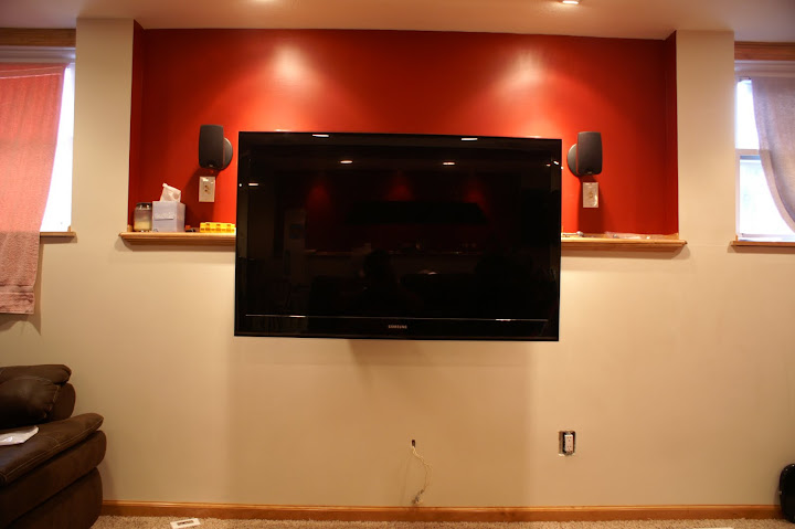

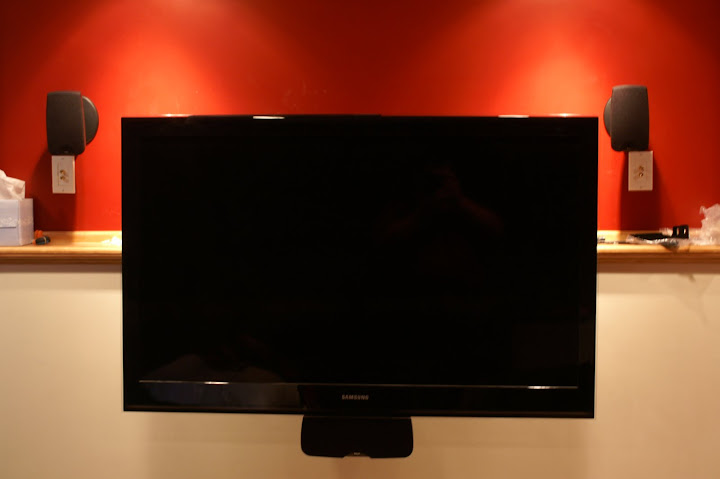

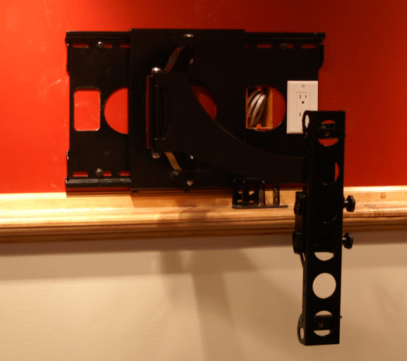

I showed the Sanus mount and how I altered it to set the height of the TV to the desired position. Now the issue is mounting it to the studs. The stud locations caused me to have to mount it off-center. How far off-center? Well...the gap between the Media box (orange) and the electrical box represents the dead-center of the wall.
In hindsight I would have mounted some nice 2x10's behind the drywall to open up my mounting options. Thankfully, the articulating arm design allows me to move the TV so it is close enough to center that you need to look really hard to tell it is not right on center (can't see the mount behind the TV).
The "boiler plate" base is rock solid - in fact the design and quality of this TV mount is pretty great overall!! But I felt it needed more mods so I cut some rectangles into the ends. Now, I did this to accept the receptacle box and cut a slot in each end (on a Bridgeport). But, I should have spent a few more minutes investigating it so I could have seen the plate is symmetrical and I only needed to cut into one end.
Now offset to the left - if I wanted to offset it right I can shift it over. Had I cut only one rectangle in I would simply have had to rotate it 180 degrees to accomplish the same thing and it would have left some of the "beef" at least on one end of the base.
This shows a close-up so you can see the cut-outs in the baseplate:
This shows a wider view and you can really see how far to the left the base is offset. But you won't be able to tell once the TV is up.

post #97 of 149 Old 11-07-2010, 06:24 AM
RTROSE's Avatar
Posts: 6,585
Mentioned: 10 Post(s)
Quoted: 135 Post(s)
Liked: 137
Nice work on the mounting the mount. Well that just kind of sounds funny, oh well. Well done. I have had the same issues as well. When I was framing my wall I did put in extra supports, but when I finally got around to purchasing the mount and TV I could not take advantage of actually using the extra support (although it did reinforce my wall) so I had to improvise slightly. If I were to do it all over again I would purchase at least the mount if not the TV too and build the wall specifically to offer the best support for mounting a flat panel.
Great work.

So, I mentioned earlier about the wife's concern with my modded wall-mount (I can't leave anything stock) supporting the weight of our new LCD. She was concerned we'd come home one day to find it lying on the floor.
Well, my 107 pound son (about 50% heavier than the television) decided he would find out. We extended the arm fully (about 27" I think) and he hung from the mount. I think the mount is rated for 120 and you know they will use the lowest rating.

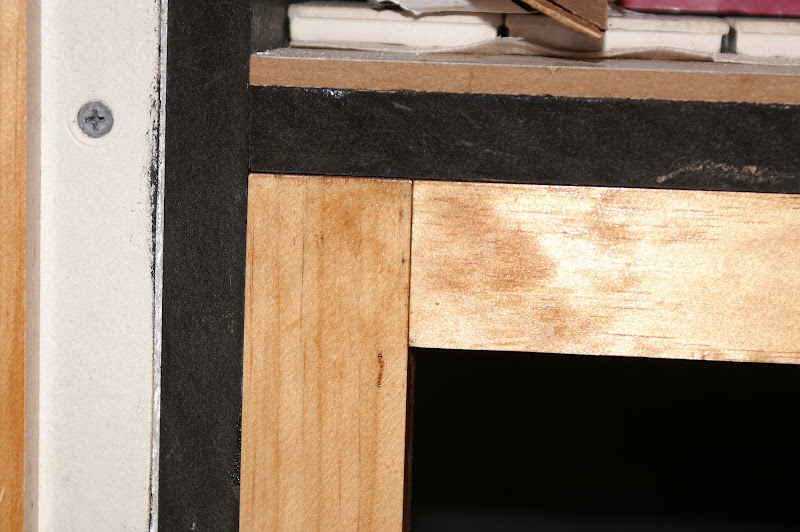

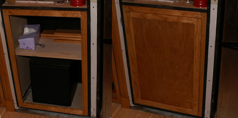

So, I'm rollin' now, baby!!! Since I confirmed the new HDMI cable works, I pulled it through my "smurf" tube. Since I didn't order larger-diameter tubing, I ended up using 1 1/2" black tube that you might normally connect to a water pump. Works great and was cheap!!
We pulled that through and also pulled my Cat6 cable through my 1/2" smurf tubing to get it over to where the router is. Of course, I'm about 3-feet short!!! UGH!! It reaches but in order to connect it all up, I need just a bit more so that part sucks!!
Since it was nice out yesterday I took advantage and stained the cabinet facing and cabinet door that I built for the cabinet next to the fridge.
Here is a pick of the wall. Note that right now there is a store-bought cabinet in the space in the bottom but that it is a little too small for the space.
I figured instead of building filler rails and stiles I'd just build a new face and a new cabinet door. Here is a pic of the face frame and then with the door installed. Btw, NO...this subwoofer will NOT be doing in this space!!

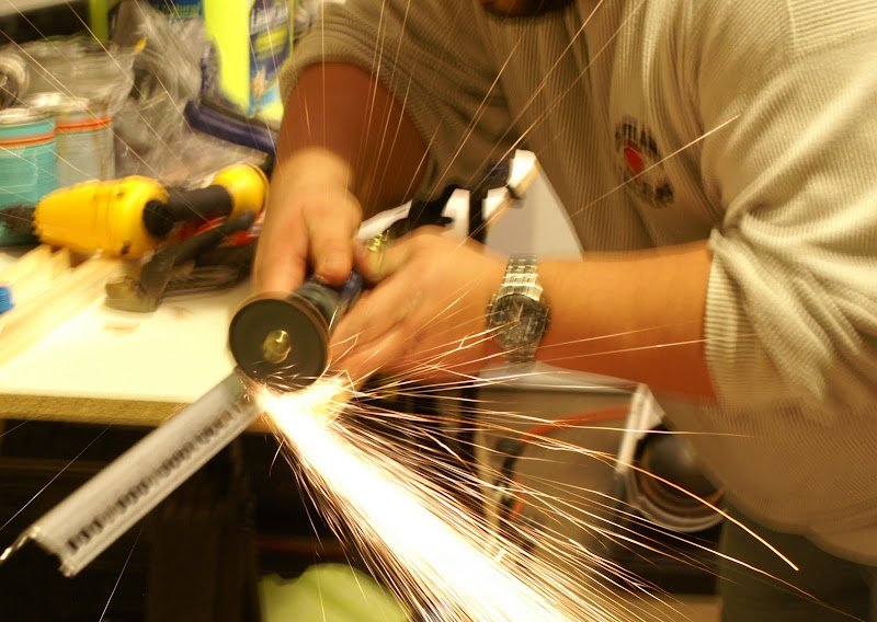

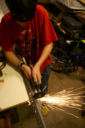

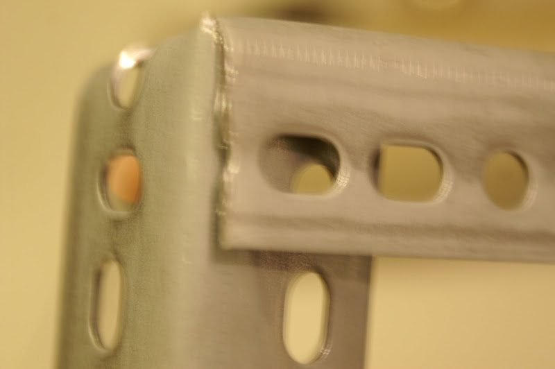

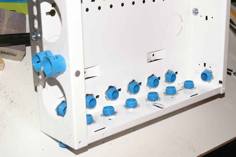

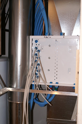

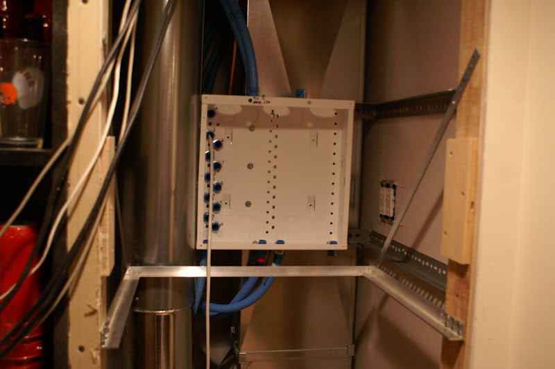

Ok, so yes, I jump around on projects which probably accounts for my lack of speedy progress...
I decided it would probably be helpful to add a centralized location to run all my smurf cables. I purchased one of those 14x14 wall cabinets to hook everything up to.
So, I fabricated a few brackets to mount it behind my A/V shelving...
My son thought it looked cool and he wanted in on the action!!
Prior to cleaning up the edge. This allows us to use the wall framing to help support this box.
Originally, I had these smurf ends coming in front each side and split the spacing so the wires would not interfere. The HVAC plumbing caused me to make changes...
This is the box mounted. You can see I had to change the location of all those ends that were in the left sidewall. You can see the fabricated rails running down the wall on the right and then across the back behind the box.
With the speaker wires run.
So while all this is looking pretty cool it leaves me with how to make all of this come together...

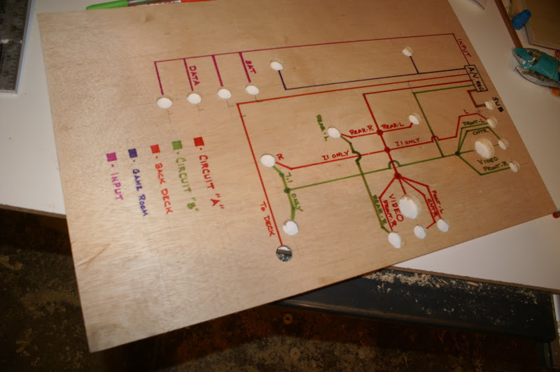

Family Time's Avatar
Join Date: Feb 2010
Posts: 153
So, what it comes down to is that I now have this box:
As well as this on the back of my A/V cabinet:
I originally planned on having all the smurf tubes terminate at all of these holes!
So, I need to connect all of these wires to my A/V gear. I can tell you I have cut some of the speaker cables too short to reach from the white box up and through the holes at the back of the cabinet. Let alone be able to pull out the cabinet to hook everything up!!
I believe my HDMI cable IS long enough to reach directly into the receiver.
My thoughts on this are (and this is the reason I brought this up because I want feedback, input or ideas on how to accomplish this): Cut holes in the box cover and mount 7.1 speaker connection plates on the face. This will allow me to run wires from those connector plates THRU the holes at the back of the cabinet and into the receiver.
Another idea still has me mounting those connector plates to the front of that panel but then scraping the idea of my "schematic" on the back of the A/V shelving. I could make a cut-out in the back wall of the cabinet in the approximate location of where the white box is oriented to cabinet. This gives a more direct route to the equipment.
The back of the A/V box is probably 3-4" in front of the distribution box. I could even "box" the area where I make the cut-out at the back of the cabinet extending the cabinet so it nearly touches the face of the distribution box.
Ok, what do you guys have for me, throw me some ideas!!

This is a closer view of the face frame for the cabinet door. Don't know about you guys but I love a tight fit.

And we continue to progress!! As I continue to move along with the A/V setup I continue to find myself needing to order additional items!!! Anyway, now that the furniture is here and the mount is up on the wall (and kid-tested) it's time to hang the TV!!
We are absolutely thrilled with this TV. I won't bore anyone with screen captures as I am sure the Samsung LN52B750 is on here elsewhere. This TV was highly praised and let me tell you, it did not disappoint!!! We were mesmerized the first time we connected the BluRay and threw in the latest Star Trek!!!
My only disappointment is the A/V receiver is not yet hooked up so we had to settle for sound from the TV. I can't WAIT to add that next dimension.
Now I can focus more on A/V system connections and what all it will take to hook this thing up!!!
While my crawl-by-design build (yeah, right) has been going, I've seen a lot of guys do a lot of cool builds on here. Each time I come here to update I get sidetracked checking in on everyone else's stuff!!! Then I just run out of time or plain forget to update mine!!
But, there is one more huge piece to this puzzle that has yet to be taken care of...

I don't know about your choice in TV's ;-), but I know you won't be disappointed with your choice in speakers. Those little Klipsch Quintets will really do well for you. They perform like much bigger speakers for sure. I have them in the boys media area and I really like them.
The TV and the mount looks really nice. Great progress, keep it up.
