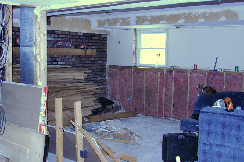

Taking a break from building my A/V cabinet and thought I'd see if anyone at least looked at my thread! And to my surprise I even got some posts!! Thanks guys for welcoming my family onboard!!
Well, let's see how easy it is to upload some images. Seems logical to start with a "before" photo of the area. But since I cannot find a true before, I will start with these. Our water heater decided to begin to spew it's guts and a slow leak damaged the walls, floor, furniture and even some of the electonics in the family room. This is the very beginning of the clean-up efforts.
I LOATHE paneling! The rough-sawn cedar was a "good idea" but was installed like crap! Besides, that sucked up water faster than anything else down there!

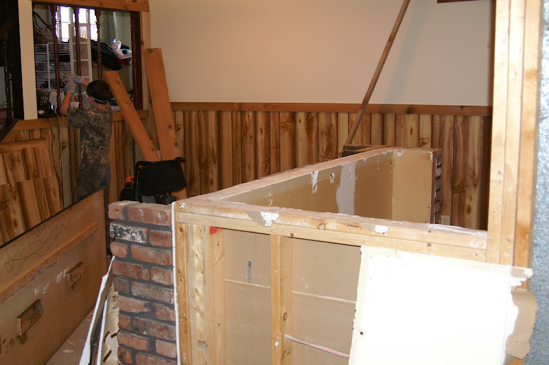

These two show the north side of the room. The wall where I state the paneling used to be is the mechanical room (furnace, water heater). It is a huge room for those two things so it was our storage area as well.
The bar, while we thought was very cool when we bought the house, NEVER got used except to set-up the kids slot-car track, building models and general "I don't know where to put this so I'll put it here"! So with that mechanical room and the bar, there was little space left for anything else on that half of the room. I once had a 5-foot desk in the corner with my computer in the corner.

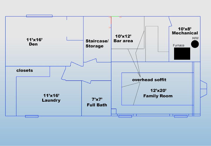

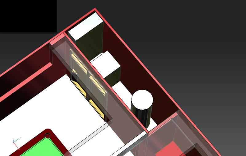

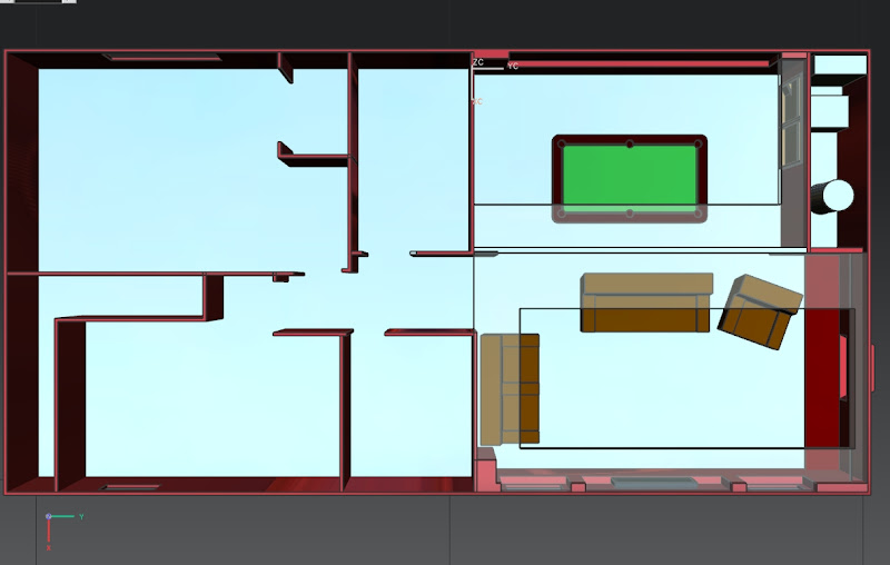

I sketched up a floor plan using Unigraphics NX. I have some 3D modeling done with UG as well, but may import into SketchUp so I can create some files like everyone else has seen.
This is the room layout prior to the build. As you can see, the mechanical room and the bar took up quite a chunk of this area. I really don't like the way this level of the house is laid out. Would you NOT put the laundry and mechanical room at the same end of the house? There is a dual-crock sump system in the lower left corner of the Laundry Room - in the closet.
We strongly considered adding a spa-tub somewhere in the basement. The wall between the bath and the laundry room is the "wet wall" and with all the plumbing being in the concrete, we felt that adding a spa-tub in the bathroom was just too much. I still have it in the back of my head somewhere that I may try to put it into the laundry room - we'll see!!

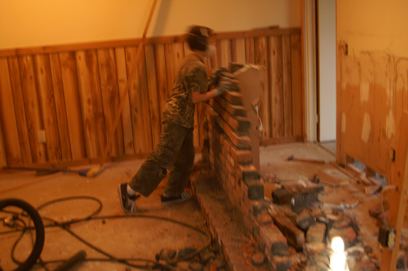

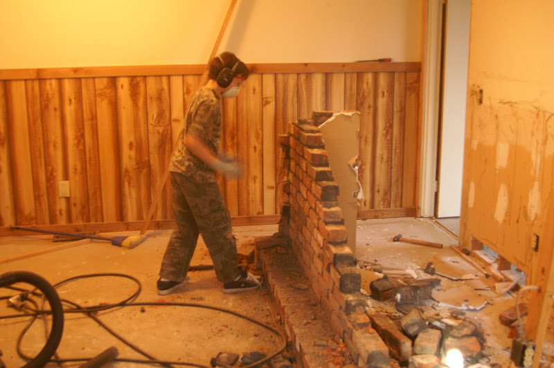

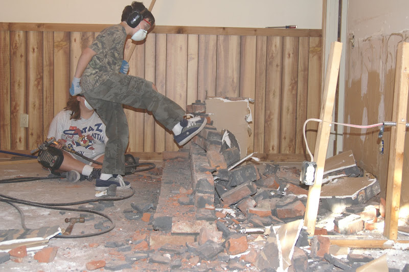

The bar comes down!!
The WINDUP....
The HIT!!!
Notice the Air Hammer in my daughters hand - we would chisel around chunks of the bricks and then knock it down!
Funny - the kids have hardly been seen on this project after the completion of the destruction!!
Family Time is offline

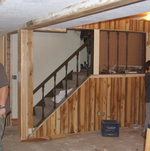

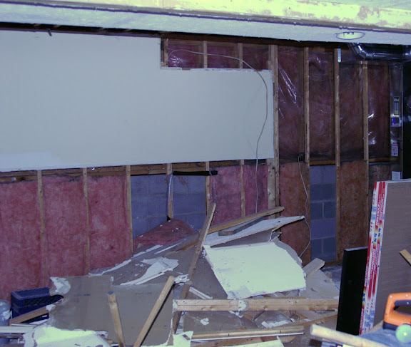

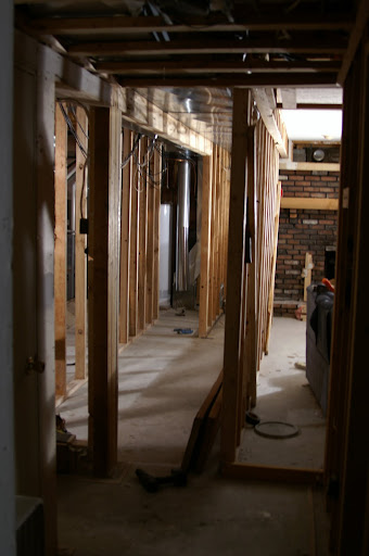

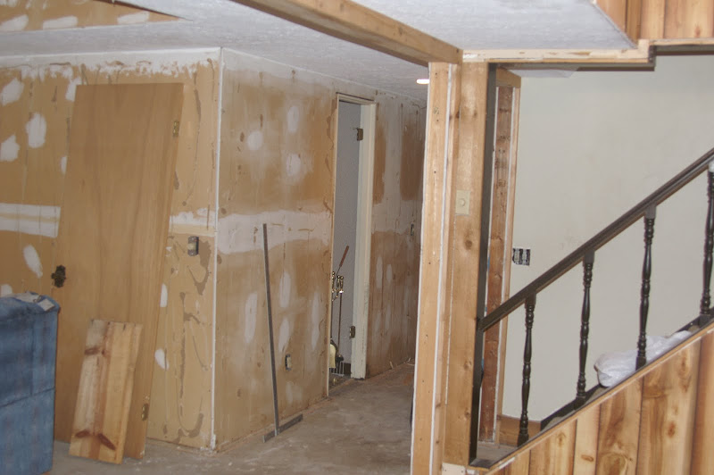

These show the wall opposite the fireplace where the hall and staircase are (see previous photo).
The first is here because it shows the beam (at the top) that spanned the gap from the staircase to the wall of the mechanical room. I mention it here because...well...because I have PLANS for this thing!!
These walls ALL has the paneling on them and once removed left behind the glue ridges. I made a short attempt to try to remove these before I deemed my life to be easier by just removing ALL of the drywall!!!

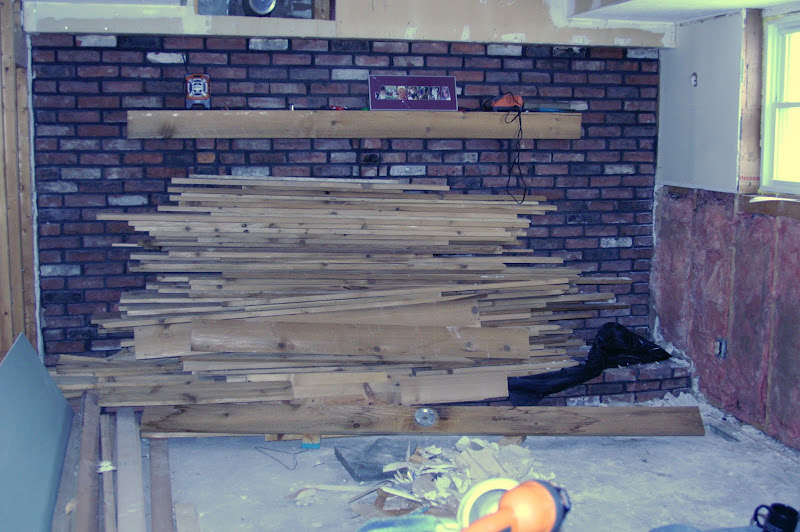

If I've learned nothing else perusing these threads, I've learned that photos are king and words are cheap!! haha!! I am trying to select photos that show a continual timeline as well as those that can actually contribute to the overall

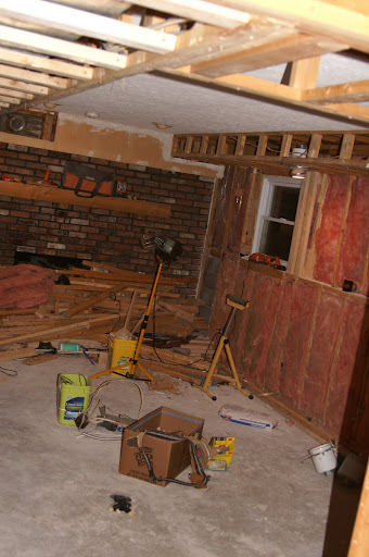

We are really getting into the meat of the tear-out now!!
The short studs in the foreground are from the old "return" on the bar. The wood stacked in front of the fireplace is all the rough-sawn cedar that was up all around the room.
The debate begins in this room. Does the TV go above the fireplace (centered on that brick wall) or on the wall on the right - to the right of that window? Hmmm...

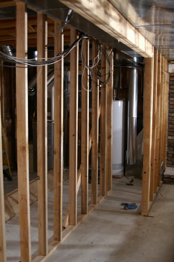

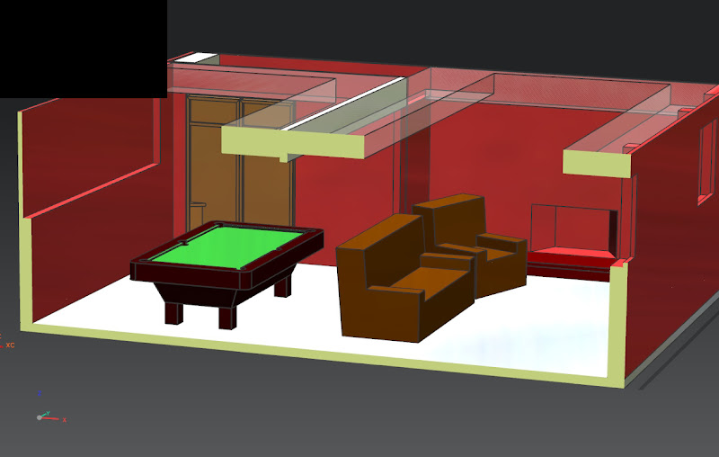

Here are a few images of the very simple modeling I made just to see how things will "fit". The table looks a little close to my Flintstones couch!
The two biggest goals with the remodel are to extend the length of the opening between the two halves of the room. Doing this means we need to address the header beam that currently creates the opening AND the wall that is the Mechanical Room.
Our 28 year old furnace has spent it's usefulness and needed replaced along with the obvious water heater. So, we shrank the mechanical room to 40" meaning we gained over 4 feet of usable floor (40 sq. ft)!!! Woo hoo!! This doesn't even count what we gained from the bar removal!
The new smaller mechanical room with the displaced furnace. Double doors for entry. To the right of the doors we planned on an A/V rack, small refrigerator and some shelving including a shelf to hold a microwave.

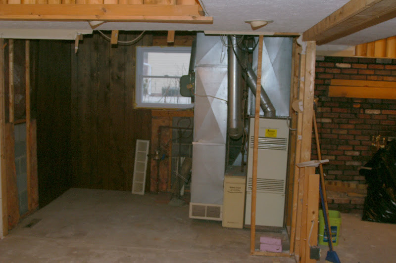

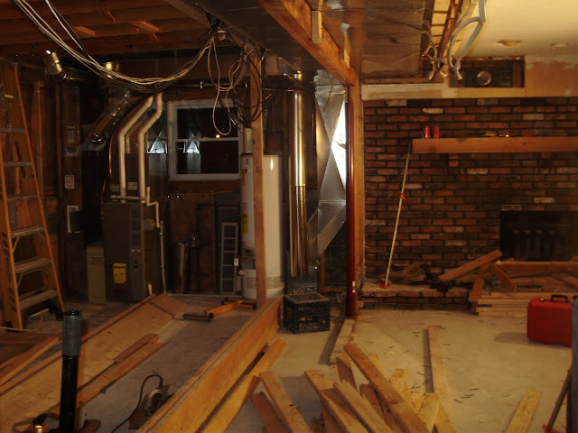

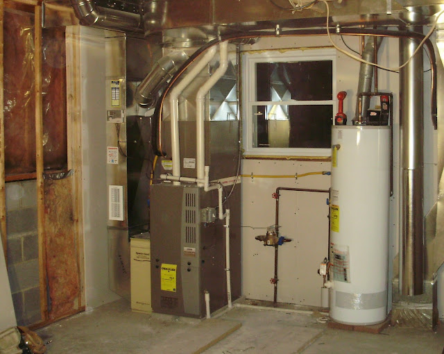

This shows that the wall was removed exposing the old furnace and new water heater.
I placed an ad on craigslist for the paneling that I removed. I actually got fifty bucks for all that paneling - yes - used! The guy wanted it for a rental home or something.
I seriously considered doing something with all of that rough-sawn cedar as well. Ultimately I placed an ad and got three times as much as I did for the paneling (kids de-nailed all the cedar).
Time to replace the old furnace. Being a Do-It-Yourself'er, I actually considered replacing the furnace and central air myself. After getting prices - I was convinced I'd have to in order to afford it - geez! Man, am I glad I did NOT do it myself!
We called a GREAT local heating and A/C company and they worked with us. They did a spectacular job with the installation and we've been VERY happy with it!!
Now...about that header beam...

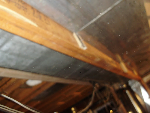

So...that pesky header beam....
I thought, like most homes, this one would have some kind of center support beam; A steel I-beam, a double or triple header...something!! My thoughts were confirmed when I saw this doubled-up 2x12 above the opening with the 1/2" plywood flitch plate in between...right?
But...why does it not go all the way to the exterior wall, I wonder? Hmmm. After investigating futher, it became obvious that there was once a FULL wall here supporting the upper levels of the house! Someone had previously opened up this area to make the L-shaped area that was the bar and the family room.
But...they didn't make the opening long enough for what we had in mind... After calculating the bearing load (I received an Associates in Architecture...23 years ago and have used that knowledge only sparingly since!!), 2x12's weren't gonna do the job.
I calculated I could go up to an 18' opening using doubled-up 2"x14" LVL beams. I did NOT want to go 2"x16" due to more loss of headroom Well, I didn't need to go all the way to 18' so that was even better. I confirmed my calculations with a P.E. and I picked up some 20-footers at my local lumber yard and was soon back home to figure out how to get them in... I had the structural guys at the lumber yard triple-check my numbers.
Obviously the house wasn't going to support itself waiting for me to put the new beam in after ripping out the old one. So I picked up the necessary 2x4's I would need to build my temporary support walls. Sorry, other than the pictures posted previously, I don't have any true before photos of the header beam.
I do, however, have photos of that beam surrounded by the temporary support walls.
Here you can see the LVL beams laying next to one of the support walls.
The old header beam has been removed and the ductwork that had been attached is being supported by outriggers attached to the temporary support structures.
With the help of some buddies we installed the new LVL beams and man do they look great up there!! You can see the pile of 2x4's that were the support walls as well as how much shorter the wall of the mechanical room is now. The sole plate will be cut back almost to that red post. The opening went from less than 13' to more than 17' - WELL worth the cost and effort!!
Here is a nice fuzzy photo of the new beam. The 2x4's on the sides are temporarily supporting the ductwork.
This would be the biggest structural change in this whole project. Now that this is completed we can begin to put the room back together!!

Thanks RT, glad to see you chiming in once in a while - being sure to remind me of uploading pics!! At least I know someone is following along :-P
Though I had never replaced a beam before I knew I had the capabilities to do so - it was just a question of "is it worth it?" I can see with 100% certainty - YES it was!!
Now time to begin the looooonnnngggg haul of putting everything back to a usable state! We ALREADY miss this room at this point in the build!!!

I am at a major point with my build right now that I need to address and I hope someone here can help. The wall where I am mounting the LCD has a ledge at 48" from the floor - almost exactly where I would like the center of the TV to be (according to other threads on here...).
Below that ledge is 8" cinder block with 2x2" furring strips. Above that ledge are normal 2x4" studs, 16" on center.
While the TV would look really nice mounted above this ledge (because it would fit into a shallow alcove), we feel this is much too high for comfortable viewing - see nearly any discussion on here about a TV mounted above a fireplace...
However, no way do I trust the 2x2's below the ledge to support my 52" LCD. I do NOT want to molest the cinder block foundation!
My ULTIMATE set-up would be for the TV to sit up into the alcove (see the attached pic) while we are NOT watching it. And have it drop down to the proper viewing height when we ARE. I have designed several ways for this to happen - none seem feasible at this point.
So, barring that, I'd like to place the mount itself just above that ledge. However, I would like the TV to hang well below the mount so the TV is at the correct height. All the mounts I've seen seem to have the TV centered vertically with the center of the mount.
I see the Sanus mounts have a huge arch-shaped arm and considered flipping that over so the TV "hangs". But since the mount was not designed for that, I'm not sure it would work well and I'm concerned about the additional stress this could put on the mounting hardware.
Any ideas???

post #30 of 149 Old 02-26-2010, 06:43 AM
beach31684's Avatar
Join Date: Feb 2010
Location: Indianapolis, IN
Posts: 195
you'll have to excuse me, as i am still a noob, what about building a wall that is right in front of the blocks, and attaching the new wall to the wall studs above the bricks. You would lose a few inches on space, but it sounds like the least expensive way to achieve your goal.
their is probably a really good reason why that wont work, I just dont know it.
