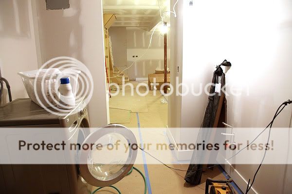

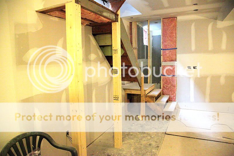

Sorry, again, for the lack of updates. Life has been hectic and so has been the reno so If I don't post regularly, I'll eventually catch up and chronicle what remains of this reno.
We're at the home stretch now although the contractor isn't going to finish by the June 1st targeted date. We're basically at the trim stage now, so we're pretty close. We've still had to deal with a few headaches over the past few weeks and, let's face it, after 3 full months of this reno, we're getting pretty antsy and just want to finish so we can get back to our normal lives. And I wouldn't mind sitting back and listen to some tunes and watch some blu-rays on a big screen

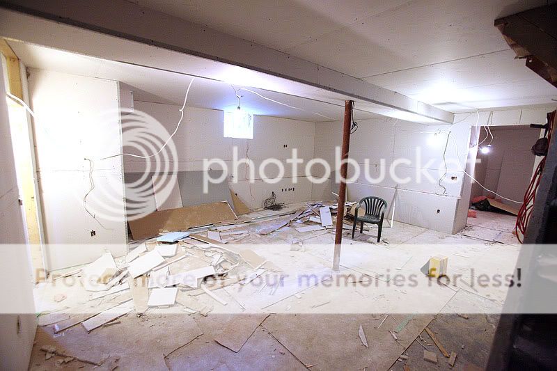

The drywall guys were really rough and left a mess. Not only that, they cut some of my cat6 cables when cutting holes in the drywall. I have to terminate them anyways, so I guess it's not a big deal but....c'mon....how can you do drywall for a living and damage the cables?!?! I'm really hoping they didn't damage any of the other cables running across my ceiling. Also, I'm no construction expert, but does it make sense for them to put up drywall and put the short piece right across the middle of the wall like that??? Why wouldn't they have put that strip at the top of the wall? I know the plaster will cover it, but those seams are always going to be there....and right in the middle of the walls! Over the years, I worry that those seams will become visible.
Drywall Mess

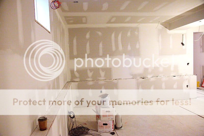

Drywall strip in middle of wall? Is that how it's done?

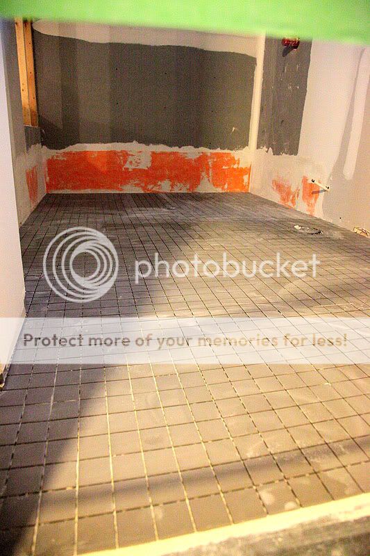

Anyways, drywall is up, plaster guys came to do tape and mudding. We've popped new windows in, got the bathroom floor tile laid and got the colored concrete floor all cleaned up. They're going to apply a concrete sealant to it tomorrow so I'll come back with better photos on the weekend. The floor is pretty dark, a lot more so than we were expecting, but we took a chance choosing a colored concrete floor instead of the conventional choice like carpet or hardwood or tiles.
What's left to do is the glass shower in the bathroom and installing all the plumbing fixtures. The new stairs and exterior door should be done next week as well. Then it's onto trim, paint and, finally, electrical. I've already decided to go with a Cosmopolitan Electrol Da-Lite High Power screen and I just have to finalize the screen size. This is causing me a few sleepless nights because I need to carefully locate where the ceiling outlet needs to go as the screen motor hook-up is on the left end cap of the roller and it needs to be hard-wired, not just plugging it into an outlet. So I have to make sure I have the exact dimensions of the screen and roller mechanism and it'd be a lot easier if I had the screen on-hand.

Putting the seams in the middle of the wall is a Pro technique. When doing a whole house they try to use 12 ft sheets and then any wall less than 12 ft only has a seam at the middle of the wall. The advantage of the the seam at that level is the finishers can go around the room and tape and mud the seam at that height without standing on ladders or stilts. Horizontal seams are preferred over vertical for the ease of finishing.
As for the strip in the middle of the wall, that is exactly how I did a couple of walls. Again it is an easy height to work.

I would have thought that was weird too, having that strip in the middle of the wall, but if you've ever taped/mudded/sanded either bending over or on a ladder/stilts, it all becomes clear.

What kind of tile is that? I really like the color.
Also, are you keeping the bare concrete in your HT? If so are you concerned about the extra reverb from the hard floors?

Putting the seams in the middle of the wall is a Pro technique. When doing a whole house they try to use 12 ft sheets and then any wall less than 12 ft only has a seam at the middle of the wall. The advantage of the the seam at that level is the finishers can go around the room and tape and mud the seam at that height without standing on ladders or stilts. Horizontal seams are preferred over vertical for the easy of finishing.
Ah, ok, now that makes a lot of sense. Thanks for the reply! I've definitely learned a lot about renovation and construction from this project and the kitchen addition before that.

It's a ceramic tile and the color is a cross between taupe and grey. The photo doesn't show the color very accurately but I told my wife you liked her choice of tiles
We'll be laying down large area rugs so that should help with the reflections off the concrete floor. Because we have in-floor heating, concrete floors make a lot of sense, and you save about $4-$5k from not having to lay tiles or engineered hardwood so that helps with the budget.

They actually make 54 inch wide drywall now too, so it saves the need to install that center strip in houses with 9' or lower ceilings.

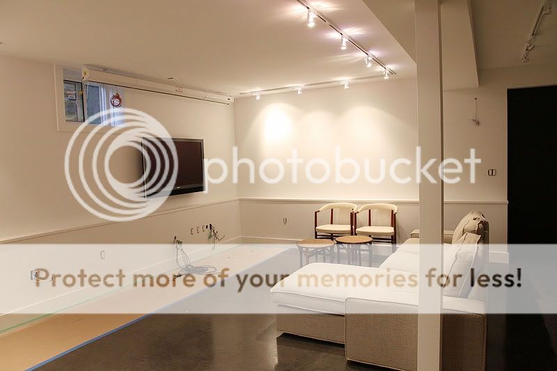

Well, I was going to hold off updating until this project was completely done. Of course, we're about 1.5 months past the original completion date, some of which was our fault, some (most?!) of which was the contractor's fault. Sigh, so typical of renovations.
Anyways, it's been pretty hectic around here as well, so I can only leave you with this teaser photo tonight. I'll try to post a massive update this weekend when I have more time. The good news too is that we should be 99% done with this basement reno by this weekend. Tonight did mark a more personal milestone for me with this project because the electrician finally wired up the Dalite screen, although I had to finish the job for them since they neglected to wire up the connections at the junction box end (!). I also had to terminate the cat5e cable I ran with RJ14 jacks to connect the up/down rocker switch. It was a thing of beauty when the motor whirred and the 110" HP screen came down I haven't brought my gear out of storage yet, so I just had my PS3 and I watched for an hour various blu-rays without sound. It was sweet.
More to come...

Wow - what a change, Congrats!
Looking forward to more photos

You better not be like others around here, post a teaser pic like that then disappear for a week or two. We WILL hunt you down!
Looks amazing to say the least. Congrats on seeing the light at the end of the tunnel (and actually being AT the end of the tunnel) and being able to enjoy the end result even if it is without sound.
Looking forward to more pics for sure.

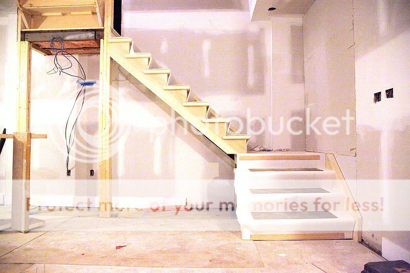

Actually, before the sealant, I forgot to mention some of the wood work. First, the stairs were installed. No adventures here, other than the fact that it was installed a week later than it was supposed to, which meant no work was being done while we waited!
Stairs (poplar) installed

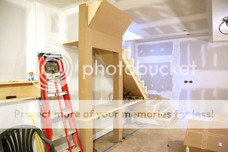

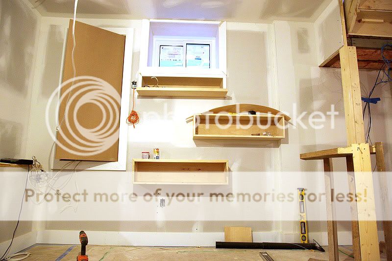

You might remember that my wife absolutely did not want a projector hanging on the ceiling. I was OK with that because I had my heart set on the Da-Lite High Power screen, which works best when the projector sits close to eye level. So we designed a "projector niche" to house the projector, and where I could also place my rear surround speakers. Then my wife got the idea to add 2 floating boxes on the same wall. This solves the potential danger of someone walking into the sharp corners of the overhanging lip of the nicheand it also gives us some additional storage. They also look cool!
Projector Niche and Floating Boxes
We also decided to leave open the area underneath the stairs. Because of the new plumbing and, of course, the extra 6" of the new concrete footings sticking out, the depth is actually quite narrow if we had decided to close it off and use the area as a closet or storage space. Again, my wife designed this idea of slapping some mdf across and, voila, we have a functional desk. I have designs to put my vintage Commodore 64 there, but I haven't told her yet
Desk area underneath the stairs
Finally, I was thrilled to finally get the washer and dryer hooked up again! For 3 months, I drove up to my brother's house every weekend to do 3 loads of laundry. You have no idea how long laundry actually takes (wash/dry) until you have to do 3 consecutive loads in one sitting!
Washer hooked up (dryer would take another 2 weeks)
