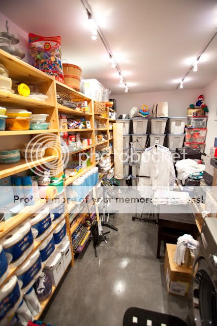

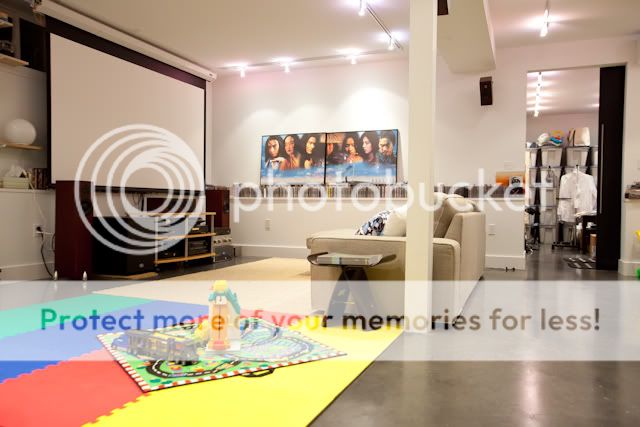

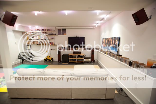

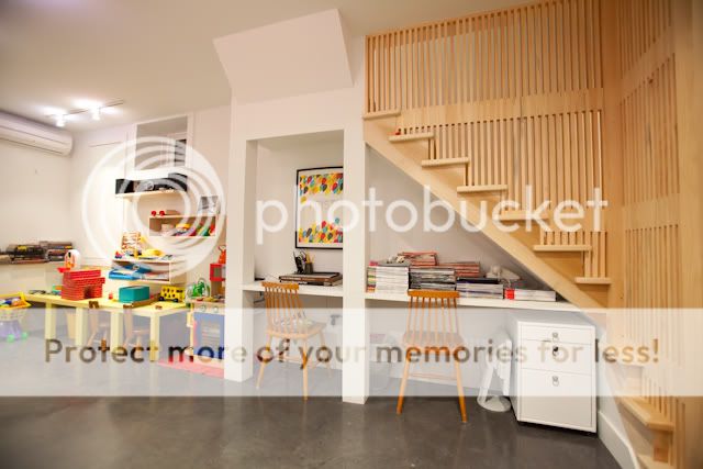

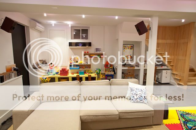

Hey guys, sorry for not uploading the finished pics, but better late than never! So here goes:
It has been a little over a year since the basement was done, and it sure has gotten a lot of use during this time. My son loves pushing his toy trucks around and I've been enjoying lots of movies and watching sports on the big screen. As life continues to be busy, the space still feels unfinished as there are still lots of art I'd like hung and I've had no luck finding an a/v rack that meets the wife approval and satisfies my audiophile sensibilities. I also would like to look into room acoustic treatments, especially as the space is wide open, and the left front speaker opens up to lots of space but the right front speaker is at a corner.
View from Laundry Room (everyone loves the concrete floor!)
View from Projector

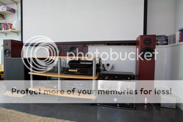

View from A/V Rack
Toy Storage and Open Counters Under Stairs
Equipment List:
Blue Circle BC32 5-channel amp
Blue Circle BC3000 MkII pre-amp
Audio Aero Prima CDP
Anthem MRX500 receiver
Totem Forest, Model One Signature Center, Dreamcatcher Side Surrounds, Energy RC-Mini Rear Surrounds, Hsu STF-3 sub
My own build of mini-ITX HTPC
Blue Circle MR1200 power conditioner & various cabling

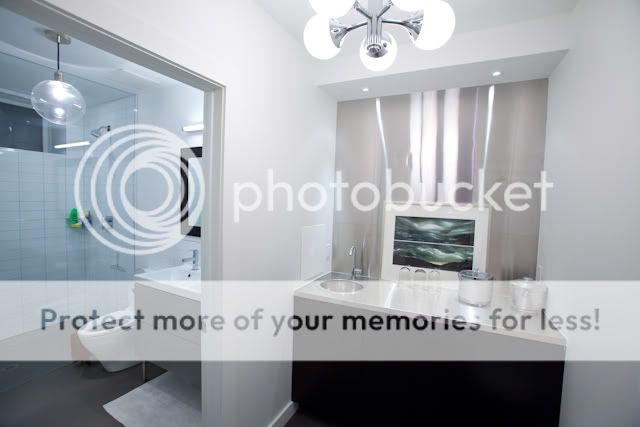

Bar Area
Bathroom

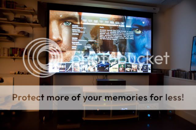

Da-Lite 110" HP screen
Money Shot: Running XBMC and System Turned ON!
There it is - hope you guys enjoyed the thread! I also had a heck of a time dealing with a ground loop hum. This was particularly frustrating because I had 3 dedicated circuits put in for the whole setup! I even called in an electrician to double check everything, but no luck solving it. The only "solution" I found was to have everything plug into a power conditioner and then run a power cable with the ground pin pulled from the power conditioner to the outlet.
I'm not sure if I'd go through all of this again if I had the chance As someone else posted earlier in this thread....maybe I should've just moved and found another house with the basement I wanted.
