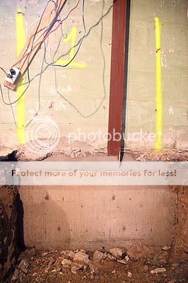

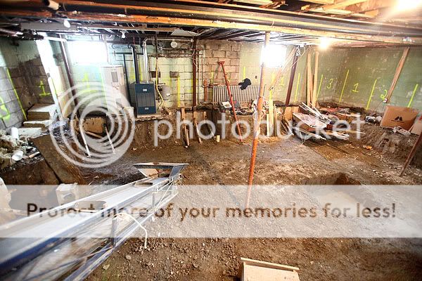

My wife and I bought an old house in 2007 and we spent the first few years renovating the main floor and 2nd floor bedrooms. During this time, my beloved 2-channel and home theater system sat in my basement storage as the basement height was too low (6'-6'4") for the space to be much use as a rec room. Having no main floor family room, I basically had to give up listening to my music and watching movies on my 5.1 system for 2 years (!!!).
Finally, we're getting around to underpinning the basement and the project started last month. We should be getting a net height of 8'6" after the reno is done, and while I won't have a dedicated home theater or 2-channel listening room, I will have a decent amount of space to use for watching movies and listening to my music. So, like some of you, the basement is a "mixed use" facility, which means I'll have one side of the room totally "open" and therefore not great in terms of sound, as seen in the layout below:

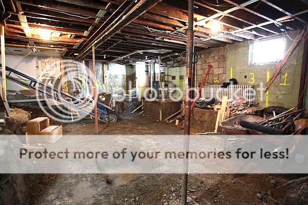

Just for interest, here are a few photos showing the digging:
Before Construction
Excavating
More excavating & underpinning
Now, I've been lurking for some time and I have a lot of questions which I'm not sure if I should post on the specific forums dealing with projectors, screens, speakers etc....well, maybe that's the more efficient way to get my answers.

WOW!! what an undertaking and process >> I'm Subscribed.
So in the 3rd photo - I think I am seeing vertical steel beams being installed alongside the original foundation walls?
Curious were the original footings extended or "added to" any way?

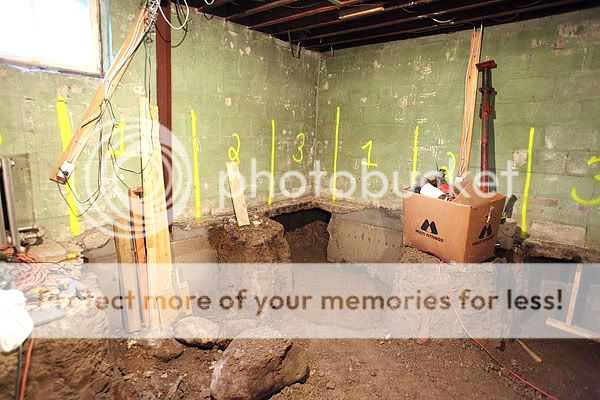

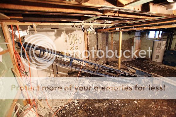

Thanks for all the comments! I'm definitely not doing this on my own especially as I'm embarrassed to admit that I'm pretty hopeless when it comes to being handy around the house. So I've got a contractor overseeing this reno, a structural engineer to design the underpinning and complete the permit drawings in order to get the permits from the city. We're talking about the foundation of the house, so I don't think this is a DIY project for most people.

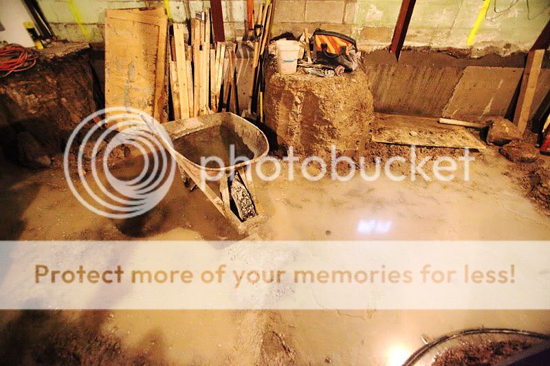

Day 1 - Breaking up the concrete floor
This is a highly labor-intensive job especially as we're going from 6'4" in height to about 8'6". Of course they'll have to dig deeper than that to accomodate the new concrete slab as well as an insulation layer and another 4" of granular. All the digging is done by hand with the help of a jackhammer. The dirt is loaded onto wheel barrels, carried to the conveyor belt, which shuttles it out the window to the driveway.
Day 2 - Conveyor belt

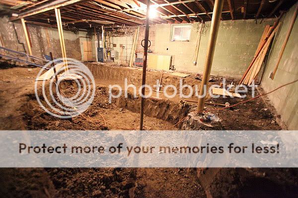

If you're really interested in the nitty-gritty, they have to excavate in sections around the perimeter of the basement so that the house doesn't collapse! That's why they have the "1-2-3" numbers sprayed on the wall - they dig all the section 1's, pour the new concrete footings, wait 24 hours for the concrete to dry, then apply the concrete grout to fill in the gap. This sequence takes 5 days, then they move on to section 2 and then finally 3. Each of the section is 3'4" in length. The first week was spent demo'ing the whole room, breaking up the concrete floor, removing drywall, insulation etc. Depending on soil strength and the make-up of your walls, they might have to do a 5-stage underpin design, which means it's a sequence of 5 sections instead of 3!
So we're in week 4 and they will have all three sections completed by Friday. Then they'll get ready to pour the new floor and locate the drains for the toilet, sink, etc. We had a lot of rain over the weekend so it's pretty muddy down there right now. Luckily, the weather has been warm, because they had to disconnect my boiler. They were originally going to suspend it to the ceiling, but the boiler is heavy. They did suspend the hot water tank, which is electric, so that makes it easier.

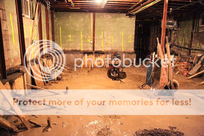

Interior area being dug out (4' in width left around the perimeter)
The steel angles you see from the photo in my first post are required because we went for a height higher than 8'. So the steel angles are there to prevent the walls from buckling inwards.
I'll post more in the coming days but, yeah, it's a HUGE job and one wonders whether it would've been easier to just buy another house with a higher ceiling basement instead of going through all of this! Oh well, there's no going back now! And now that the underpinning is almost done, I have to get ready to make some decisions related to the home theater soon because they'll be moving onto the finishing stage of the reno.

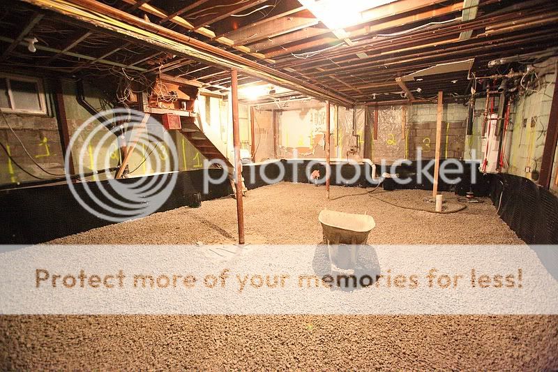

From a dollars and cents perspective, you would never undertake a basement underpinning reno because 1) it's expensive 2) when you resell the house, most prospective buyers (unless they're an AVS member ) won't value a full height basement so you might be lucky to get 50-60% of the money you put into it. We're planning to stay in this house for a while, so even though it might not make much sense financially to do this, we're planning to get a lot of enjoyment out of the extra living space so this is worth doing for us!
Now I'm from Toronto, so I don't know if contractor margins and construction costs are similar to where most of you guys are. Pricing for underpinning a basement falls in the $40k-$50k range for an average size home. They'll cost it out based on linear feet of the room. Also, I think most base it on getting you a net 8 ft high ceiling. Obviously, depending on how the engineer has designed the underpin (soil strength, condition of existing foundation, local building code, etc.), there'll be additional costs. As I mentioned, because we went for 8'6", which is the height of the main floor and 2nd floor, they had to dig a little more and insert the steel angles and so that was an incremental cost. The cost is almost all labor - the sequencing of the excavating, concrete pouring and grouting must be followed, so there are no short cuts. And, as you can imagine, it is HARD WORK - the crew working on this job only consists of 3 people!

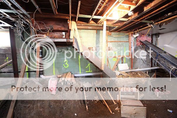

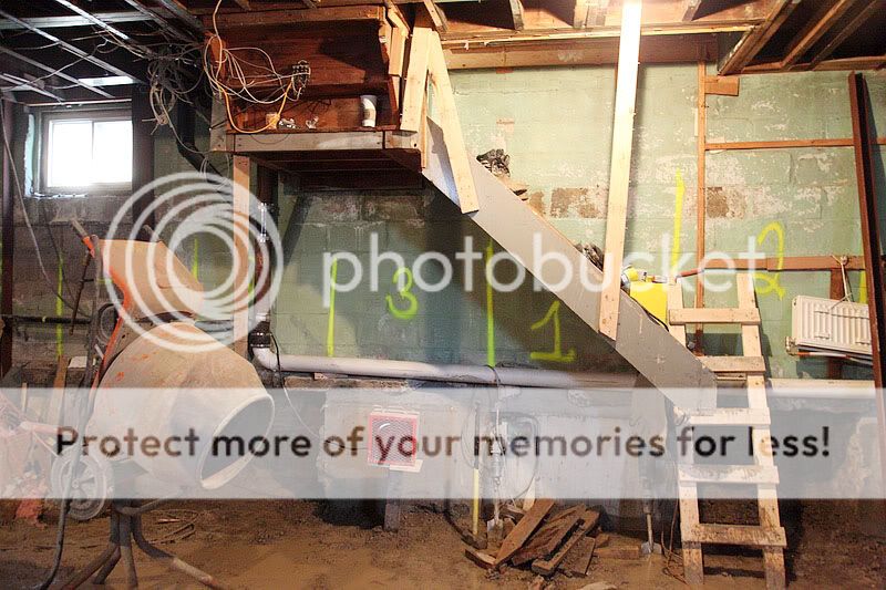

Anyways, back to the picture show:

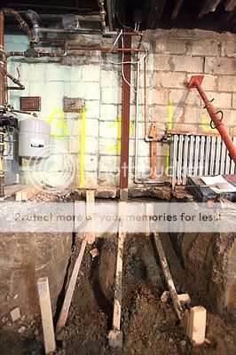

Week 2: Jack posts are up and Section 1 concrete blocks poured
Close-up of concrete and bracing for it
After concrete grout has been applied
One of the Section 3's opened up
Stairs suspended to joists and plumbing stack re-routed
View from the stairs

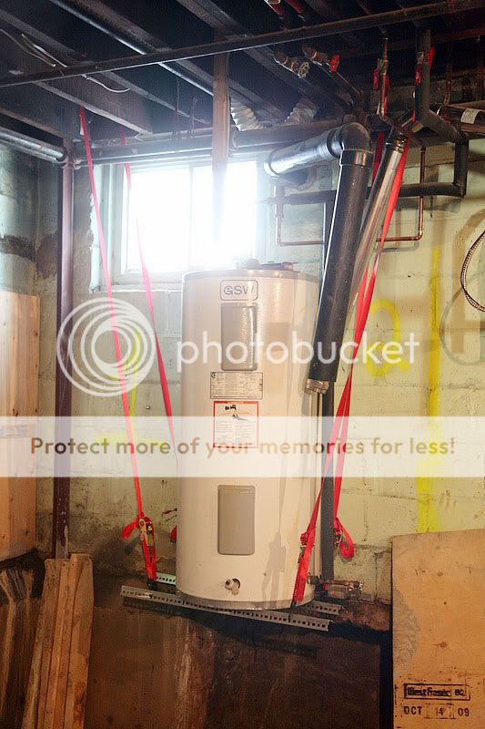

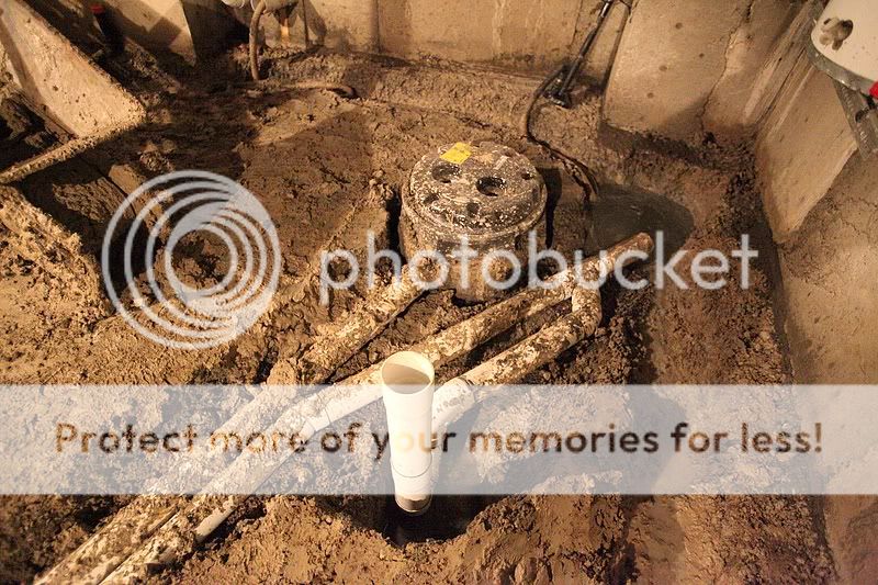

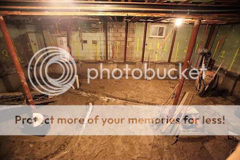

A few more photos for tonight...all these photos are reminding me of the time i visited Palm Springs and driving along the freeway - everything is brown. And brown remains constant wherever we drove to All the photos are kinda looking the same now.
We had quite a bit of rain last weekend and A LOT of water came through. Walking, never mind working, in this muddy soil is almost like having a lot of gum always stuck to the soles of your shoes.
Suspension of hot water tank to joists
Another shot of the stairs and the make-shift ladder to go down
Concrete poured for the last section
lpw is offline

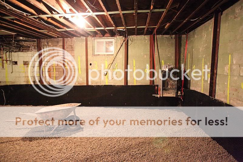

Well, we had 3 consecutive days of rain and not just the light stuff. Also, only one of the three underpin sections had concrete poured so I imagine there wasn't much preventing the water from coming in. We had the engineer come by and he didn't think it was out of the ordinary and that once we have the platon on the walls, the weeping tile and sump pump installed, that should take care of the water coming in.
The contractor is, in fact, putting in the weeping tile this week, then installing the radiant floor heating pipes and pouring the new floor later this week. I'll post some pics tonight.

Posts: 150
We're at week 5 now and these photos will catch you up on where the renovation is as of today. Despite the construction zone being on a separate level of the house, renovation definitely introduces a lot of inconveniences and puts a strain on the normal day-to-day things that we all take for granted. So I echo some of the comments you guys have posted - I also hope all the expense and headaches of living through a renovation, especially one as big in scope as this, will be worth it in the end!
Installing drains
Sewage Ejector Box
Week 5 -Gravel for flooring is in, conveyor belt removed and no more mud!
Home theater area (boiler suspended to joists)

What happens to the sewer lines? Do they stay where they are or do they get dropped too (with some sort of ejector pump r something)? Thinking of doing this same thing to half of my basement but wondered what would happen to the sewer lines. Looks quite impressive. Good luck with the rest of the build.
EDIT: OK, didn't see that post you snuck in there an hour ago. Awesome.
