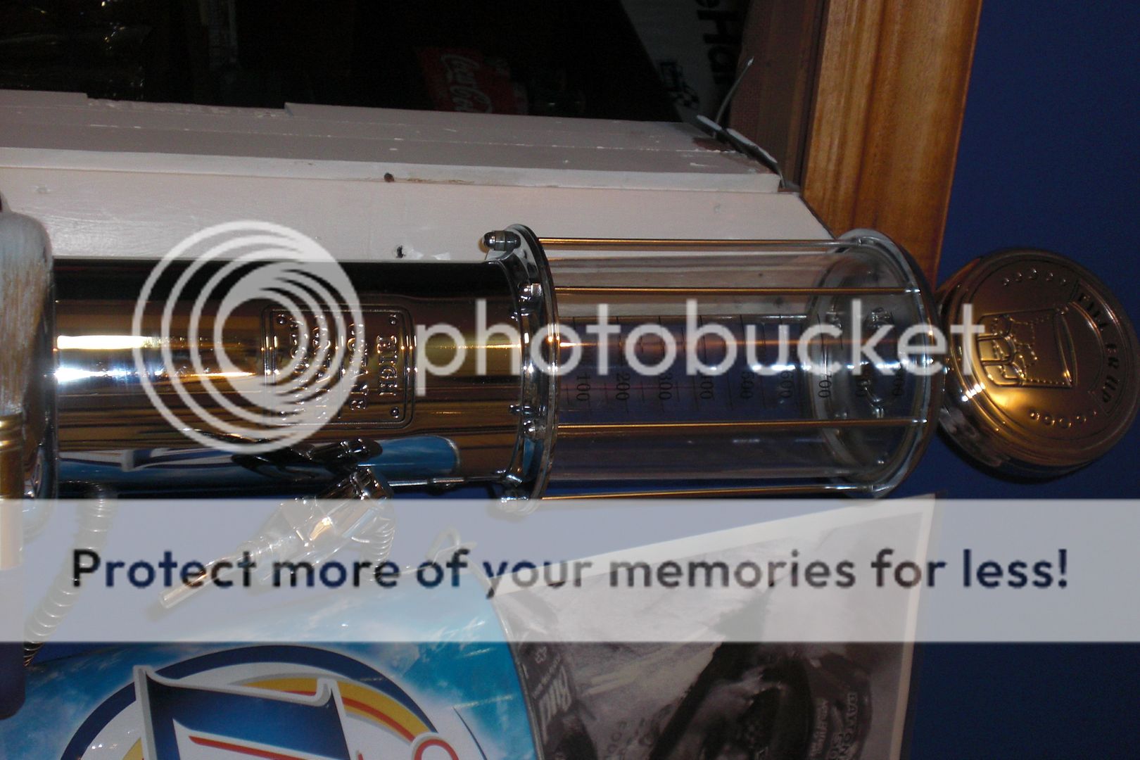

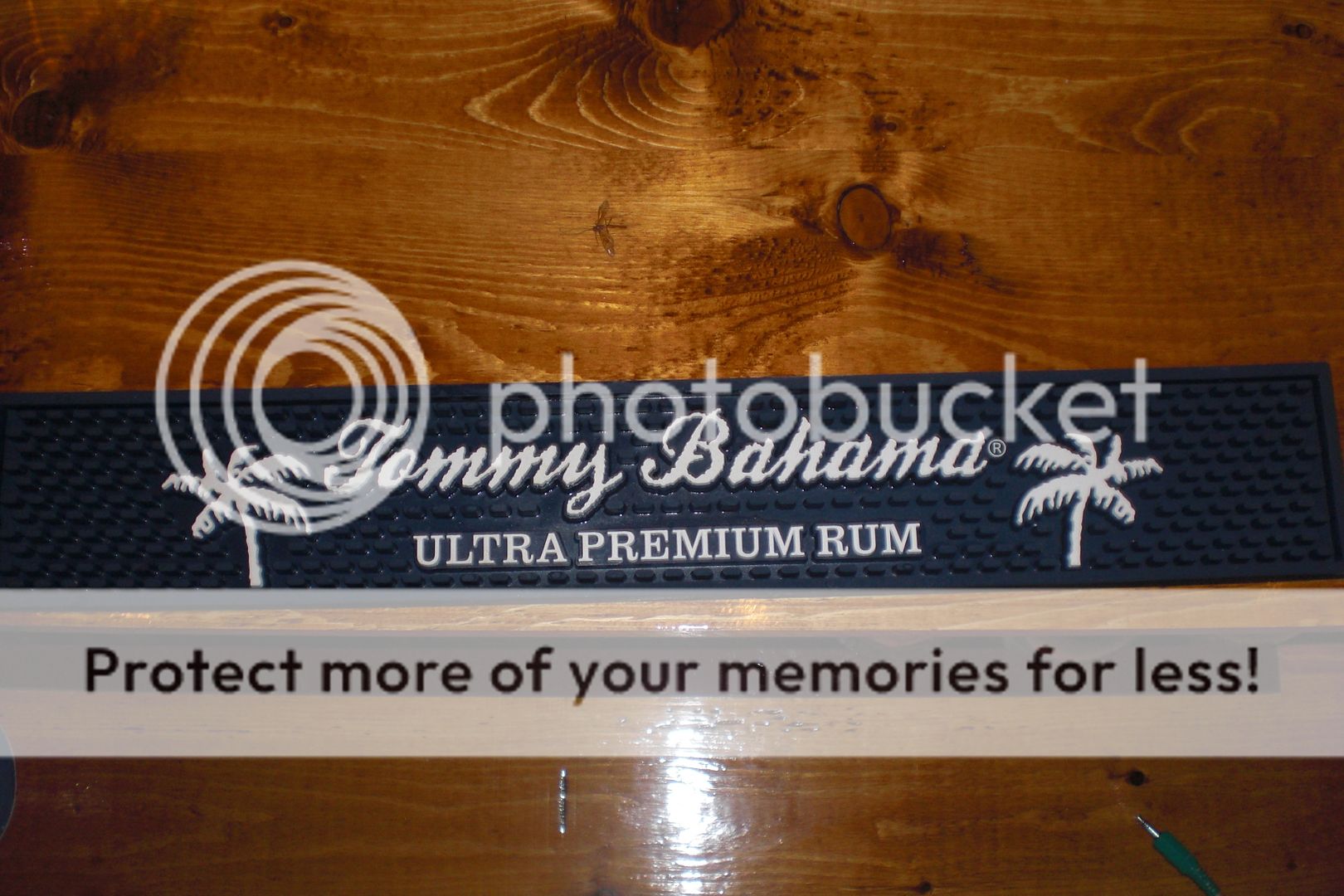

So... Some more "peices" of the bar
bar mirror $40
bar mat. Freebie
painting from my grandparents party room. freebie
cool logo from my grandparents party room. freebie

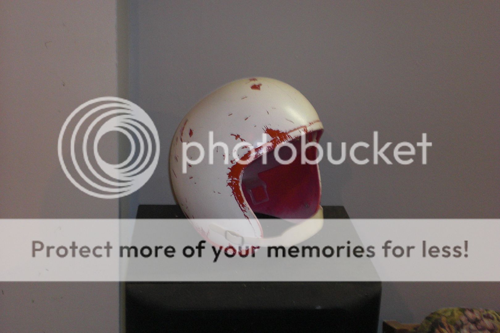

old broken football hemet (next mini project). freebie
plastic toy racing helmet. freebie
liquor dispenser. $20
cool beer bucket freebies
The Pitcher that started this all! Someone gave me that set of four glasses and the pitcher as a wedding gift. They thought I already had a kegerator, what a novel idea!!!!
consider this picture deal to be... FIXED!!!!!

Thanks, I am trying to decide what to do with it. Part of me says paint it gold and leave the facemask laying off of it. The other part of me says to paint it like a colts helmet and fix the facemask.
whats everyones opinion on this? (and no, I am not painting it like the saints, steelers, patriots, or usc, so dont even say it!)

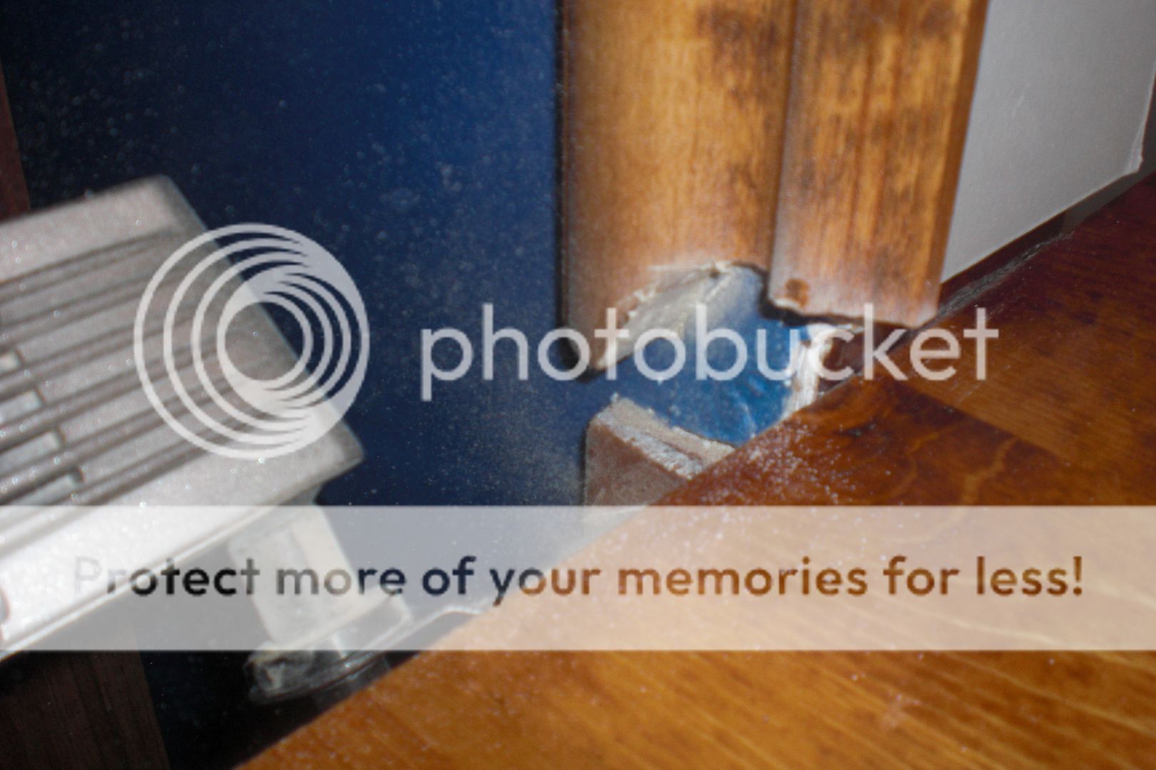

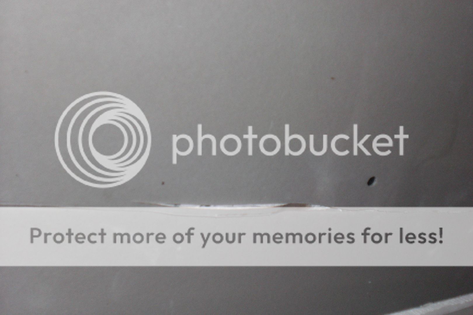

Well, I am officially over drywalling!!!! I hate it. I am not very good and I seem to break as many peices as I am getting put in. The big sheets are easy and no problems there. Except one of the sheets that I used is bent wierd and I had to use five screws in the same area to help hold the drywall to the studs. And the little areas and spots that need to be trimmed to fit are really starting to piss me off!
I wish I had the money to pay someone to come in and do this for me!
The latest screw up the i litterally put my blood and sweat into!
(stupid razor blade)
notice the wave in the surface and the cracks on the side, AHHHH!

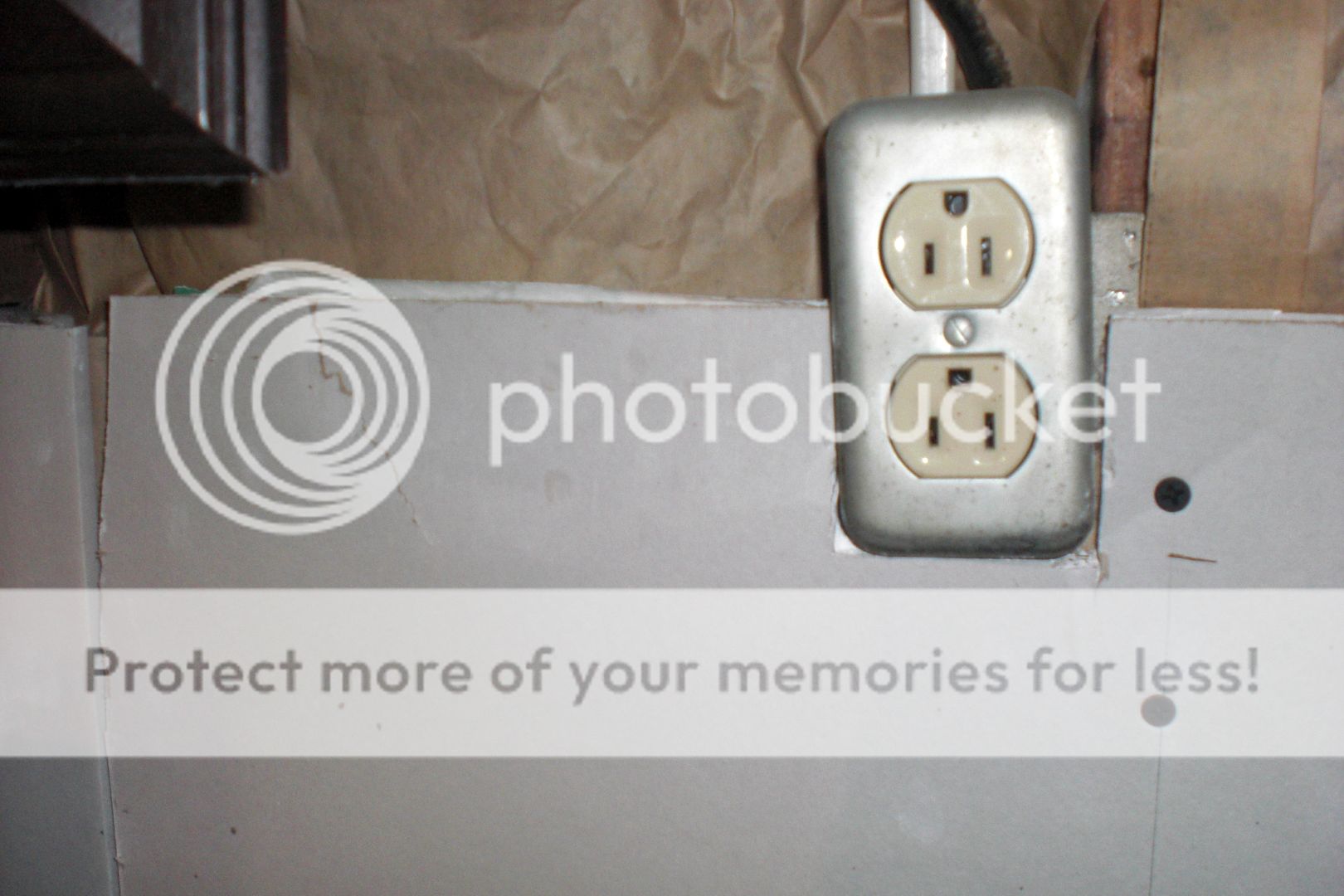

Originally Posted by beach31684 View Post
Um, I know you are upset right now, but I can't let this on go...
When you are installing drywall around an outlet, you remove the outlet cover before you put in the drywall. The drywall is cut to be flush with the box and then the outlet cover covers the drywall seam. The way you have this installed now, the edge of the drywall will be visible around the outlet.

Beach,
I must say I am concerned about those seams also. Are the seams on studs?
It doesn't look like it, if so, you should be screwing both sides of the seam, about a 1/2" in from the seam.
You are right, full sheets are relatively cake, but cuts can take some practice., but in the end, tape and spackle can fix a world of hurt. Though tape and spackle can cause a world of frustration too!!
I strongly second BeerParty's comments, although i can't tell how much your wall plate overhangs the electrical box.

ha. Thanks for the comments and concerns on my anger issues. Dont worry about me being upset, this thread is my tool of release. I am only saddend(IF THATS A WORD) by the fact that I have to redo that at this point.
As for the outlet box, that is a really wierd angle that I didnt notice before. Plus, the cover that I will be using is larger and does cover the edge by about half an inch. But since I will have to redo this, I will go back through and make it a little more snug (thats what I tried to do, but apperently my measurements were wrong) hey, in the immortal words of my hero, "perfect practice makes perfect" right!

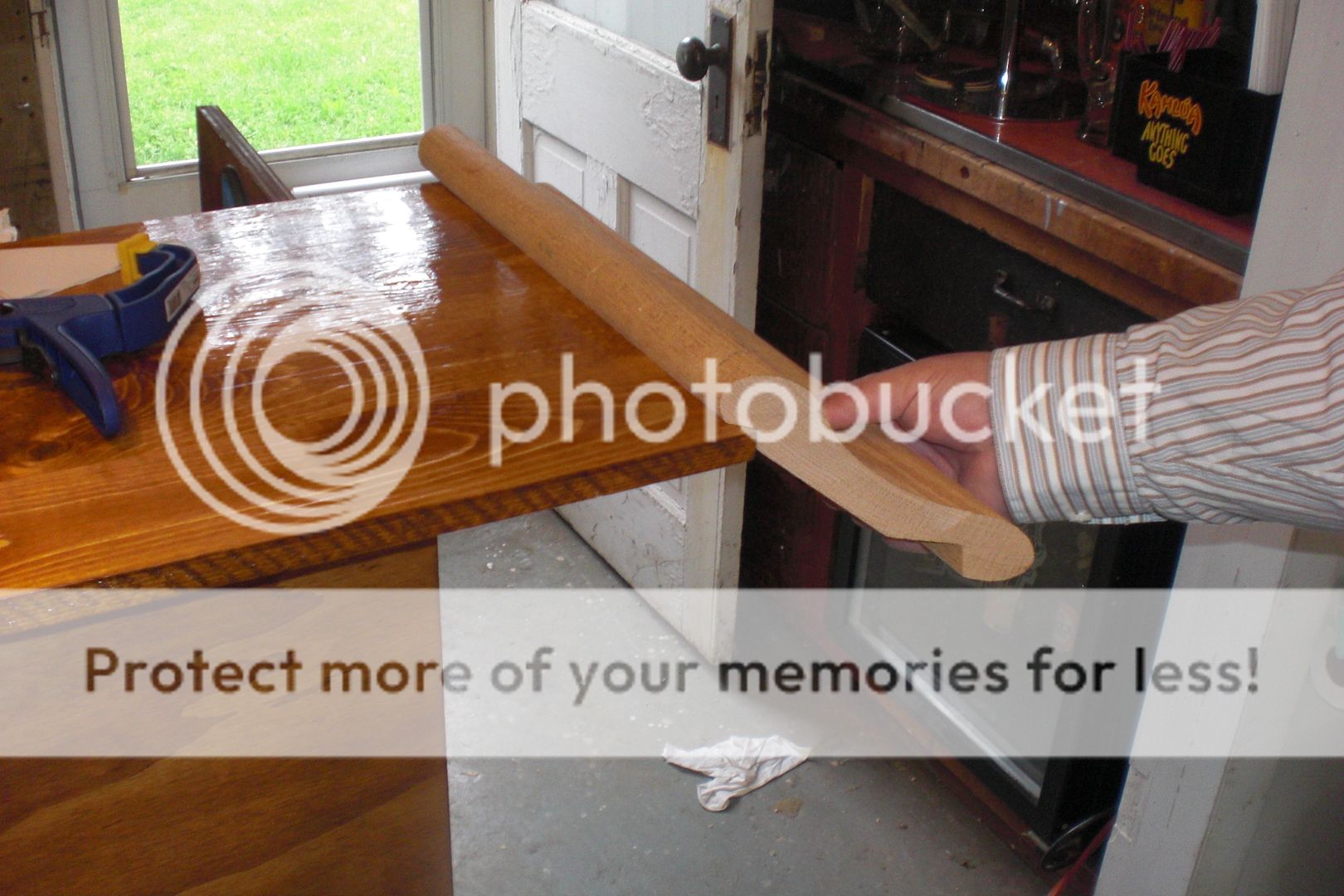

I have one 8' section of rail, and one 6' section of rail. The bar is 8' long, so I cannot use one full peice on the front. and the 6' peice seems to be slightly warped, (very slightly warped) so before I cut it, should I do something to striaghten it, like take it back and get a different one? I just dont want to cut it and then find out I have to get a different peice to make this work.
Keep in mind, This rail is by far the most important item of the build (and the most expensive). I am trying really hard not to screw this up, so if I ask a ton of questions between now and monday, bare with me.

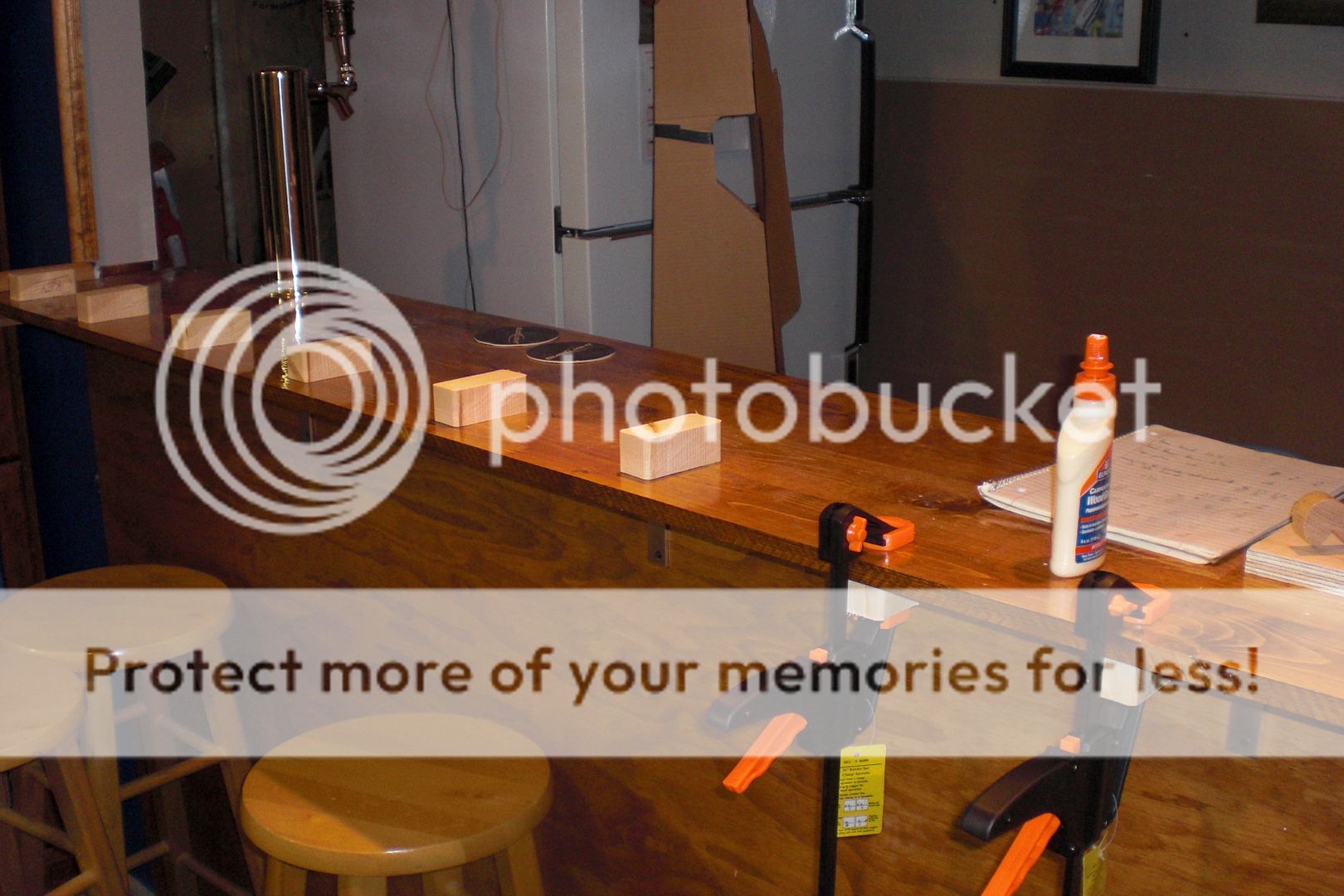

Beach, is it safe to assume you are building up the existing bar top? If so, the corbels sound like they will be only decorative, and if that's the case, you can put them on later. Or are you planning to replace the L brackets with the corbels?
As for the bar rail, the most ideal thing to do is to get one length, 14', and cut the two pieces you need from that. This way the grain pattern will be a good match, and you don't have to have a two piece front rail.
BUT, if you do end up with a two piece front rail, put the smaller piece against the wall, away from the miter. It won't stand out as much that way.

But I just pulled the trigger on the 14' oak bar rail. My loving father is grabbing for me today since their ours are 8-5 and mine are 7:30-5:30 go figure.
So now the front of the bar will be all one peice!

But seriously, the bar rail is home at last. I will at least have it dry fitted and ready for light sanding and staining by sunday.

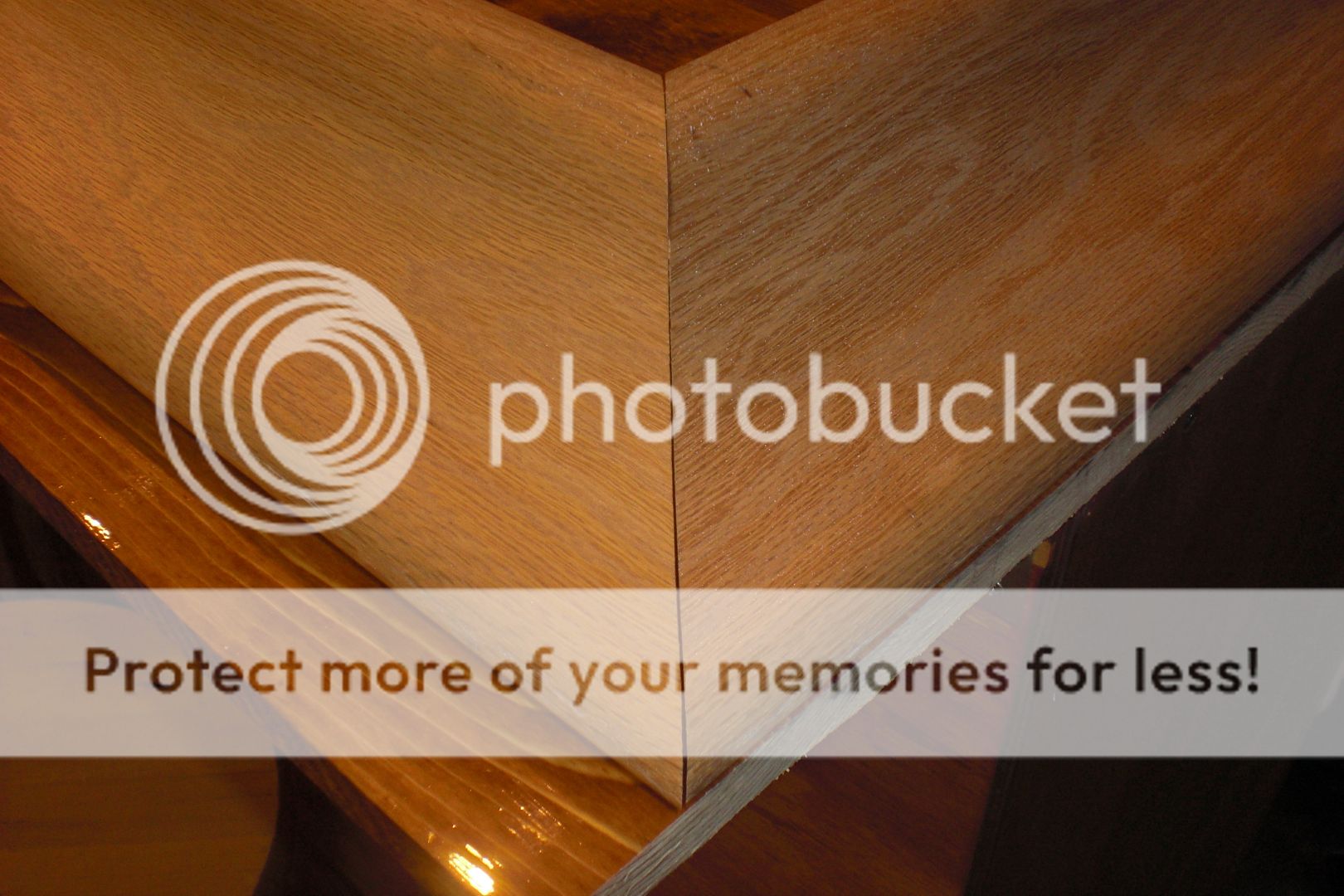

Tisk tisk, ye of little faith. I do apologize at the time of the pictures but, as I promised, it is still sunday and I have the updates.
First, I was delayed in starting on Saturday. I had to say goodbye to a dear old friend of mine. My grandpa died back in 2004, this was his car. A '72 Hurst/Olds Pacecar of the Indianapolis 500, the stickers have been off since the Resto. My grandma finally found a buyer. So I took it for one last trip. For both of us to say goodbye.
Thanks for following me on my little trip.
Now on to the fun stuff!
First I had to cut the trim to fit the bar rail
Then we cut the other side peice
and the most nerve racking part was not screwing up the front peice, but the corner mock up seems to have gone nicely!
Next up... this week I will be working on actually mounting the rail to the bar!

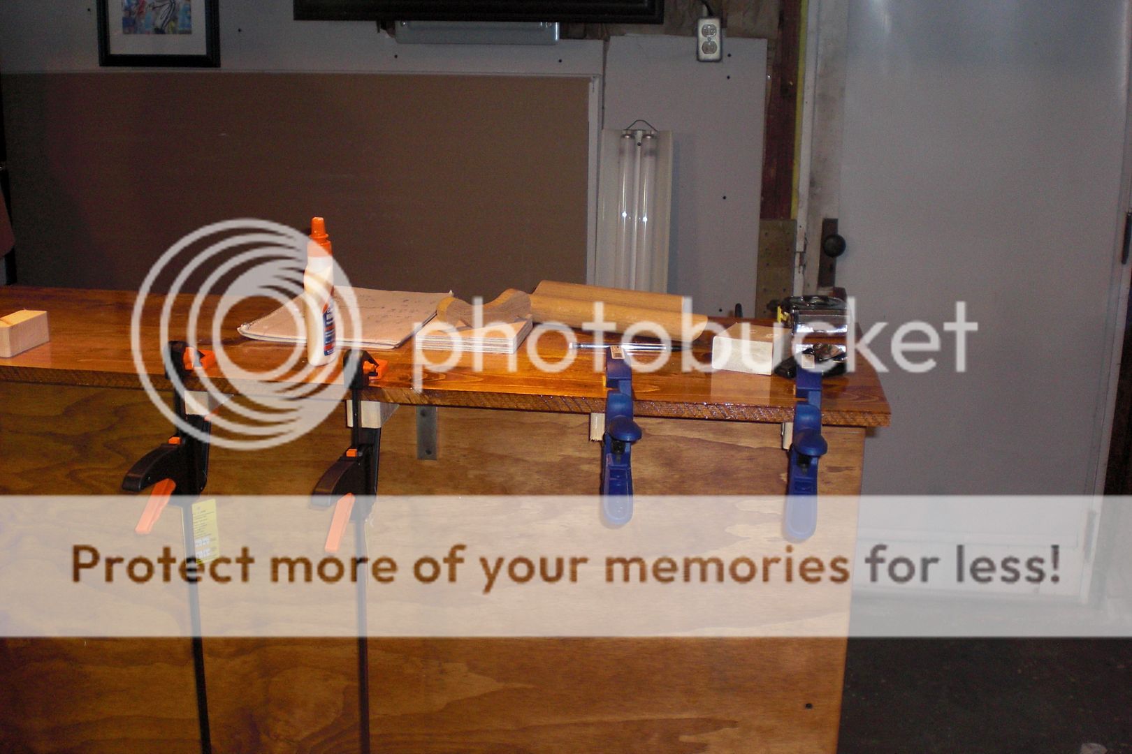

Quick question. The guys at the wood mill said that I would be fine without removing the bar top. To put it simply, I just need support for the bottom of the bar rail and it doesnt have to run through to the other side of the bar to do it.
What does everyone think about that? I like the idea because that means I dont have to changed the height of the top (which I think is perfect).

Okay, before anyone says anything about how crazy this looks, I know.
I have a friend that is an engineering major. I am relying solely on him at this point. So please, go easy on me!
The 2x4's you see are the only way I could reach the proper measurements (without going out and buying more wood that I dont have the money for right now)
In this picture specifically you are attempting to incorrectly mount the rail. The issue I see (having installed nearly 18 feet of the stuff) is that it will not be supported properly and when someone leans on it it may snap off (no matter how much glue or how many nails/screws you have.)
See how the rail has two "lips"? The top/upper lip is to be rested on a second layer of mdf, plywood or whatever you choose and the bottom/lower lip is to be rested on the base layer of material which is what you have installed already. The cost to fix this is only the cost of a single sheet of 3/4" ply, mdf or whatever. I would wait until you can get that to install it properly so that you dont damage your expensive rail and/or bar.
Just my $.02
