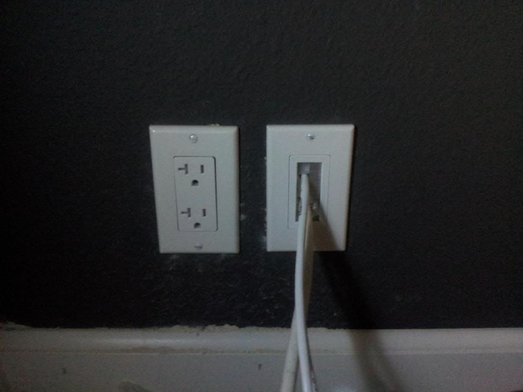

Damn it's been a while! I've made a lot of progress in the last 4 years.

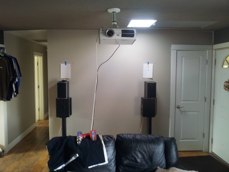

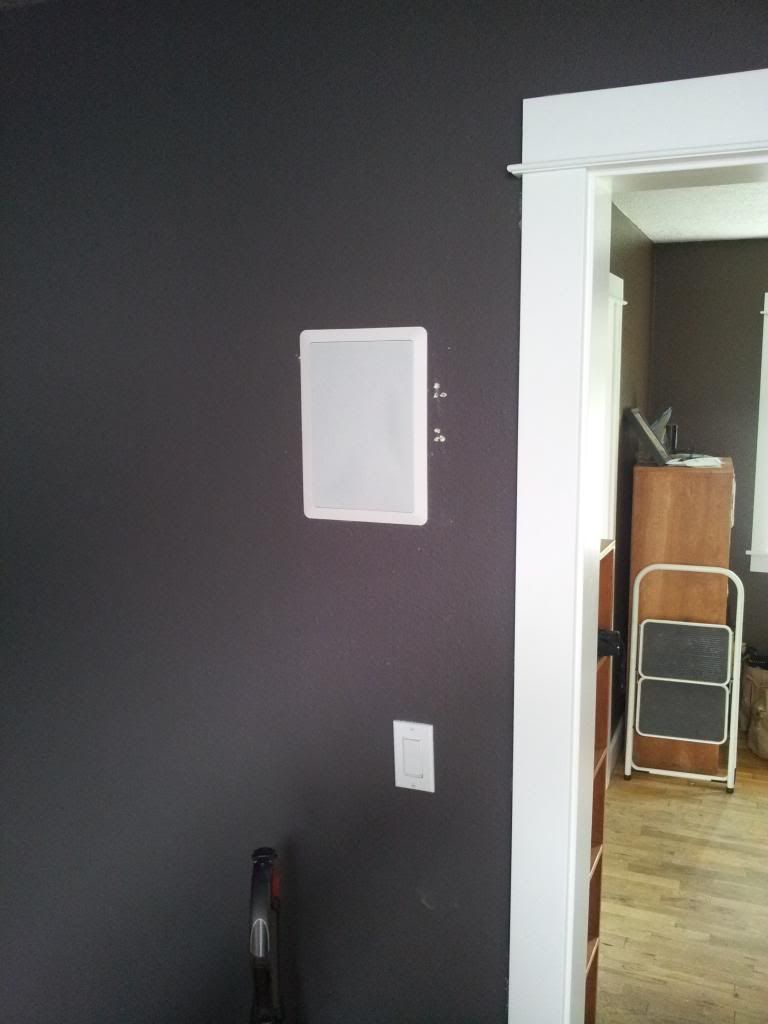

Here I'm trying out 7.1 and trying to decide how high to mount my surround speakers.
Dedicated 20 amp breaker with one outlet in the attic for the projector and the other behind the component stack. HDMI run through and down the wall.
Rear surrounds installed, eventually I'll paint then to match the wall.
Component stack organized and rear cut out for cooling.
Left side surround
Right side surround

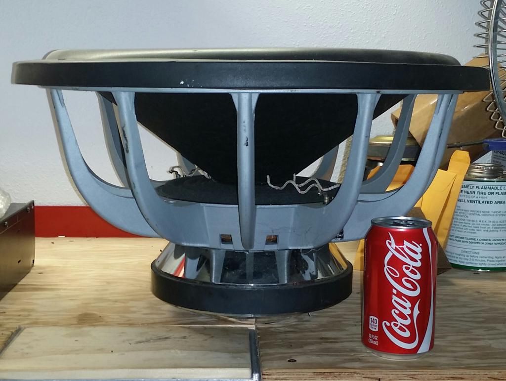

Got my avalanche 18 out of the attic

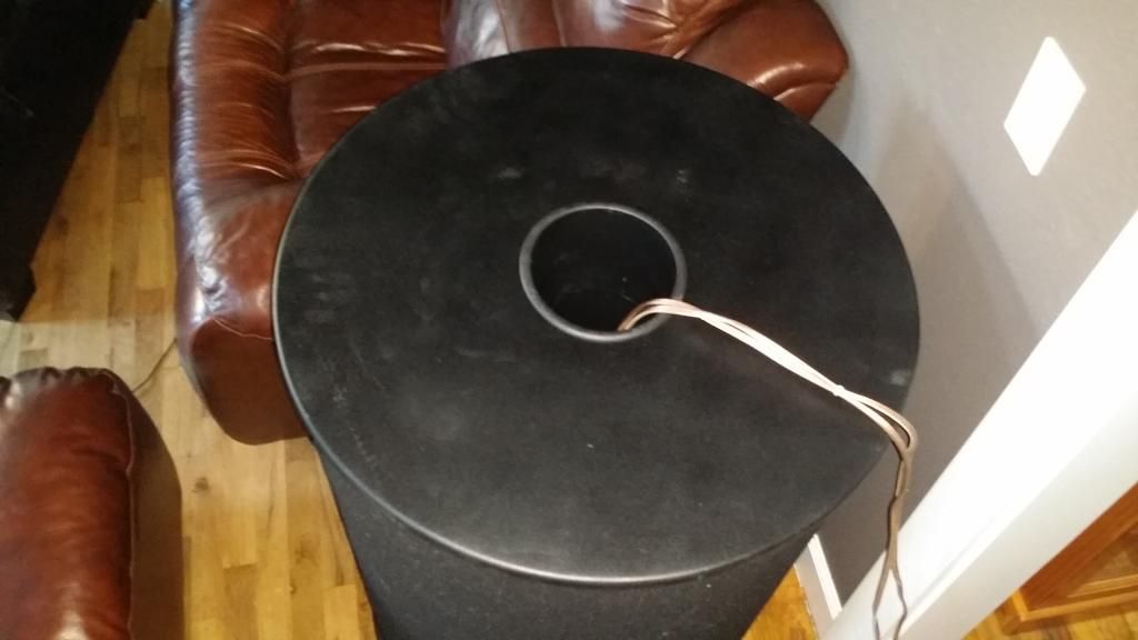

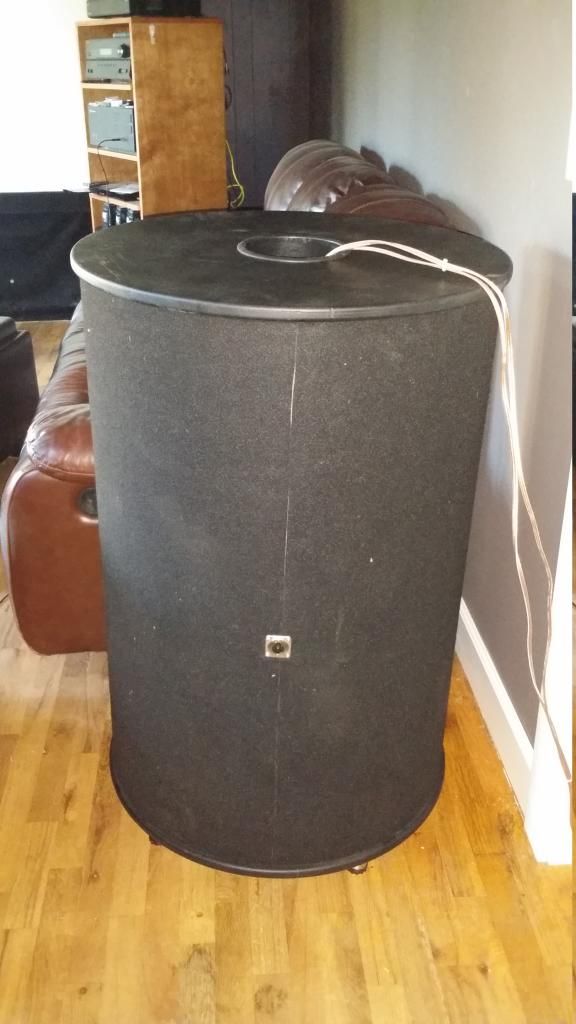

Box I found on craigslist, 8.5 cu ft tuned to 20hz with a 6" port. Turned out to be forum member pdxrealtor. He gave me a demo while I was there. WOW! His setup gives me something to shoot for.

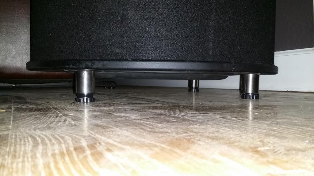

One of the feet broke, I'll see if I can find a replacement.
Couldn't find a speakon connector in town so I'm running the wires through the port for now.

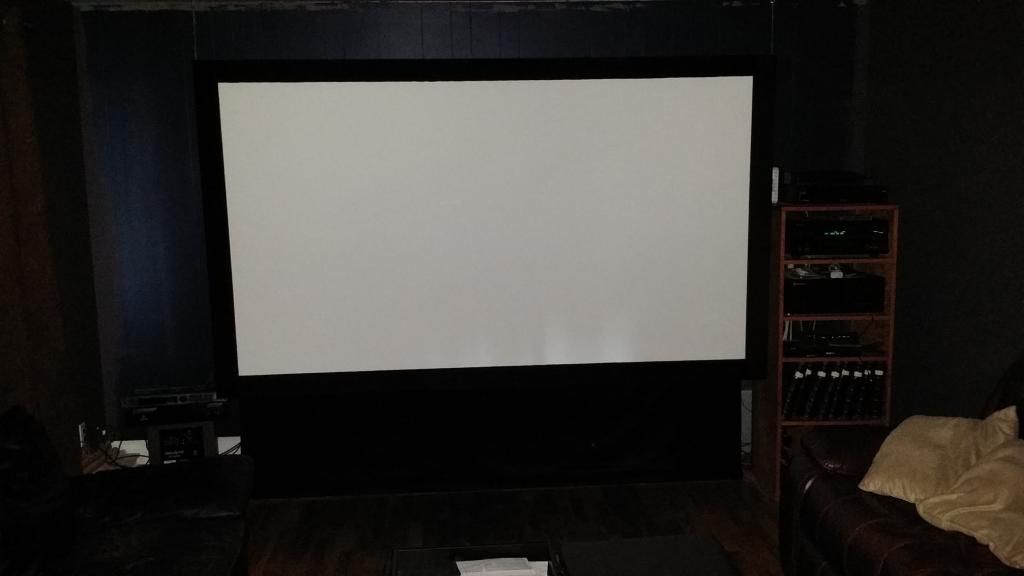

It's hard to get a pic of it with a cell phone.

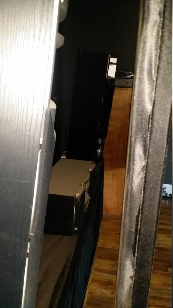

The screen is hanging from the ceiling via cables.
Speakers tilted and toed in behind the screen, are on a table made of 2x4's that's wrapped in velvet to hide the hearth. The back of the screen is covered with black grill cloth to cut down on light going through the screen.
Moved the sub into the corner, put the amp and BFD behind the screen, ran audyssey, and calibrated the projector with the WOW bluray. Then I enjoyed Jurassic Park on bluray. Man this is so much more impressive.
