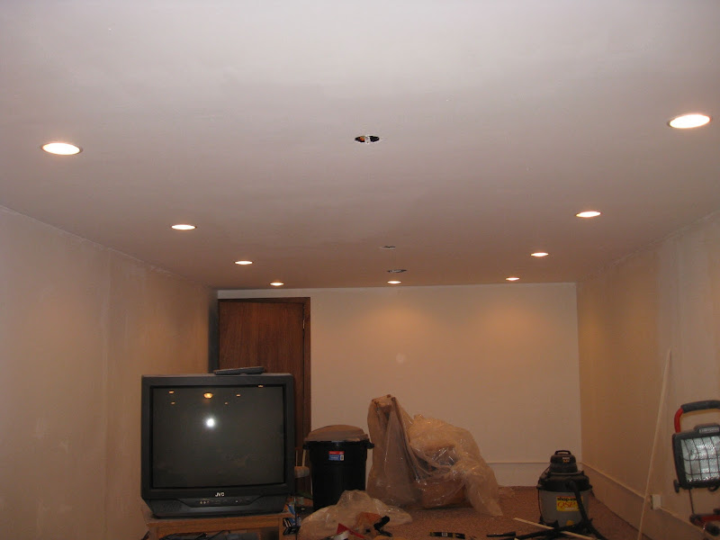

It's been a while since I've posted pictures, so here are my gratuitous If I put up pictures, people will think I've been working on my basement pictures. Here's a picture of the room with all of the furniture removed, except for a glider and a chair that I couldn't fit into the unfinished side. And, of course, the TV so I can watch the games on Sunday while I'm working.
As I mentioned previously, the ceiling is primed. I'm just trying to find some time to put a coat of paint on it. Then I can get the recessed lighting and vent covers back up. We still haven't picked out new overhead light fixtures. We looked for a while at Home Depot, but didn't see anything to our liking, so we are probably headed to Lowes or Menards this weekend. We are pretty lucky because both Home Depot and Lowes are within 5 minutes of our house, and Menards is about 10 minutes away. This is especially helpful when you run out of primer at 9:30 PM.
I'm ready to paint the new wall. I finished mudding/sanding last weekend, so I sealed it and sprayed orange peel texture on it earlier this week, and then put a coat of primer on it last night. While I wait for us to pick out a paint color for the walls, I'm going to get the outlets and switches wired up and then start cutting the additional holes for low voltage wall brackets.
Same products that RTRose used for his project.
Here's a shameless plug for Homax spray texture. I read a lot of mixed reviews about it, but I have to say that if you follow the directions, it works great. I didn't have a single issue with it, other than the price. If you have a pretty small project like mine, I would recommend it.
We are getting pretty close to deciding on a carpet. After much looking and research, our budget somehow crept up to around $4/sq ft. I'll put up a picture once we make the final decision - hopefully this weekend.
Upon further review last night, I think I'm also going to replace all of the baseboards and the doors. The baseboards need to come off anyway when I do the Dricore subfloor and carpeting, and after inspecting the doors last night, they are in worse shape than I originally thought. Like everything else in my basement, they were not installed very well at all, so I'm thinking about starting over.

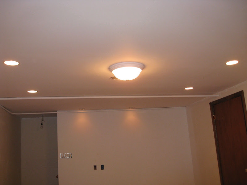

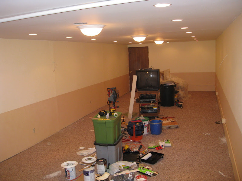

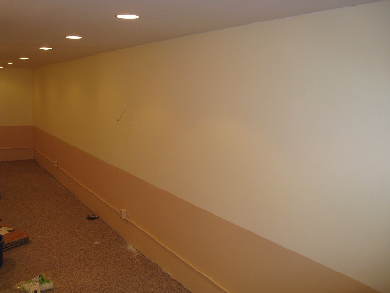

Unlike like my last post with the pseudo-progress pictures, we made some actual progress this past weekend. First and foremost, we've decided on carpeting:
Over the past couple of months, we've ended up with about 200 paint samples from various stores. We took the carpet sample to the basement under the correct lighting last night and eliminated most of them. As of this morning, we probably are down to about 20 samples, and I think my wife is finalizing the colors today (or at least will probably be down to about 5 colors by the time I get home).
I did get the coat of paint on the ceiling on Saturday night. We also picked out the main light fixtures. After not a lot of luck at Depot or Lowes, we ended up at Menards on Saturday. Wow, they've got a great selection of lighting! There were probably about 3-4 options that we both agreed on. They were also having a 25% off sale on all lighting, so we brought home three options for a dining room chandelier. We (almost) finished redecorating our dining room about three years ago, but we never got around to replacing the light fixture and the door hardware on our china cabinet. It will be nice to have another room completed instead of almost there. (We also redecorated our ½ bath a couple a years ago, but we still need to put in new floor tile. We bought the tile over a year ago, but just haven't installed it).
Anyway, back to the basement. I installed all of the recessed lighting trim, installed one of the new fixtures from Menards (they had a paintable base, so I started with one to make sure we liked it), and wired in all of the switches.
I still need to install the other two light fixtures (hopefully tonight) and the two vent covers (which also need a couple coats of paint), and then the ceiling should be complete. Oh, and I need to do something with the electrical conduit up in the corner. Not the big water pipe (which I discussed in a separate thread), but the one near the wall wash recessed lighting. It was secured closer to the ceiling when I started, but I ripped off the wall fasteners so I could paint the ceiling a little easier.

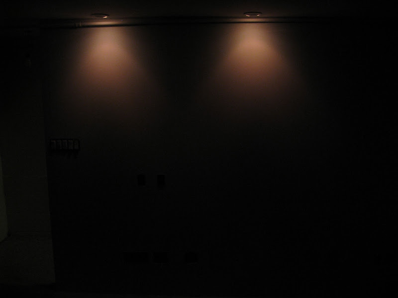

It's a little annoying with the wall wash lighting on right now:
I've taken off all of the baseboard trim, cleaned up a couple small areas that had mold, and am in the process of doing the last repairs on the wall before painting. The hope is that we can start painting the walls on Wednesday. As of last night, we were leaning toward a two-tone wall with a chair rail. I guess I'll see if that's still the plan as of tonight.

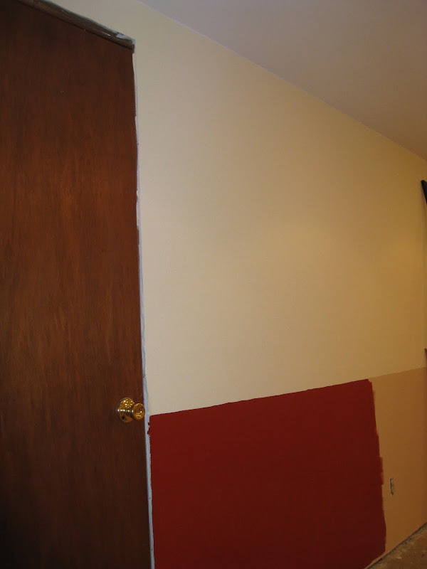

I got home last night and my wife finished the first coat on the top of the wall in the morning, and then was able to get the second coat on in the afternoon. So we worked on the bottom half and got the first coat completed last night. So what do you think?
We aren't completely sure at this point. The carpeting we are putting in is a darker shade of brown, so it probably won't bring out the orange/pink in that bottom layer as much. Also, I've heard from two people at work that the chair rail will make a huge difference. I guess we'll take another look tonight and make up our minds.
brewersfan73 is offline

As for feedback on the color - the bottom color looks a bit on the light side for my tastes, and a bit orange. Maybe it's the light in the photos, but I'd hope the carpet and/or the chair rail pulls the darker colors in that out. Can you get a larger carpet sample in there to eyeball it?
Although I think a darker color would definitely look better on the bottom, we have a problem with no ambient light and lower ceilings, so I didn't want too dark of a color that would make the room look small. The biggest concern to us at this point is the orange color that you mentioned. No, we can't get a larger carpet sample. We have one swatch that is 1' X 2', but it's attached to a display board so it's really hard to gauge it against the walls.

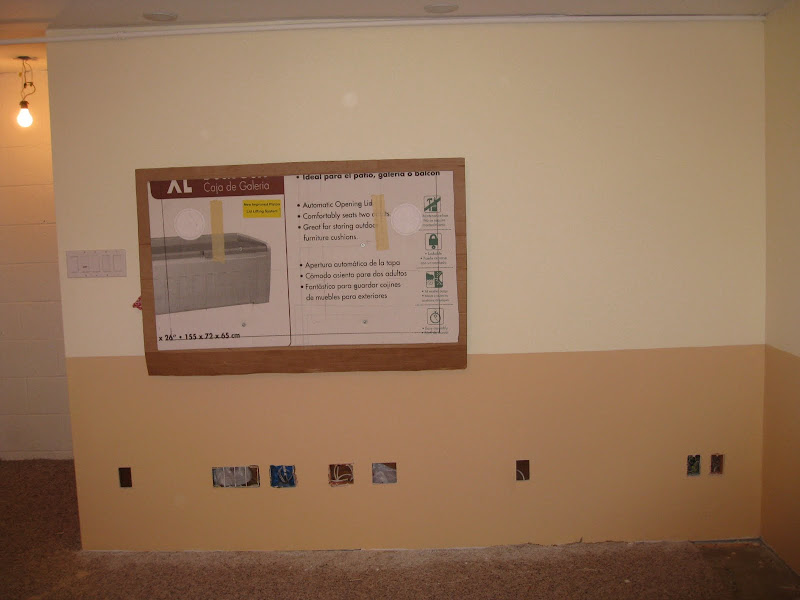

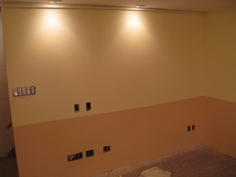

Since my thread got bumped to the 2nd page, it must be time for some updates. I kept forgetting to download the pictures off my camera, and I know how the crowd on here disapproves of updates without pictures.

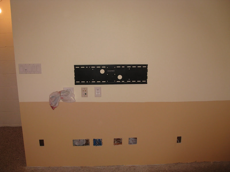

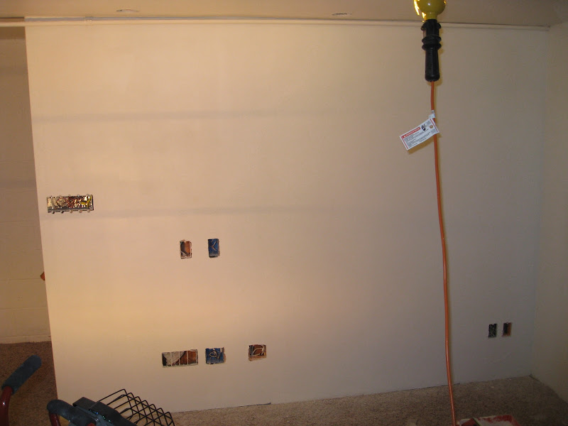

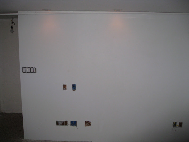

I finished making holes in the new wall for all of my wiring needs. I also put on the faceplates and plasma wall mount on the top part of the wall since we are 95% sure we are staying with that color:
And a picture with my new TV mounted. Sorry, I don't get very good reception down here yet.
(and yes, my chair rail line and the face plates behind the TV are not completely level, but the TV mount definitely is)

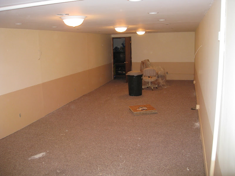

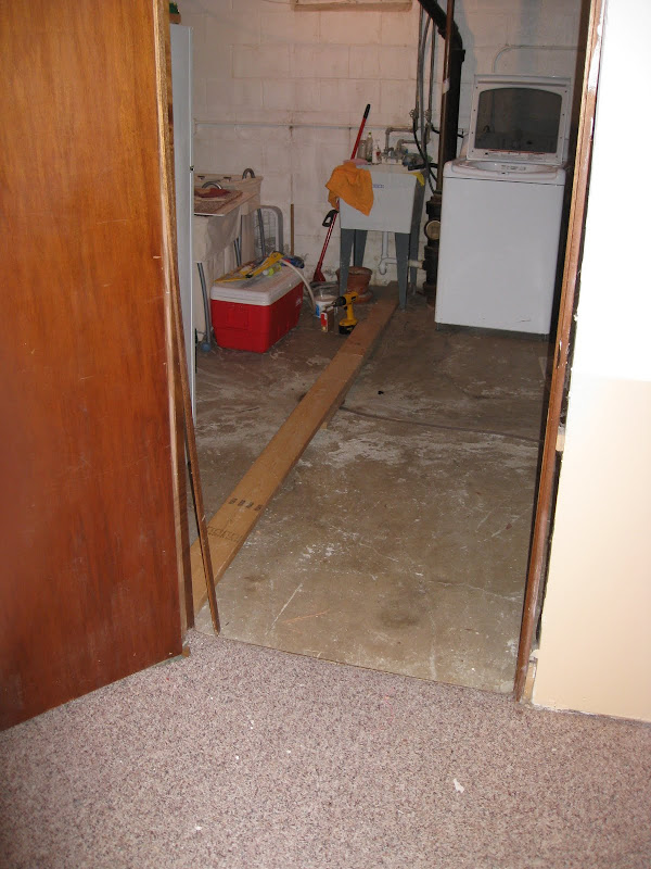

The sales guy was scheduled to come over this past Monday, so I had to clear out everything in the room. Those are my first Dricore tiles on the floor. I bought them so I could play around with them and verify the dimensions. I also wanted to make sure that my carpeting guy didn't have any questions about them.
And finally, the room without carpeting.

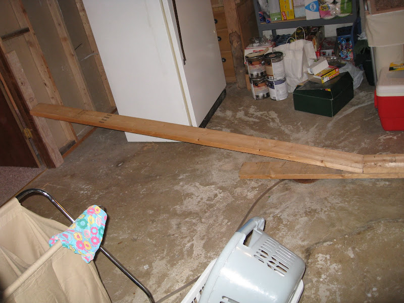

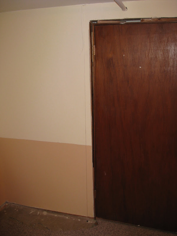

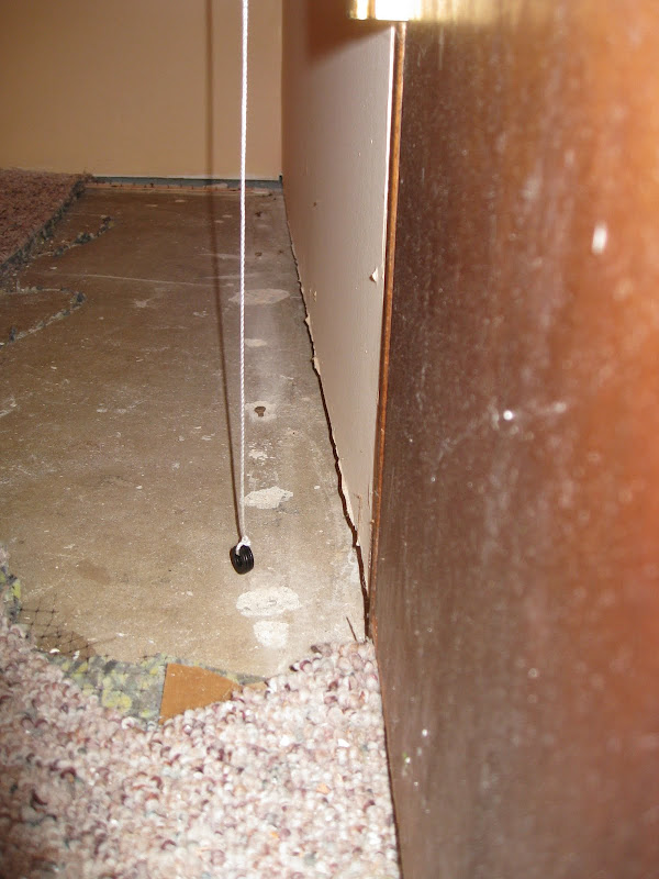

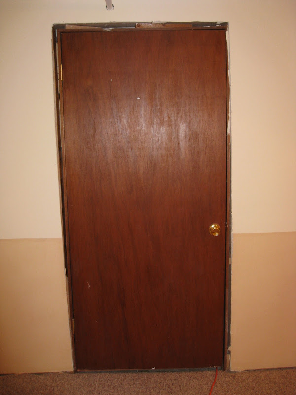

As I was measuring the rough opening for the door, I realized that it was out of square.
No big deal. I've never hung a door by myself before, but I had a pretty good idea how to get it plumb. But as my father-in-law and I were discussing how to do it, we measured to see if the rough opening was plumb front-to-back. Not sure if you can see it in this picture or not. The wall that I'm standing next to when taking the picture is plumb, but the wall on the other side of the door opening is leaning. From this point of view, the bottom of that wall is kicked out to the right.
So I hung a plumb line from the corner of the wall and ceiling
and it was off by about this much (about 2):
Now I can see why we've had so many problems with this door and why the trim work was nailed on how it was.

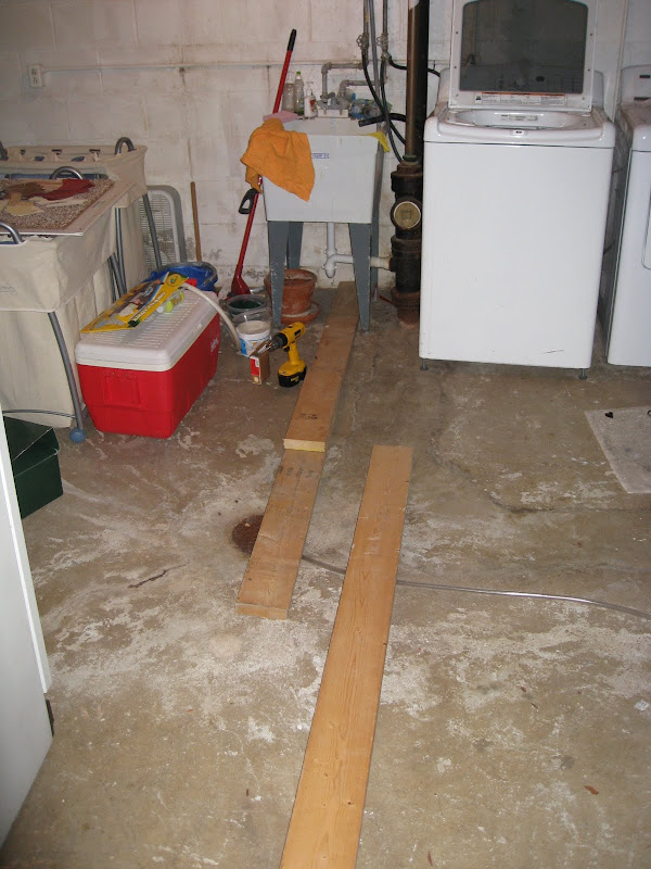

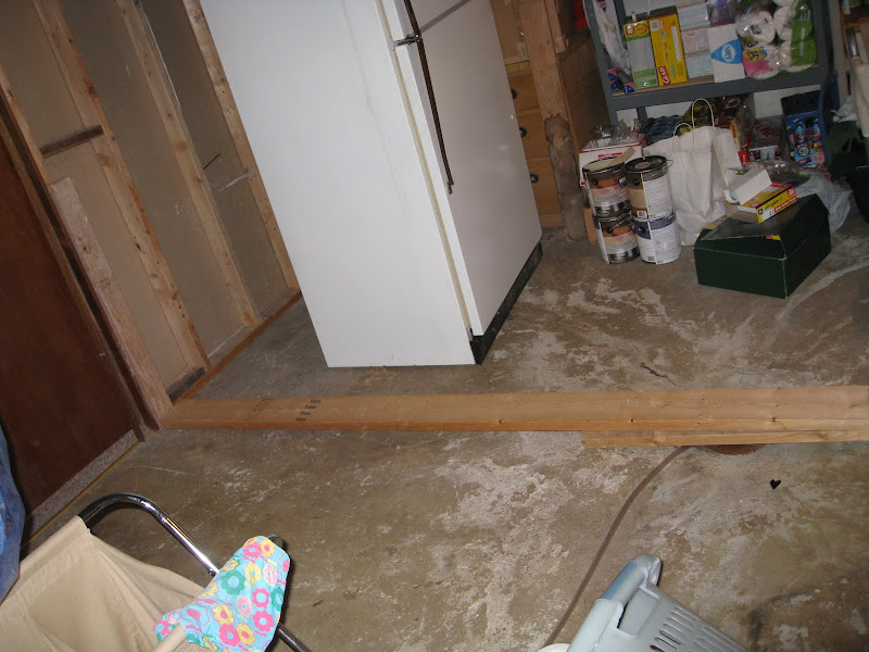

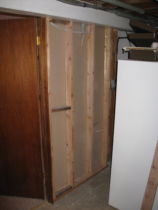

The stud wall was not nailed to the floor at all, so my father-in-law devised a solution to kick out the bottom of the wall from the other side so that it was plumb.
Here's a picture of the wall from the unfinished side. You can see that we aren't talking about a very big wall. And we weren't worried if it was plumb at the other end (in the corner on the finished side of the room), since that was going to cause all sorts of drywall issues. We just needed to plumb up the door opening.
So while I was at work on Monday, he took some 2x6's and made this contraption. First off, he pushed one piece of lumber against the opposite concrete wall and then attached another piece on top to act as a cleat.
Next he set in another 2x6 so that it rested against the cleat and angled up to the problem wall.
Then, he pounded down the top end of that angle and it gradually kicked the wall out to the right spot. Then we put some Tapcons through the sole plate into the floor to secure it. Problem fixed. And the best part is that there was no damage to the drywall on the other side. I thought a crack or two would develop that would need patching, but I guess we lucked out.
We are still working on colors, but we just can't make up our mind. I ran to Depot last night and bought a sample of a brick red that we sort of liked. Definitely an improvement, but still not sure if this is the direction we want to go.
Any opinions?

Nice fix for the crooked wall! Very inventive way to do it.

Amazing how out of true and plumb something can be and you don't realize it until you start remodeling or renovating. Nice fix. As for an opinion on the paint color? Yeah, I got one. I LIKE it! What are the chances that you will pick this color over the other. The red would give the room a little more umph for sure. I say go for it!

I kinda prefer the darker color myself, but wouldn't slow down your progress too much at this point for it. You can always repaint later.
Nice work by the FIL. But looking at that laundry room area reminds me of my basement pre-project ... brrrrrr! You need some insulation on those walls dude!! Us northerners can't be going insulation-naked in the winter!!

I like the red for the walls, and the tan for the ceiling...
If you are checking out my thread, you will see why

All credit has to go to the father-in-law. If it was just me, I either would have left it alone and hung the door crooked, or I would have taken a hammer to the bottom of that wall and tried to kick it over (probably without success).
