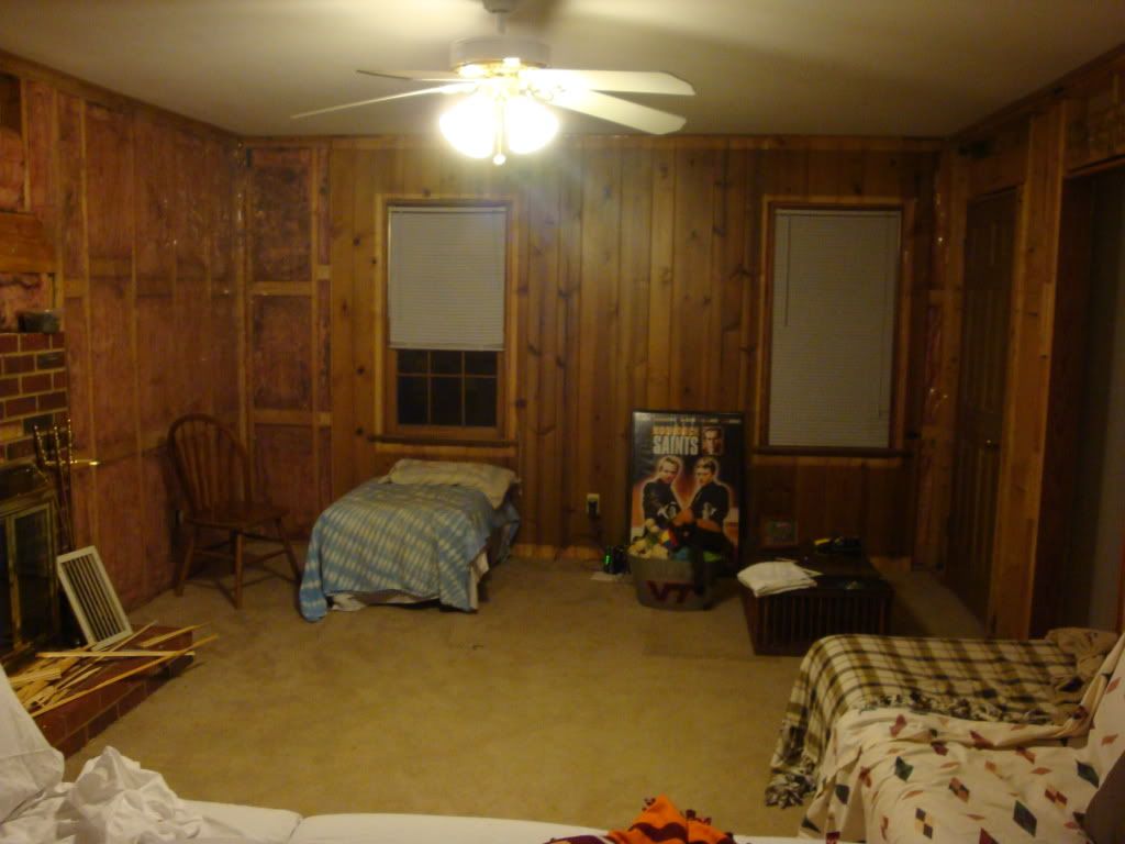

Hey guys,
I am new homeowner, and the home I recently purchased is 70's/80's retro'ish in a few rooms. You'll see that the family room has the knotty pine tongue and groove paneling...not my liking. Thanks to the tax credit, I want to make a few renovations early so I can enjoy them while I live here. First purchase...Sony 55NX810 3D LCD TV, now I need it to fit in haha.
I've already received estimates to put drywall up & reface the brick fireplace with stacked rock. I plan to tear down the paneling and gently take off the trim and then I want to wire everything for my home theater. The TV will end up being mounted on the wall probably level with the bottom of the window...still undecided on ultra-slim vs. fully articulate. I want to futureproof the wiring if possible (but just to a normal man's needs), because I know it will be harder later on to get it done. My future plans most likely include upgrading my receiver in the next couple of years, and once I do that I can enjoy 7.1 lossless audio with 3D as well. I'm trying to keep this low-budget, but really improve the look of the family room and be a kick-a$$ game/movie room.
Equipment:
Sony KDL-55NX810
HK AVR-347 7.1 Receiver
HK HKTS-18 5.1 Speaker Set
2 Average Floorstanding Polk-Audio Speakers
Playstation 3
Nintendo Wii
Room Dimensions:
18 ft. 5 inches x 13 ft. 5 inches
Seating Distance:
9-12 ft. away
Wall Mounts:
or
Wall Plates
Recessed Power: http://www.monoprice.com/products/pr...seq=1&format=2
7.1 Wall Plate: http://www.monoprice.com/products/pr...seq=1&format=2
Outdoor Speakers (2 Backyard, 1 Front Porch) Wall Plate: http://www.monoprice.com/products/pr...seq=1&format=2
Cables/Wires
Speaker Wire: 200 ft. of 16AWG (no runs further than 50 ft)
HDMI Cables: various lengths - 28AWG - High-Speed
In-Wall Speakers (haven't purchased yet):http://www.crutchfield.com/p_107RC65...nwall+speakers
-Questions-
1) With a room of that size, is 7.1 really that important? I already plan to put in-wall speakers for the surrounds, so if I'd wire the extra rears, I'd probably plan to buy another set of in-wall speakers. But if its overkill, I don't want to waste my money.
2) Do you put a wall plate where the speaker wire will exit? or just run the wire through the drywall?
3) Can you think of anything you'd do differently? Any other product you'd recommend? Let me know any opinions, tips, comments, etc. Thanks!
Goal - hopefully in time for Christmas

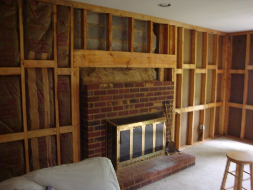

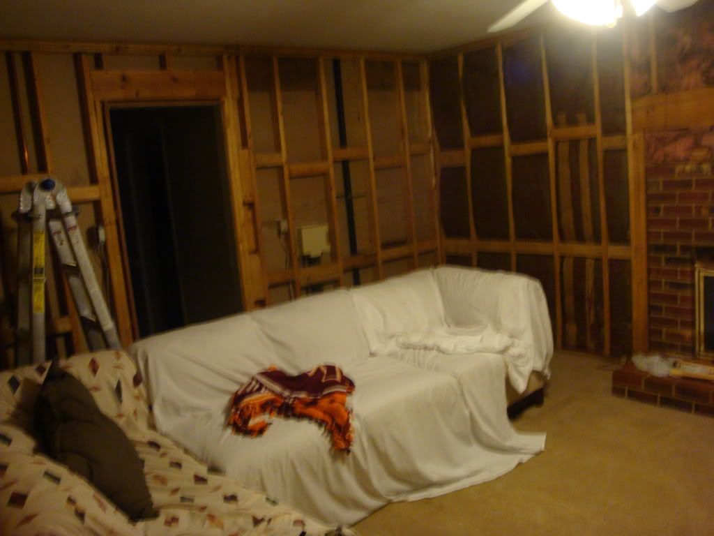

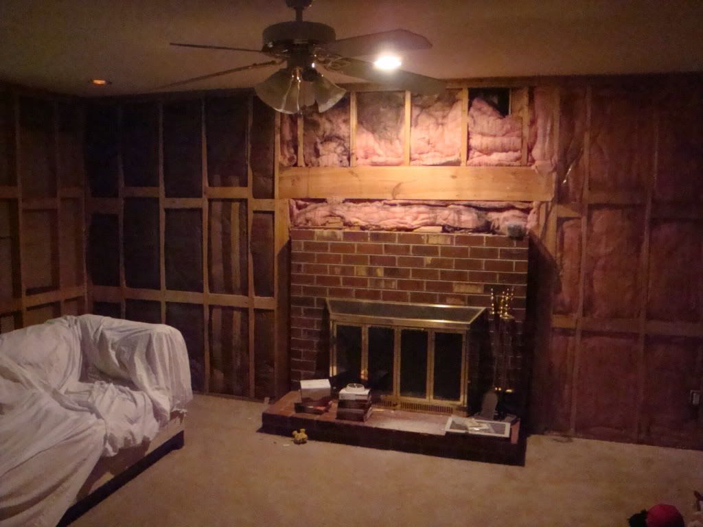

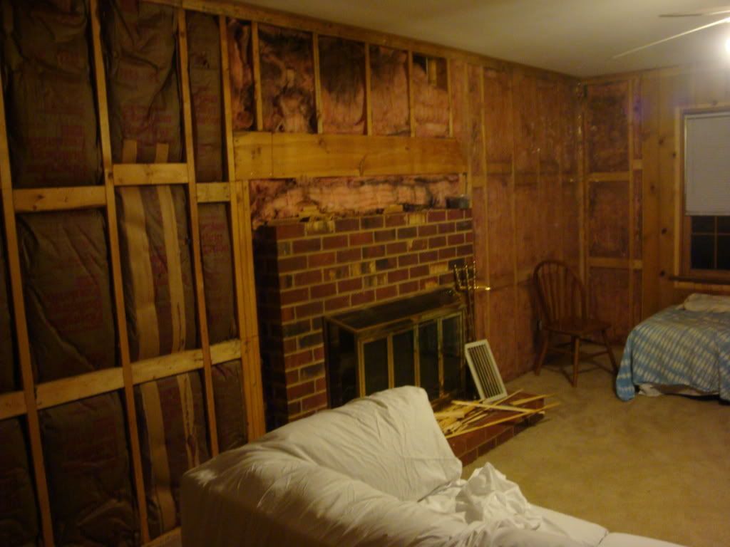

Progress! I have to remove paneling off of only one more wall. Didn't have the patience required to save one board, those guys were really nailed in.

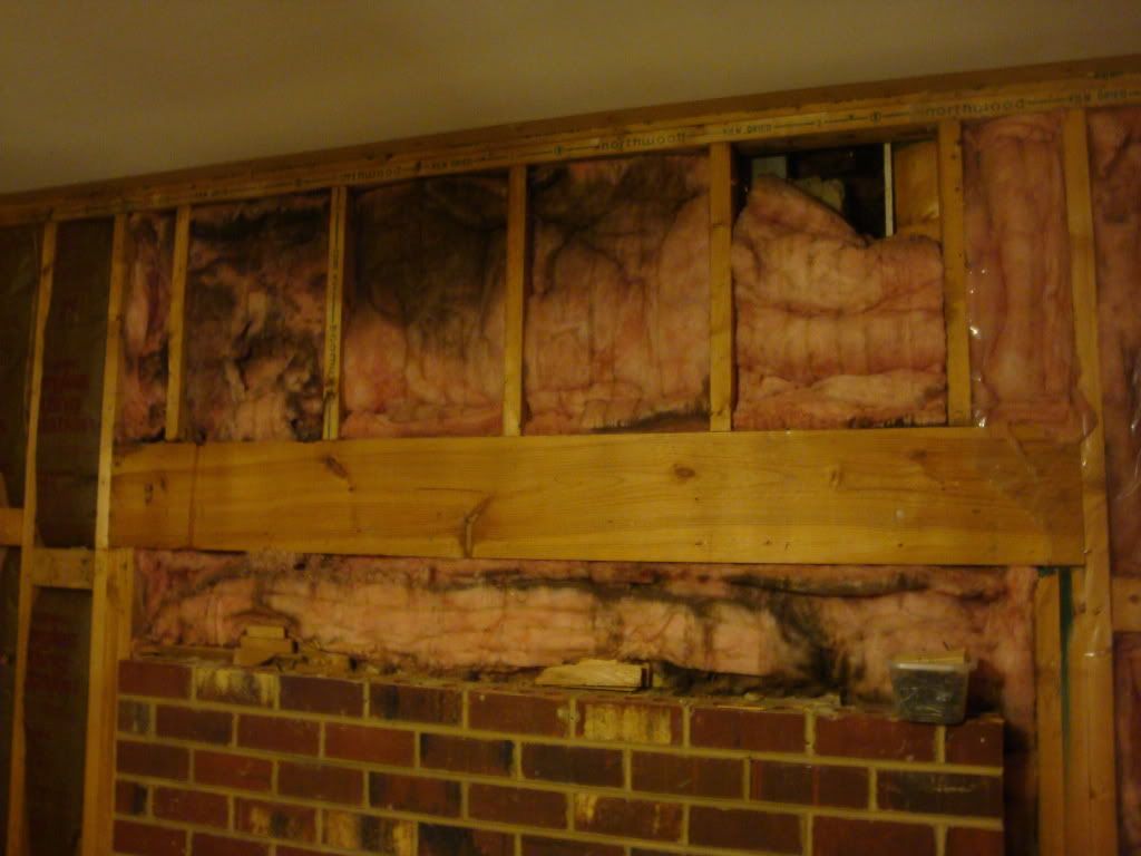

I did find some mold on the insulation above the fireplace and and along the wall with the two windows. I know I should replace the insulation, but I'm thinking it'd be a good idea to find the cause...maybe crawl space???

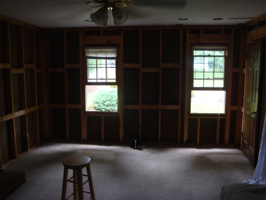

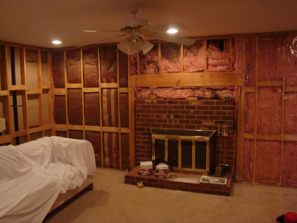

Decided against the projector, good thing because the half roof is on that end of the room and the joists would have run perpendicular with the projector. Project is finally picking up steam - recessed lights done and drywall being done a week from today. To prep for drywall, I need to replace insulation and wire for surround sound and box in where I want my 2 in-wall rear speakers.
A few questions...
  • How do other threads have big pictures posted within their posts? I uploaded the pics to Google's Picasa and linked to that, but the pictures still show up small...

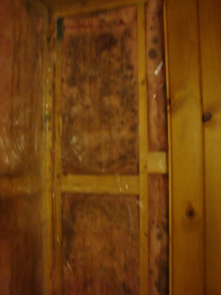

  • The insulation has a little mold on it I believe, black spots throughout. I think its best to replace this 30 year old insulation since I already have the walls down. Is there a certain way I should wire for surround sound in walls with insulation?
DEFINITELY replace the insulation if you have mold (yes, black dots). I would also do a thorough walk-through once you have all the old insulation removed to make sure it didn't creep to other areas as well. Mold is no joke, take care of it now so it doesn't bite you in the a$$ later on down the road.
Not sure if it's too late for input or not, but definitely get rid of every bit of insulation that has - or may have - signs of mold! Trust me on this - it's way cheaper and way easier to get rid of mold now than to do it later once you've invested time and money in new wall coverings! Ugly details in the first part of my build thread if you have a strong stomach, but the crib note version is: don't pussy foot around with mold.
Some other quick random observations/questions:
What is the climate - where do you live? Make sure you take the time to properly insulate while you walls are open. Living in a northern climate, adding insulation was huge for me. I had paneling almost exactly like yours, and I'm so glad to have drywall & insulation now. Feels much more like regular living space than an old crusty basement.
I agree on running wire for possible future 7.1 speakers, and maybe even a PJ. For the cost of some cables now, you'll be ready if you want them in the future. You can run those speaker wires & other cables to a low voltage box in the wall, which will work very much like an electrical box does for electrical terminations.

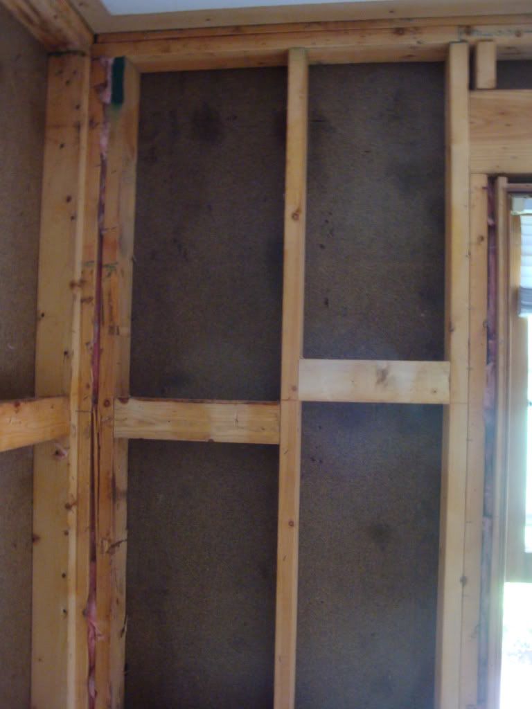

On to the insulation...I hope this isn't a huge problem, maybe its just isolated to this one room? I live in central VA, a variety of weather throughout the year. If you look at the insulation pics, you can see to the left of the fireplace they had the insulation with paper backing, then above no vapor barrier, then to the right, plastic sheet over it - its definitely not consistent work. I wonder if the mold is due to taking shortcuts on the insulation the first time around? I'm not sure if having wood paneling makes insulation more prone to mold either.

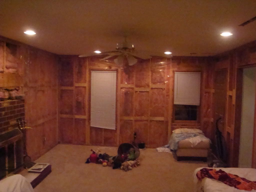

Here's pictures of the recessed lights too, I think they turned out awesome - I'll put on the trim after the ceiling is patched and painted. When the fireplace is done it'll really look nice since that recessed light is on its own dimmer.

UGH! MOLD!!! Aaaagggggghhhhh!!!!
Before you buy the insulation, I would take the time to try and identify what is causing the mold, as you may want to get a different type of insulation. I can elaborate on that much more if you want, but want to quickly communicate this if you're running out to buy insulation tonight.
What is behind that mold infested insulation? Exterior wall? Made of what? Is the wall itself showing moisture leakage and/or mold?
Also be careful handling the moldy insulation! You don't want to disturb it if possible, as the mold spores can easily become airborne and transfer to other spots where it can grow. Ideally keep the insulation contained in the plastic vapor barrier where it exists, or otherwise into plastic bags with minimal disruption. I'd also wear a mask and gloves.
Sounds like overkill. It's not.
You need to first deal with the cause and source of the mold before wasting time and money on new stuff.
Sorry to be a downer, but I've ben there, done that, and have the ribbons to prove it!

Well, first order of business should be to safely remove the mold infested insulation and identify what's causing the mold. You really should take some time to google/start learning about mold, even if there are a gazillion other things you'd prefer to do, because it has the potential to be a big problem for you, including a health problem. Here's what I'd say to get you started, although I'm no mold expert - just a guy who realized he had a serious mold thing going on and a wife who was allergic to it, and sick from it.
Basically mold growth can only be prevented or controlled by controlling moisture indoors. If there is mold growth in your home, you must fix the moisture problem. If you clean up the mold, but don't fix the moisture problem, then, most likely, the mold problem will come back. Mold cannot grow without moisture, so fix the moisture issue and you'll be well on your way to fixing the mold problem.
Often times moisture problems are tied to poor drainage around the house - that was one of my problems as my gutters were emptying too close to the house and the grading around the house was not taking the water away from the house, so it was getting stuck in the ground against the basement walls/foundation. I also had a slow plumbing leak in old pipes behind one bathroom wall. Finally, once the source problem was corrected, we also ended up buying a large, industrial strength dehumidifier, which helps keep the humidity under control in the summer. I don't know what your moisture source is, but you really need to identify and fix that if you want to keep the mold away.
I think I've sufficiently beat the moisture issue like a dead horse.
The second part of the mold equation is a substrate for it to grow on. It can grow on most surfaces, but some substrates have been found to be much more resistant to fostering mold growth than others. One of those is insulation in areas like basements that are prone to moisture. Turns out the typical fiberglass type of insulation exposed to direct moisture is an ideal place for mold to grow. OTOH, non-organic materials resist mold growth much more effectively, which is why polystyrene insulation is often chosen in basements at least for the at-risk walls. This is also known by other names like rigid board insulation or foam board. Whatever you call it, it is the preferred type of insulation to use against walls that are likely to be subject to future moisture. It's a similar cost as fiberglass insulation, and is actually pretty easy to install.
Here is a link to one post in my build thread where there is some more details, including links to many, many websites that contain far more information than I can list here.
I know this isn't the sort of thing anyone wants to hear, but it's the lesser of two evils, as it's easier and cheaper to attack it now than it would be after you finish your renovation. If all else fails, a few stiff drinks helped me a lot when I was at the initial stage of realizing I had a much bigger project than I thought.
Hang in there, my friend. This, too, shall pass - and hopefully it will be before you pass!

Yesterday I checked out the crawlspace and everything looked fine under there. Like I said, I plan to add more vapor barrier on the crawlspace floor, but theres no mold growth under there at all. If the crawlspace was the culprit, I'd assume that the mold growth would start on the insulation at the base of the wall, that wasn't necessarily the case though.
This morning I removed the moldy insulation and sprayed the areas with a bleach/water mixture. Surprisingly, the back side of the insulation was mold free. Likewise, the studs and walls showed no signs of mold either.
I am starting to believe this may have something to do with the wood paneling, since the mold grow was on that side of the insulation. Also, the home is 30 years old, I dont believe this is just something that happened over the last year, I think its taken quite some time to even build up to this.
I think by changing the insulation & spraying with bleach/water, I think I've defeated any mold that was there currently. I'll continue to monitor the crawlspace and keep it as dry as possible. After seeing under the house and behind the insulation, I don't believe the problem was as developed as first assumed.
I'm waiting for the bleach/water to dry and then I'll put up R-13 insulation this evening!

I really hope this strategy works out well for you, since you will be essentially just replacing the mold infested insulation with new insulation without identifying, much less correcting, the cause of the problem - which is moisture, not your wood panelling. Changing the bandaid does nothing to treat the wound. It just covers it for a while. Your call though.
Good luck!

Hanesian, I hope I'm making the right call too...I have tried to find the source/cause of the mold and I can't find a plausible cause.
If if was the crawlspace...wouldn't the insulation in the crawlspace be molded? Even though the crawlspace isn't molded - this is where I will take more preventative measures by adding extra vapor barrier.
If it was because of water damage, I would think that I'd see water damage on the studs.
The insulation that was molded wasn't kraft faced, instead it just had a plastic vapor barrier over top - I've been told paper kraft-faced is a better choice.
I'm trying to make the right health/economical decision. I just bought this home last year, and it is 30 years old - understanding that an older home isn't going to be perfect. Perhaps there was a reason for the mold in the past (maybe there wasn't ANY vapor barrier in the crawlspace until recently...), and its been corrected before I bought the home. Since theirs no signs of mold anywhere else, if I hadn't taken down the paneling, who knows how long it would have been before the mold had been noticed. I think I'm doing a little more than just replacing a band-aid, perhaps putting neosporin to aid the healing wound too?

I noticed there was a lot of mold around the fireplace area. Is there a source for moisture there. Cracked masonry, weather stripping, caulking, anything missing that would allow moisture in?
Obviously you are right there looking at things, Hanes and I only have you and your pictures to go by. I can only say that bandaids, neosporin, are fantastic for what you use them for, but if you can't find and cure/fix the moisture mold will reappear eventually.
You have to do what you think is right and proper, we can only offer our suggestions and support. If you say that you have checked things out and you can't find any moisture problems, then we have to take you for your word that there are no longer any moisture issues.

I didn't mean to sound too negative. I know it's frustrating. Everything is a matter of tradeoffs, so if you choose to push ahead I understand. I've just become very gun shy about mold, although if my wife hadn't been allergic I probably would still be living in a house with lots of mold. I had to act - you probably don't.
At a minimum, I would make sure you have a good dehumidifier in there, and keep it running as long as it seems to be pulling moisture out of the air. Vapor barriers are one part of the defense, but they are not designed to hold back serious moisture; they are more for dealing with the moisture that forms from condensation when warm, moist air comes into contact with cold air.
Anyway, a couple last questions: what, exactly, is on the other side of those walls that had the moldy insulation? It looks like it's the ground floor and above grade, right? Is that an exterior wall or an interior wall? Is there a roof valley or some sort of un-level roof area right above that room or wall? What is on the other side of that wall? Where exactly is this crawl space in relation to this room?
Also, with all that mold at the top of the insulation near the fireplace, have you checked the fireplace flashing on the roof to see if there is any chance of leaking from the roof down the chimney brick to the interior? That might possibly explain the mold near the ceiling above the fireplace. How old is the roof, and what shape is it in?
Finally, do you smell any musky/mildew smell anywhere in the house or crawl space?

The walls with the 2 windows on it is my front exterior wall, first floor above ground. Directly above window's is a half roof. Here's a quick diagram.
\\ < top roof
\\ < half roof
| < first floor, family room
Directly behind the fireplace wall is the garage (not-heated). Directly underneath the floor of the family room is the left corner of the crawlspace.
The fireplace very well could be a reason for the moisture. When we painted the house last fall, we re-caulked around the fireplace flashing because that was started to crack. I am also going to be buying a chimney cap to keep the flue cleaner as well. Overall though, the chimney looks in good shape.
The roof is a 30 year old roof, only about 15 years into its life, so the roof shouldn't be an issue. And I haven't seen any evidence to lead me to believe otherwise.
The crawlspace/house doesn't have any smell of mildew or musk either.
I think I'm doing what I can to get rid of it, and I'll continue to make home improvements to keep the home dry and in good condition.
