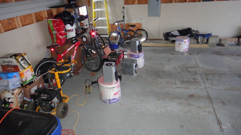

post #274 of 290 Old 07-30-2015, 01:21 PM - Thread Starter
barlav's Avatar
Posts: 236
I used a laptop and old stereo system. The speakers actually sounded decent and being in the garage amplified it nicely.
This is the setup. Nice and simple and easy to setup/take down.

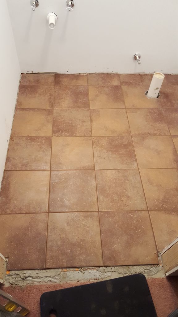

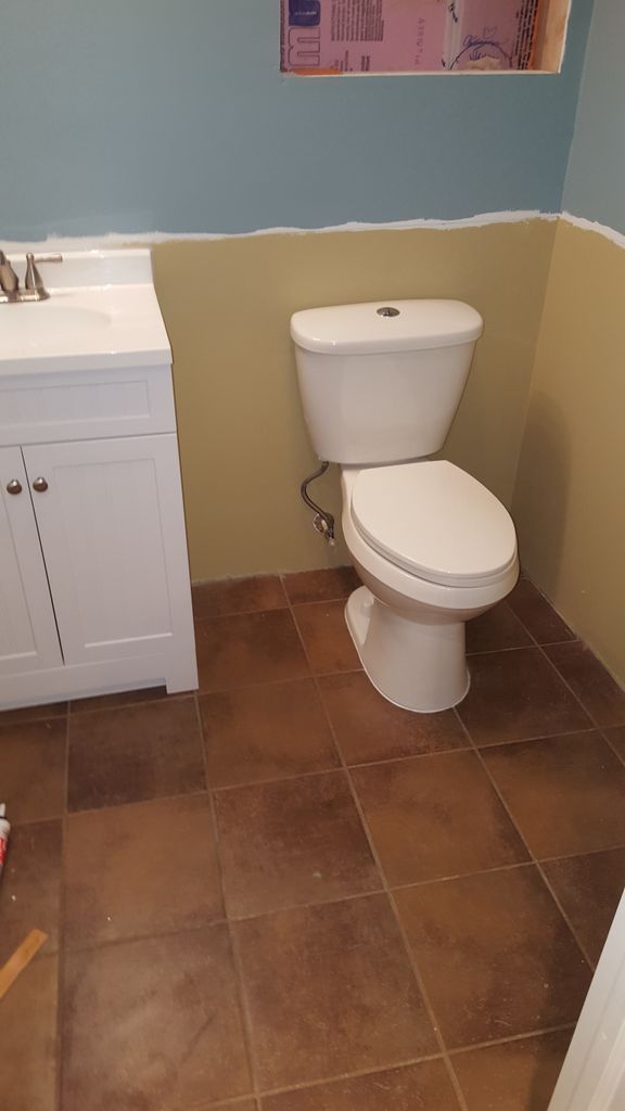

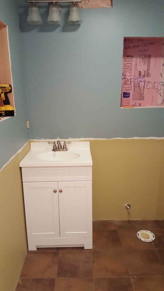

I've been chipping away at the bathroom and trying to get it behind me. It's not very exciting I know but it is nice to almost have a completely new and finished bathroom in the basement. Other then painting and trim work and adding some built ins it is fully functional.
Floor Tiled: These tiles were on clearance for $5/box. It cost less than $20 for the tile. The grout was more expensive This did wonders for WAF

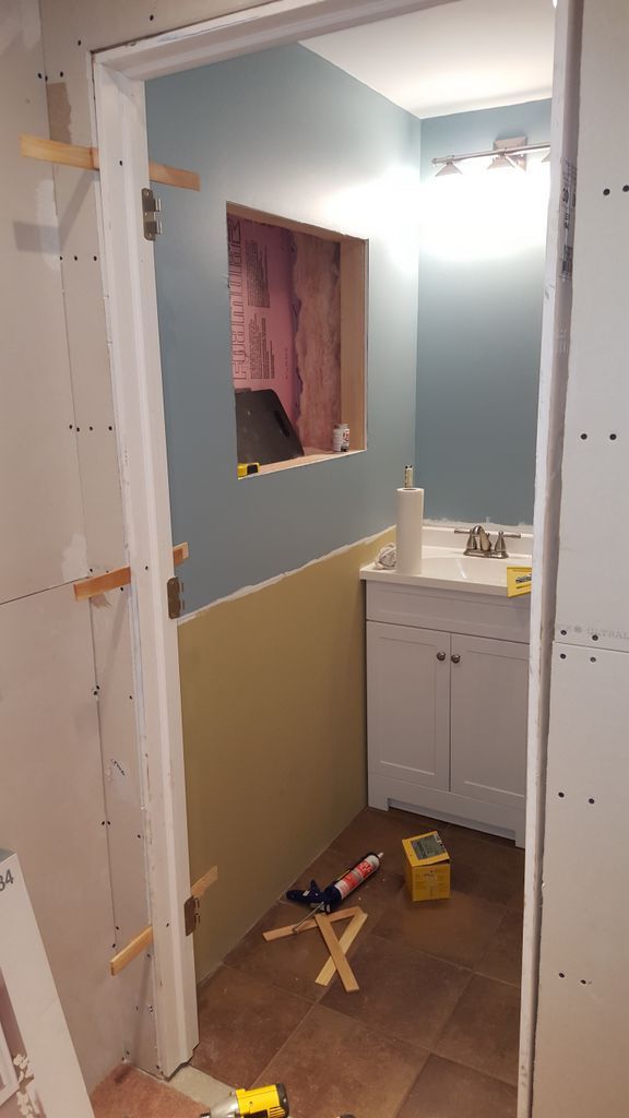

Vanity/Sink/Faucet and toilet flange installed as well as a paint job. Oh and also a new light above vanity. The flange had me nervous being on tile and concrete. I had never drilled through porcelain before and was nervous about cracking tile. I bought a 3/8" diamond tile bit and it worked well. I used slow speed on drill and a spray bottle with water to keep things cool. It took a few minutes for each hole but they came out perfect. Then I used hammer drill into concrete under tile to pre-drill for tapcons and then screwed in 4 2 3/4" tapcons. That flange is going no where!

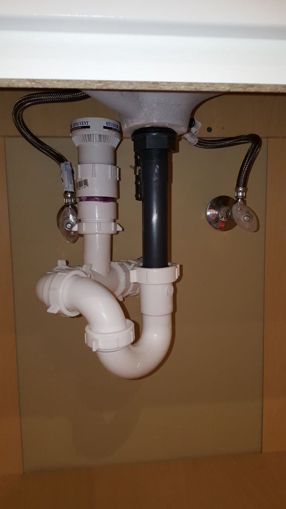

Trap/Vent. I have to admit, this one had me perplexed. First off, I talked to the builder of my house to ask about the 1/2 bath rough in. I asked about the vent and they said it is not directly vented and that I had to "wet vent" with an AAV (Air admittance valve or Studor Vent). No biggie, I noticed my kitchen had one of these as well. So I grabbed a studor vent. After I installed the vanity and saw how close the sink drain was to stub out I was like "HTF am I going to fit in a studor valve in this space???" I stared at this for a long time and had no clue. I went to the store and started buying every elbow angle and part I thought might work. I really didn't want to use one of those flexible traps if I could get away with it. So after messing around with all the parts this is what I came up with. I turned the stub out with a 45 degree elbow and then used one additional 90 degree elbow so I could make a turn that left enough space for the studor vent. I then used a Plastic Center Outlet Tee and punched out the baffle in the middle so I was able to easily connect to the other plastic pieces while keeping length to an absolute minimum. And then studor vent was attached to the tee opening. After all was said and done it works great. No leaks and an issue free drain.

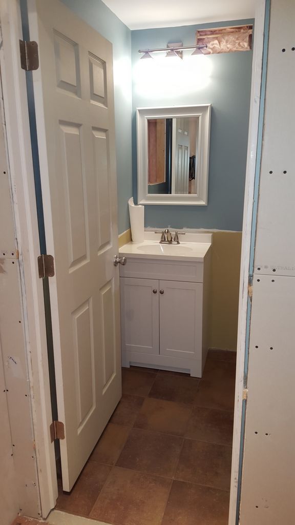

More shopping this past weekend. Toilet, door, base molding, chair rail, crown molding and lumber for the built in shelves. Everything that will be needed to complete the bathroom.
Installing pre-hung door. Pretty quick and painless
Door install finished, lockset added and mirror hung

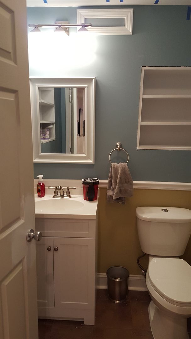

Toilet installed and functioning. This is one of those "2 flush" toilets where each flush uses different amount of water per flush. There is actually a I and II on the top of the tank for flushing
Up next will be door casing molding, base molding, chair rail and crown and then will finish it out with built in shelves.

It's a bit late now, but that vanity fixture looks too high. I have some that are also higher than I'd like. But not enough to go hacking up drywall!
I've got one of those vents under a laundry room sink. Which I noticed because the plumber had FORGOTTEN TO INSTALL IT. Wasn't a natural gas leak causing the smell, it was the stubbed open end where the valve was supposed to go! Note, not all jurisdictions allow for using that kind of vent (why, I don't know).
Still, nice job!

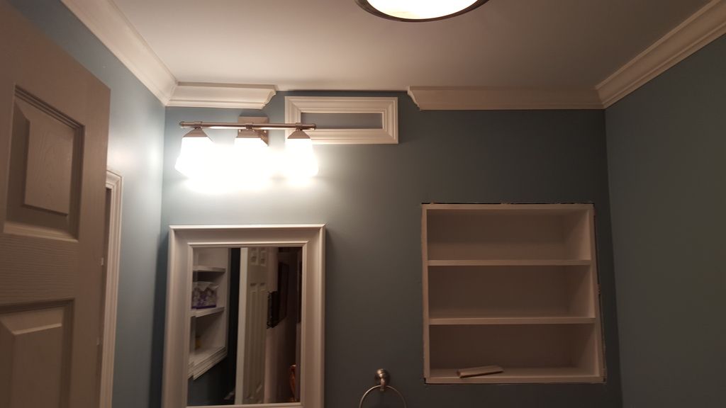

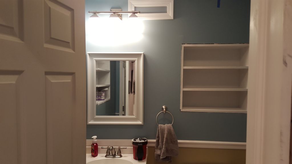

I know it's been a while and, while it's nothing too exciting to report, there is some progress. I've been settling in with all the drywall mudding and taping and it's going to take me a long time! Every now and then I will take a break and do more trim work in the bathroom. At least I am close to having one thing totally complete! Since my last post I have installed the base molding, chair rail and have built the shelves that will recess into the wall. I am in the process of adding crown molding now and the trim molding around the shelves. Just about complete with the bathroom. Not sure if I need to post drywall pictures since it's about as mundane as it gets. Can't wait to have it behind me someday. For now here is the bathroom progress:
In the process of making one of the built in shelves
One of the shelf locations
One of the shelves installed and the chair rail. Also, I made an access panel out of case molding and drywall to cover the water shutoff access. I have it held in place with velcro currently. It seems to be working well but I may end up using magnets in the long run. The tape is marking stud locations for crown molding nailing in the near future
The other shelf installed
Like I said, nothing too exciting. But I am still chipping away.

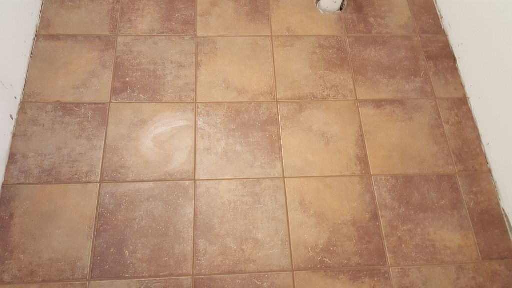

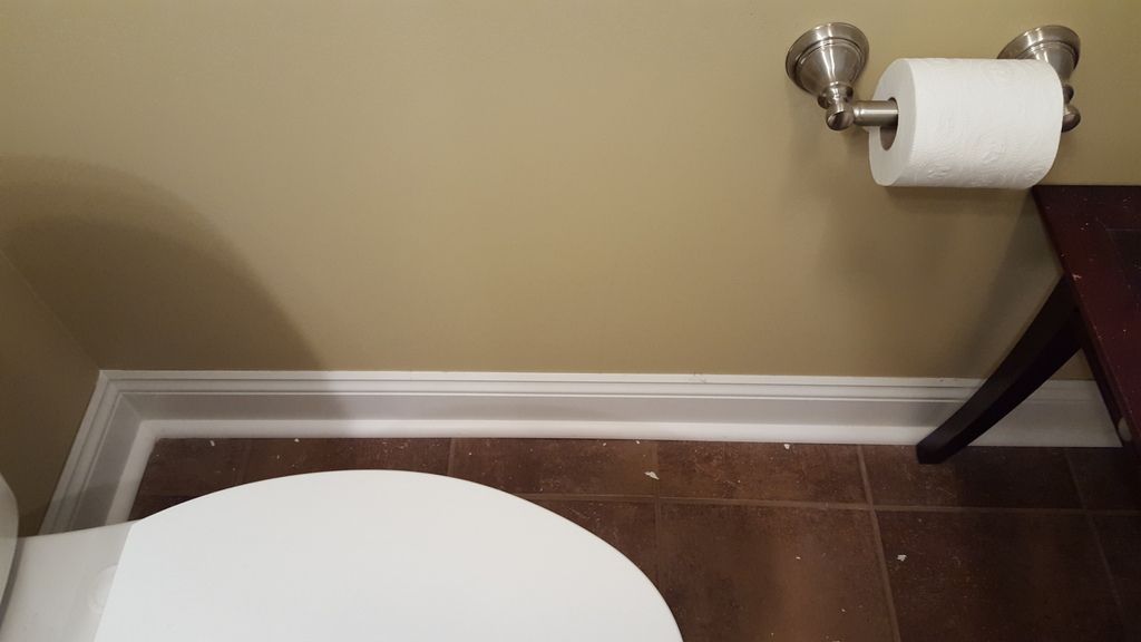

For some reason I thought I had posted the latest pics from the completed bathroom but guess not so here they are. Not much different from previous pics but done nonetheless
Base trim with quarter round, water shutoff trim, chair rail/crown molding, shelving trim and painting:
