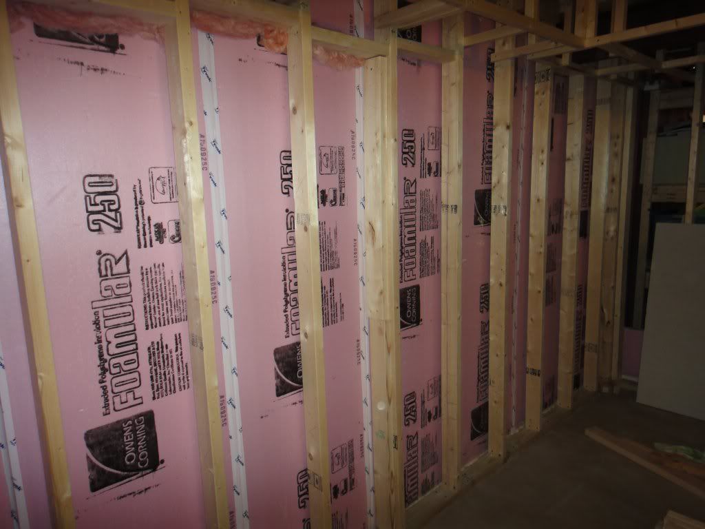

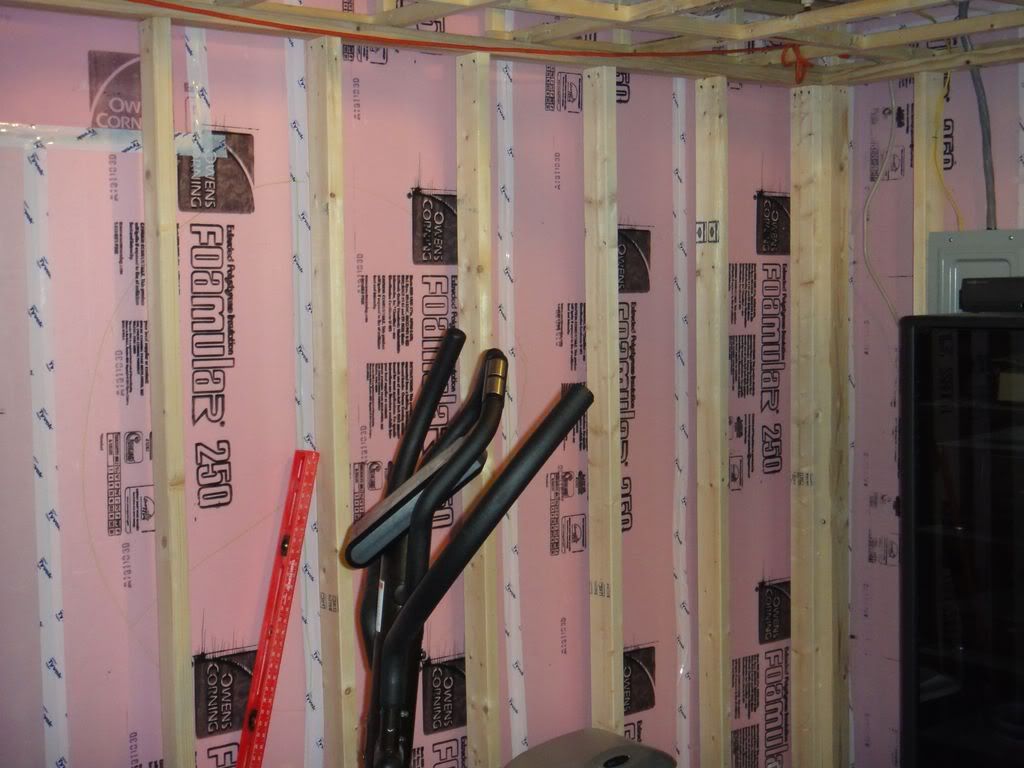

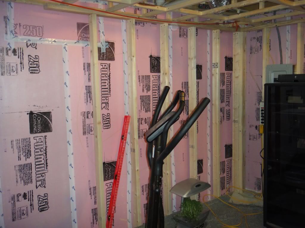

I started fire blocking one of the walls and here are the pictures as promised. Also, why is it that no matter how hard I try to prepare myself to work with insulation I always end up itching afterwards....scratch scratch.
I jammed in some insulation so it's nice and tight between the wood fire blocks and the foam board. The insulation around the sump plumbing is on both sides.
Here is the part of the wall I added another vertical board to limit the amount of space behind the wall that a fire could travel. There is a small gap between the piece of wood and the foam board that I will be filling with more insulation or more likely some great stuff fire block foam.
Close up of the vertical board in place.
The only thing not done is filling of the remaining gaps which I will do all at once when all the fireblocking is complete. I will use this stuff. I didn't want to do just this small area since once you start using this stuff you have to use the whole can since it won't work if you come back to it later. It gets all clogged up.

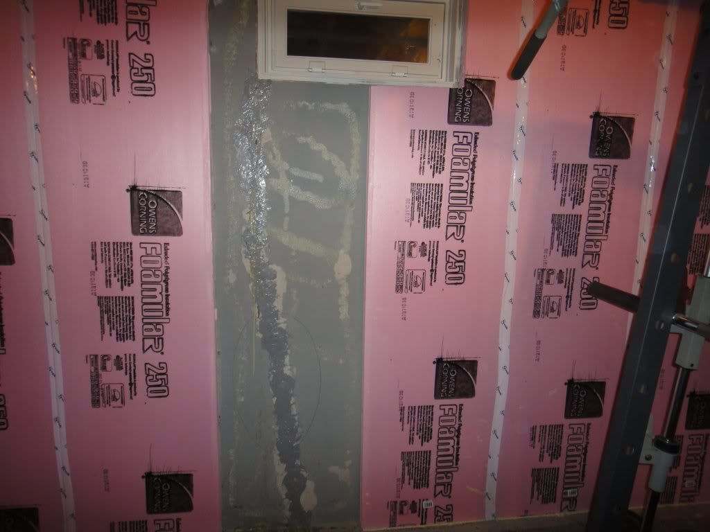

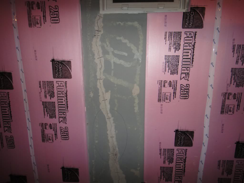

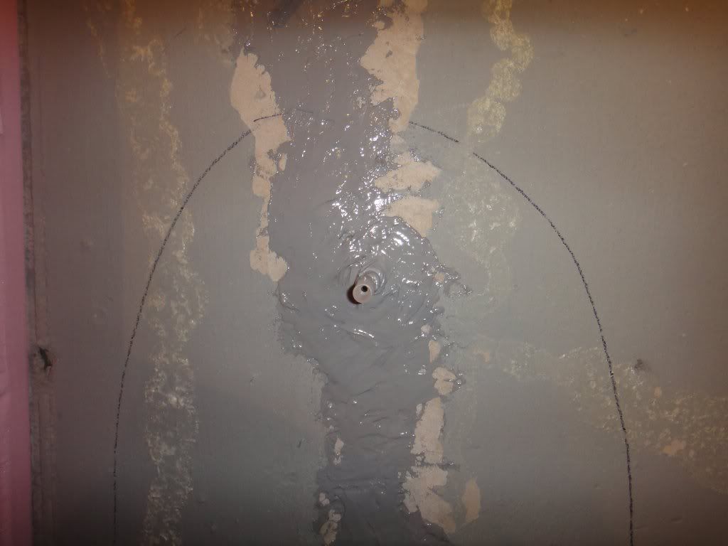

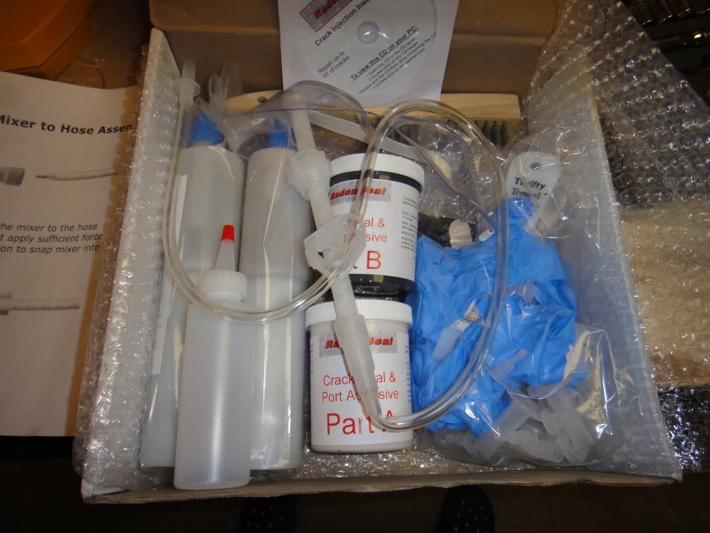

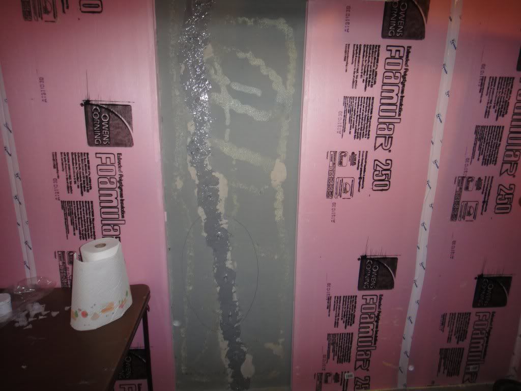

I just realized I hadn't posted any pictures of the fun crack in the wall I had to repair. I guess I must have been blocking it out....actually the pictures were just in an unrelated folder and I over looked it.
Here is the crack I had the water issue with. I was hoping that some hydraulic cement and a layer of drylock would do the trick but no such luck. During a weekend of heavy rain in came the water once again. This of course was after I already had the insulation up so I had to remove the piece that was over the crack and then scrape off all the drylock and chisel out the crack so I could have some surface area to work with for the polyurethane injection. The marks on the wall are where I put the injection ports. The circle is where the water leaked the most. Thankfully it was very easy to recreate the water leak so I would be able to tell for sure if the injection in fact corrected the issue.
Here is the kit that I used to seal the crack. It was actually very easy to use and only took a few hours to do including cure time.
Here is the wall after the injection ports and the epoxy were in place
A close up of one of the ports
This is after the polyurethane was injected and the ports removed. PROBLEM SOLVED!!......hopefully
The following day the moment of truth came. To recreate the leak previously all I had to do was stick a hose in the window well and turn it on for a few seconds. Within a couple of minutes water would be entering the basement through this crack. For this test I put the hose in the window well and turned it on full blast for several minutes. Not a drop of water entered! Yay! Since the fix we've had some major rain storms and still nothing! Dry as a bone....this stuff really works!!
barlav is offline

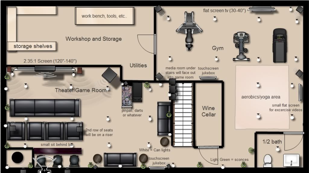

Here is the original floor plan and the updated floor plan below it
Original Floor Plan - Once I got framing I realized the "media closet" was really cutting into the gym space so I decided to take it out of the plans and use the under the stairs space for the media equipment.
The New Floor Plan The media closet has been removed. The media closet was going to cover up the sub panel that's on that wall as well as the cable connections that come into the house at that point. Now I will put the sub panel in the joist cavity of the wall and keep it flush with the outside of the drywall. I will most likely hang a framed poster or picture over it to hide it when all is said and done (yeah I know that's against code but consider it a minor infraction) . I am also going to add an access panel flush with the wall over in that area too for the cable connections. It will be a small control center that will just manage the various cable feeds I have coming into the the house.
The space under the stairs is a lot smaller than what I was planning for the media closet but I think it will be large enough to fit what I need to put in there. There will be the AVR, hd cable box, DVR, blu ray player, roku box, network switch, router, conduit termination for all the wires and cables, game system(s) and a couple of pcs and smaller stereo receivers for the touch screen jukeboxes. I also won't be able to use my rack so I will do something custom to make this work. I will also need to keep this space cool so I will add some kind of intake/exhaust fans to keep it well ventilated.
I'm still not sure what I am going to put in the game room as far as activities and furniture go so I keep changing the floor plan. At a minimum I would like some seating, a pinball machine and an electronic dart board like you see at bars. I will probably also get some kind of collapsible poker table that I can put up and take down as needed.
It is crazy how many things are going through my head as the build progresses. Now I'm worried about the corner where the wine cellar meets the bathroom and that it will eliminate any possibility of big furniture in that space. I wasn't planning on having any big couches in that space now but who knows about the future. I don't think there is any way a couch or anything that big and awkward would fit around that corner. I am going to do whatever I can when framing the wine cellar to give myself as much space as possible turning that corner and play around with the big couch I have down there now to see what I am going to end up with.

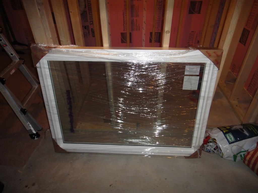

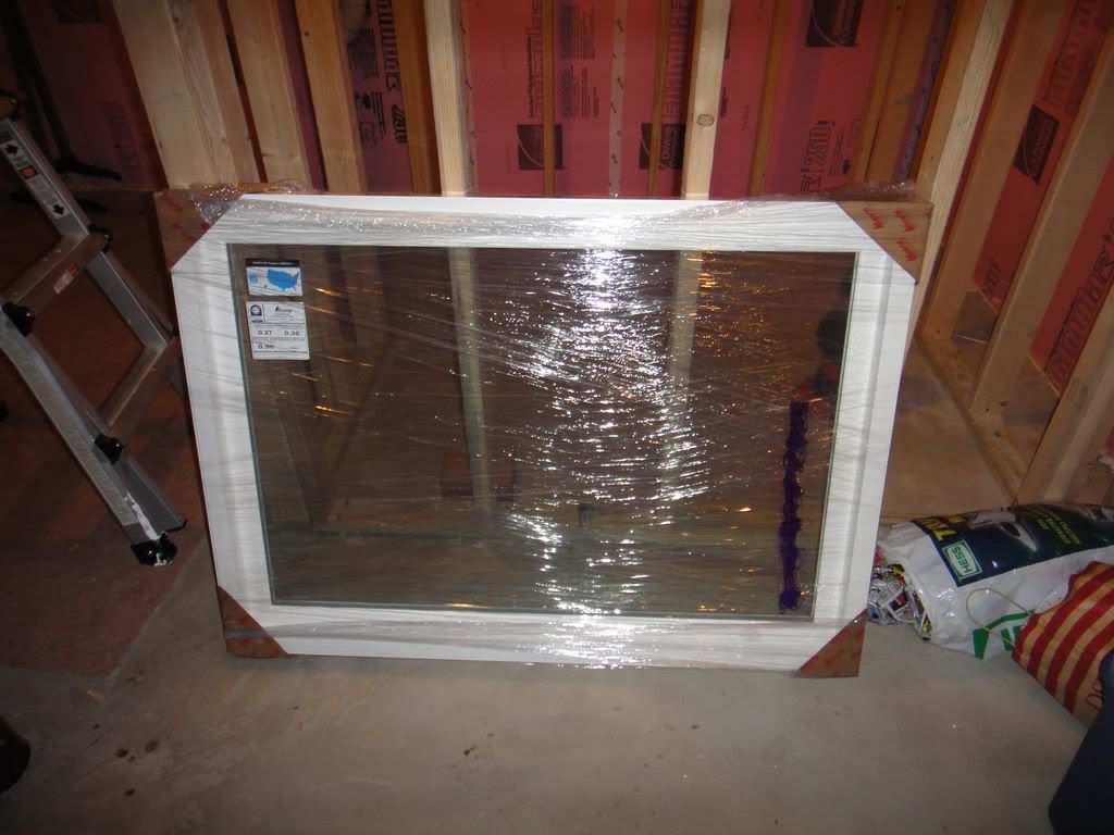

I picked up the wine cellar window today. It is a 48" X 34" insulated double paned tempered glass window.
Here is the side of the window that will face out:
Here is the side of the window that will be on the inside of the wine cellar:
The window's energy performance ratings:
The window will go in this wall as marked:
And this is the other side of that wall. As you enter the basement you will be able to look to your left through the window into the wine cellar:

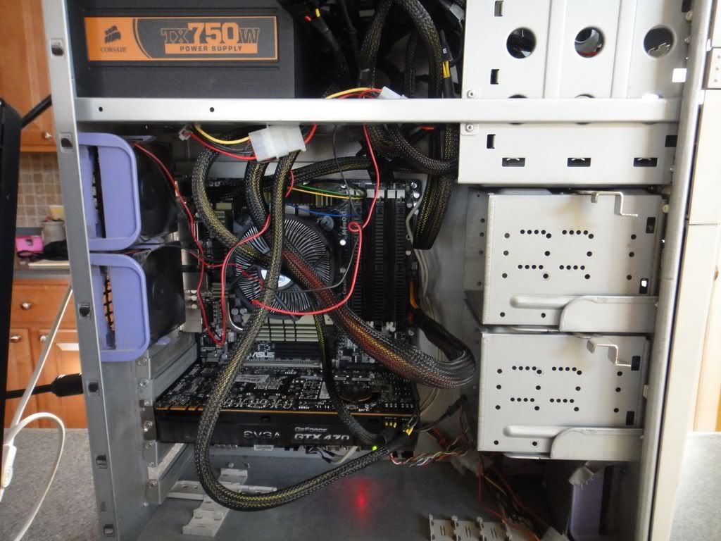

A different kind of build update today.
I had aspirations of completing most of the framing this past weekend but of course something came up. On Friday night my main computer crashed. As some of you computer people may be able to attest to, when the pc goes down it becomes priority number 1!!

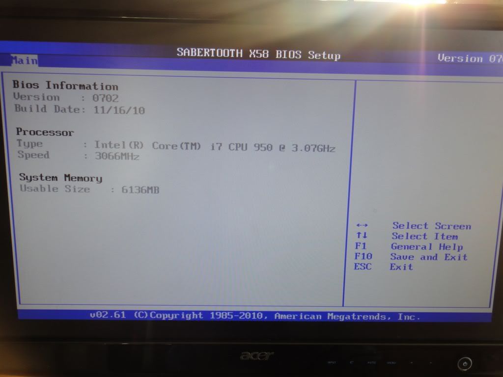

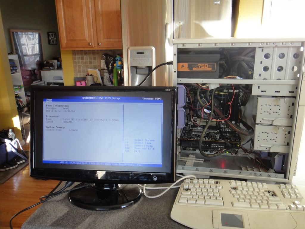

So, I stayed up too late Friday night diagnosing the problem. It turned out to be the hard drive. So my Sat. started later than I expected since I was too tired to start working on the basement at my regular time. And, the first thing I needed to do is order a new hard drive so I had to shop around for that. So I ordered the hard drive (ssd this time), poured a cup of coffee and then went off to the basement.
I was distracted though, I was tired and I was wondering if I really wanted to just upgrade the hard drive?? The pc is 6 years or so old (which is a damn dinosaur for me). So after an hour or so in the basement I had an "A HA moment"....I could use the current pc hardware I had as one of my touch screen jukeboxes in the basement. I had an old ATX case that I could transplant it to and everything.
So I decided the heck with the basement framing, time to go shopping again. So I shopped for a new motherboard, cpu, ram, video card and power supply. Here is what I ended up with. Enough of the parts came today so I was able to get the thing together and test the main hardware.
The new hard drive hasn't arrived yet. And I also needed to buy a new blu-ray burner. The existing dvd burners I had were all ide IDE and there is no such thing on this motherboard. Everything is SATA now. I told you my computer was old! I definitely needed to upgrade right? I've been wanting a blu-ray burner for a while now anyway. So Hopefully the rest of the parts will arrive by the weekend and I will get the thing backup and running.

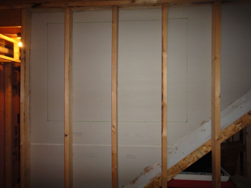

This weekend the media closet under the stairs was framed out as well as the rough opening for the wine cellar window in the stairwell wall. I even got to dry fit the window which was exciting. I didn't know exactly how or what to do with the framing under the stairs so I spent quite a bit of time just sitting there staring at it. The center stringer extended down further than the side strings. I have to drywall the inside of it for fire codes so I needed to figure out the easiest way to even them up.
Thankfully a 2X4 attached under the side stringers did the trick. It's not perfectly even with the center stringer but it's even enough where the drywall will attach well enough. This was nice and simple.

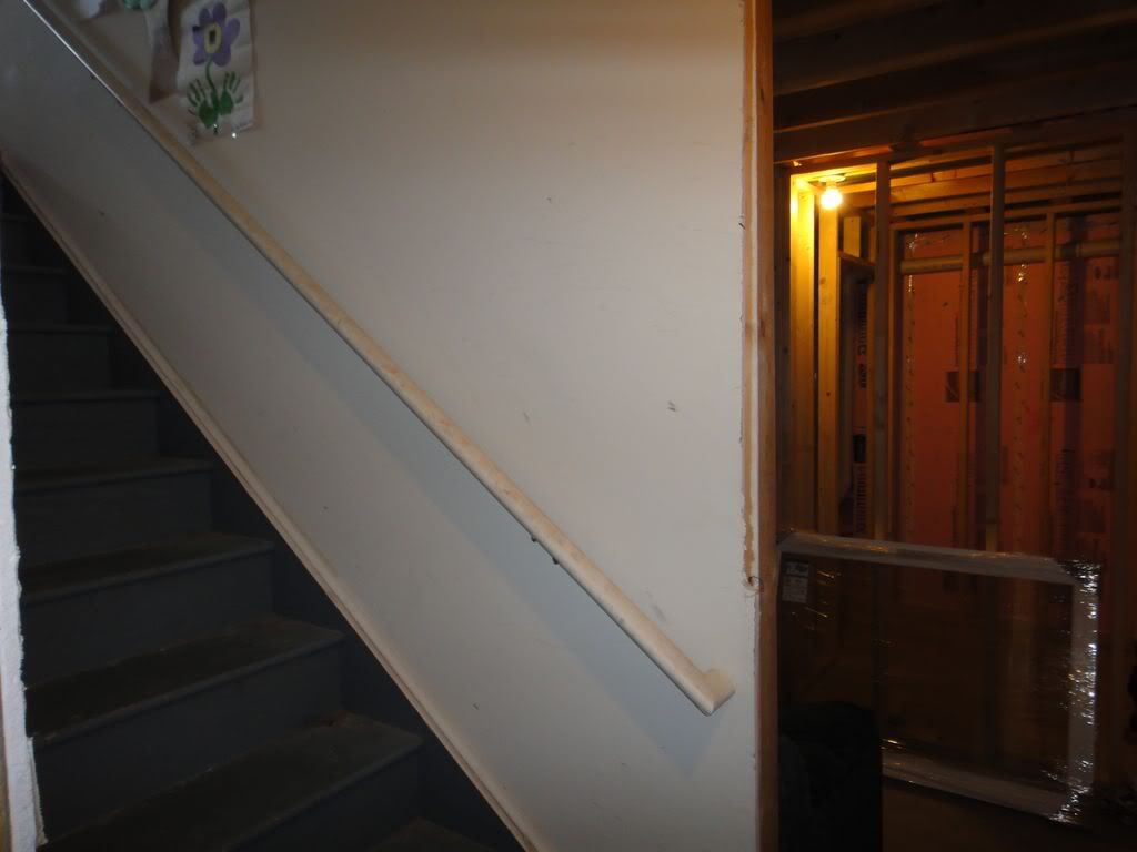

Wine Cellar Side:
Theater/Game Room Side:
Here is the before:
Here is now:
And I had to get the window out and give it a dry run:
Next up is to frame an identical wall right next to the window rough in wall to give me enough depth for the extra insulation I need for the wine cellar. I could've removed the entire existing wall and replaced with a 2X6 wall but decided it was just easier to frame a 2nd 2X4 wall. It was really quick the first time so it will be even quicker the second time. Then I will frame the rest of the wine cellar with 2X6 walls.

Finished framing the wine cellar which takes me to the end of the framing stage....finally!
Looking into wine cellar through window opening
Looking into wine cellar from the back
Next up will be to wrap a few more odds and ends with the framing and then move some electrical so I can take out the section in the other side of the basement stairwell wall. Then I will be onto the rough in stage for electrical, plumbing, networking, media which will be a nice change of pace.
Thanks for following along.

Had a busy weekend last weekend and didn't have anytime to work on the basement. This week I was able to get back down there and make some progress.
The first thing I needed to do is finalize what unit I was going to use for the wine cellar cooling/humidity control. My choice was:
Then it was on to relocating some existing electrical before opening up the stairwell wall. I needed to move a light switch and an outlet on the stairwell wall and also moved the doorbell transformer and junction box out of the way and into an unfinished part of the basement. I also needed to add a new junction box to take the 14-3 I needed to extend from upstairs to the new light switch location. I also placed this in the unfinished part of the basement:
The switch and outlet that are being moved (Doorbell transformer is hanging down there too)
I moved the outlet into my workshop instead of getting rid of it altogether. I am sure I will find a use for it.
A view of the old switch location and the new switch location:
A view of the moved doorbell transformer and new junction box into the unfinished area where the workshop is.
This little removed section makes a big difference! It makes the basement feel like less of a basement, it will provide a direct view into the wine cellar from the other side and it will also allow me to get some big furniture down there too.
Still need to frame from the stair stringer to the floor underneath the removed wall section. And need one last soffit section to complete the tray ceiling and then I will be truly done with framing until it comes time to build the stage, screen wall and riser.
Also, I have been measuring things in the theater and deciding on what I am going to go with as far as screen size. I have decided on a 130" diagonal 2.35:1 screen. As a result of this the sit behind bar in the back I have in the original floor plan has to be scratched to create a reasonable seating distance to the screen for two rows of seating. The riser is going to go all the way to the back wall and fit 3-4 seats. It will come off the wall 6 feet and then there will be more seats or an L-couch in front of the riser. The front row may still even be a bit close to the screen (9-10 feet) but that is far enough away to be acceptable for me.
