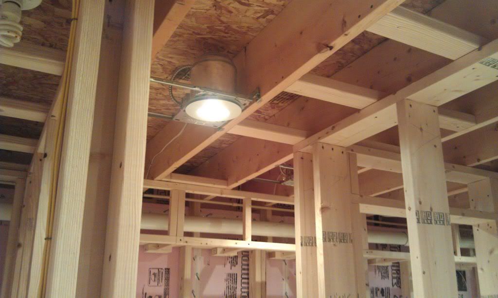

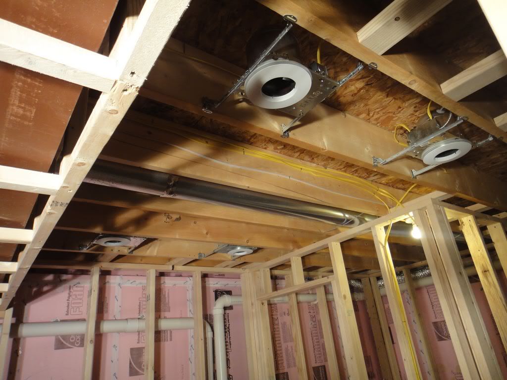

I finished installing and wiring all the lights in the gym this weekend. I still haven't connected to sub panel but that will be done sometime this week. As you will see I did NOT find it easy wiring 3 dimmers in a 3 gang box with 12-2 wire!! Live and learn I guess.
The last 4 cans installed for the aerobics area
All the wires pulled (3 zones and power feed)

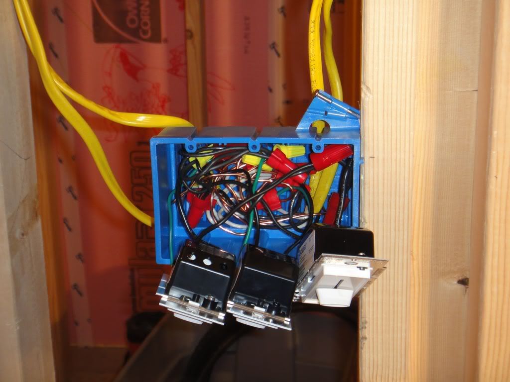

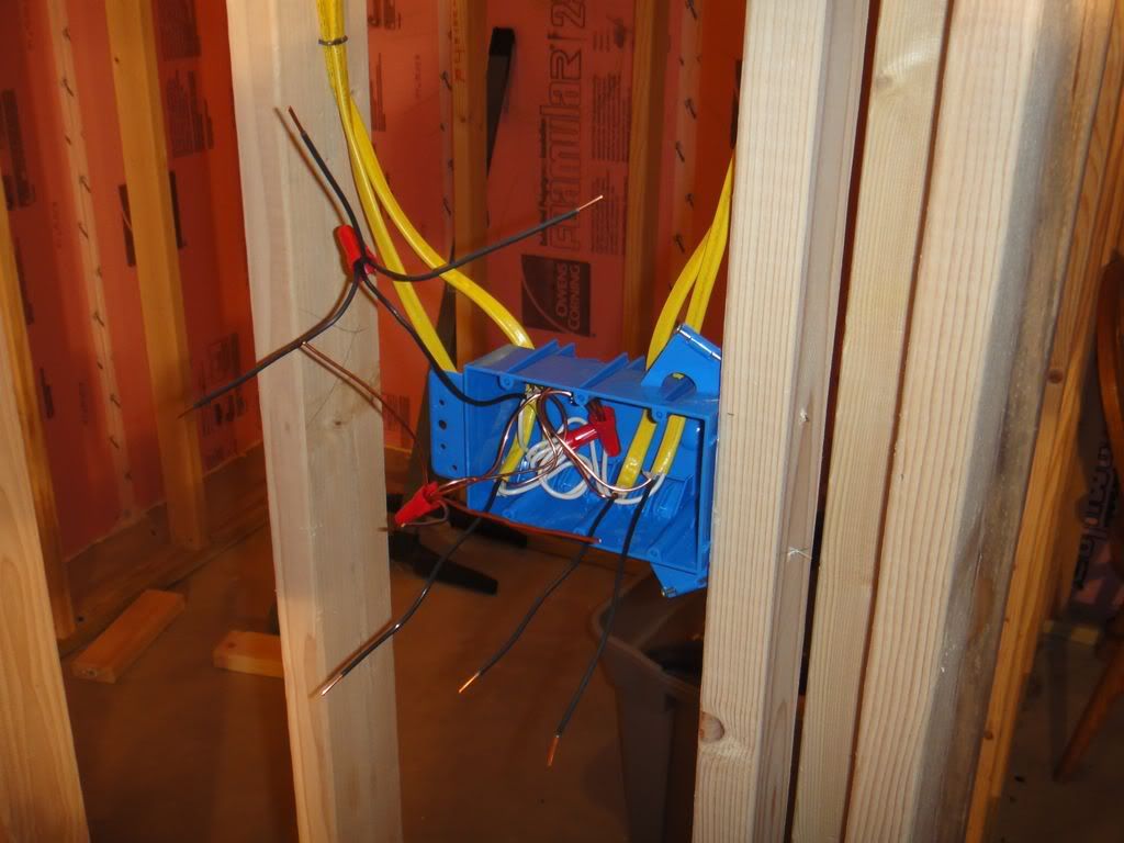

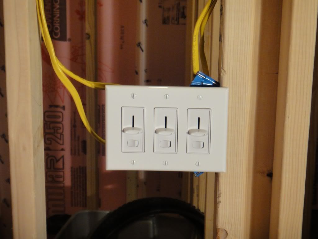

The plan was that this box was going to have 3 dimmers on the same circuit controlling 3 zones of light using 12-2 wire. It was at this point I starting thinking "htf am I going to be able to make this work???" The dimmers are bulky and I was already running out of room before even installing the first one. Nonetheless I plowed forward and wired everything up and, of course as I expected, there was no way in hell the dimmers were going to fit in that small box. I tried and tried but there was just no way.
So, I undid everything and ripped out the box. I made a trip to the store and picked up a deeper 3 gang box. I needed some wire clamps for the sub panel anyway and some new workshop light halogens so it wasn't a wasted trip. First time in a while getting out of the store under $20!!
Getting all the wires in the deep box was still challenging but thankfully there was enough space to work with. Here is the resulting ratt's nest
It looks much better with everything installed
Another thing I learned that I didn't plan for is that the capacity of the dimmers is diminished if you remove the tabs on one or both sides. I originally had planned for them to be in a specific order but that idea went out the window because the one I wanted in the middle (with tabs removed on both sides) wasn't going to support enough wattage for the lights on that zone. The 1000W dimmer is diminished to only 650W when both sides are removed and to 800W when one side is removed. I don't have any zone that will run 800W or more so I was able to make due with the 3 gang box. The aerobics room will only use about 300W so I put that dimmer in the middle and kept the weight room and cardio equipment room dimmers on the outside. This wasn't a big deal but if I had to do it over I would've scrapped the 3 gang box and put each on in it's own box.

I'm not an electrician, but my brother-in-law has been helping me out with some wiring projects. When he does the wiring in a box like that, he's shown me a few tricks/guidelines. First thing is that you have a LOT of the outer sheath in there. That should be taken back pretty close to the clamp (inside the box). He strips with a utility knife to slit down the middle, then cuts off the jacket/paper with dykes.
Second, is that he usually trims back the wires to "hand width". Basically, Grab the wires in your fist, up against the wall surface, and trim back to where the re-emerge from your hand.
Just guidelines, but it seems to make the process go more smoothly in my experience.
One more thing - take note that some dimmers use more traditional screw terminals (like a standard switch) instead of the pigtails like yours have. This will buy you a little more box space as well.

Thanks for the good advice travisd. You know when I opened the dimmers and saw I needed to use wire nuts I was like "ugh that is going to take up even more space!". I don't think I had a chance with the smaller box no matter what I did. I'm going to start with the deep boxes from now on for multi-gang installations just to make my life easier. I used 6" lengths for all pigtails and wire slack inside box since I think that's what NEC calls for but then I realized they state that is the length from where the cable enters the box and I measured from where it exited the box so I could've cut them down to give me some more room for sure!

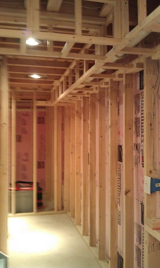

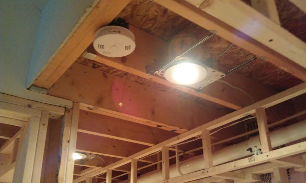

Made a little more progress over the weekend. I began ripping out the existing light sockets and pulling the old wire. I replaced the light socket at the bottom of the stairs with a can light and added 2 more can lights that wrap around the hallway leading to the gym. These are the only lights that will be controlled from the existing circuit. Everything else will come off the sub-panel. I also installed a dimmer for the 3 new hallway can lights. (Sorry for the pic quality this time around, my camera went missing so I had to use my T-Bolt phone for the pics this time)
Standing at bottom of stairs looking down hallway leading to gym
This is the third light after turning the corner in the hallway
Also replaced the old smoke alarm with a new CO/Smoke combo alarm and moved it to a more suitable location centered over the bottom of the stairs. I gave it a test to make sure the hard wire worked with the rest of the alarms in the house and everything worked well.

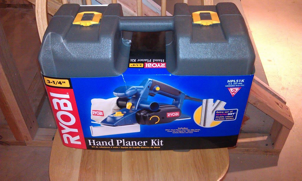

A month or so ago I noticed that some of the joists in the theater/game dipped a bit when compared to the others. I am going to hang some lines and see where I need to shave off some wood to level up the joists to help minimize waves in the finished ceiling. And I got to buy a new tool for this.
Here is the room with the problem:
And here is the new tool I got to buy:

Barlav,
A belt sander works well for the wider boards, and a simple planner works for 2x4s on edge.
Don't forget about the nailers for the awkward areas drywall will need screws.

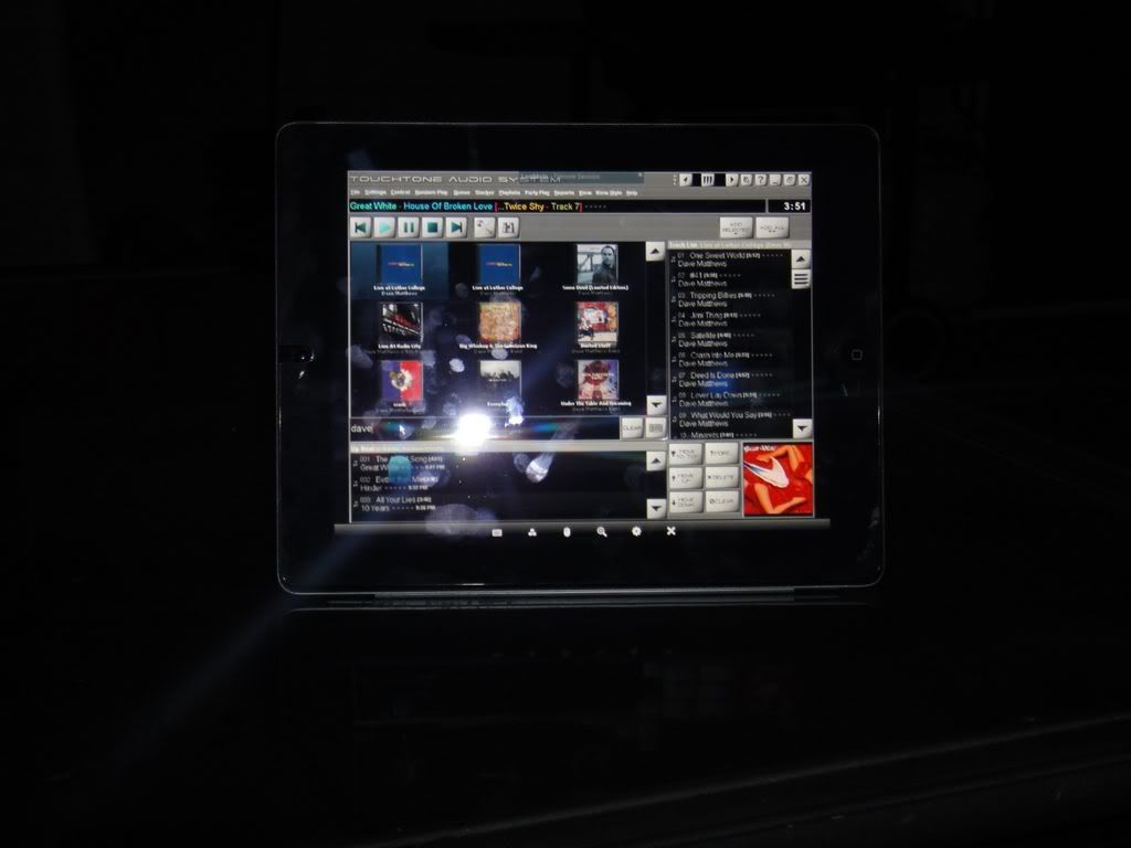

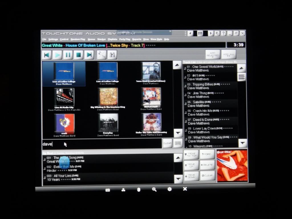

Here is a screen shot of the software I am going to use for the jukebox. It is designed specifically for a touchscreen implementation. I have gotten familiar with it and, except for some minor bugs, I am quite pleased with it.
I can put the software in "party" mode and when I am entertaining all the guests have to do is search for their music and add it to the queue just like a real jukebox. It is quite slick!
My original idea was to have permanent touchscreens in each jukebox location but then I thought outside the box for a minute and came up with an even better idea. I am going to use an iPad2 as the interface for the jukebox. I will remotely control the music server with the iPad2. I will add wall mounts for it in each location that has the speakers so this will be the best of both worlds. I can keep it fixed or yank it off the wall and have wireless access to the music from anywhere and use the iPad2 for other things when not using the jukeboxes. This will work out great since I will be able to use it out on the deck too where I also have 2 outdoor speakers that will be connected to the music collection. And this finally gives me the reason I've been looking for to buy an iPad2!

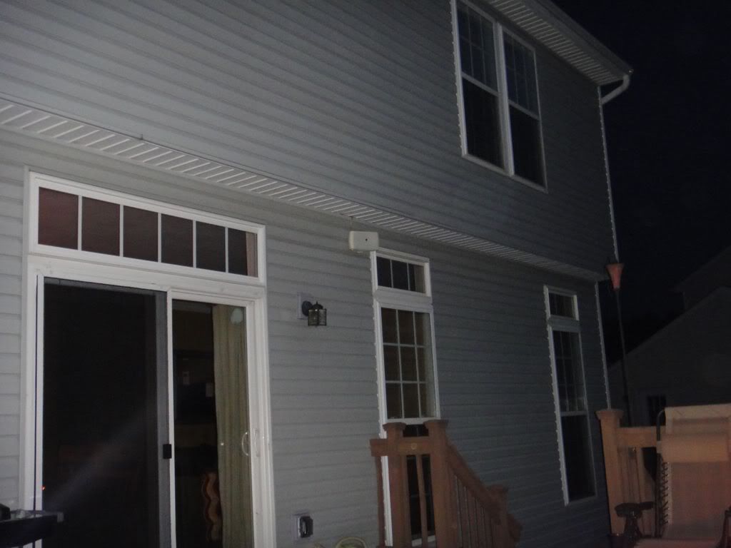

We were sitting around the fire about 50 feet from the house passing around the iPad and selecting the music to play. We could pause, control the volume, etc.. right from our seats. My guests couldn't get over how they were controlling the outside speakers from just a finger tap on the iPad.
Here are some pictures of the outside use of the jukebox:
Here are some pics of the iPad sitting on the patio table with the jukebox running:
Here are the outside speakers I'm using. They are pretty decent speakers and create a nice sound outside:

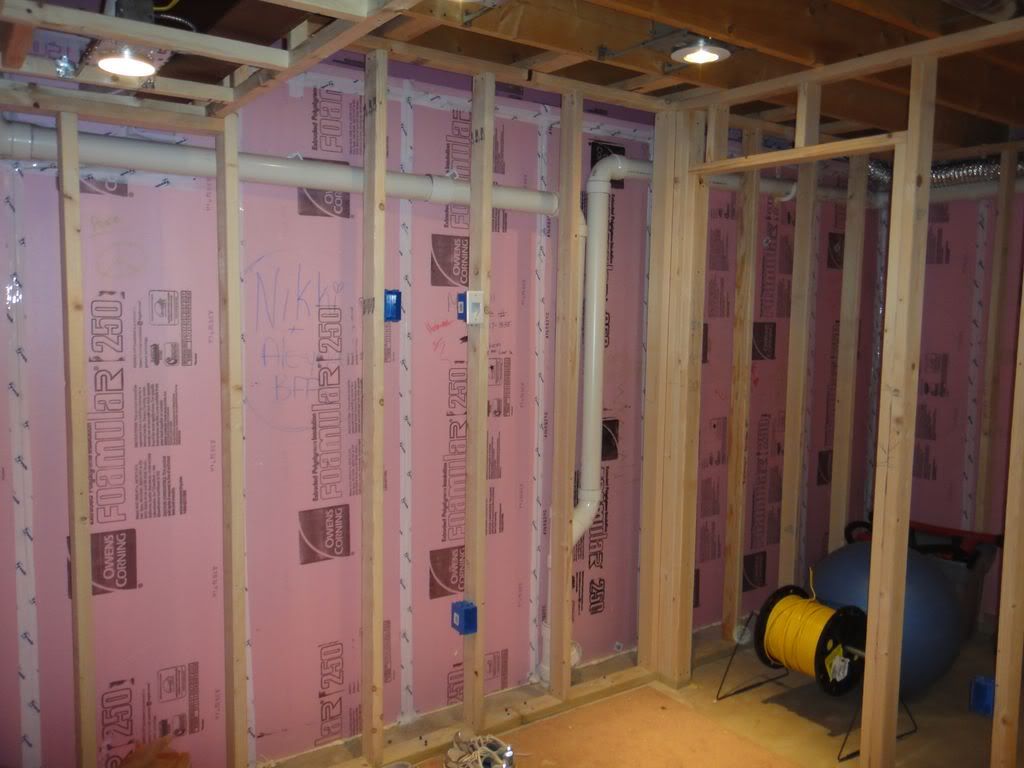

There is always something that cuts into basement time. This weekend started out with this. So now I am trying to find the cheapest way to replace this. I called one place and they quoted $500! And that is just for the window since I will be replacing myself. Seriously?? This is a simple 2 paned panel, no frame, just a panel. Anyway, I am looking around for a cheaper place.
After addressing the window I did manage to get into the basement for a while. First was the rewiring of the workshop. The WAF is back in effect now. She has been complaining about the dark storage area since I cut the power to the existing light fixtures down there.

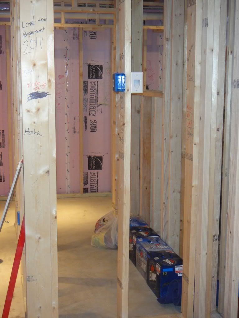

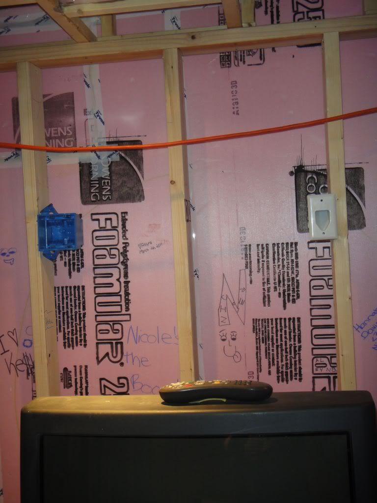

Didn't get much done this past week unfortunately. Had the brilliant idea of cycling around one of the Finger Lakes on Sat. and after returning from that I was toast. I did finish up determining where I will be putting the media in the gym. I also setup a new monoprice account. I can see that I will be buying a lot of stuff at this place. I ordered some low voltage wall plates for my first order. I decided to go with the direct hookup style as opposed to the plates that have the connectors built in. I believe in the fewer connection points the better.
Here are the plates:
This is where the tv will go for the cardio station. It will hide both the outlet and the media cable plate.
This will be the location of the big Tv in the gym. The plan is for a 42" LCD. There will also be a TiVo, Cable Box and perhaps a Roku device needed here that I will put on some built in shelves under the Tv. So I used a double gang outlet box for enough plugs. The only cables that will come from the media plate box in this location will be coax cable and cat 6.
This will be the location of the jukebox. It is on the back wall of the wine cellar (even though it looks like a beer cellar for now). I am going to start by having a wall mount for the iPad in this location. I will run a usb cable either to the plug or out of the media wall plate (since the media center closet is right next to this location). I will probably also run an hdmi cable and cat 6 to the media plate in case I decide to go with a permanent touch screen at some point.

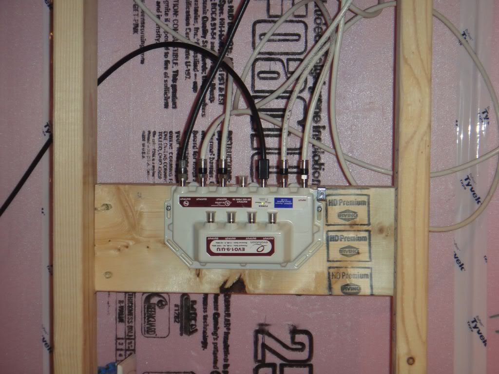

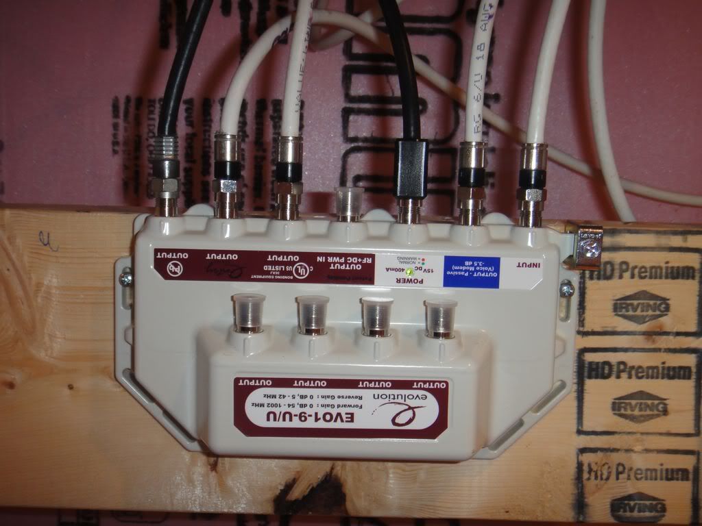

I decided to take a break from the wiring and install the coax distribution center to see if everything worked. The location of the distribution center is right below where the cable enters the basement. This was going to be the original location of my media center but now it will just be an access panel to get to this. I installed a dedicated outlet for it as well. It doesn't have juice yet so it is currently just plugged into a power strip for now. I will eventually clean up the wires and make them neater before I close everything up. I am planning to use conduit for all cable runs to the basement from this location also. This unit is working well and it is cleaner than using multiple splitters.

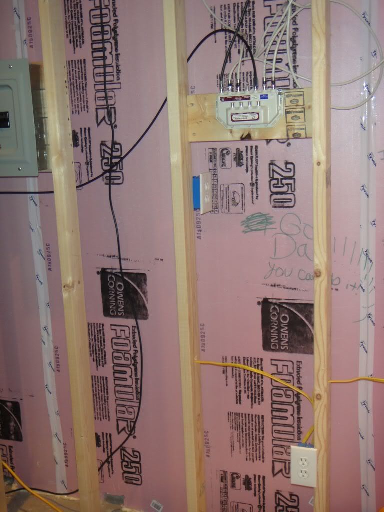

Finally back to basement season! I picked up on wiring the gym over the weekend and completed all the outlets and wired it to the breaker box. All outlets are working great and it is nice to have standalone power in that area now. I added many more outlets than I am going to actually use but I still haven't finalized equipment locations so I wanted to make sure I was fully covered.
The outlet dedicated for the coax control center

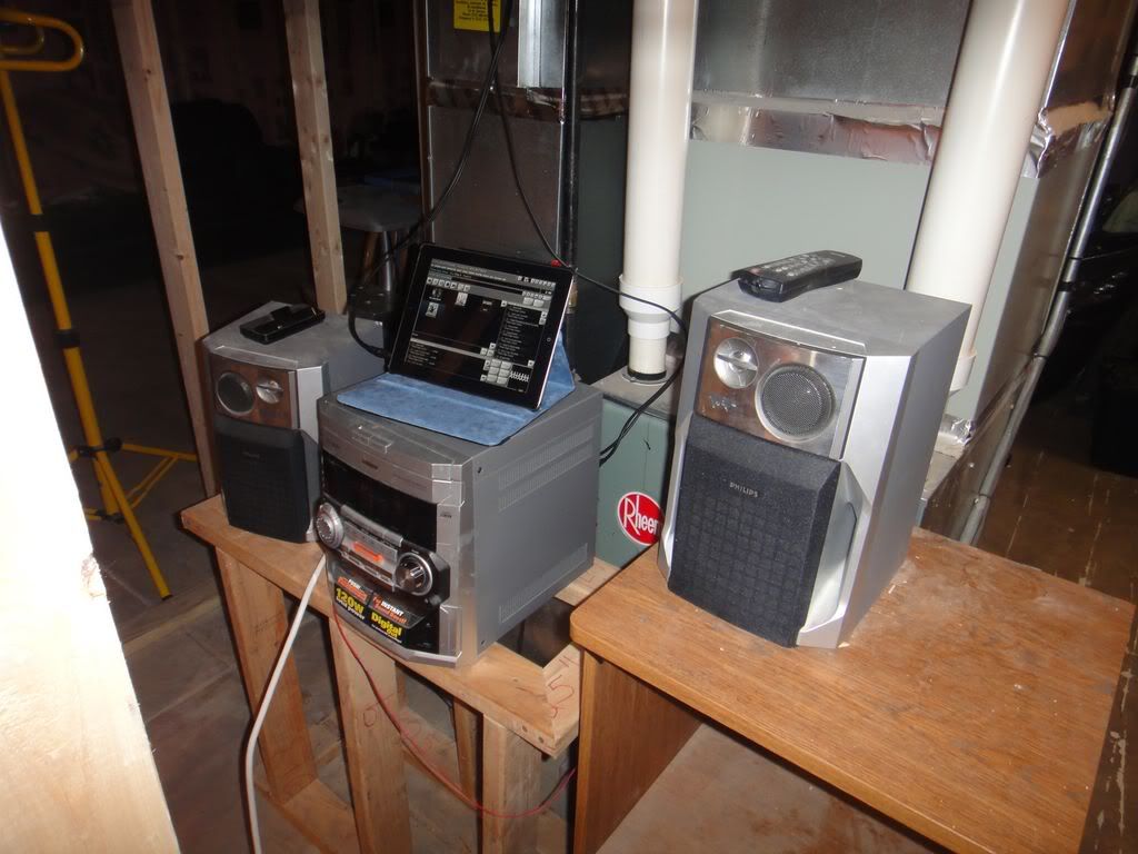

Moved the temporary stereo over to where I am going to install the touch screen jukebox and made use of its outlet for now
